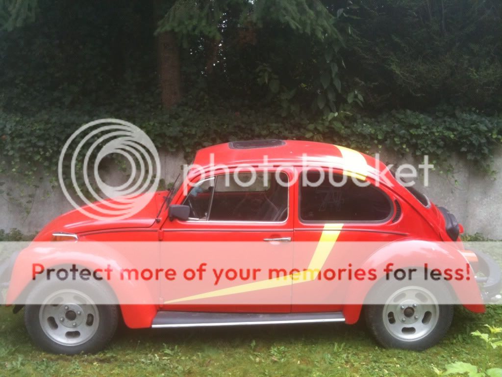

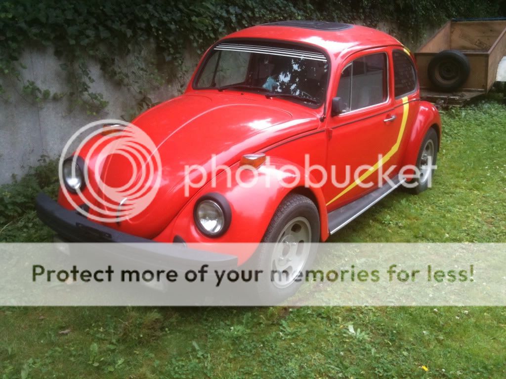

Hi, my name is Paul and I have picked up a new to me bug.
It is a 74 non-super Beetle. It was bought at auction, restored to driving condition, drivin a few months and parked in a garage since 1989, and here we are.
