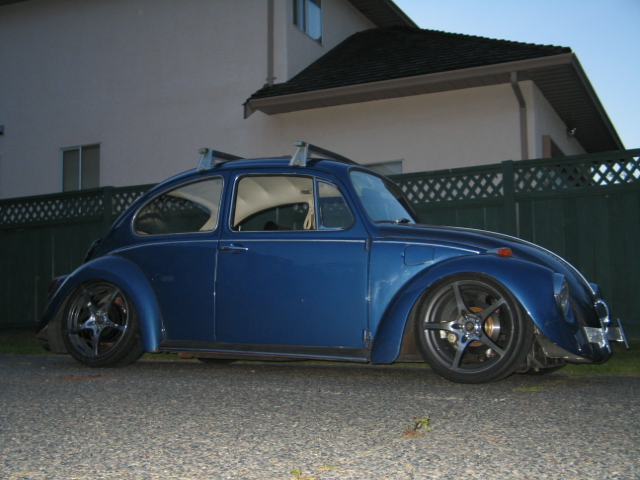

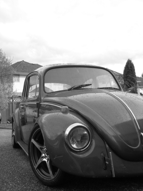

here are some pics of the car. still have work to do, but was able to put it on the ground tonight to see how the rims look.
before the winter
after

Hows the clearance with the front tires?

i rub a little on the edge of the fender on the passenger side. i will either raise it a  bit, or roll the edge of the fender out a bit.  i still have a couple days to work out all the little kinks, before aircare and insurance.
thanks to james buchan for narrowing the beam!

Where's you get the rims. What size....bolt pattern. Anything else fancy to make em fit. How narrow the beam??

i got the rims from airspeed. they are 17x7's with 205/40's, james1 to narrowed the beam 3\"
the bolt pattern is a 5x100. need to roll out my fenders a bit. but other than that, they fit great.

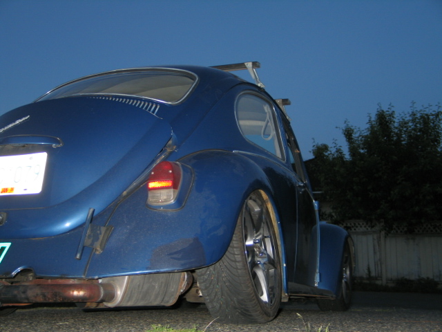

« Reply #14 on: March 26, 2005, 03:57:13 AM »
got some more pics.
also installed a 3\" narrowed sway bar from airspeed.

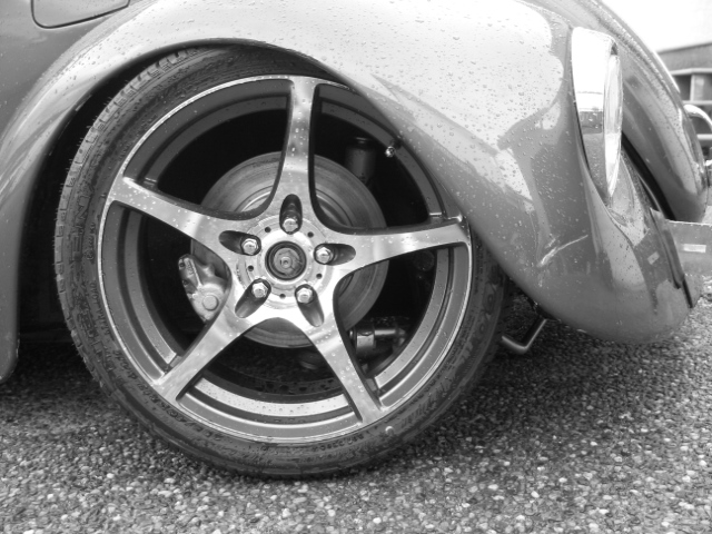

just some quick questions
what offset are those wheels?
and do you just have the narrowed beam?
or drop spindals as well?
i noticed the disc breaks did they push the wheels out?
whats the total height of the tires because i wanna go with 18's on my bug but i wanna know if they will fit if i keep 7.5 width,
yeah i work at a tire shop, i get discounts :) for myself
20's SORTA FIT!!
63 Beetle
Offline reefreshd_jive
  • Posts: 376
James' 68 Beetle
« Reply #19 on: April 15, 2005, 07:21:56 AM »
the wheels are a 40mm offset, 7inches wide 5.5\" back spacing and 1.5\" front spacing.
i have the 3\" narrowed beam, 2.5\" dropped spindles, and went the extra mile the airspeed 3\" narrowed sway bar.
i have been told the discs might push out the wheels a bit, but nothing substantial
i am running 205-40-17's with a total height on 23\". you would be able to run 18's with low pros no problem i think, the only thing is you might not be able to go as low as me. that would be my only thought.

were you disc rotors blank when you got them?
and who drilled them for you? how much did it cost?

« Reply #21 on: April 15, 2005, 04:57:38 PM »
the discs were 4x130.
airspeed was able to get a machinist to drill in the new 5x100 pattern.
they know his name, and what he charges. ball park was $150.

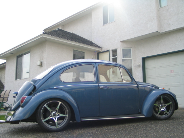

just installed my adjustable spring plates. here is what is looks like at its lowest possible height...
