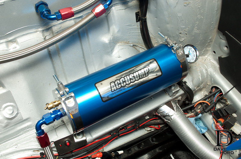

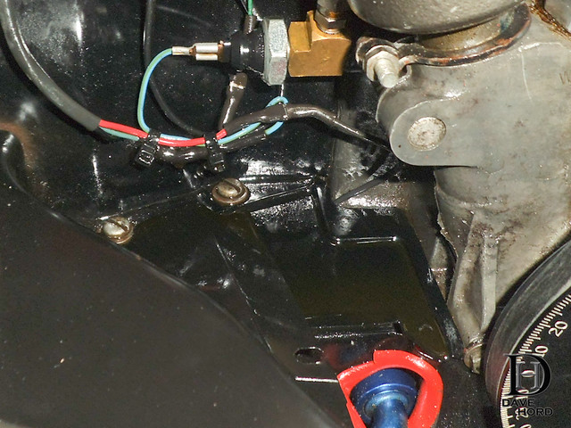

The motor has been back together for two weeks, and I've put almost 2,500km on it. So far the engine has been trouble free, and I'm even letting it idle for short periods while I walk away. I guess you could say I'm testing my luck, but so far there hasn't been any problems.
The current oil setup, including the fittings, was modeled after the Huebbe brother's setup. They've been stage rallying their car without oil issues for a few years now, which is why I figured it was the safest way to go. I have been looking into new fittings on the pump, however, as they do look pretty restrictive. Only the fittings on the pump are the steel industrial units, everything else is a proper aluminum -8AN fitting. The steel fittings on the pump are the same fittings the Huebbe's and I have used without problems (until now)...but at this stage I should be tweaking everything I can.
Upon reassembly I obviously measured everything, once again, but this time found one item which I had missed on previous builds. The magnetic drain plug was long enough to be touching the screen. While it *shouldn't* cause a problem, with heat I suppose it's possible that it could have reduced the opening gap for the pickup. Next time I have the engine apart I plan to cut the pickup on an angle to reduce the chances of a occurrence. For now I've tossed a washer in as a spacer. Sometimes the quick fix is just as good.
A new issue, which is probably related, is that the Accusump stopped holding pressure. Now to be fair, I think this was an issue prior to the big failure...but I broke the gauge on the Accusump months ago and haven't fixed it. In order to swap out the gauge I needed to remove the Accusump, so I was simply waiting until an oil change with some time. Over the previous months I've noticed it was slowly leaking down pressure, like if I left the car for a week or more it wouldn't have the pressure to pre-oil. Without having the gauge on the unit I couldn't tell if it was the ball-valve leaking down, or an issue with the Accusump. Once installed with the new gauge, I quickly determined it was leaking down. Within a couple of days of use, it wasn't holding any pressure (or indeed building pressure when the engine was running). A few emails to Canton Racing and it was agreed the internal seals on the piston were probably in need of replacing. Considering I've been using it daily, not really surprised.

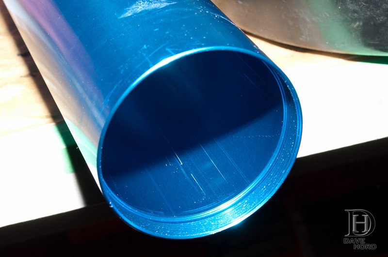

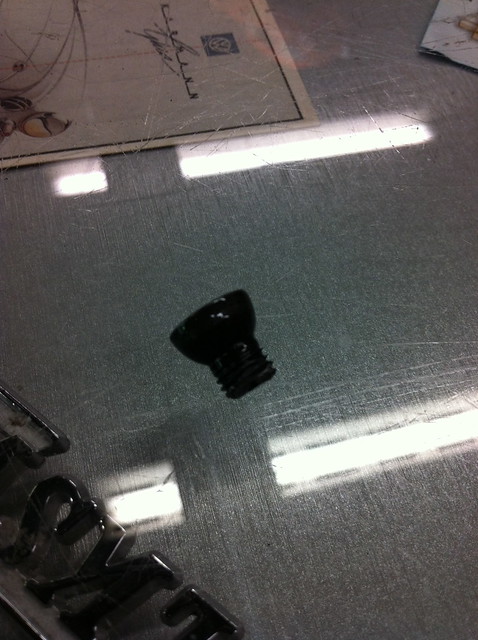

The Accusump isn't designed for user-servicing. Canton requires that all units are sent back to the factory, except for a few teams who do refurbish their own. I was given the go-ahead, and a list of mistakes to avoid. But first, one has to create a key to get into the secret vault...
With that done, I popped open the Accusump and immediately found the problem. The first thing they check when rebuilding these units is scoring on the cylinders. If the cylinder is scored, the unit needs to be replaced...and I won the bad-luck lottery. Obviously the Accusump ate some hard particles at some point, which I suppose isn't surprising considering I've roasted a couple of motors with it. The score marks are also on "the bottom" of the cylinder with respects to how I had it mounted, so the particle(s) were probably settled on the bottom and then caught up in the seals.
A few emails back and forth with Canton, and I'm going to need a new Cylinder. Since they don't sell refurbishment parts, that's going to be a challenge as I missed the production run for the year. Hmmmm. They're looking to see if they can find a cosmetic blemish unit, and in the meantime I've decided to clean up the scoring marks. While waiting for the correct sized O-rings, I figured I would try the closest-fit from the local industrial shop, just to see if I'm wasting my time. In went the O-rings, in went the Accusump and voila! Holding pressure...for a while. Interestingly it's now holding oil pressure, but not holding pressure on the air-side of the chamber. I suspect with the proper sized o-rings it will all work as planned. Might make it without a new cylinder after all!

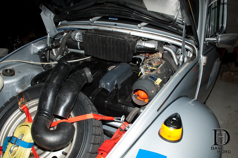

I also spent some time tuning the gas heater this week. I was having some issues with it cutting out, or taking a long time to fire up. Through adjustments to the flame switch I think I've finally got it running close to factory spec. It now runs continuously without cutting out, which is great. I should be getting just a bit more heat out of it, but my fuel pump adjustment is maxed out. That's the Achilles heel with using a gas heater these days, the pumps aren't available new and everyone I have is just slightly under the factory spec for output.

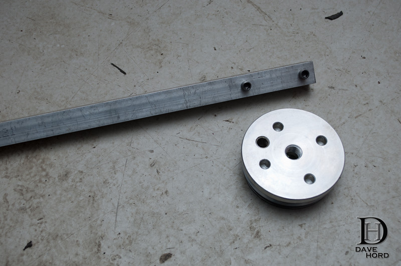

Started playing around with the tachometer project, its going to be a little more involved then I anticipated. I need to work out how to remove 3/4" in depth from the Stewart Warner tach internals before moving forward. I think I've figured out how to attach a face-dial, and the Porsche needle will simply need to be drilled out to fit the SW motor.
On the one hand, my motor will definitely be rust free. On the other hand, an oil leak is never appreciated. Turns out the pressure switch was leaking through and out the electrical connection. Rather annoying, as with the Christmas rush it took a couple of days to figure out that simply tightening things up back there wasn't solving the issue! Finally stopped to run the engine while I watched, and the issue was quickly determined (and solved).

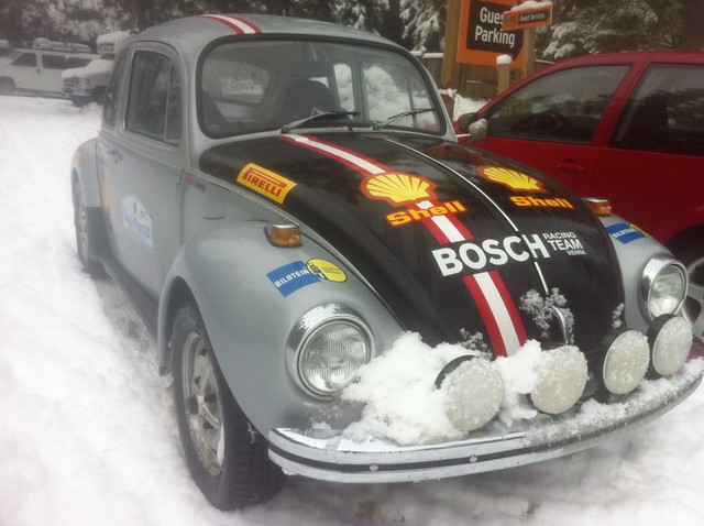

I was invited to check out a driver training center just North of Whistler yesterday, and so popped the car up on axle stands Thursday to give it a "pre-event" check. I was anticipating an issue with the rear wheel bearings on the right-side, and I wasn't "disappointed". The metal washer between the disc and bearing spacer had cut into the seal, destroying the first lip. Dirt then destroyed the second lip and the outer bearing had water/dirt ingested.
Normally the job is annoying, but not too difficult. Public Service Tip: if you weld all new lower shock mounts onto your control arms, confirm that you can still remove the axle stub before assembling the car for the final time. Oops. Once I pulled the shock out I was able to get *just* enough room to cut away the required material. A mere 5mm was all I needed. With the stub axle free, the job was as per any other Volkswagen. Greasy but easy. Alas, we had incredible amounts of snow in the last few days, and the skid pad plowing went much slower then anticipated. Event postponed...but I'll get out there soon enough. This does mean snow photos/video will need to wait as well.
The Pre-event check also determined that the mud simply never stops. Geesh.

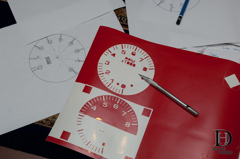

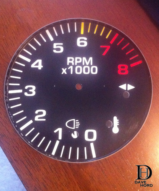

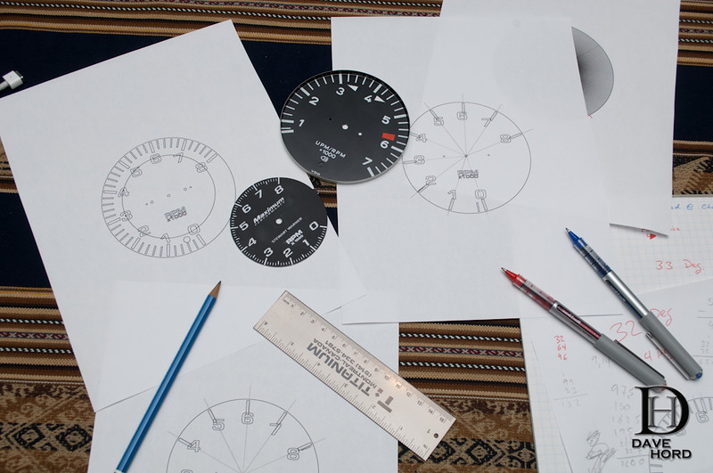

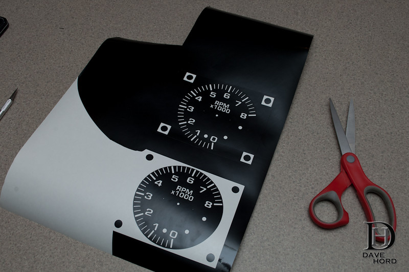

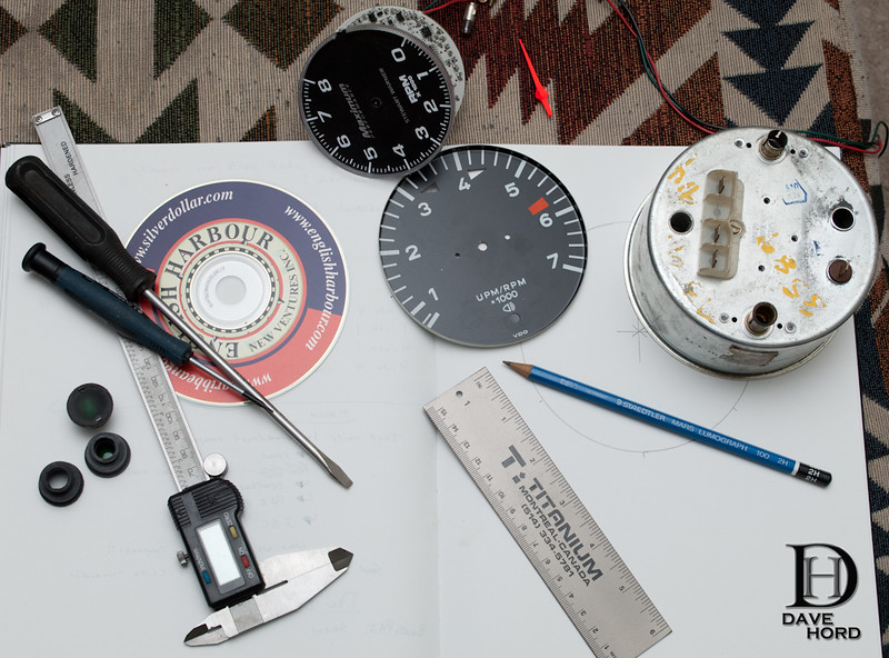

Back to the tach project. Started with a lot of measuring, and some basic drawings / concepts to figure out the direction I was going to go.
In order to get the drawings perfect I'm using a combination of Rhino3D, and then exporting it to Adobe Illustrator before finally exporting it to my vinyl cutter. The three steps opens a lot of room for file error, so test cuts are required.
Once the file was sorted out, various stages of 'look' for the tach dial.
The new tach will have the turn signal indicator where I can see it, as well as the high-beam indicator and an oil-cooler fan indicator so I can see when the fan is on (either tripped by the thermostat or by my override switch)
After modifying the internals of the Stewart Warner Tach, and then determining that my original plan of mounting it all inside the Porsche housing wasn't going to work, it was off to the Lathe! Unfortunately, this is where the project sits for the next little while. A slight 'lathe accident' means I'm on the hunt for a new 914 tach housing :P

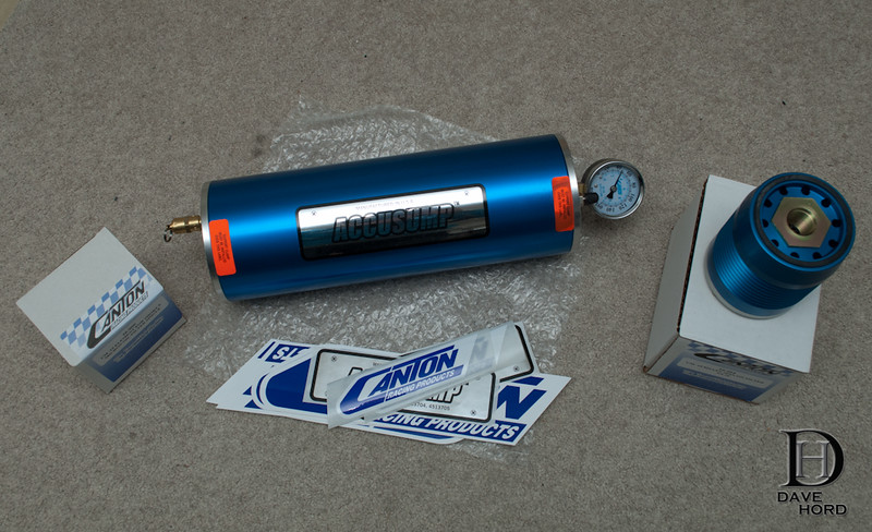

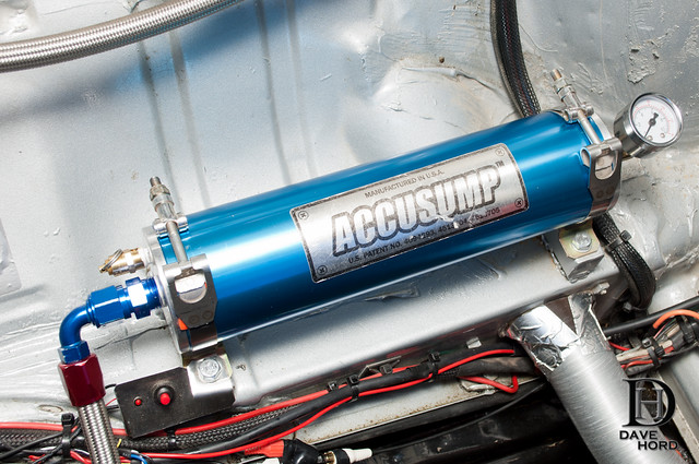

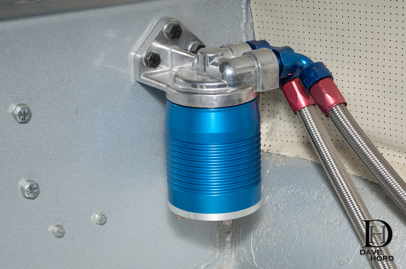

Well, rather long since an update. Whoops. Canton Racing and I had been talking about refurbishing my 1-quart Accusump, and after trying a few of their suggestions we determined the damage was too extensive. Lucky for me, however, as Canon Racing loved the build and sent me a little care package:
Inside was a 2-Quart Accusump, and Canon Racing Products oil filter. Part of the issue with my original Accusump could have been attributed to less-then-ideal filtering, and this new oil filter cuts down to 8-microns. I'm pretty stocked to add this into the oil system.
Installed and working like a charm. I'm back to pre-oiling before each startup, which I feel much better about.

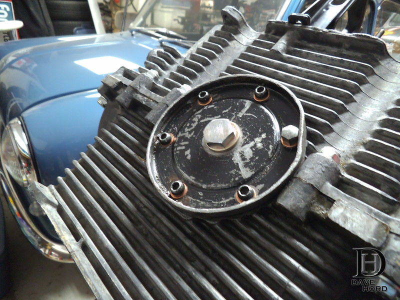

The emergency exhaust gaskets I got on the last engine install were apparently really short-life units!
I knew getting gaskets to fit the Vintage Speed exhaust in my hometown wasn't going to happen. And while AVRparts.com had a set on the shelf, that means they would have a system they couldn't sell until replacements came in. Time to find a better option!
I've read a lot about Remflex gasket material, it's 100% graphite material, and is often used successfully for pitted and warped header flanges. Could be awesome in this application, as the Vintage Speed flanges are pretty long and narrow, making them challenging to seal if you're not careful. The Remflex is 1/8" thick, and crushes down to 1/16" (but seals long before that apparently). I traced out the flange, and cut out gaskets using a hobby knife and punch for the bolt holes. So far, so good! If the gaskets aren't the reason I pull the exhaust next, they'll definitely be a success.

A few days after installing the Remflex gasket material, I was heading over the Duffy Lake road on my way to The Thunderbird Rally. I was almost past the point of no return when I smell alerted me to a problem. Yup, burned out number 4 again...and this time it was the Remflex that was 100% gone. Clearly my issues were bigger then just the gasket material. I checked my watch, and was a little over 40min away from the closest town...and it was 4:40pm on a Friday night. Not good! I hammered down the road, and into a tire shop and general repair shop to peruse their gasket selection. I found a few that were close enough, and then hit the local snowmobile shop for a roll of header wrap. A parking lot backwoods repair was done, and I was on my way.
Since I'll forget to update it later, it turns out the issue was not the gasket materials, but that I had overtightened the flange when I last had the motor out and they were no longer mating flat. With the pressure localized on the ends, the gasket would blow out in the middle every time. I have since repaired it and enjoy leak free driving without issues...

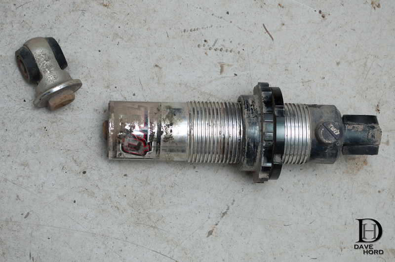

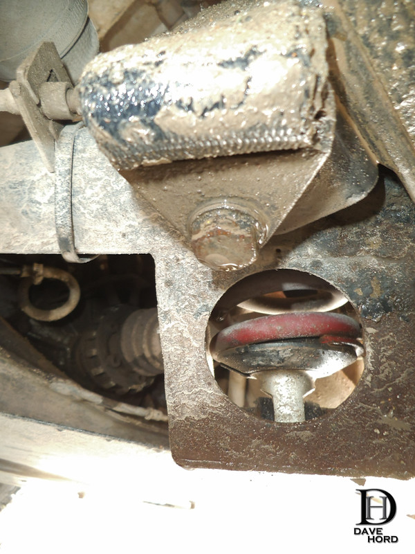

Crawling under the car I was met with a rather interesting sight, which I'll admit took me a few seconds to figure out:
The observant amongst you might notice that something is missing. I could see the shock body, I could see the spring. I could see the lower spring perch but oddly enough there was no shock shaft joining the upper and lower halves of the assembly! Now, a normal person would probably look at this and think "call a trailer", but rally people have never been accused of being normal. I could see from the way the shock body was wedged, and how much movement it has without a spring, that there was very little risk of losing the spring out of the assembly. The embarrassment of not making the finish of another event was too much to consider, so I jumped in and began to figure out the new handling characteristics.
By the end of day one I was getting pretty comfortable with the car, and I had pushed it enough to know that I wasn't going to be at any real risk of losing the spring. I could take it easier on the gravel sections, and go with a much heavier foot in the snowy sections. By the end of the event, I was thoroughly enjoying myself. Sure, I had heavily damaged my car (who knows what else went with the shock), but it held together and I had figured it out enough to have a tonne of fun driving it. I drove home over the Duffy, which was snowy by this point, and I found that special bond you hope to build with a car. That moment where you can't wipe the smile off your face, that point where enjoyment and experience outweighs the build, the cost, the headaches and everything else. That spot where the car I imagined on paper was finally materializing in experience.
Of course, one still has to fix the damage.

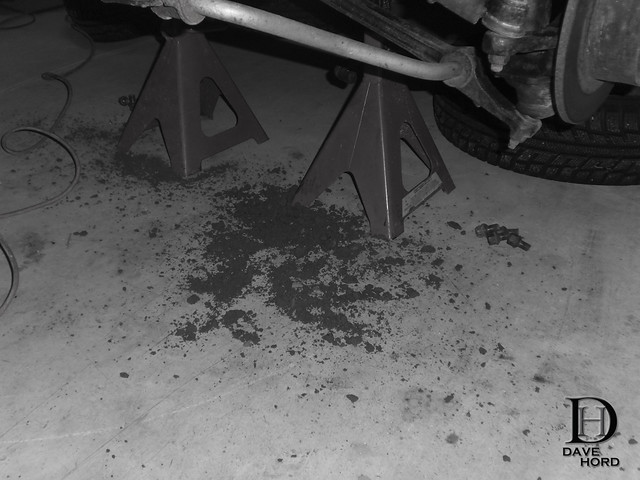

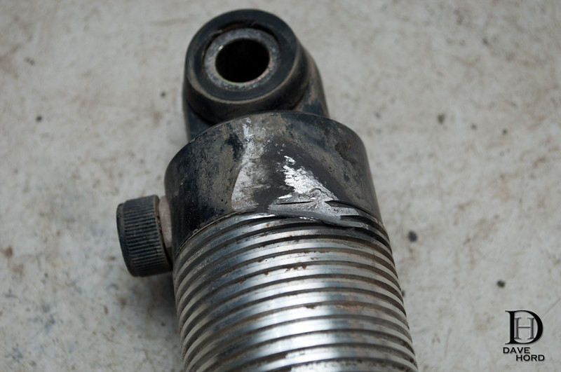

Upon teardown of the rear suspension the first thing I noticed was there was no longer any bump stop attached to the trailing arm. My best guess, based on the experience is that I lost the bump stop on the first big hit, which then allowed for the shock to bottom out completely. The shocks haft snapped off right at the lower eyelet, at the beginning of the threads which are a stress-riser. Initially I was concerned that the shock was getting a side-load under full compression, but the missing bump stop (and cycling it through without a spring), points to a simple bottom out failure.
Both the upper and lower hardware had the faintest of bends in the bolts (visible only when rolled on glass), so they were replaced. The load travelled through the Kafer bar to the right-hand side, where the upper bar mount snapped clean off at the weld. Needless to say, it had to be a big hit! While technically the QA1 shocks are rebuildable, and all parts are replaceable, for time sake I picked up another unit and installed it. The Kafer brace was removed, a new stronger mount welded up, and replaced. Sorry, no photos as I was trying to get the car running for work the next day!
The upper shock body received some damage from leaning against the body all weekend.

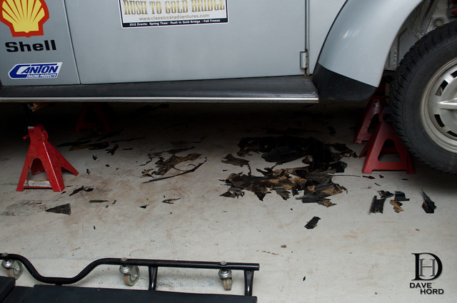

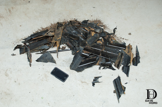

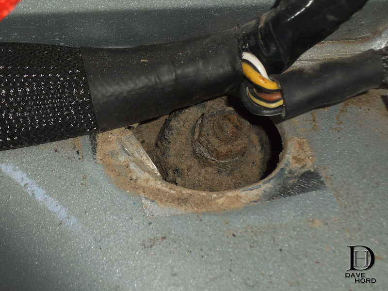

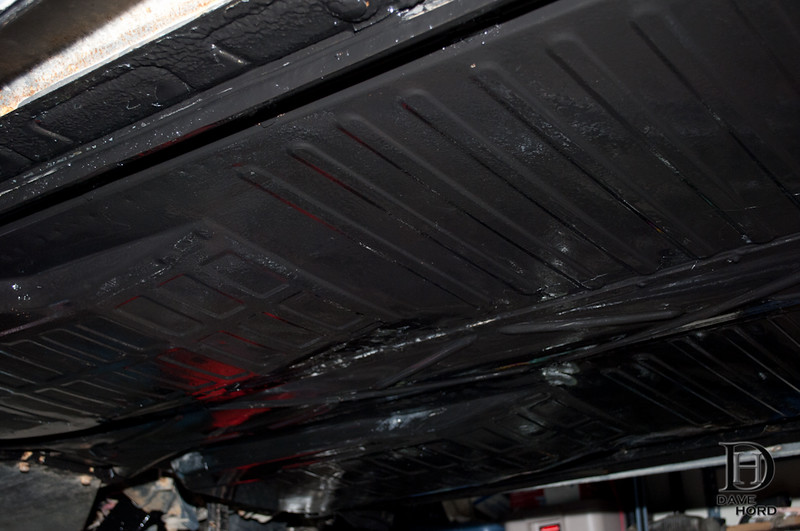

I call this next shot "why I will never POR15 new metal again"...
It literally just peeled off the bottom of the floorboards, iphone included in the sweeping up for scale:
Interestingly enough, any of the "old metal" (spine, torsion bar housings, etc.) which was prepped the same way is fine...can't take the POR15 off with a chisel. So, I let the bare pans 'season' for a day or two and then repainted them. We'll see how this holds up...
« Reply #290 on: March 11, 2013, 02:51:35 PM »
I have had the same experience on "good metal"... Makes me rethink POR15 sometimes.

I have had the same thing happen with Por. I will never use it again. I use Endura now. It is the same stuff they use on the Oil rigs. Tough as nails.

I've used endura before, and though tough, man it's a pain to apply. Great when you've got the car separated from the pan, but not an easy fixup for small areas.

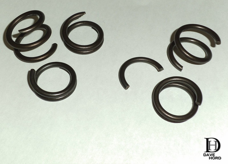

Finally I decided to go all the way back to the beginning. Well, actually the car decided for me when it blew out an exhaust gasket (again). The car went up on axle stands, and I made plans to adjust the valves, set the timing, start with a set of base jets (by the math), fix the exhaust gaskets and try again. The heads had been fully reworked in November by Darren (K-Roc Heads), so I was really confused why every single valve was tight. I was exhausted, so when I popped on the 3/4 valve cover, removed the paper towel on the heater box and was met with a piece of valve spring…
Really?

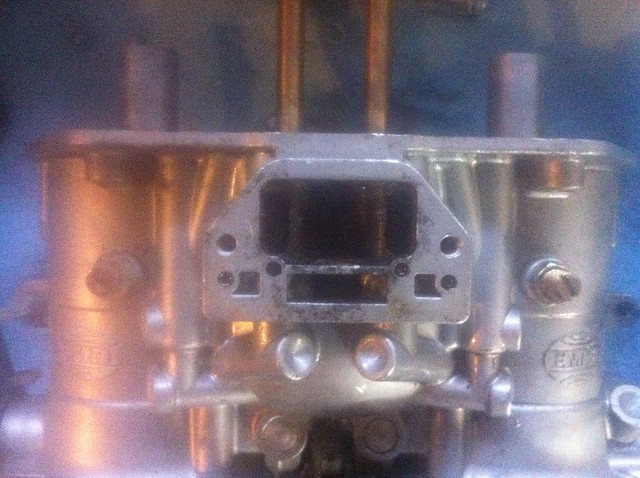

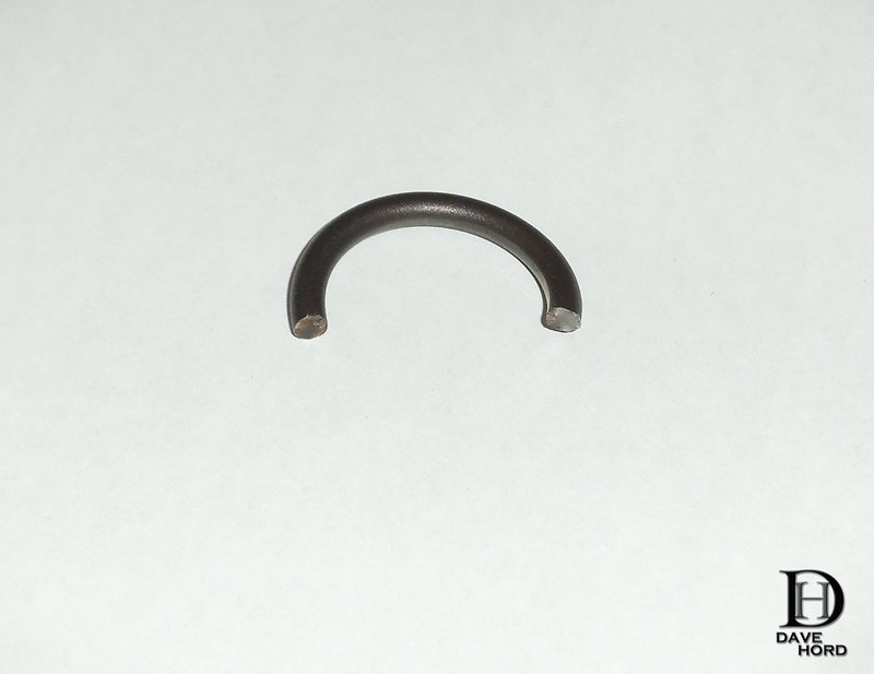

Darren and I chatted, and we both realized that I have almost 80,000 miles on this set of springs. More then double what either of us would have suspected. While they were fine in November, clearly that wasn't the case anymore. Thankfully Darren had put dual-springs into my heads many years ago, so when the outer spring failed, He offered me his on-car replacement tool, and had a full set of dual valve springs ready for me…two hours away. Good thing too:

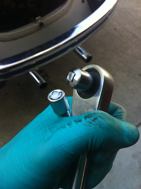

While driving to get the valve springs, I realized my valve adjustment issue. In my stress of organizing and lack of sleep, I had neglected to consider that I have chromoly pushrods and thus adjust to loose-zero, not .006"! Whoops. With springs and exhaust gaskets installed, valves adjusted and timing reset, I cleaned the carbs…finding mud in the choke area which isn't used by the Empi HPMX version. Mud eh? Hmmm. Don't let anyone tell you I'm easy on equipment.
Well, with that cleaned out I started tuning for lean-best-idle…and still had exhaust popping. Soon a hairline 2" crack was spotted, and off came the apron & exhaust. It would seem that at some point an impact resulted in a crack on the muffler at the #2 inlet (actually on the little pipe sticking out of the muffler to the flange. The resulting movement probably attributed to the gasket failure issues I was having earlier this season. It was 11pm, but my buddy Scott still took it home, welded it up, and brought it back. Killer service, and help from a buddy who leaves for work at 6am. It was too late to tune, but not too late to get a good night sleep.
Amazing how easy the tuning is when there aren't a bazillion other problems causing weird results! Within two hours I had lean-best-idle, idle jets set, mains sorted and the airs figured out. My AFR numbers were spot on everywhere except for a lean condition when cruising at 3000-3200rpm. While I knew Darren and Geoff were going bat-shit crazy with all my calls and texts regarding tuning, I was at a loss. The RPM range said it should be mains, but changing them didn't help and made other things worse. Maybe a combination of Airs and Mains? changing didn't seem to get the results I needed. A final text sent to Darren (with crossed fingers) and a suggestion came back "go one up on the idle jets". I did, and what you know. Running fantastic for the Spring Thaw…with 20 hours to spare!
« Reply #294 on: May 02, 2013, 12:24:37 PM »
So final follow-up on the valve springs. Coil bind was checked for when I originally built the motor, and again in November when I had the heads off. The old springs show no marks of coil bind, and the new springs (same brand/model) were checked and cleared without issues. I am attributing the failure to a combination of mileage, abuse, and a WOT over-rev the other night while tuning.

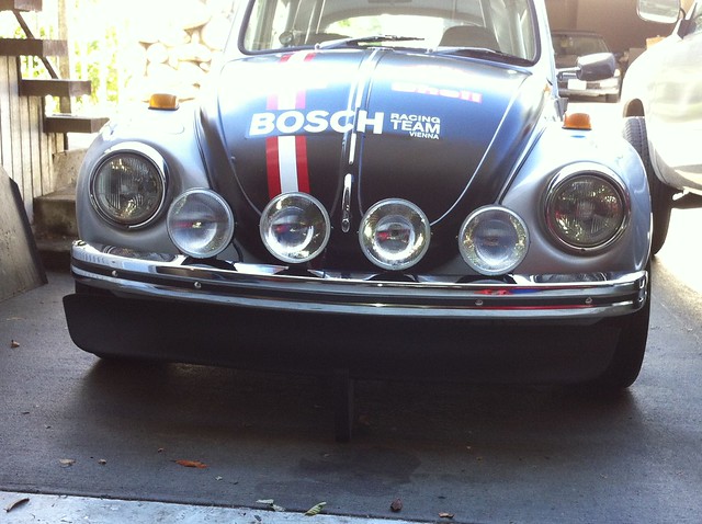

Here's the thing, when the owner isn't using it...he wants me to Rally it. Stage rally, rallyX, etc. if it's just going to be sitting, it might as well be used. Hmmmm. So basically I now have a full stage rally car in my collection of vehicles. Suddenly destroying the beetle further with gravel is a less enticing idea. I mean, why would I shred paint on the beetle when I can just use the Colt?
I'm seriously considering working on the suspension this summer, and setting the beetle up as more of a Tarmac-Rally car. We've got our www.classicccaradventures.com events every year, and I'd probably still pop the suspension back up for winter events. The Colt is too damned loud inside for anything but Stage rally.
Thinking Coil-overs on the front, perhaps wider wings (and rubber), a Kamei front spoiler and it should be good. Tarmac rally and track car...???

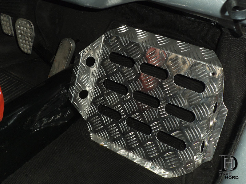

First up, I finally got around to mounting a co-driver footrest in the car. I had planned on machining up a unit which would have two rails permanently mounted to the floor, and a moveable panel (for different height co-drivers), but the crunch time to get the car ready in time for Spring Thaw meant I went with an OMP pre-formed panel. Of course, I'm not happy with the way it sits...so it will come out of the car soon enough for some changes. Basically, the angle isn't "right", and in order to sit correctly it needs to be trimmed to clear the tunnel and the inner fender.

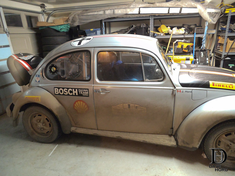

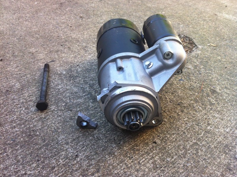

Geesh, this car was new just months ago! It's amazing how things underneath get dirty and corrode. Adjusted the steering box in anticipation of a road trip a couple of weekends ago, and made a note to get under the car with some cleaning supplies and fresh paint soon. The road trip started off as a blast, headed down to the southern border of Washington state, via Mount Rainer National Park and a bunch of other twisty roads. The car was handling flawlessly, despite the heat, until I hit the desert-like conditions of Yakima. The air temperature was a little over 33 degrees, with zero wind. Driving at around 120kph the oil temp was up to 220, and I had to work to keep it below 230F. In hind sight taking the skid plate off before my trip would have been a wise idea, but I was so close to my destination I figured I wouldn't worry too much. I know from past experience that dropping the skid plate will equal a 20deg oil temp reduction, and should probably resolve to create a summer plate with some of the design features of VW's original ones.
The road trip home, though, was like a story from hell. First bad gas (water), which required overnight carb cleaning in a walmart parking lot. The rear brakes went to metal (seized slider pin) and I roasted the rotor and brake calliper. Then ignition issues, and finally a broken elephant foot adjuster (which I discovered many hours later).
I limped the car to AVR on three cylinders, and spent a bunch of time diagnosing the problem (being awake for 30+ hours doesn't help the brain to function). Thank goodness Art and Vic were there to help me out between calls and customers! Eventually I borrowed a set of Rockers from Art's drag-car parts stash, a few other miscellaneous parts and made my final two hour trip home.
And once home, the poor Beetle sat. First off to wait for parts, then to wait while Audi & truck projects were worked on, and then finally because every damned thing I did wasn't working out. The list of things I meant to take care of was rather long, the car after 42,000km was due for some bumper to bumper checks and maintenance. Some things, like the grinding starter, I was aware of…while others (like apparently I have no brake lights!) were pointed out to me on the drive home. While I waited for new rocker arms to arrive, I started picking away at the list.
The brake switch boots were filled with dried mud, and thus the contacts had corroded. Relatively easy fix that, so there was that positive factor. But the next two photos give a much better description of how my last two weeks went.
Missing from the photos is the brand new brake calliper, that once installed started puking fluid out of the e-brake mechanism…there were other issues too, but I'm afraid I'll end up in a mental hospital if I start listing them off!  After breaking the new chinese-rebuilt starter ($40), the only thing I could get quickly was a Bosch rebuilt, at a price tag of $150. True, not bad for a starter…but when you toss them in a lathe and cut a 1/4" off the front face you think about whether or not you want to spend the money! My gosh, why did I not buy one of these from the get-go?  All my grinding starter issues are gone, even though I haven't replaced my now hurting flywheel. Not to mention it spins so much quicker the bug starts in less then a second.
