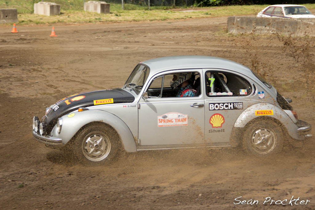

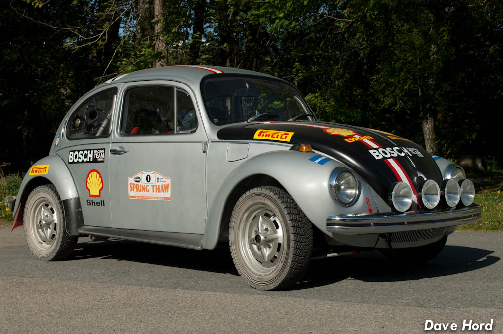

I'm super stoked and happy with it so far. Having the shots done this weekend by Andrew means that I've now got free reign to play with the car. Stone chips? Not a big deal now! The car does handle significantly differently from the last bug, so it's going to take some testing before I'm comfortable sliding it on Gravel. Sunday I swapped the seats back to my own, and prepped it for some gravel playing on Monday eve. A last minute group in whistler meant switching it back to street tires, and a day on the mountains until 11pm. Sigh. Probably won't get out on the gravel tires until Sunday :(
On the plus side, however, I am allowed to post this teaser shot!

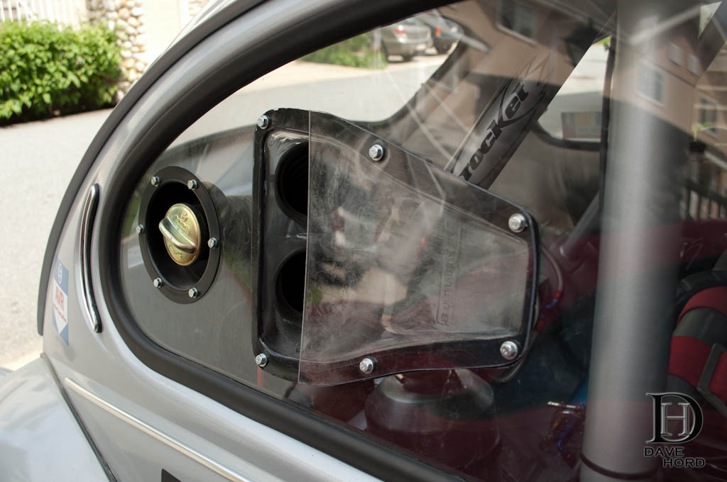

I've also been working on the cooling. The NACA duct flows too much air past the oil cooler, and running on the highway I can't actually get it up to 200deg running temperature. The thermostat I'm using to bypass the cooler still lets a small amount of oil pass through, and this is clearly a problem. A couple of tests with cardboard (blocking the duct) allows the car to come up to temperature...so a solution needs to be found! I honestly don't understand the aerodynamics of the duct well enough, but I know I need to keep the boundary layer intact as much as possible past the duct. This piece of lexan seems to be doing the job so far, might need to make it a little larger and/or adjust the shape.

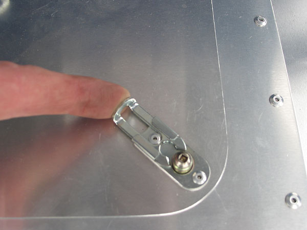

Once I've got the shape/setup figured out I'll then swap the bolts out for Dzus 1500 fasteners. They will allow me to pull the panel at any point when the heat is getting to high for the fan to control. (Hot day at the track perhaps?).

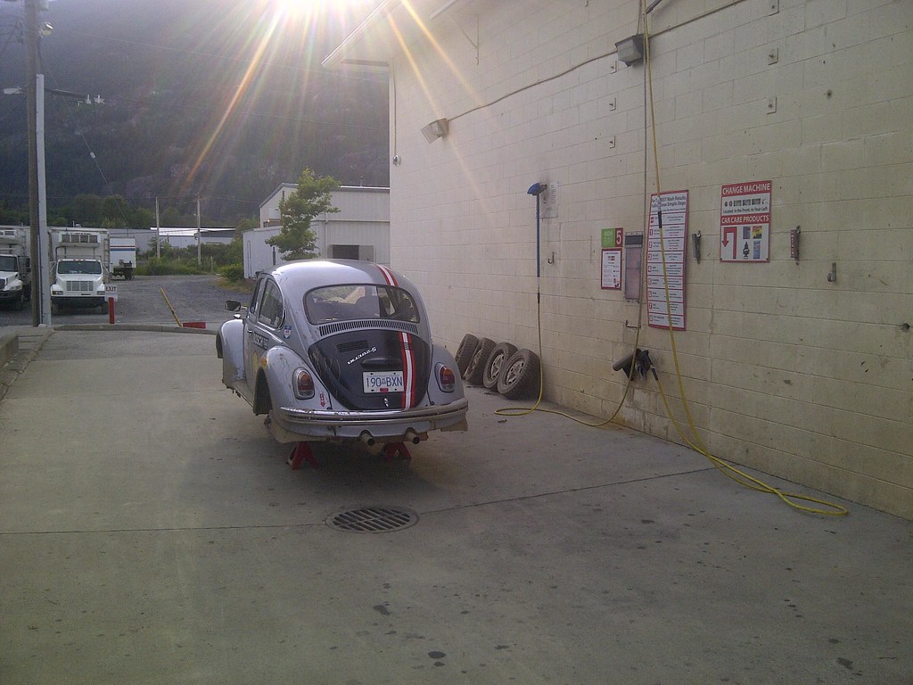

Started cracking down on the various things I need to address before rallyXing the car on the 24th. First up was swapping the Oil pressure gauge with the Voltmeter. Let this be a lesson to everyone, before installing everything else in front of the dash (wipers, airbox, etc.)...put the steering wheel in and make sure you can see everything! Now with them swapped I can monitor the oil pressure without the need to look, and I can see just enough of the voltmeter needle to know if it's charging or not.
With that done, i decided to investigate why Fuel Pump #2 wasn't working. It hasn't worked since the first day I put a battery to the car. I recall testing the relay and all the wiring I could reach, and determining at some point that it had to be the wiring right up at the switch. Since the dash was apart I pulled it all out, and found the switch and wiring to be fine. Hmmmm. Testing all down the line I eventually discovered I bought a $30 dead fuel pump relay. Hmph. Tossed a regular relay in for now (which doesn't have the tach-input feature) and Fuel pump two was working properly. Sweet. Stuffed everything back in the dash, put the airbox back in, did a few other things and triple checked it before leaving the garage. Fuel pump two not working.
Hmph. Guess I'll be going back to deal with that tomorrow night :P

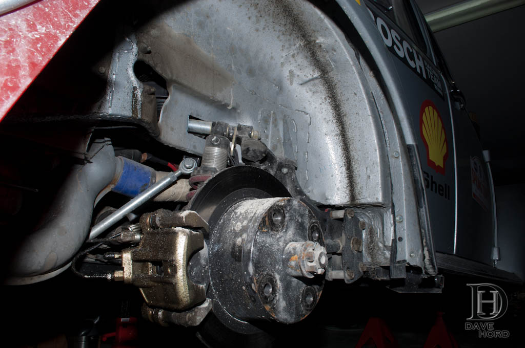

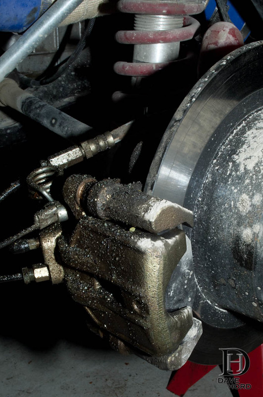

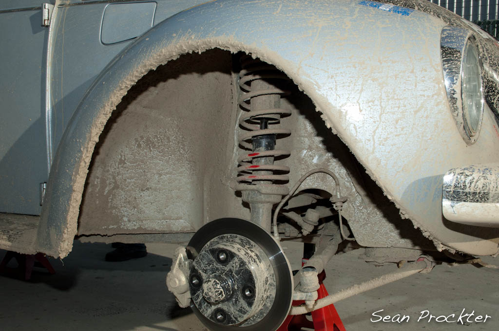

I decided since I'll be working on it tomorrow that I might as well drive my F150 for a day, and put the bug up on Axle stands. It will give me a good chance to look everything over after playing the gravel for over an hour on the weekend. Good thing I did!

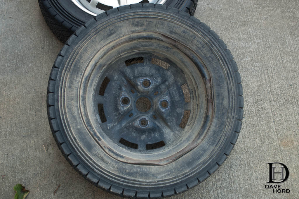

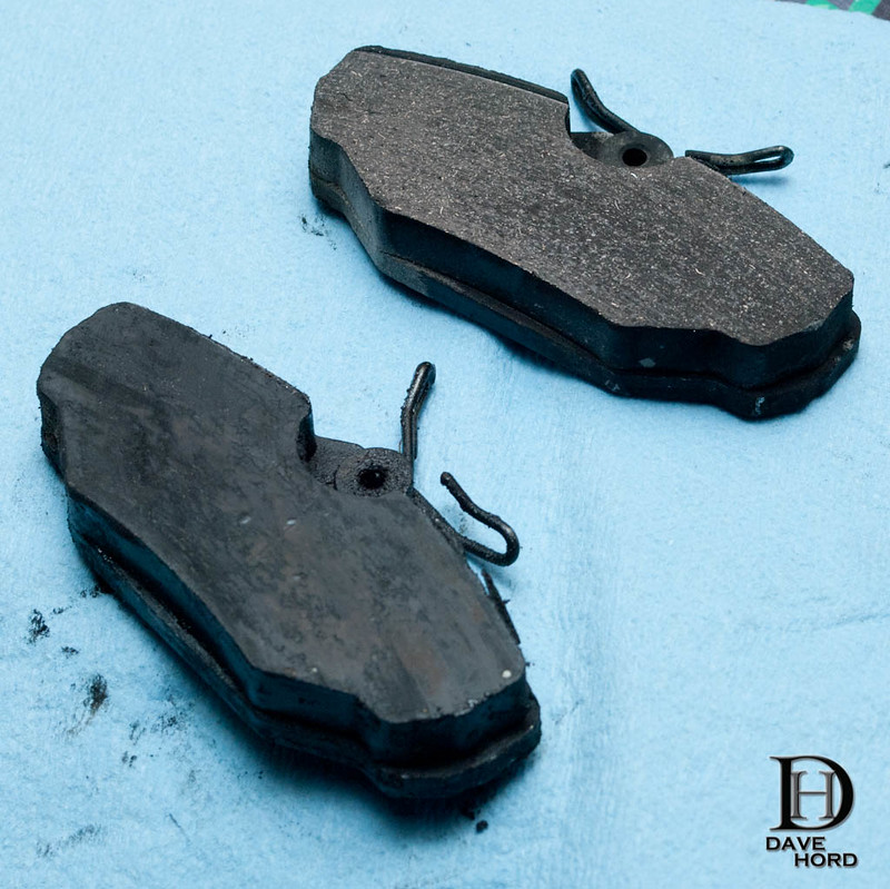

My first thought was that I must have blown a Motorsport CV boot. But upon closer examination it would seem that my catch can drain came loose and the oil was being picked up by the airstream from the tire. The drain is right against the inside of the fender wall, and will need to be changed. The oil tank was slightly overfull before I hit the gravel, and I knew the catch cans were going to need draining...but I guess the bug decided to drain them a little earlier then me. Unfortunately it's all over the brake caliper:
And the inboard brake pad is wasted.
I've got the brakes and rotor cleaned up, but will need to check to see if I have any rear pads for the car. I know I have spare fronts, but not sure about rears.
...on the plus side, at least I have something to do?!
« Reply #221 on: June 13, 2012, 11:05:17 PM »

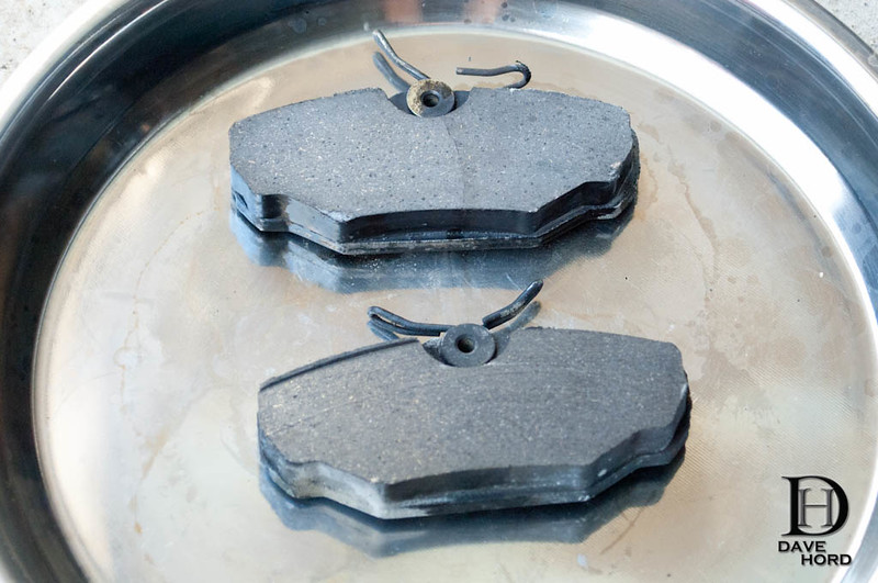

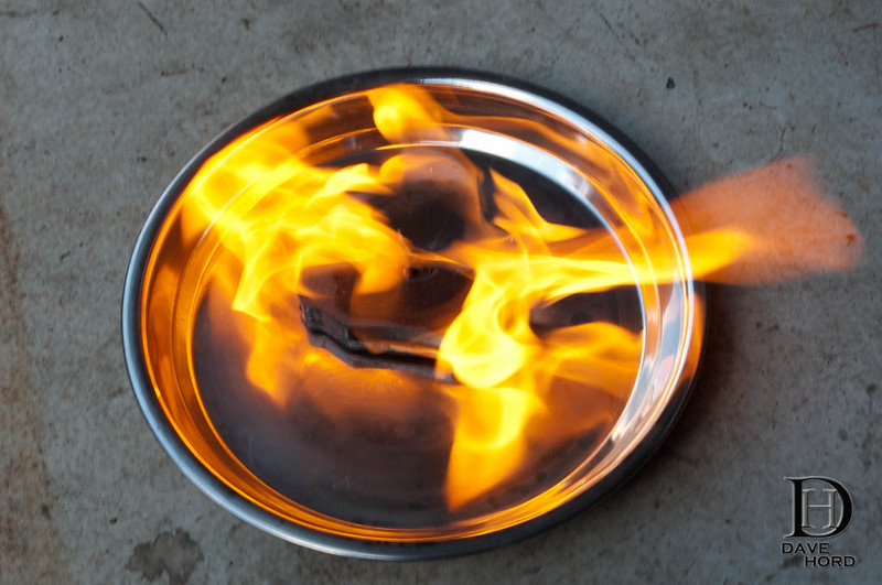

Well, AVR has brake pads in stock...but I really don't want to drive down just for a set of brake pads. Especially since that means I would have to drive my Ford. Ugh.
So, what I did next comes from the "not recommended" and "historical" section of your library. Back in the earlier days of motoring, when brake linings were riveted to the shoes and a pain to replace, it was accepted practice to clean a pair of oil-soaked brake shoes. The problem being that brake linings are porous, so simply wiping them off isn't enough.  First step is to clean them with brake clean, to get the major surface gunk off. Then, using white-gas (called Naptha or camping fuel in Canada) you clean the pads a second time. Once that's done the pads will look new, with some light oil staining. Now the fun begins. Pour some white gas on the pad, wait about 5 min for some of it to soak into the pad...light it up and stand clear!
As the white gas burns, it draws the oil out of the pad like a candle wick. Repeat the soak/burn step about 4 more times. This next photo was after the second burn. You can see the pad is clearing up, and also that it had cracked during the burn. Oh, you thought this method was foolproof? lol.
Regardless...what I have is set of pads which are usable for the couple of days until my new set arrives.
uh, not recommended as a permanent solution...but does work for a roadside fix!

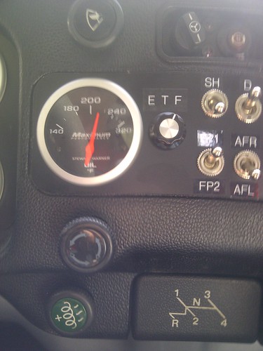

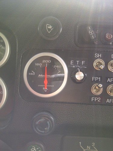

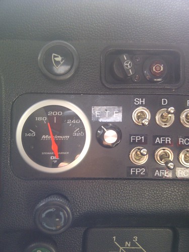

I'm getting closer to sorting out a solution for the temperature issue. Cutting off a portion of the forced-airflow through the duct has helped quite a bit. Here are the three sensor readings after 45min at 120kph:  (Engine at front pressure plug, Bottom of tank, , Feed into engine)
All sensors the same brand, but I on the next oil-change I think I'm going to need to pull them and confirm they all read exactly the same at 100deg C.  The engine temp reading lower then the feed could be a product of the location, the case temp or the sensor. At this stage I'm most interested in the feed temperature, and so it would seem that I have a bit of trimming to do on my cover plate. I should also order in some of those Dzus fasteners pretty quickly.

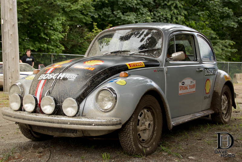

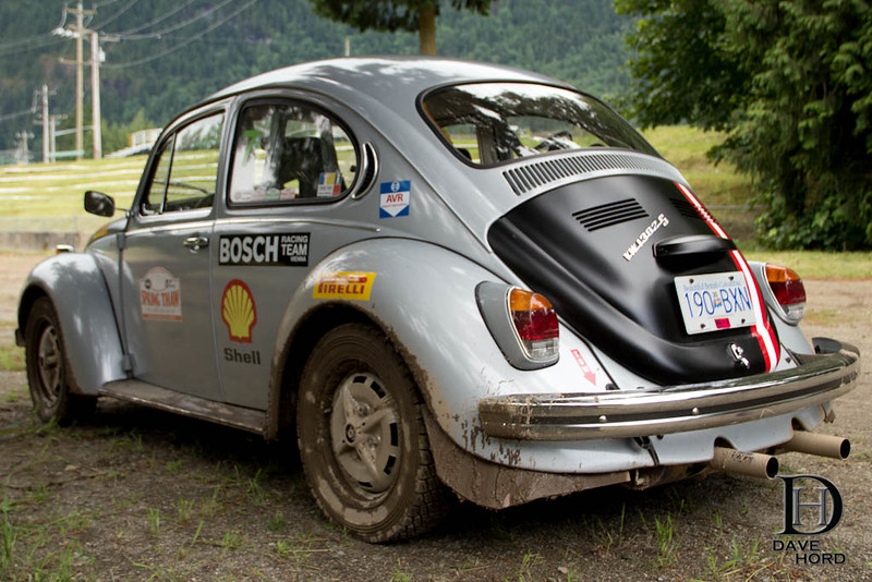

Well that was an interesting weekend! To date I've done about 100km worth of testing up on the local forest roads here in Squamish. Switching from an Audi quattro (All-wheel-drive, massive amounts of front end weight ahead of the front axle), to the bug is quite the challenge. I've been getting used to it up on the mountains, though I have to be honest it occasionally catches me out...let it get away from you and it will just spin regardless of what you try :P
Sunday was a local RallyX event though, so it was up at 4:30am and the three hour drive to Hope BC. Unfortunately I didn't wake up to my alarm, and woke up at 6am. Whoops! Lets just say the bug gets real light up front at speed, and I will be starting to look at front spoiler options :P Made it in time for registration, and even early enough to end up tech'ing the other cars. The course we've got out in Hope is pretty tight. Depending on the configuration you can get up into second gear, but it's down to first for most corners. Considering I have the 901 gear box with dog-leg first, and a pretty heavy lockout, dropping down into first gear isn't the easiest proposition. I made the attempt for the gear change on a couple of runs, sacrificing some syncros along the way. After a couple of laps I decided the time lost hunting for first wasn't worth the gain made in second gear along a short section. This, of course, was mostly irrelevant seeing as I was mowing down cones with almost every run.  With low momentum I just couldn't get the car to transfer weight under braking, resulting in understeer into corners. When it would transfer it would grab so hard I'd end up taking out the inside cone. Mostly humorous, but frustrating as I wasn't correcting my errors for future runs. Definitely need more play time in the tight stuff if I'm going to do well in RallyX in this car. Oops, isn't that one of the things I built it for? :P
For the afternoon the course was reversed, increasing the overall speeds significantly. For RallyX, however, the 901 as I've got it set just isn't precise enough for the 2-1 shift. Second gear really would have helped coming across the mid section, but I ended up just wailing off the rev-limiter in first. The back section was my arch-nemesis, a missed gate in run one...the same cone mowed down in the next 3 or 4 runs. For the last couple of runs I stopped caring about the back half and just focused on enjoying the first half where the speeds were higher. Figures that on the final run I finally cleaned the afternoon course with no penalties :P
While I wasn't able to link up a single run to my satisfaction, I did have some great "segments" where I was able to pitch and flick the car exactly the way I had planned. Essentially the stuff I had practiced on the forest roads was dialed...now I just need to back it down to some tight stuff and get re-learning for the Rear-Engine 2wd setup. Either that, or I need to find a larger venue so the courses can be faster! I'd love to try the car out on some rally-sprints, where the gear box wouldn't be an issue and you could really work the car over a longer, quicker, section.

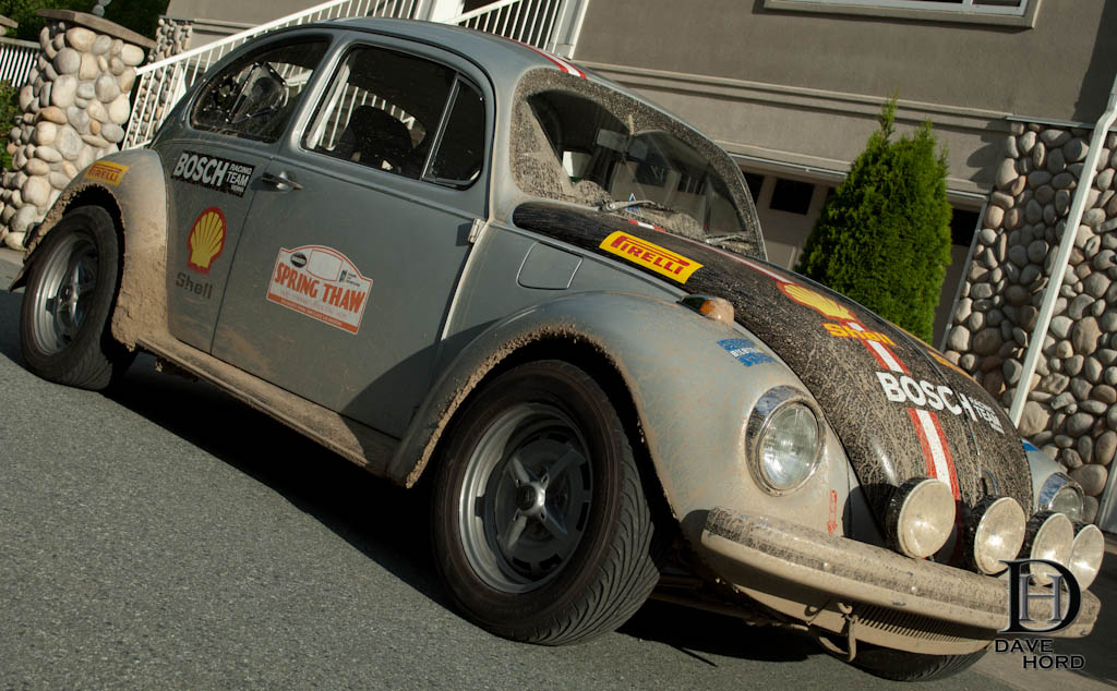

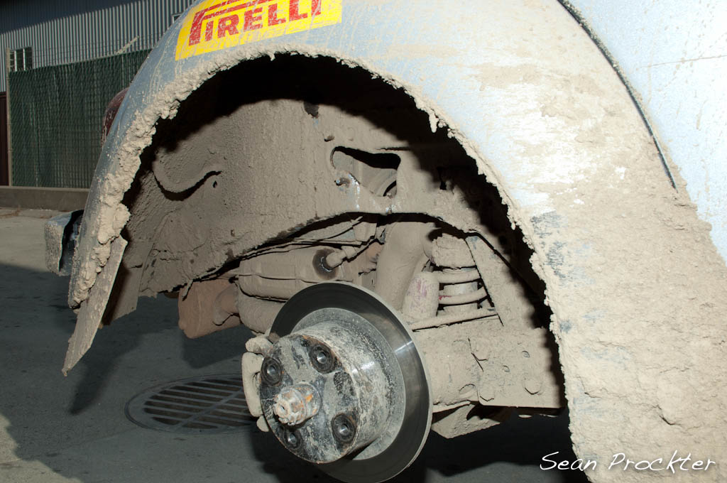

As you can see, the course was pretty wet...and the mud accumulation was incredible. After the morning runs...
...end of the day was a bit worse...
Rob was commenting on some different Tin he has to seal up the engine bay better. I think I'm going to take him up on the offer.

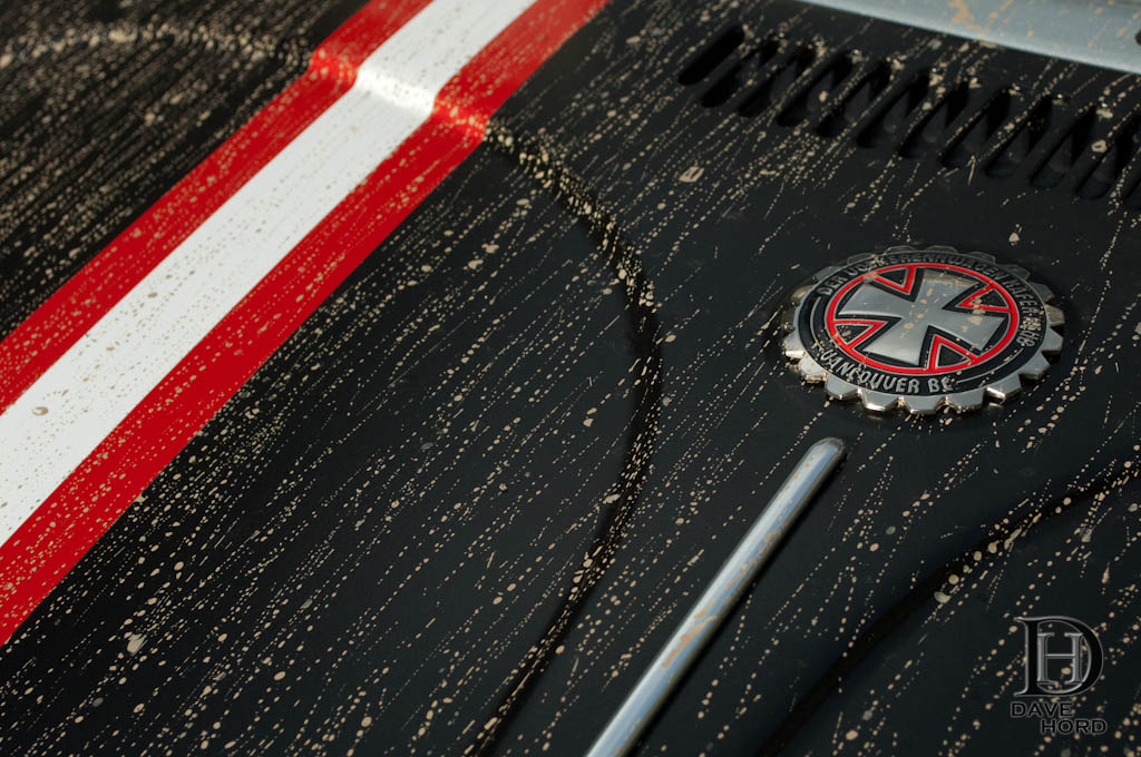

Pretty sure this is the first DVKK badge to be treated this way...

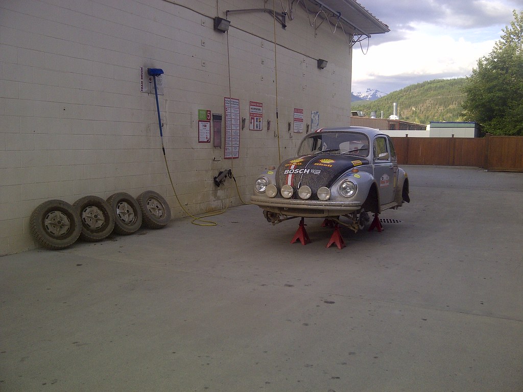

So, last night I figured I should start taking care of the cleaning process. I posted this photo up on Facebook with the question "this is normal, right?". #1 comment was the fact that "No Handwashing" definitely means no removing the tires and putting the car on Axle-stands!
...40min of pressure washing later, and I have *most* of the mud off the car. Seriously, the stuff was like concrete. Thankfully a buddy works at Sea to Sky carwash, so I had a semi-sponsorship last night!
 I'm not sure how I'm going to get it out of all the fender lips, but I won't leave it in there as it will just hold moisture and cause the fenders to rust. I guess you could say "stage one" of cleaning is complete? I anticipate an other 3 or 4 evenings to get the car clean. One to wash the body with soap and water as per normal, one to work on cleaning out all the fender lips and any missed areas on the underside, one to clean the engine bay and a fourth to clean out the interior. Racin' is hard work! haha

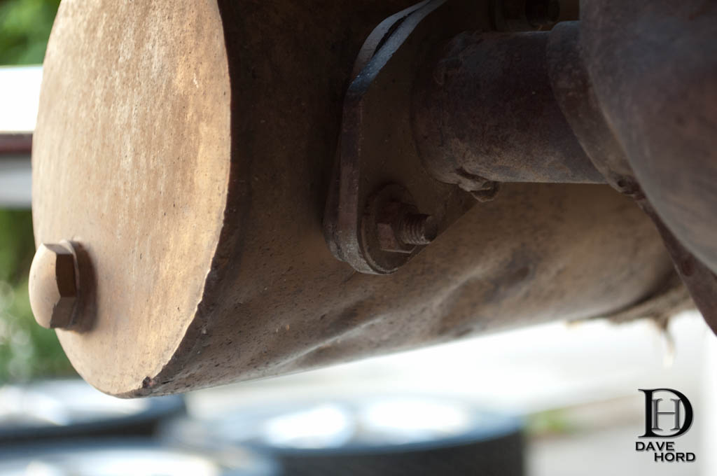

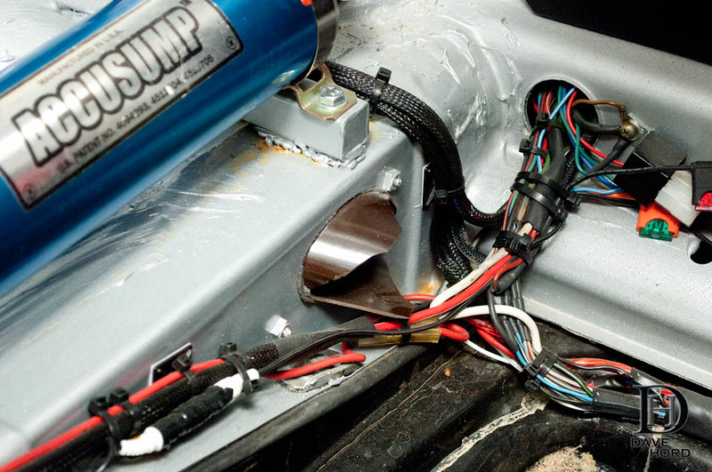

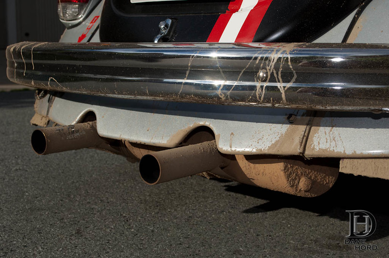

I did have two casualties this weekend while racing. The car performed absolutely flawlessly, and was only hindered by my driving talent and the gear selection. There is something satisfying about tearing the car on the rev-limit knowing you're just running it for exactly what it was built for. Back off? heck no!  I may consider trailering the car to the next event, only because there is such limited space for carrying the four gravel tires. The bakelight heater outlet was casualty #1 from loading tires in the back. As we all know, the body needs to be removed if I'm going to replace this. For now I think I'll epoxy the parts back together!  (and shhhhh...don't look at those welds)
The second casualty was on the Accusump. Kind of hard to tell, but the tire slipped back and crushed the pressure gauge. The gauge is bent back, and the face is broken. Accusump seems to be working fine still, but I'll need to swap out the gauge for piece of mind.
At the end of the event I was second in 2wd class, and 5th overall. The field was small, however, and based on my driving I have work to do before I would be "happy" with my performance. But honestly, who cares? I built the car to race it, and I was out racing it. That in the end is the important part. I was having a blast, and will look upon all of it's new stone chips with satisfaction. I've now got 6,300km on the build and will be busy scouring the Pacific Northwest for other events. Maybe a track day next so I can avoid the week of cleaning?

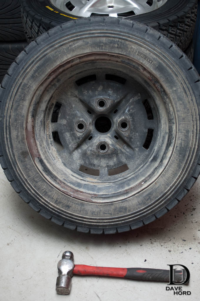

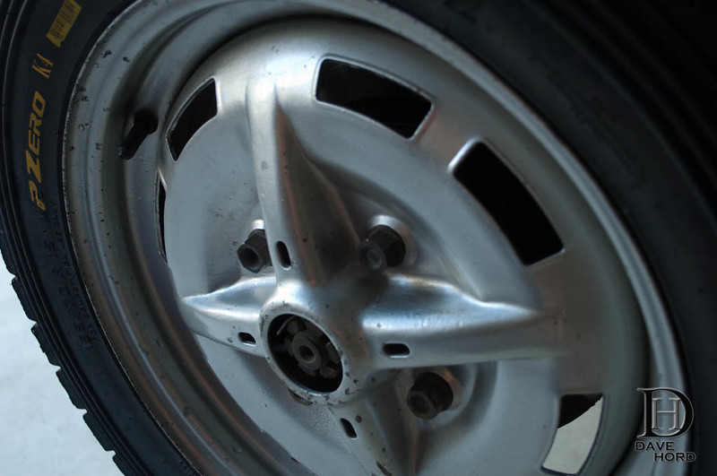

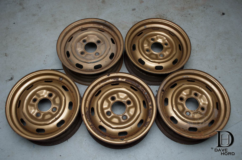

So I figured I better pick up a set.
I was hoping to sandblast and powdercoat them, but my friend's shop is currently "clean" for painting, and not messy for blasting...so the wirewheel, hand sanding and spraybomb will have to suffice for now. Once you run any wheels on gravel the finish doesn't last anyways, so powdercoating is really just lazy not better. Of course, the wheel purchase means I'm going to need to buy more gravel tires. As the set I have are narrows for use on the 4.5" wheels! These wider wheels would be perfect for my A032r's...but that kind of defeats the purpose of making the car fully period looking. Hmmm, maybe I'll just have to buy another set of them :D

i'd say powder coat is way better for wheels. my bajas rims were coated 13 years ago and the only damage is where a sharp piece of tire machine put a nice polished edge on the bead. heck, water still beads on them when i give it a wash every other year! that being said, if powdercoat starts to chip, it was a shoddy job. a proper powdercoat job will never chip, at best you can maybe "mash" it off with a sledgehammer. it will still gouge and scratch and mar up just like good ole paint. i'm not saying this to dispute you dave, its just i know there is a lot of hack job powdercoaters out there.
fyi, to get that water beading thing without ever waxing, you need to clear the powder with "tiger drylac" (german powdercoat company) and have it applied with a "tribocharging" gun, not the electrostatic " corona" gun. only tiger makes tribo compatable paints. the difference between the guns is the corona gun adds an electron to the paint molecule, and the tribo removes one, as it gets its static charge through the friction in the paint. the paint lays down WAY smoother this way

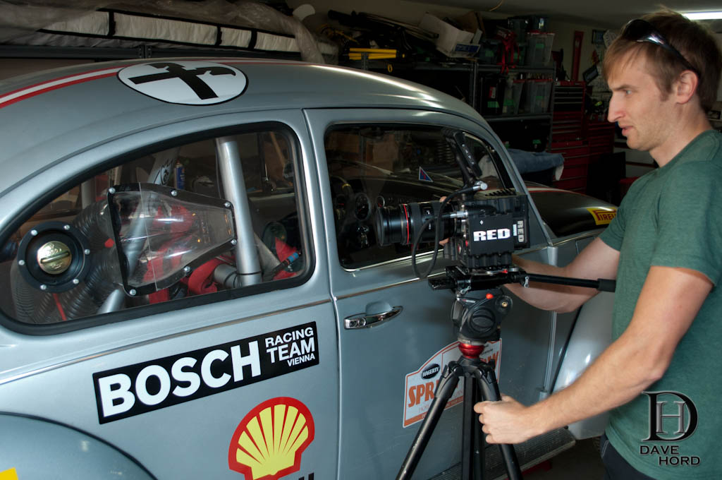

A buddy of mine does snowboard, mountain bike & outdoors films/videos, he and I have been talking about shooting the bug since it was a project in my garage. We've bounced around different ideas, but still haven't gotten around to doing anything. This past week, Taylor sweetened the pot the little with the addition of a RED Epic Camera. As if that wasn't good enough, his friends from Sea to Sky Cable Cams were looking to do some testing with a rally car. Hmmmmm....
Taylor's current demo reel.
Sea to Sky Cable Cam's demo reel.
For those who don't know what an Red camera is, think the Porsche GT3 of the camera world. It shoots in 5k, and super high frames per second (super slow-mo). To give you an idea of the quality...
Can't really turn down an opportunity like that!
Started off in the garage. David prepping a shot.
Later, Taylor setting up the Red as a POV cam. A wee bit bigger then a GoPro :P
Cable Cam rigging...
I won't have the video for a while, but will be sure to post it up once Taylor's had a change to edit something for me. In the meantime though, I did lap after lap of the section of road we had set aside. "faster", "slower", "can you put the car here?", "more show-ie", "that was great...we nailed it...better do it again just in case". Now I remember why I avoid video shoots! haha

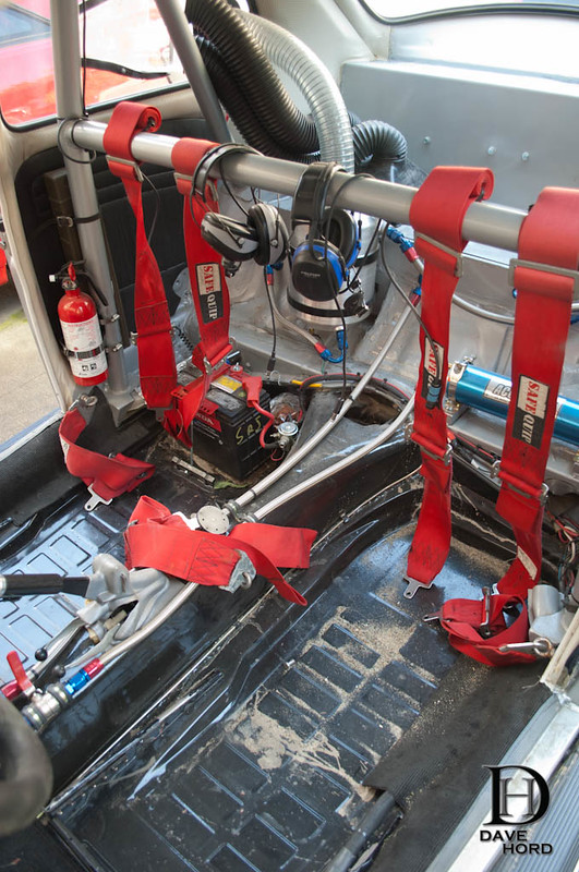

Today, it was all about clean up, damage assessment and check of all fasteners to ensure I hadn't missed anything else. I washed the car twice, first at the coin-wash to pressure wash as much dust and dirt off as I could, and then a regular hand wash upon returning home. The inside was filthy, even the dust had dust on it.

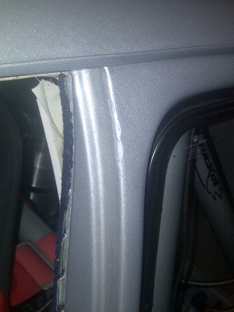

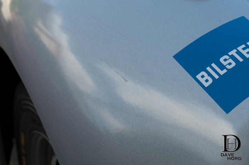

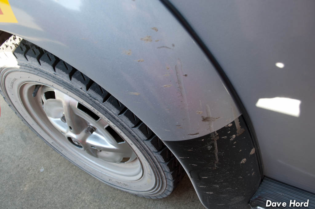

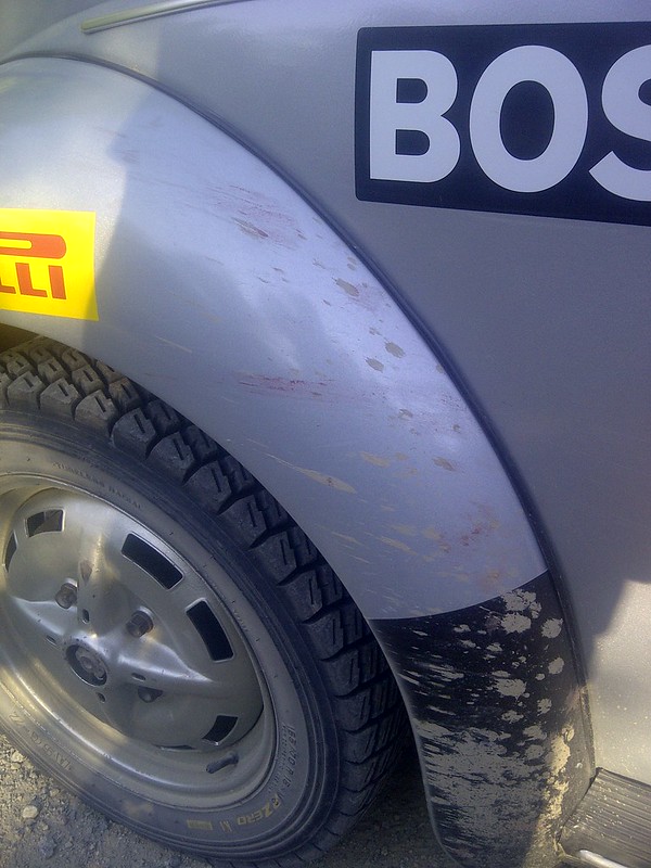

Once the interior was cleaned out, I started on the damage assessment. The paint on the wheels took the expected beating and chipping.

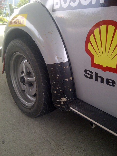

And the raspberry bushes left me with some passenger side stripes that I'll need to polish out this week. Hard to photograph on a silver car, sadly not hard to see in person though!
The gravel road isn't a polished prepared "loose surface" road designed for road traffic. We were using a logging access road, so the stones are bigger. Sometimes much bigger. But hey, gotta use what you got! The rocks do take their toll on the car though...

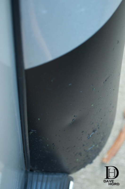

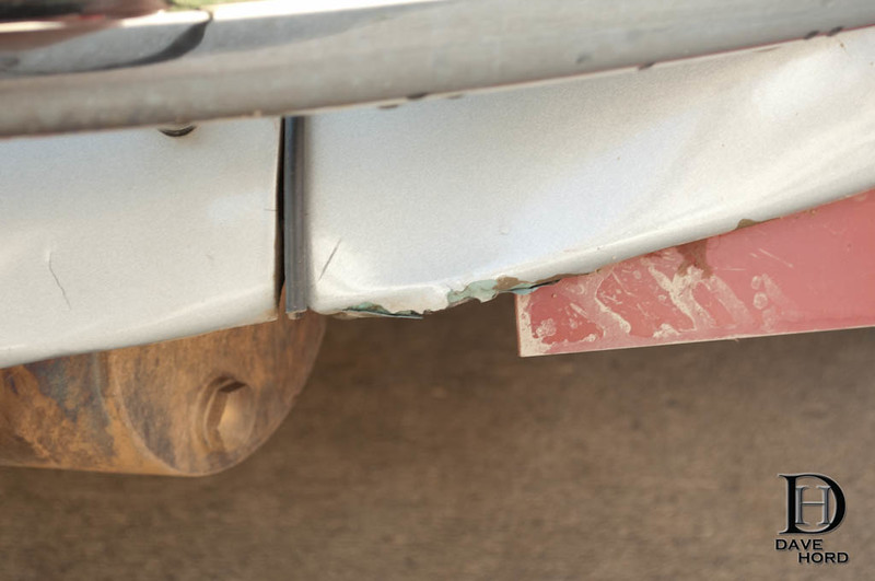

Slight dent on the driver's side rear fender...
Slightly larger dent on the passenger side rear fender. Kinda wish I had made that flap just 1" longer! The rock has completely crushed the lip of the fender and pushed it out about 1/4".
The muffler is saying "make the skidplates dumbass!"
About this time I was thinking to myself "why don't I build track cars?" And then I removed the wheels. Seems I might be switching to alloy wheels sooner then I had anticipated! This is the passenger rear wheel:
The passenger front has one small dent/flatspot on the inside edge. In true rally fashion, however, both driver's side wheels are 100% perfect. Why anyone chooses to be a co-driver I'll never understand. Now, initially I was a little down on myself for doing this, as i have to go find a replacement. But then I checked the wheel and it's holding air to the exact psi I had set it to. My friend Gord has repaired a number of rally wheels (steel and alloy) using a special tool, so really this shouldn't be so bad. I grabbed my copy of Gord's special tool, and went to work. Good as new! (or in this case, good enough :P)

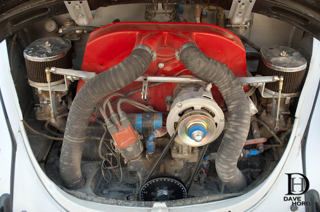

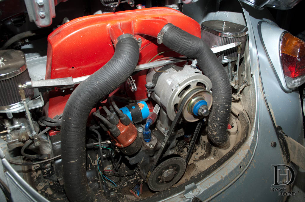

The engine bay is starting to look quite scruffy, but I have a gravel rally event before our local VW show..so I figure I'll do the full detail after that. For now it was just a quick clean to get the main dirt out.

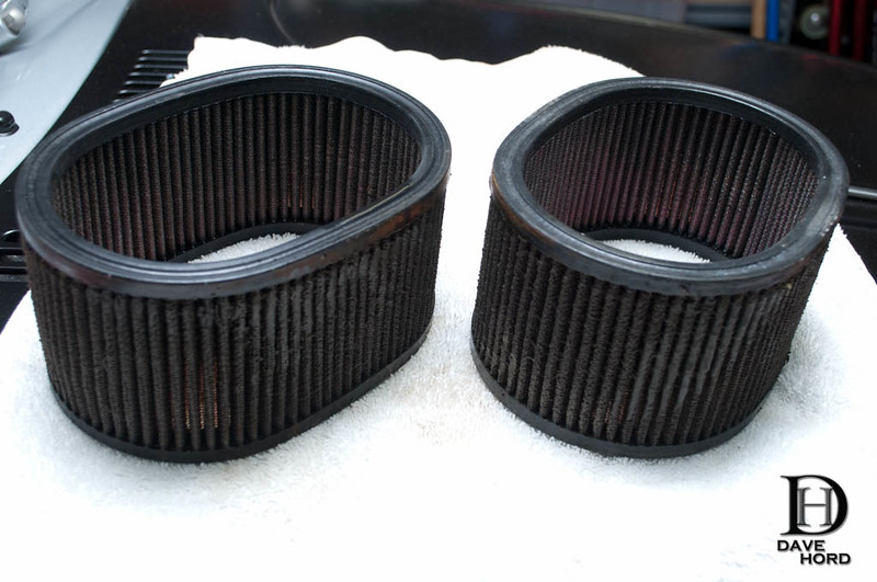

I did decide to do an airfilter cleaning, as they showed some signs of needing it.
Car is now cleaned, checked and ready for work tomorrow. Just need to pop the re-oiled air filters back on.
