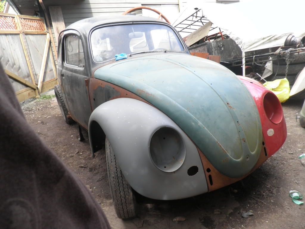

having finished my engine, i needed something to put it in, it just so happened that a friend of my dads saved a bug from the crusher a few years ago and we bought it off of him. After sitting for 6 or 8 years it was pulled out last Sunday. Although it is very rough and will take me a few years to complete, it was a very good 15th birthday present :)
the body is very rough and will need new heater channels, bumper brackets and a lot more sheet metal. the pan will also need work, i plan on buying 2 1/2 pan peaces, one for each side, to put on the rear sections.
when sitting this beetle was not doing nothing, it was housing a family of rats, that was fun to clean up...
any way lots of work ahead but here are some pics to start.

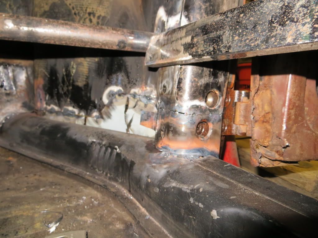

i did a lot of work of work on my pan today, I finished fitting and tacking in the battery patch that came with the car and also fitted and tacked in another replacement panel
hear are some pictures
tomorrow i want to finish welding them in and clean the welds as well and get started on the next patch

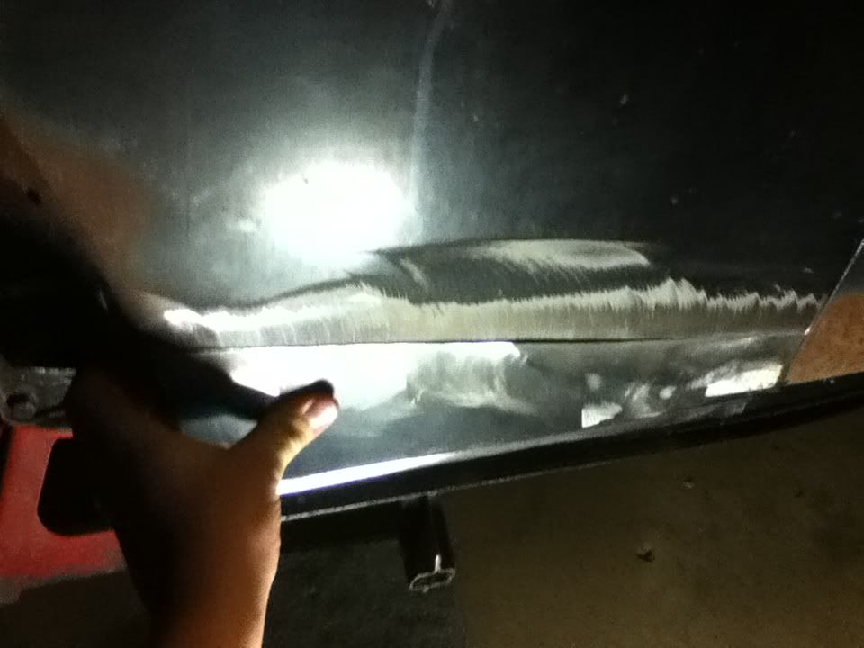

lots of progress has been made on the '60, i have so far replaced one heater channle and almost every thing that would be welded to it...
here are some pictures

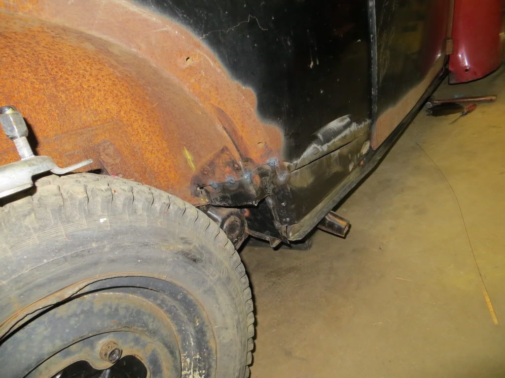

Nice work! That rear apron slice looks like a pain in the butt. Just wondering why you didn't just do full pan half replacements?
Sucks to your assmar.
Offline Kevin K
  • Posts: 111
  • Karma: 17
Re: 1960 "BIG" project bug
« Reply #28 on: August 13, 2013, 09:42:56 PM »
If I could do it again I would do the full pan half’s
when me and my dad first looked at it, it looked completely savable but I kind of opened a can of worms with a lot of unexpected rust in front of the passenger seat railing but I finished it and its solid now so I will serve its purpose even though it isn't the prettiest pan around

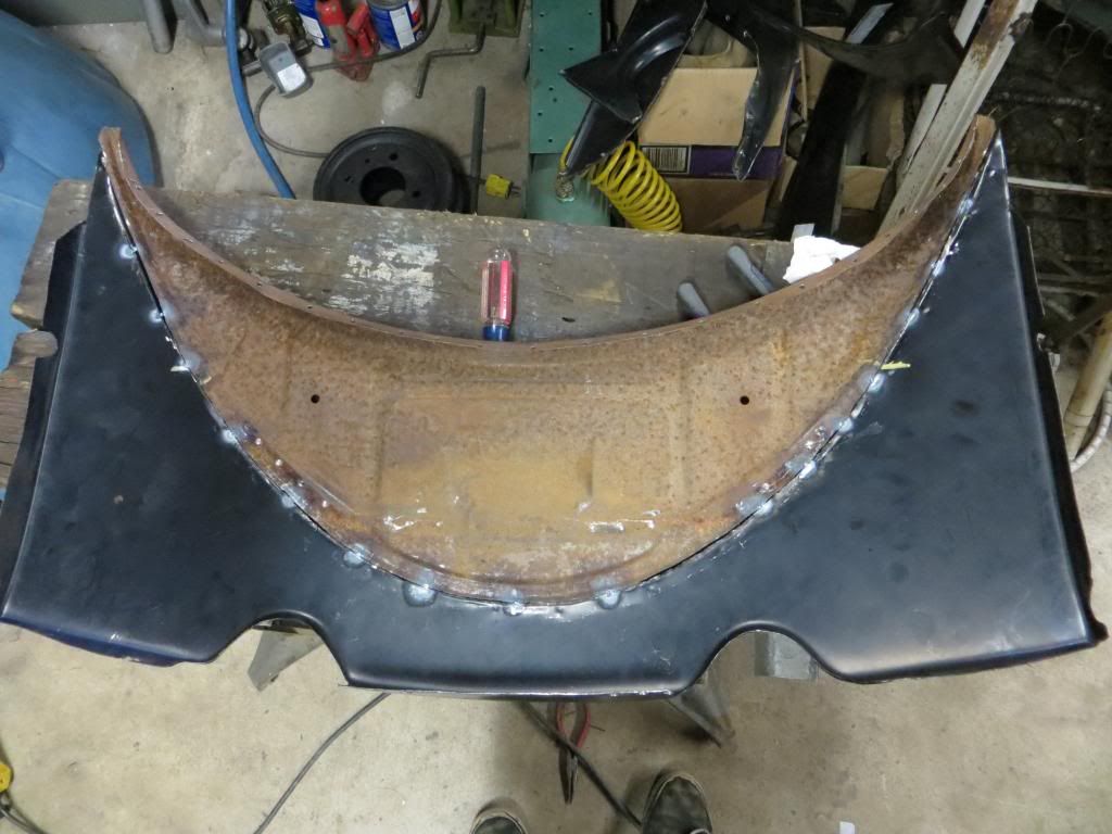

so I ended up welding up the rest of the apron and it is really looking like an H apron now, after it was welded I took it to school and did a little sandblasting and gave it a quick once over with some rust remover
I also have been working on the front apron, specifically the spare tire holder. Me and my dad decided that the original metal was to beat up to save so out came the angle grinder and torches and I replaced that section as well
