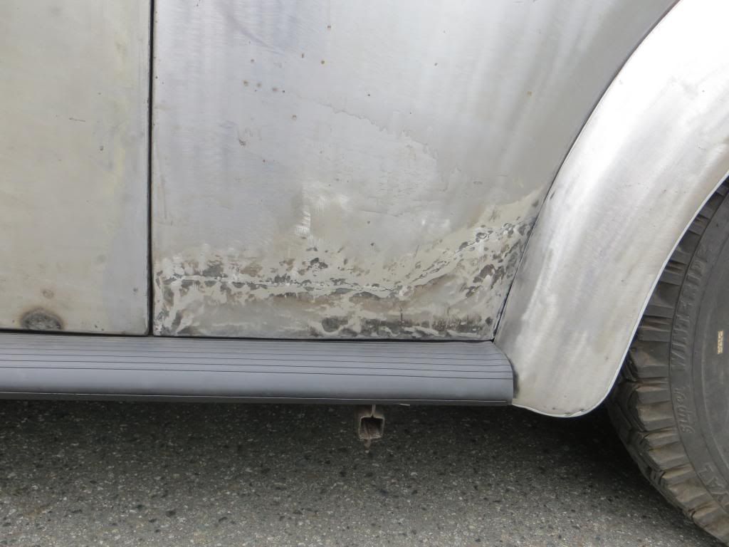

Since the last post I have gotten my car back home where the work continues
Last weekend me and my dad went to what is now called icing on the car but was Canadian auto restoration to do some sand blasting on the car
Luckily their weren't to many surprises just a few spots in the doors but no big deal
Here are some pictures

no thats ok
I dont think its too bad
the picture makes it look a lot worse so I should be ok
thanks though

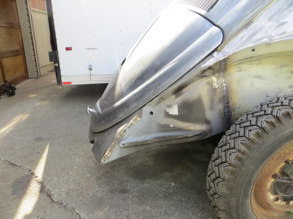

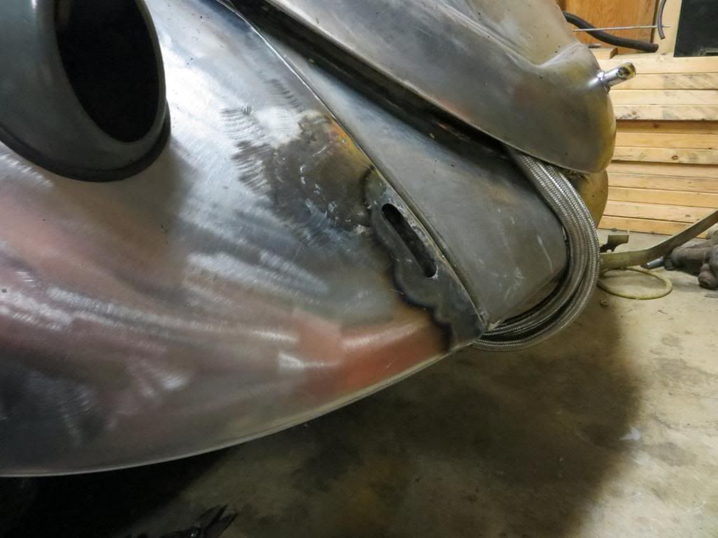

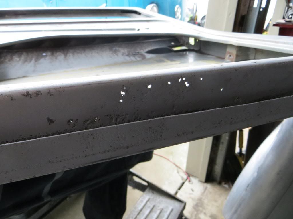

Quick update on the car, I was able to weld up the new bumper bracket sections last weekend, and it came out better than I had expected. There is so much space to work around the area I was able to really hammer weld and flatten my welds out while it was still hot instead of reaching around doorposts and what not
This picture was taken before I did any grinding
« Last Edit: January 24, 2014, 12:26:16 PM by Kevin K »
1960 bug

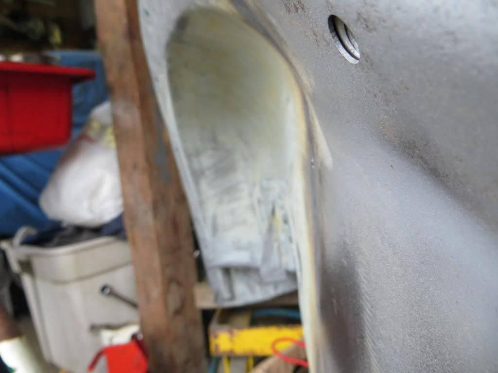

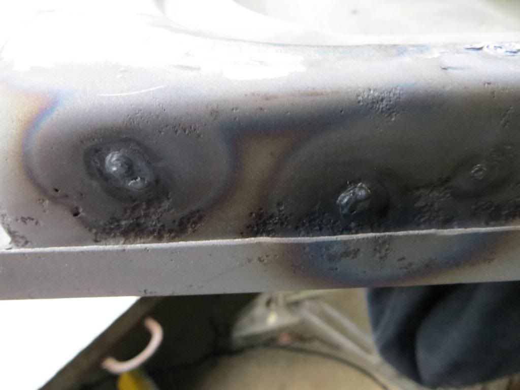

Been doing lots of work on the '60, specifically on the rear apron
my dad has had an old spot welder for years but we never used it because it had no plug, so my Opa helped me wire it up and to my surprise it worked, it worked very well in my case because the welding ends are not in a fixed I will add a picture or two instead of explaining it. So the rear apron is fully welded on after playing with the location of the deck lid and apron to get it latching properly. And now the engine seal shelves are getting welded in after getting my engine in it
Each step is a step toward paint, getting close now
heres the spot welder
here are the ends, it can get a little tricky lining up the ends but handy for getting lots of weird places
I'm really happy with the way the whole rear end ended up
the spot welder actually went through my weld through primer
« Last Edit: April 27, 2014, 10:26:13 PM by Kevin K »

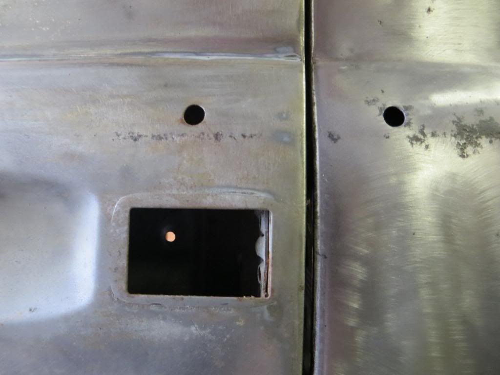

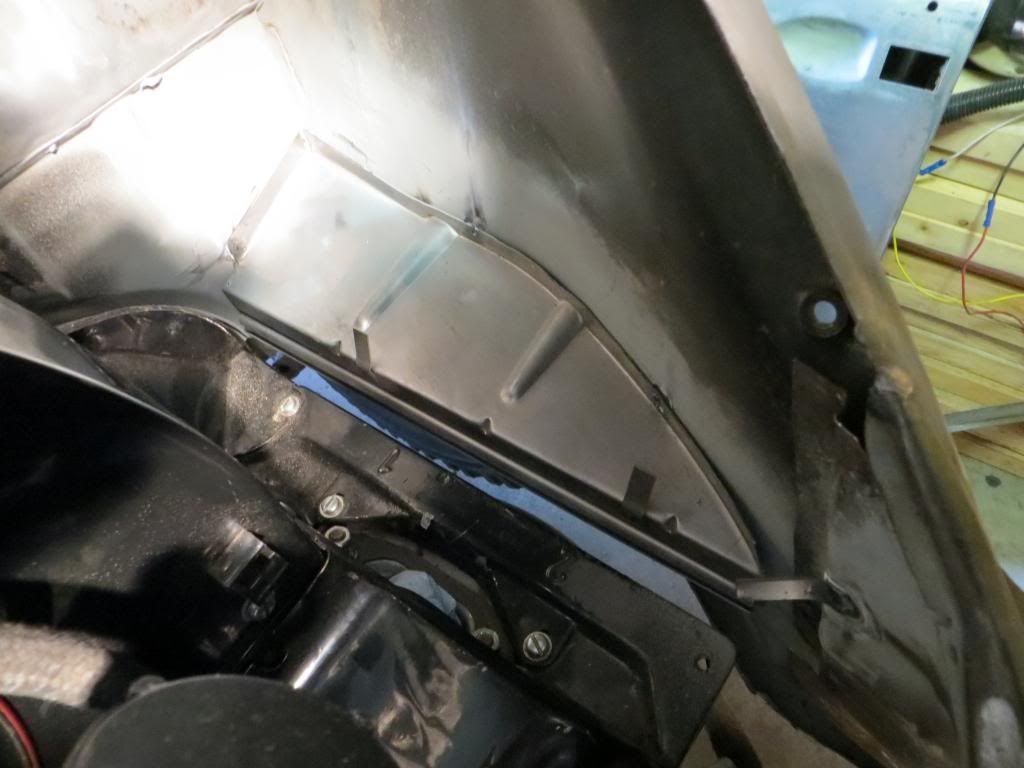

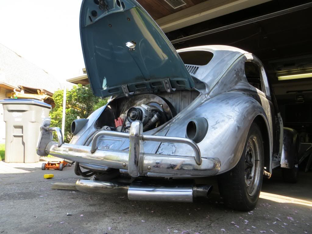

Ok, so lots more work done on the bug
I had to make some C channel for the engine seal tin on the apron, I ended up doing that at school and it turned out very well, almost looks factory
I finished spot welding to new engine seal trays
After I got my engine in I threw my new fenders on and get the tail lights on, it’s really starting to look like something
After I got it all on I noticed that my apron had more of a curve then my fenders did, it was unacceptable so out came the tin snips and torches
Turned out pretty nice
It definitely fits much nicer
Then after looking at the back of my car for so long I noticed the tail lights looked funny, turns out that the driver side was 1/2 inch higher than the passenger so I welded the old holes and made new ones to imitate the other side
Now it is better

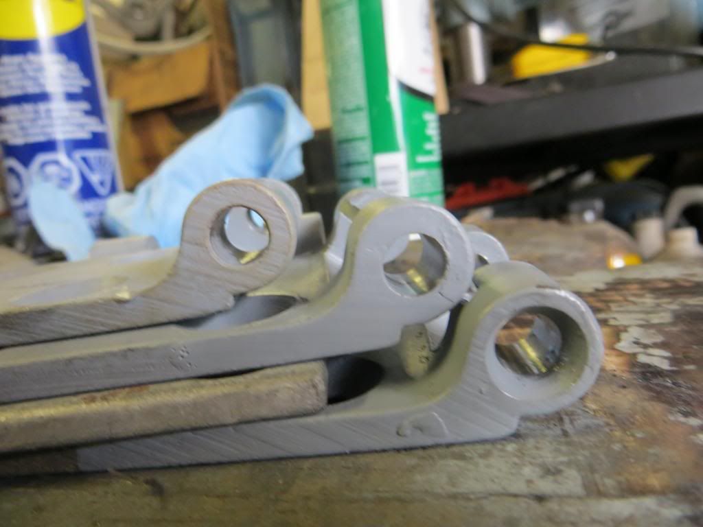

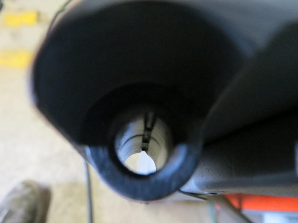

After that my dad and I reamed my door hinges for the pins
These pieces are 1 thousandth over the pin size
And the door is 1 thousandth under
Got the doors on today and it looks really good
1960 bug

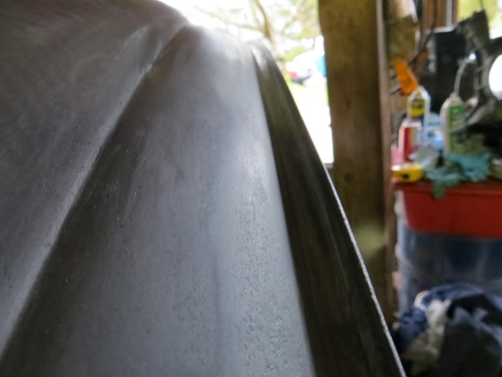

My dad and I hammer welded the 1/4 panels and got them nice and straight, I also finished the mock up of the car last weekend
just a few last things here and their and its ready the get some colour

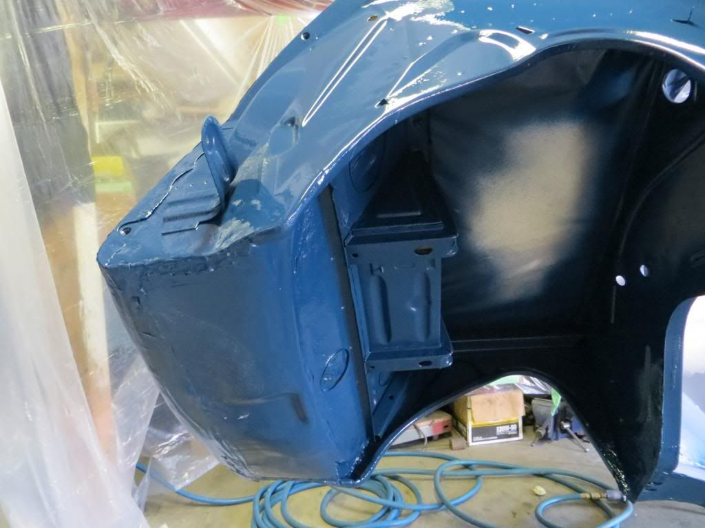

this weekend was a thrash to get some paint on the underside of the car, thanks dad for spending your whole weekend in the garage with me, couldn't of done it with out you
ready to go to the paint shop now to get the rest done
epoxy primer
their it is in base coat, sitting on the jig my dad made to get the under sides
clear
