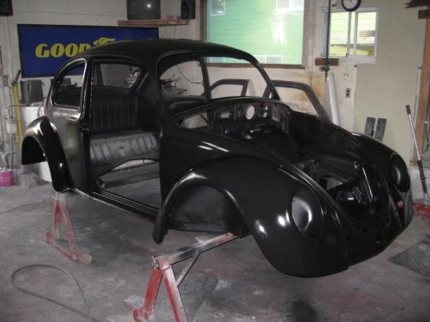

In primer!

« Reply #4 on: November 14, 2009, 08:49:12 PM »
its not flat black its satin O0

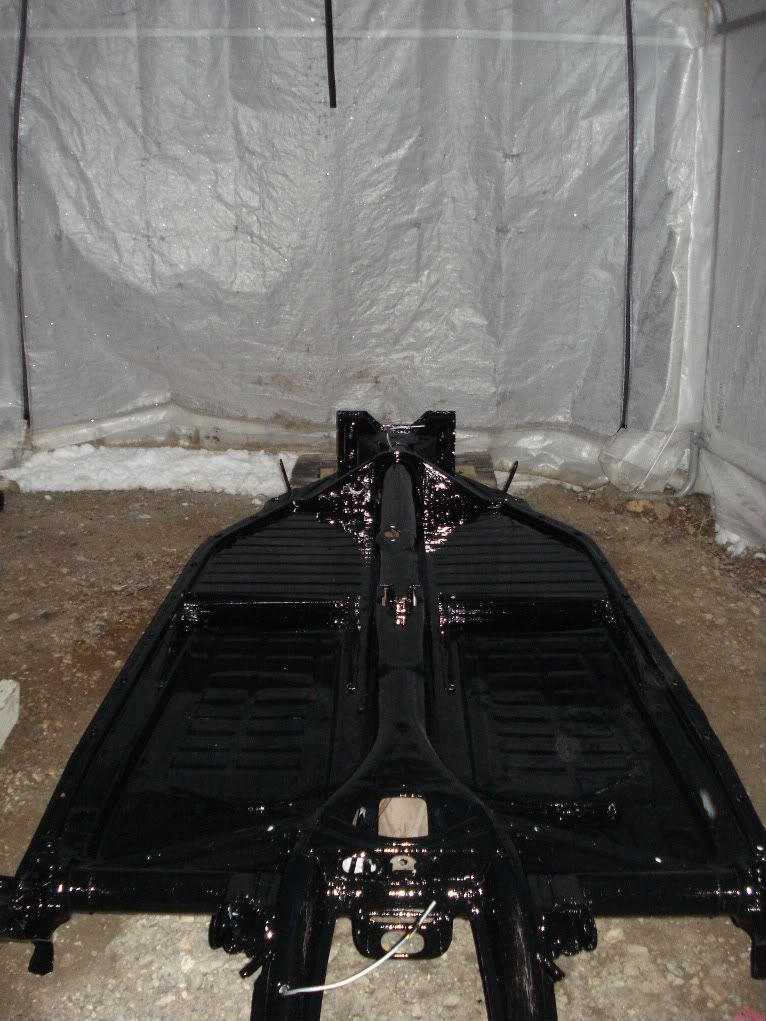

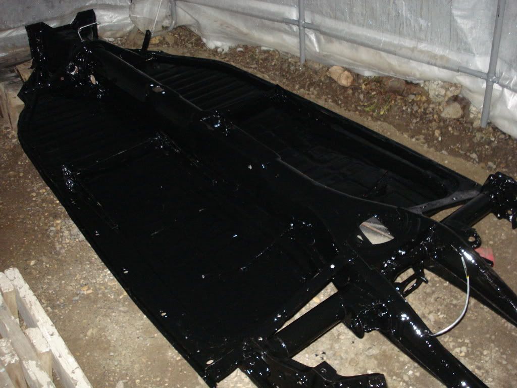

Pan is painted after sandblasting, and welding in a clutch tube.  Turned out i had bought an auto pan without the clutch tube, but i only figured that out after I sandblasted it.

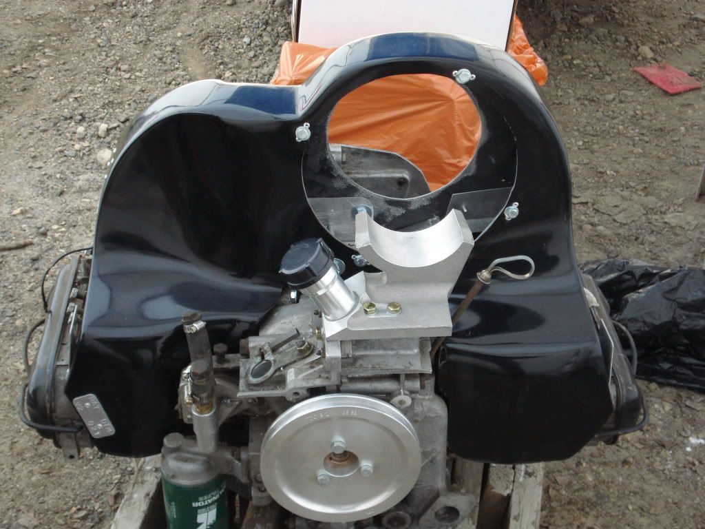

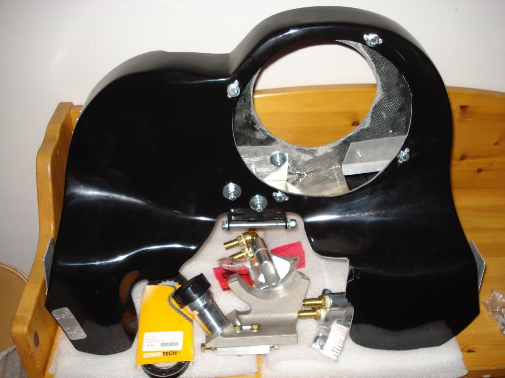

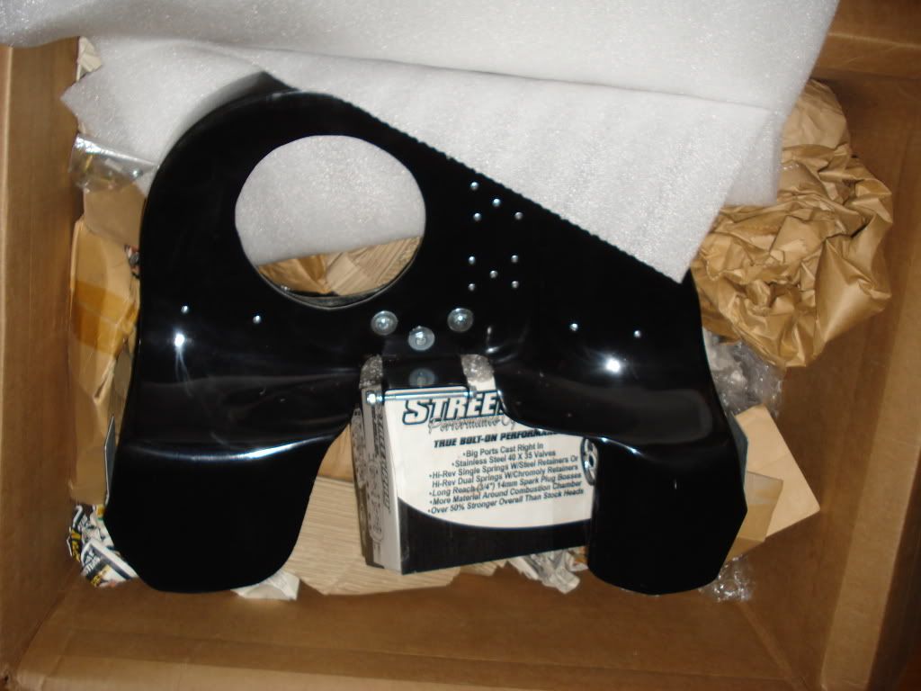

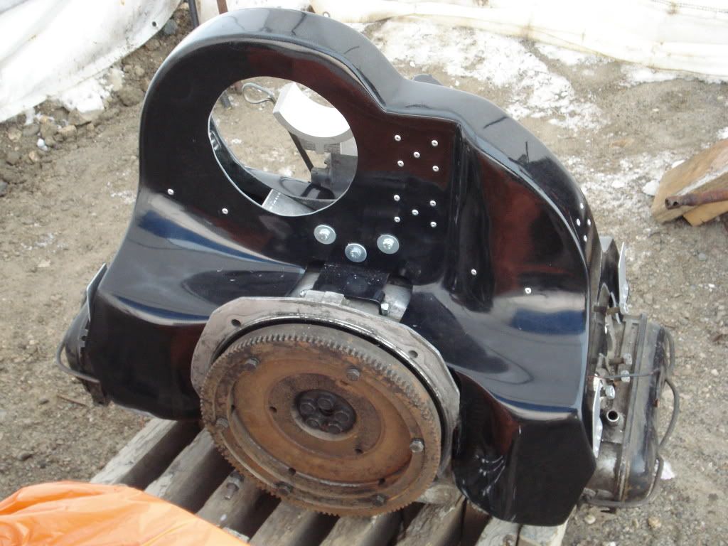

My  DTM. For some reason in the middle of 5 years not thinking about aircooled cars i bought it.  Finily today I took it out of the box and fitted it my motor.

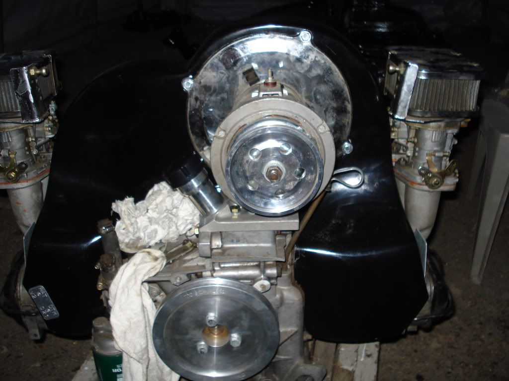

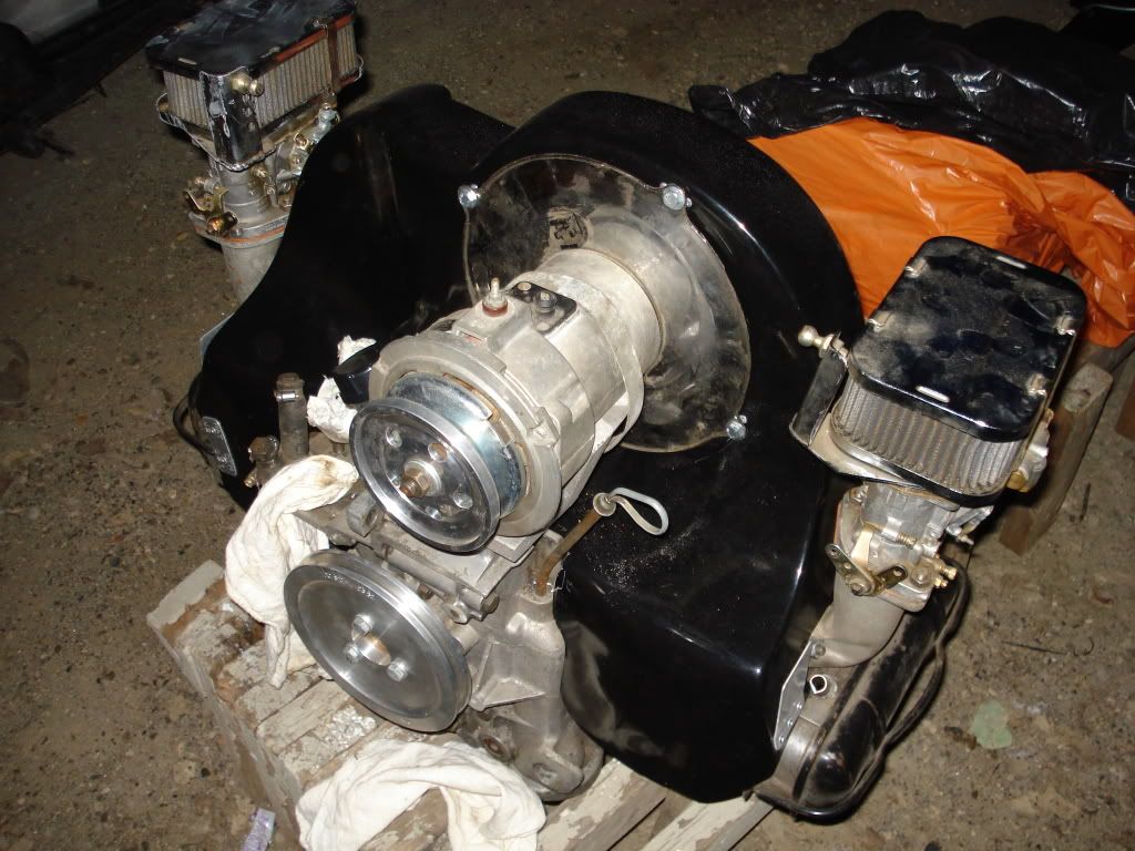

got the carbs on, ran into a little snag!?!?!?!? :-\

I fell off the wagen of bothering to update ASF or FB :-X.  Since the last posts I've recieved in-take spacers to fix the carbs hitting the cooling tin.  trying to get my beam together.  having a little trouble getting the camber adjustment things off the ball joints to replace the rubbers.  I just have to go borrow a 3 point puller.  I was going to re-drill my disks and drums to 5-130, but I think I'm just going to order new ones from CIP.  Its going to be low, 2.5 drop spindles and adjustable beam.

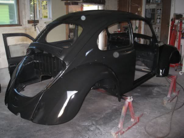

« Reply #13 on: February 08, 2010, 09:23:10 PM »

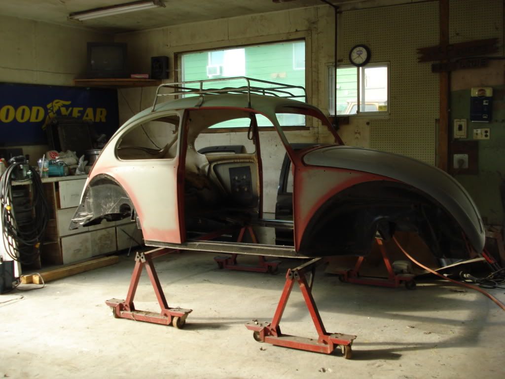

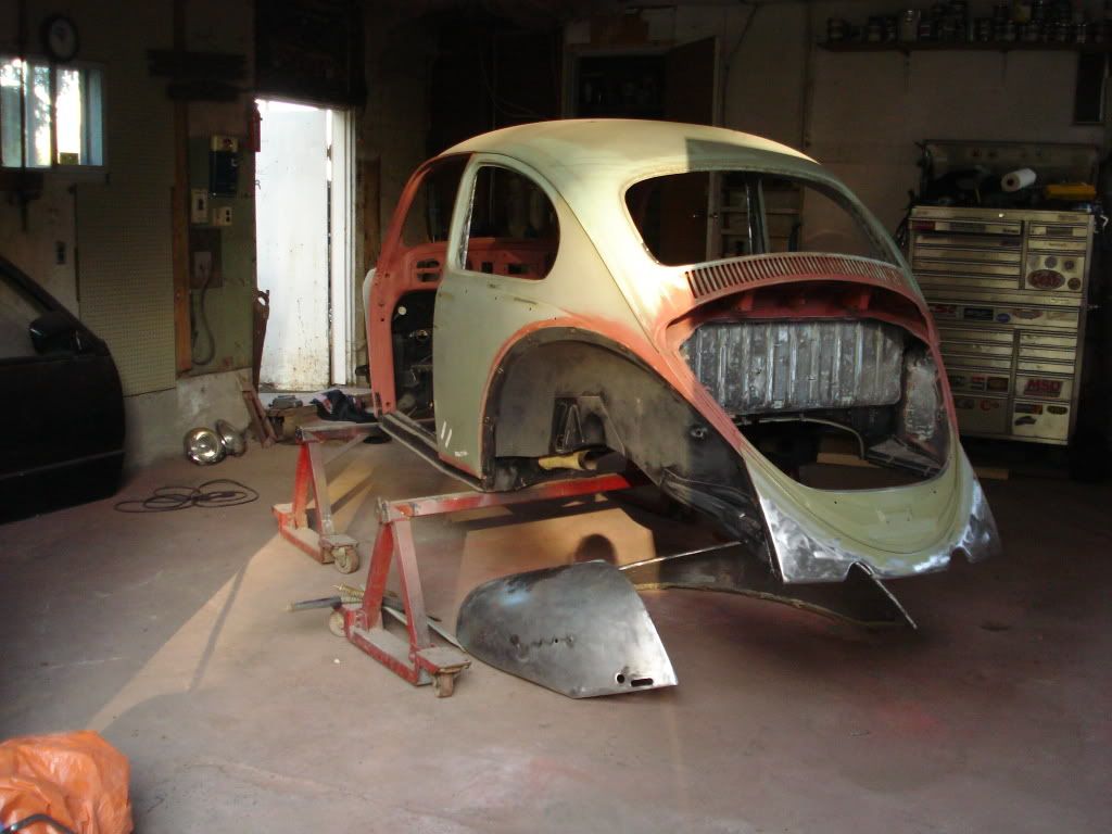

got the body home!

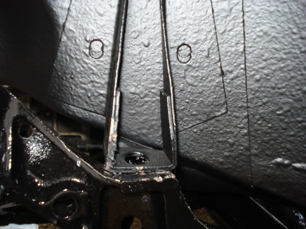

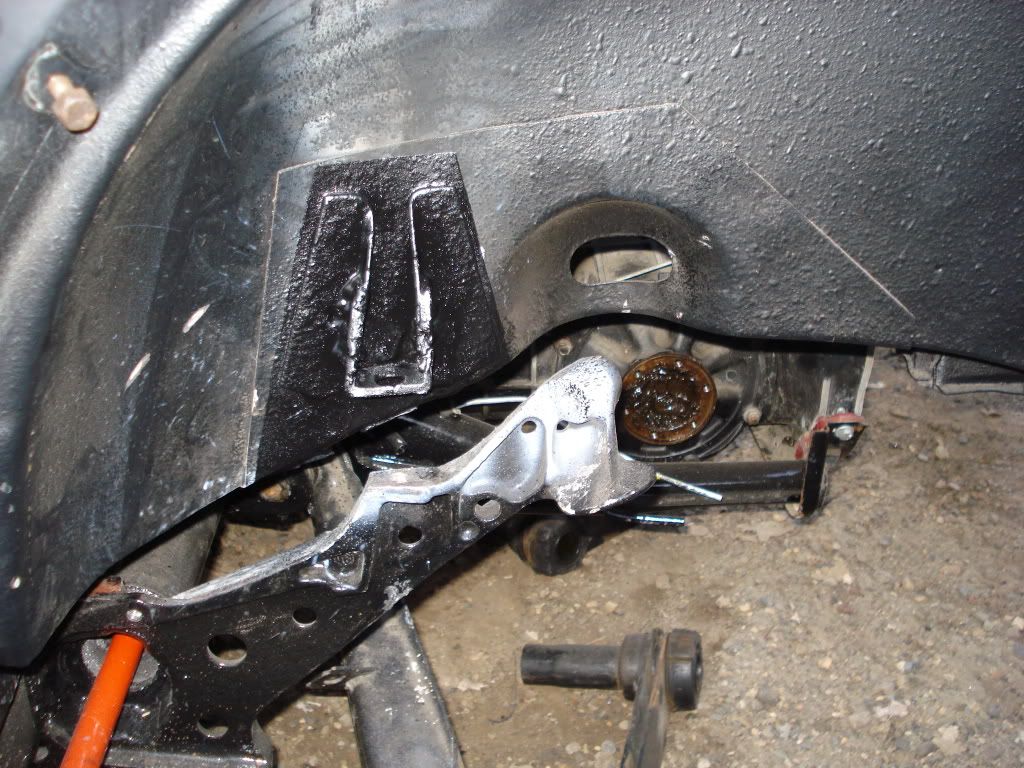

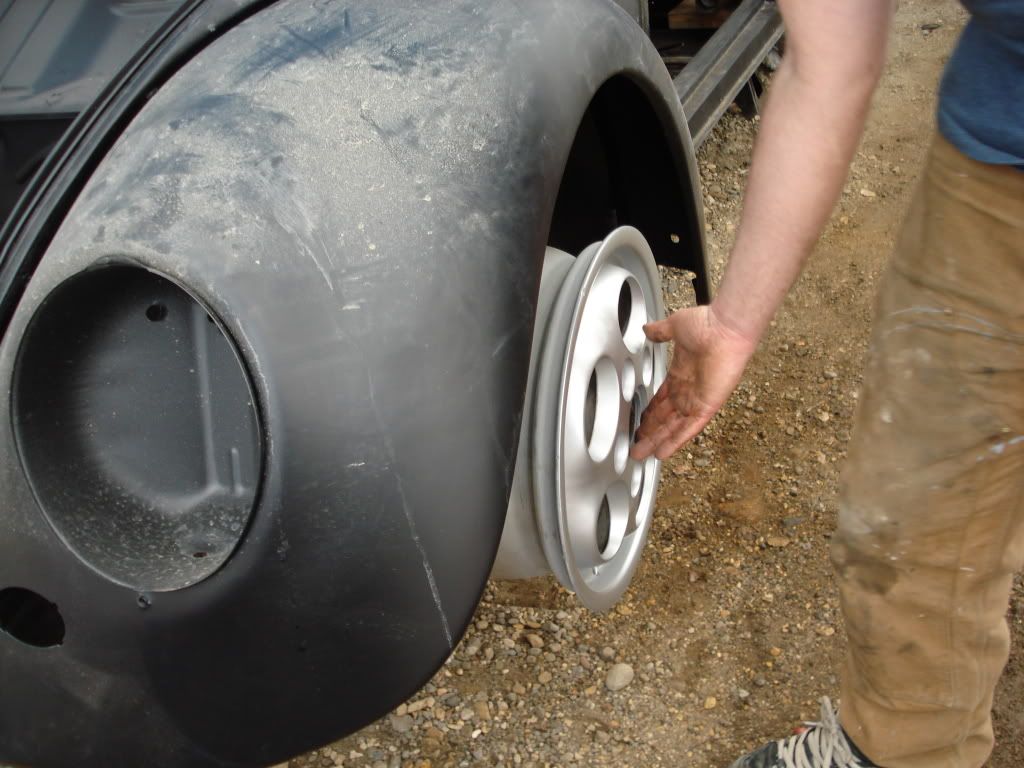

Had some trouble with the rear body mounts holding the body off the pan.  But its fixed.  And test fitting the phone dials in the front.

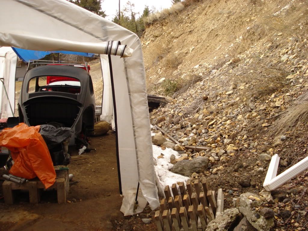

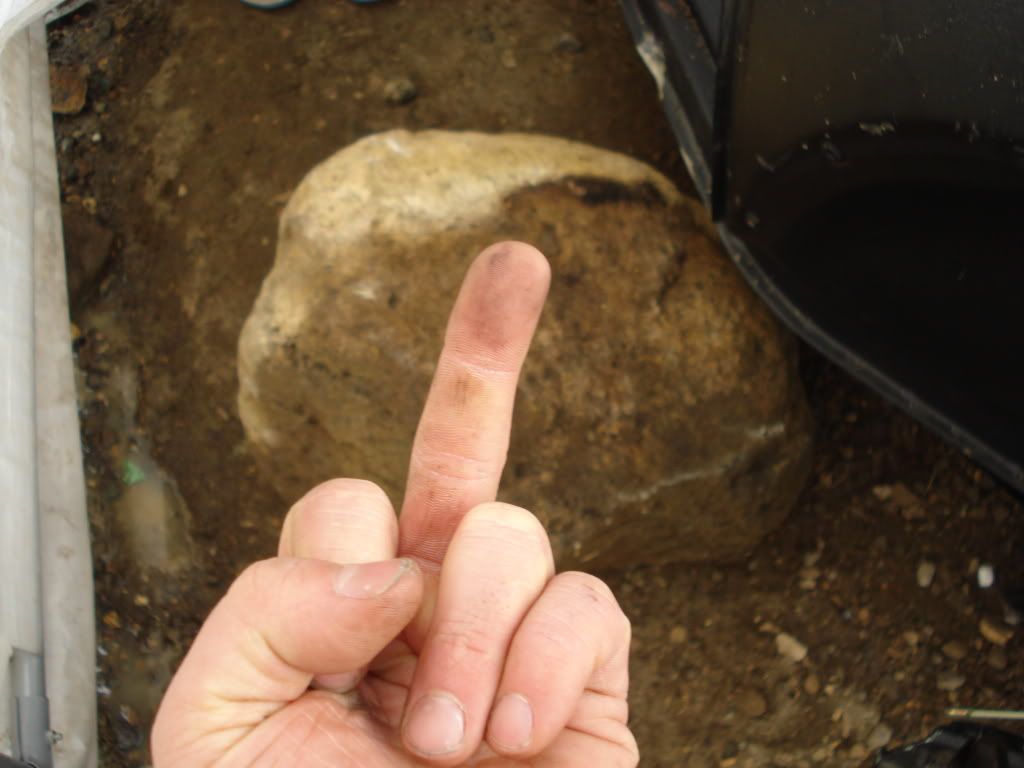

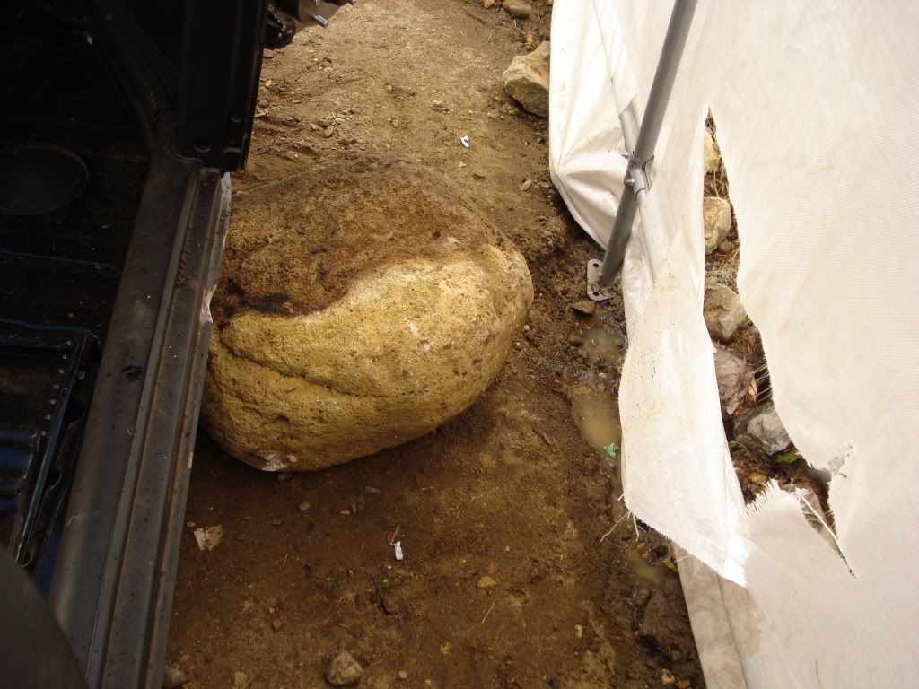

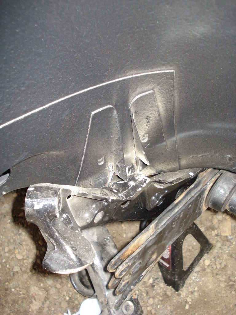

what looks out of place in this pic???
maybe this?

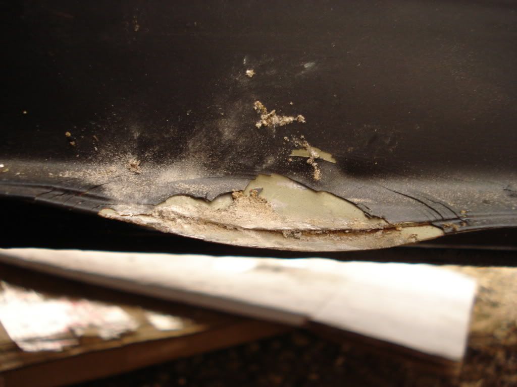

A big "f"ing rock...  this is what i think of this rock!
Once my eyes turned blue again (rather than red) i realized that the damage will be coverd by the running boards.  And if the rock would have came down while i was bolting the body to the pan last week i would be dead!

« Reply #18 on: February 25, 2010, 07:37:55 AM »
That sucks!
Retaining wall maybe?
Ya looks like I'm going to be getting some railway ties from work.  The car test has been there for more than 2 years without a problem.  As much as it sucks it could have been alot worse!

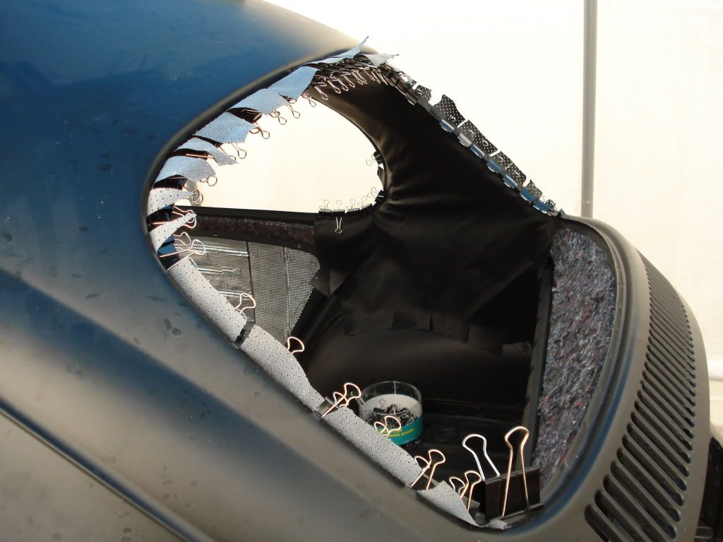

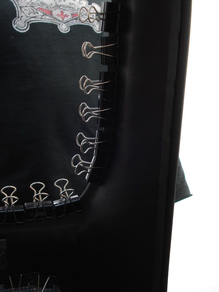

Headliner is in, not perfect, but not bad for my first one.  Breaks are coming together; the next time I run break lines I'll do them before the body is on.  more pis soon...
