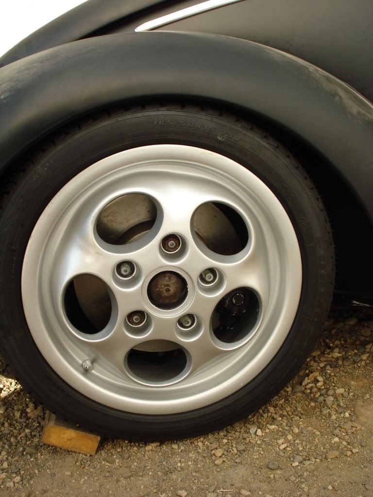

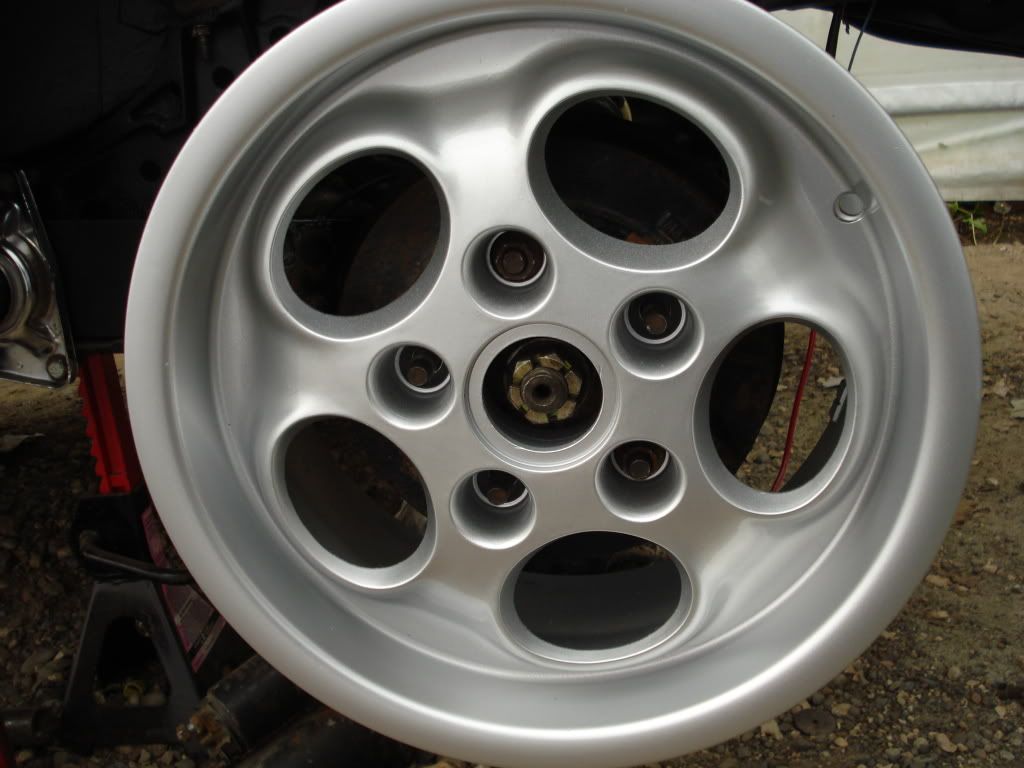

Rims are painted, thanks Alisdair

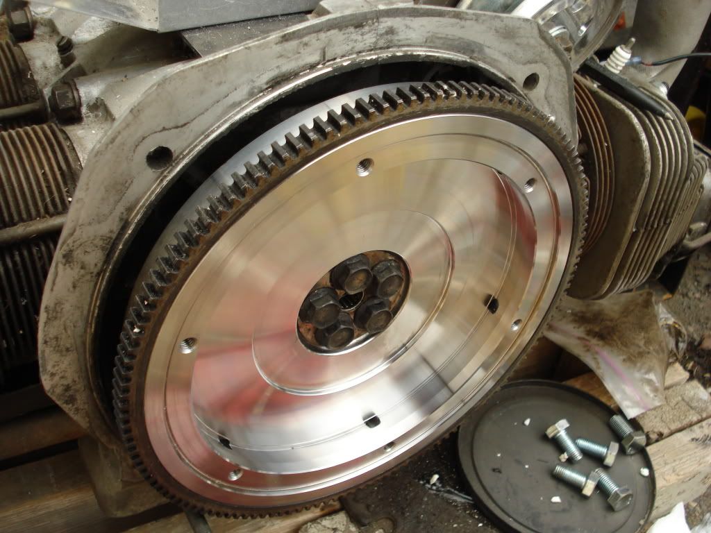

Type IV conversion flywheel finaly arrived 2 months after I orderd it

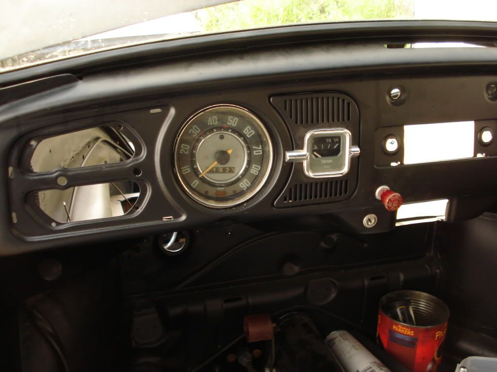

a few of the dash bits set into place while I figure out wiring
My rims seem to to be hitting the lower ball joint, I think if i put the stock spindles back on it should move the balljoint away from the rim, I think at this hight the tires won't be on the ground anyways.

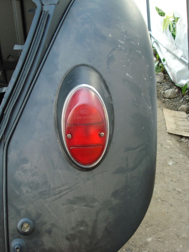

One tail-light!

If the interference is only slight, get the grinder out and profile the ball joint a bit.
Could it be that easy? how much clearance does a rim need?

Indeed.  A couple of mm should do it.  You can also skim the wheel too.  A wheel spacer will also give you some clearance since the wheel's profile there is tapered.  When you're done, take your sharpie and mark two circles on the wheel where the ball joint is really close.  When you get your tires mounted, tell the guy he can't put any wheel weights in this zone.

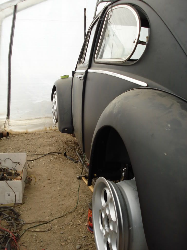

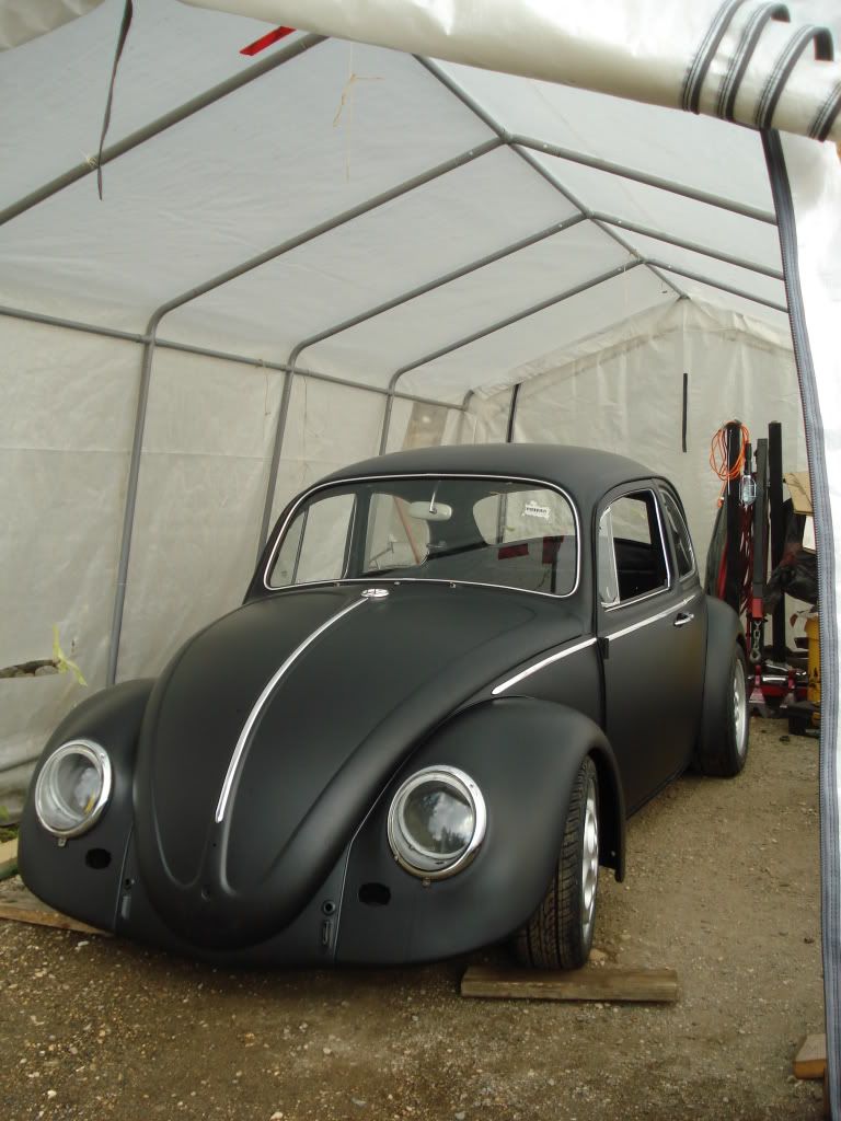

put the wheels on today! its LOW!!!
And I put the flywheel on the motor, however I bought the wrong Pressure plate so I have to wait untill the new one gets here to put the engine in  :'(

Tomorrow I get to push it out and wash it finaly!!!
yep...just did that today.
As for the wheel weights issue, I'm using 4oz of airsoft pellets in each tire and no weights at all on the rims. You can buy beads specifically for the purpose, but a friend in Cali swears by using airsoft pellets. I couldn't fit weights on my wheels, so I figured it was worth a shot. Works like a charm, and honestly balances the tires out smooth. There are a few quirks though...they unbalance on a hard bump, and take a few hundred meters to smooth out.
I used a pencil to put a circle on the rim and they were able to balance the wheels without a problem.

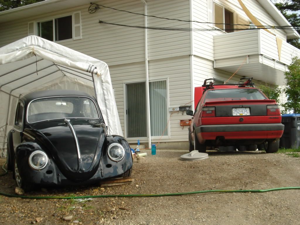

before
the bug makes my por neglected jetta look so big, and dirty
and after the wash

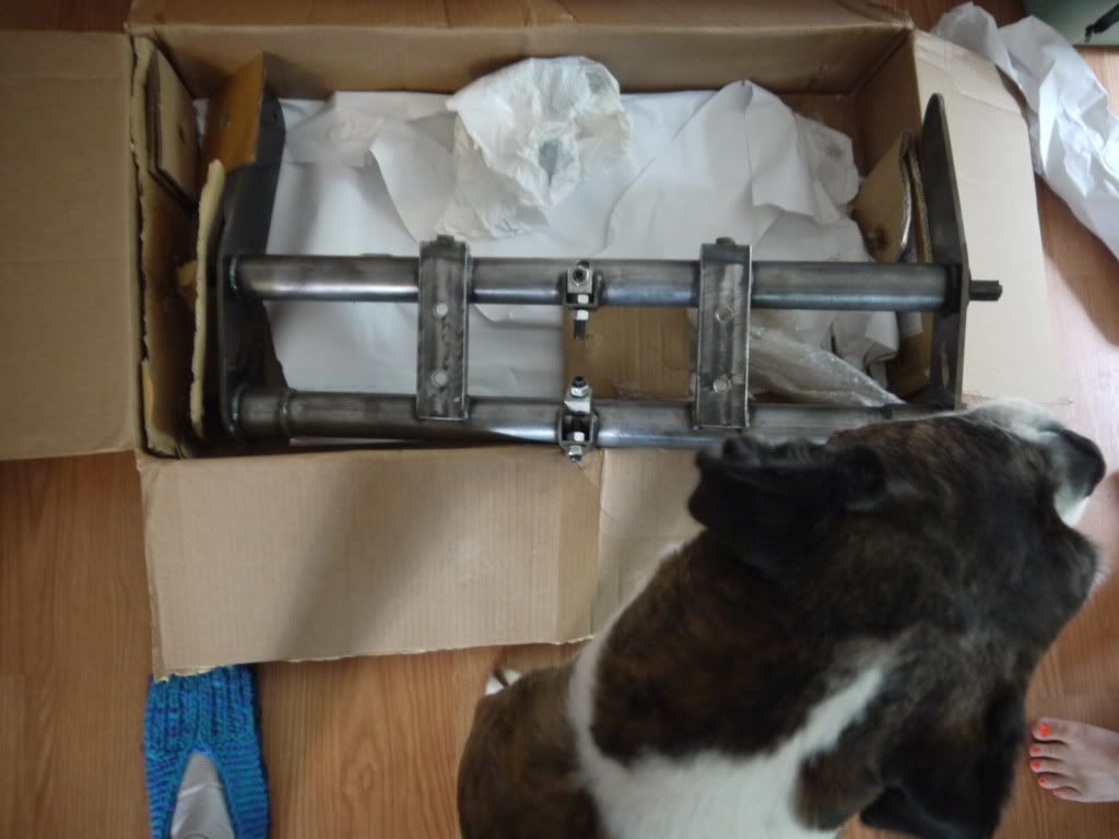

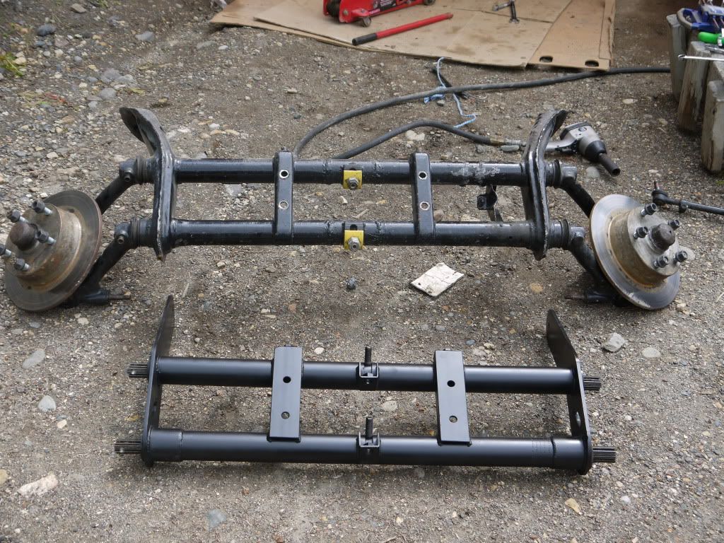

Got some more lows. 4" narrowed beam with shock towers that use linkpin shocks. put in the car with 2.5" drop spindles and 1/2" spacers so I actually have a turning radius. Next i need to lower the rear more.

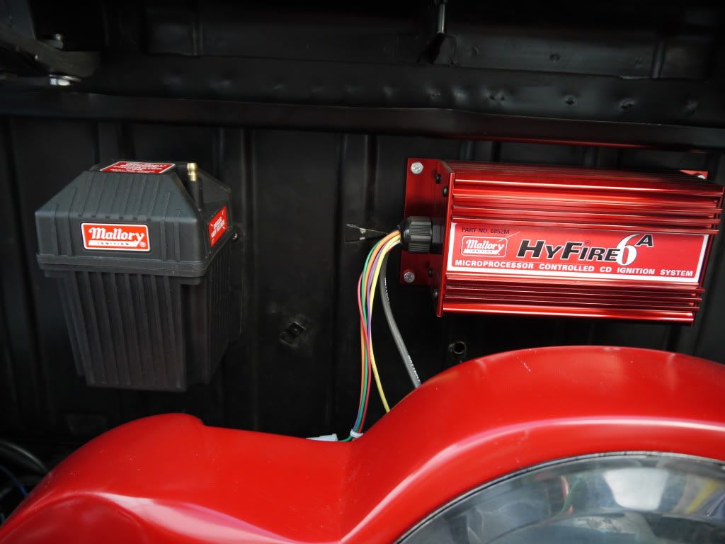

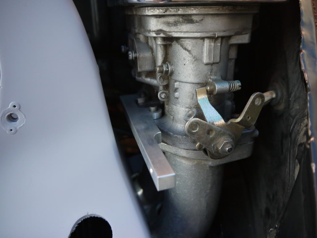

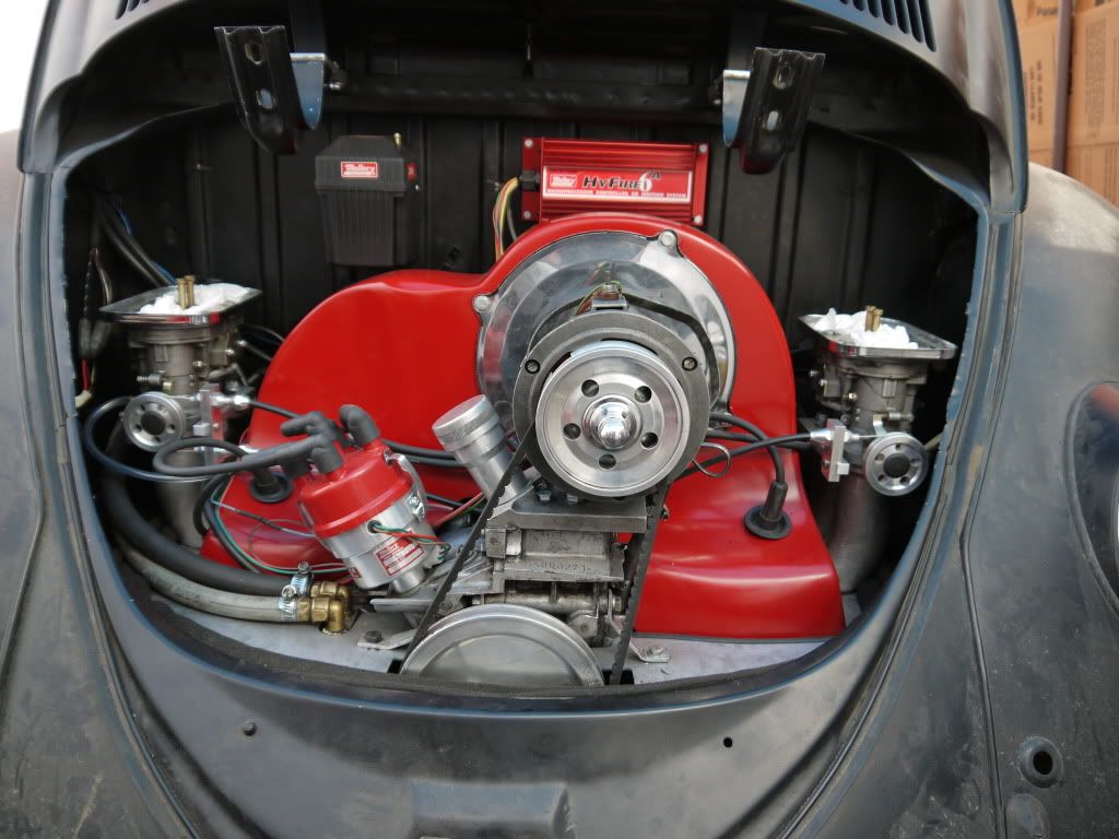

I really gotta start up dating this a little more often. My winter goals were taller gears and a smoother idle.  For taller gears I went with the Rancho Pro street box with 3.88's from rob at AVR.  Putting a new tranny in with the body on sure is a fun job!  To get the smoother idle I went for a Mallory distributor and control box from aircooled.net.  It seemed to be the best option for the type IV motor, its kinda neat it has both and vacuum and mechanical advance.  Today while I was installing new spark plugs I noticed that the #2 cylinder plug would only go in 2/3 of the way.  After visiting all the parts places in Williams lake I was able to find the right tap and chase the threads to get the plug in all the way.  This was the first time I’ve put plugs in without the cooling tins on.  I’m guessing the plug hasn’t been all the way in a while and may be the cause of my miss at idle.
mallory vs 009
goodies! now I just need my coil to come in (small over sight lol I thought thats what the box was for?)
clearence with old manifolds
with the new ones with the sync-link bracket

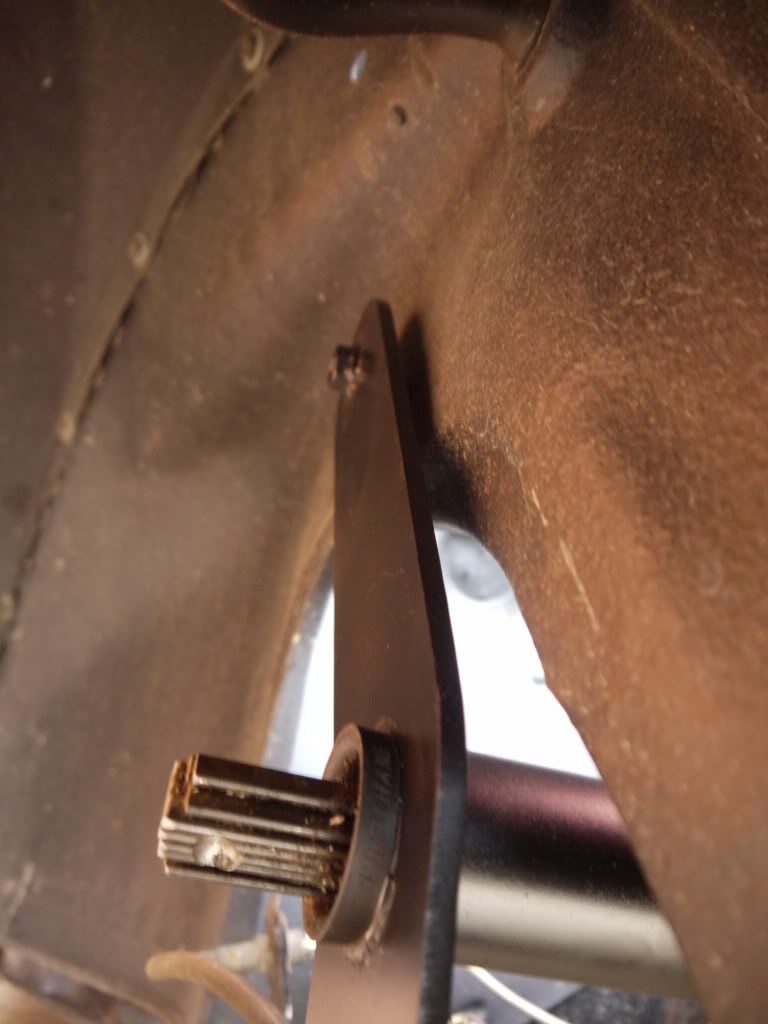

Here is my sync-link, it fits the type IV far better than a hex bar!  As with anything I’ve bought from Jake at massivetypeIV.com the quality is unbelievable.  Its nice to receive products that simply bolt on and require no mods what so ever.  I’ve been watching this be developed for the last three years and I was very happy to get in on one of the first shipments.
I ordered the ignition box thinking it replaced the coil. Then I ordered the coil using the Mallory part numbers that the instruction recommended. I think it’s a little over kill but I don't think I need to worry about my ignition being a weak point anymore!
It’s starting to come together!
