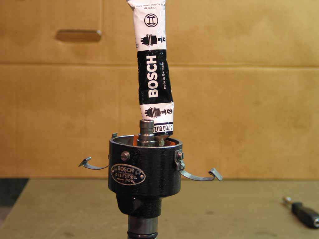

Use Bosch "Distributor Grease" and not white lube or bearing grease. My last set of points were in for 17,000 miles and I replaced them just for the hell of it.
Get the the Bosch 01016 over the 01001. It has a stronger springs.

It resists high heat and is really sticky. It's great on the tranny input shaft also.
