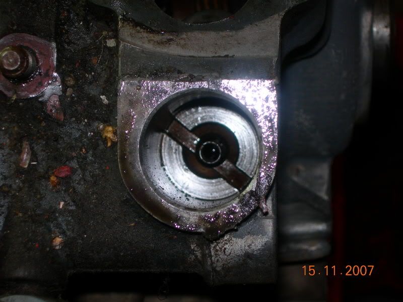

This is what you need to rotate 180 deg
ps     Use a unsharpened pencil and taper it just a bit tap in in with a hammer and it should move

Distributor
« Reply #7 on: November 23, 2007, 11:19:17 PM »
Better than that, I suggest you install it in the orientation VW specifies.  That way if you swap in a distributor that was timed on another engine, it will at least run right away.
Turn the engine over to TDC of #1.  Remove the drive gear and re-install it so that the slot is parallel to the pulley face, and offset to the rear of the car.
