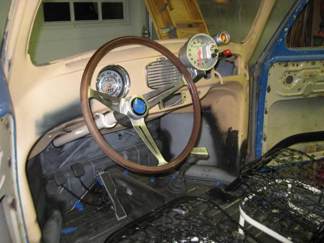

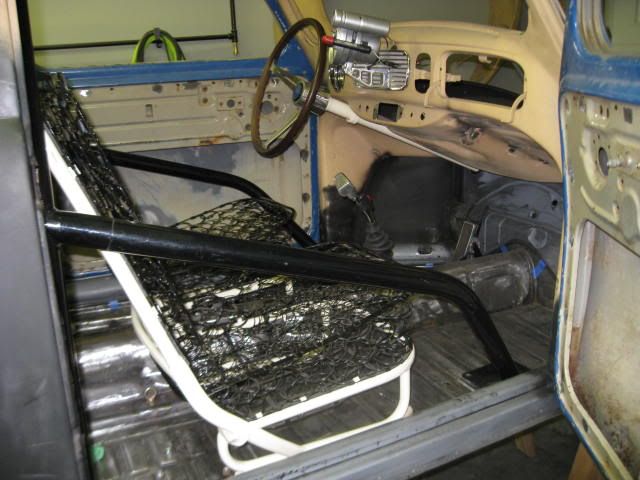

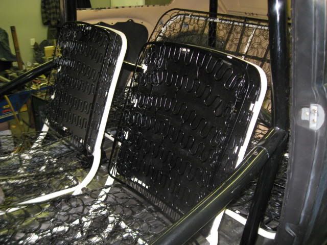

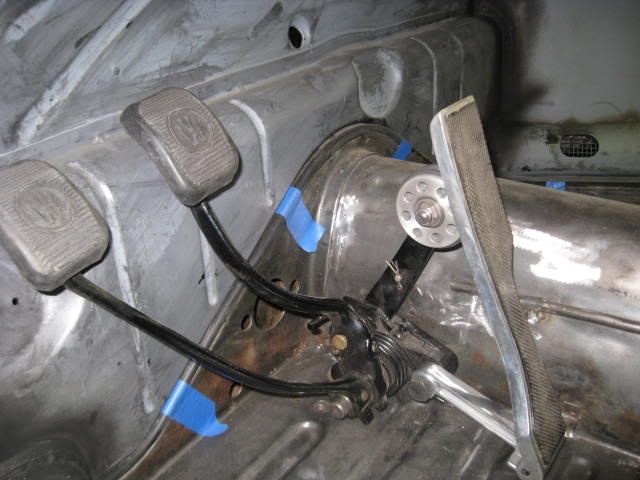

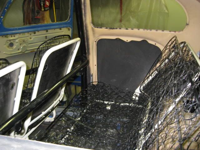

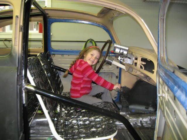

Mounting cage lastnight, got seat frames in and a couple other goodies for test fit too
She's a tight fit with the stock seats! My 57 ( which the cage came from) had aftermarket buckets in it.

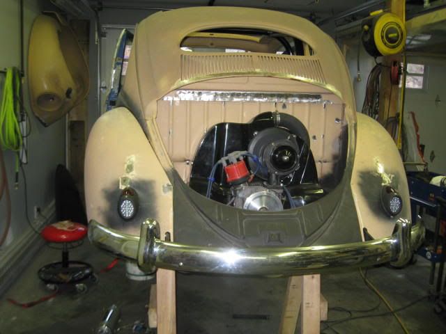

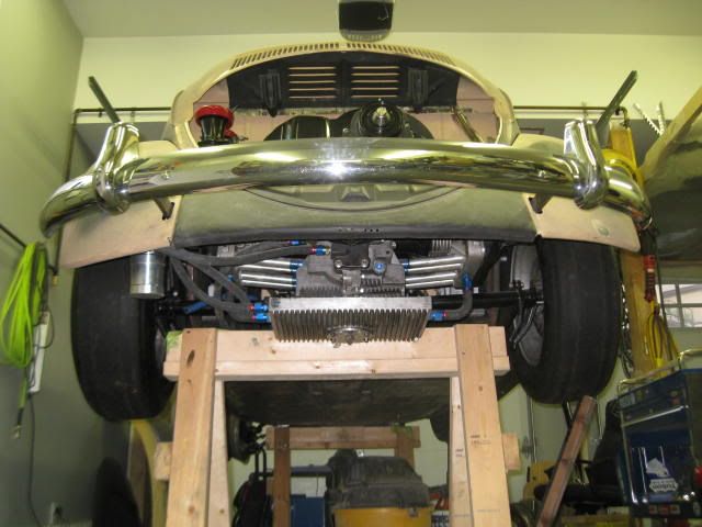

back bumper brackets got some love and blade made it on...

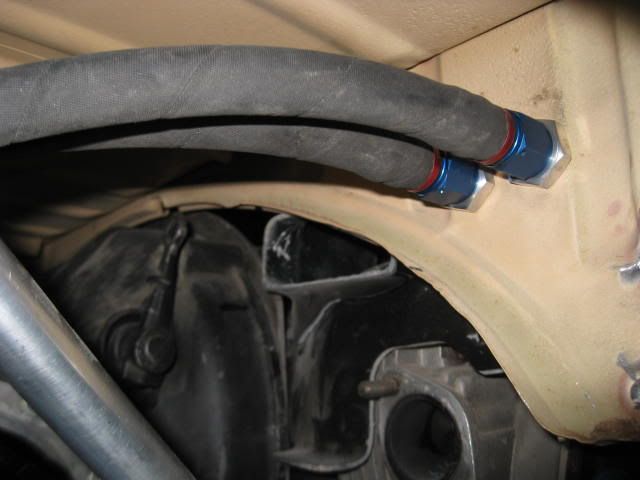

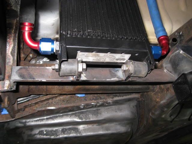

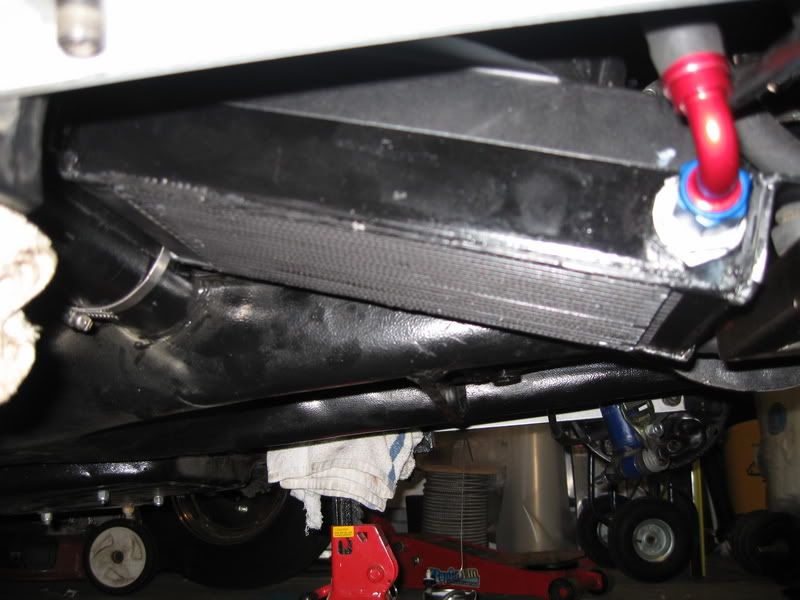

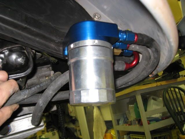

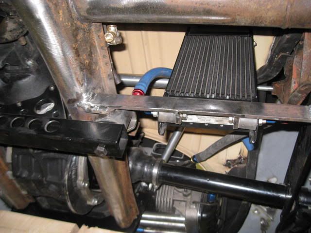

been trying to find a happy home for the oil cooler, wasn't happy with how I had it rigged in the 57.....
welded a piece of 1" flat bar between my intermediate mount and bottom of outer torsion housing

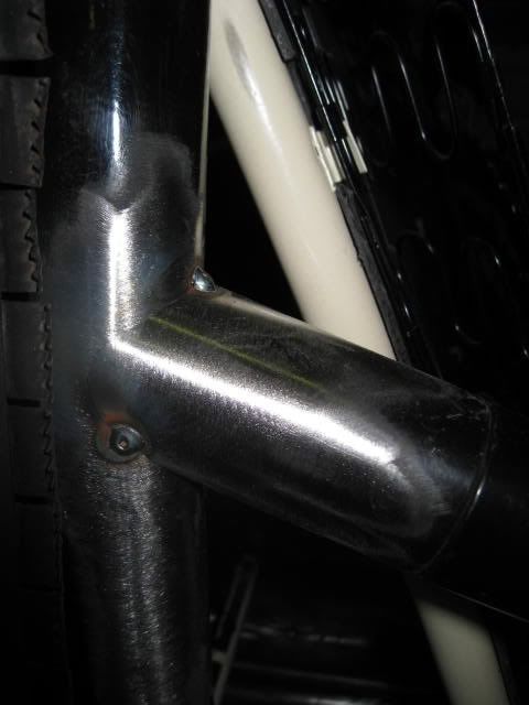

top mounts are welded onto the bottom of the cage down bar plates

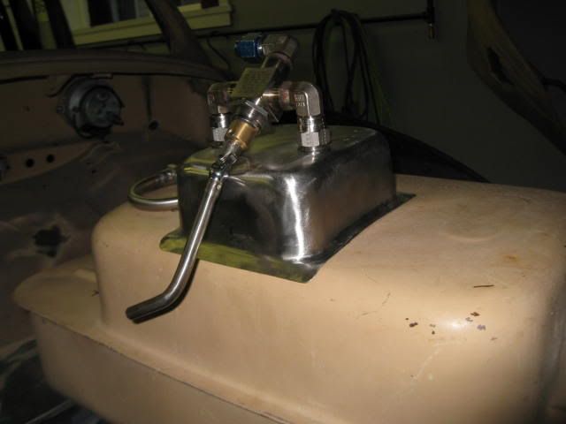

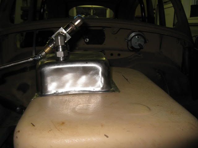

also been fiddling with the reserve lever....plan was to build a box/pan to weld to bottom of tank so the pick-up always has a solid gulp of fuel. Was digging through my drawers of fittings and came across this little stainless tray that fit the build....
took a little profiling the flange to contour to the curve of the tank but I think it will work out great ( stamped shape matches the look of the bottom of tank  ;D)

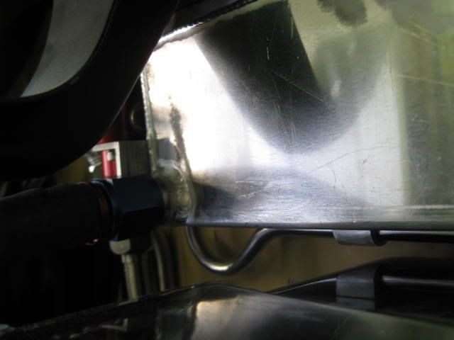

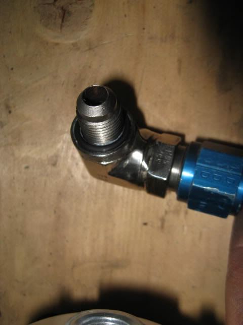

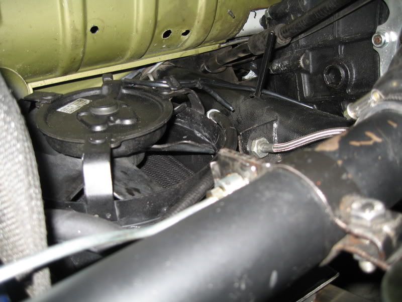

Thanks Stefan, that was my major concern with this whole set-up. I have the steering box in and just reamed my spindles to "flip" them but can't find my pass side tie rod >:(
Holding up a pc. of pipe in place it is real close to the outlet fitting (blue cap). Like 1/4" clearance :-X
Do you think I could offset the arm by bending 2 45* jogs in it without compromising strength? The way I'm thinking is the alignment doesn't care if the rod is straight oe has a 3" offset S bend in it..... Should still track the same, No?

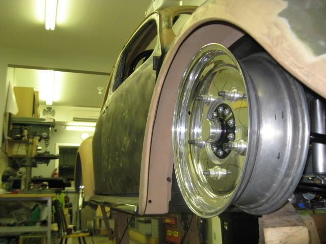

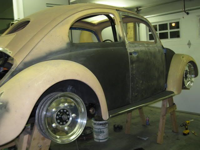

mock-up of wheels and running boards...

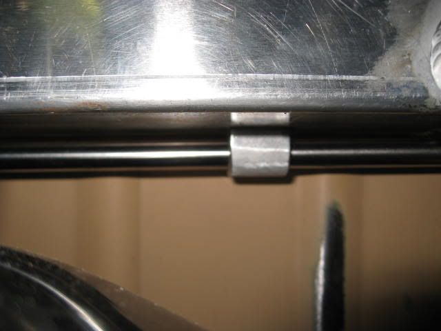

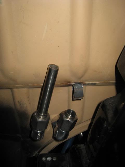

also been making up fuel and oil lines

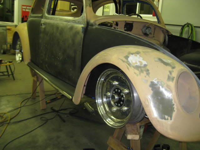

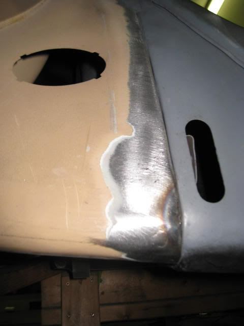

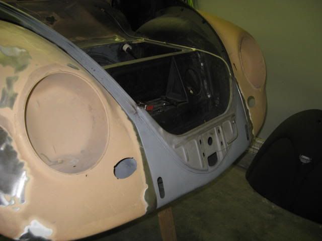

fit front fenders and had to re-do the lower corners where they meet the apron (were welded up to match up with old scabbed shitty apron before)
with any luck I will be modifying the door bars on my cage over the weekend, they don't clear the "ribbed doors" wtf

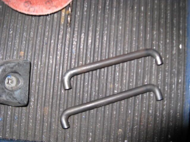

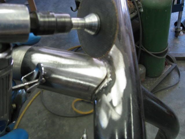

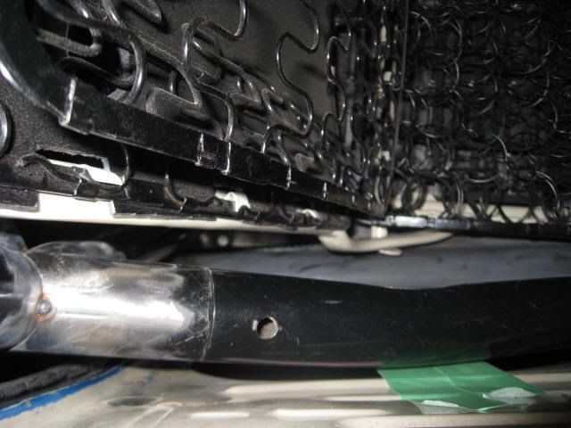

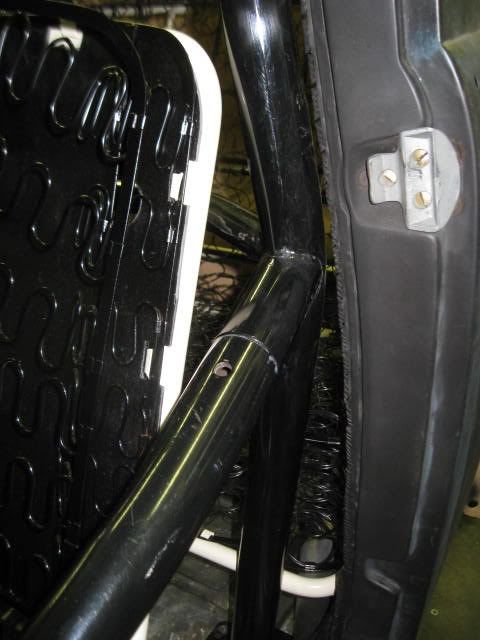

got a welder buddy from work lined up to tig my door bars up this weekend (don't trust my TIG skillz for a safety part) so I had to get crackin'

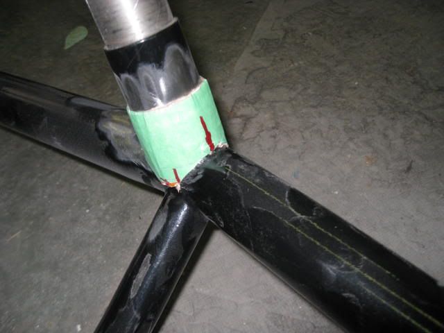

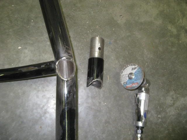

this is the RLR chromoly bolt in kit from my old 57, I remember the door bars in that car rubbing the door panels. Now on the early "ribbed doors" they actually hit the metal skin behind the panel......gotta modify
took a while with a carbide bit (wish I had a notcher) but got them fitting the hoop perfect. TIG machine is at the father-in-laws so instead of hauling the welder here or the car there I tacked them where I want with my MIG and will just bring the hoop over.
You can see where the green tape is on the door as a reference of the door panel....clears by 1/4" now :P

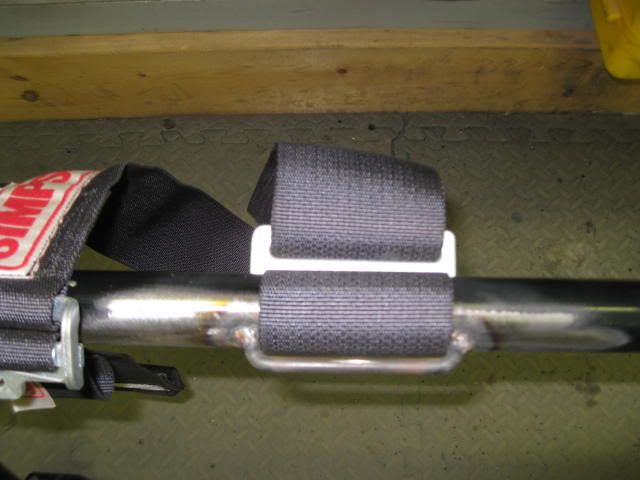

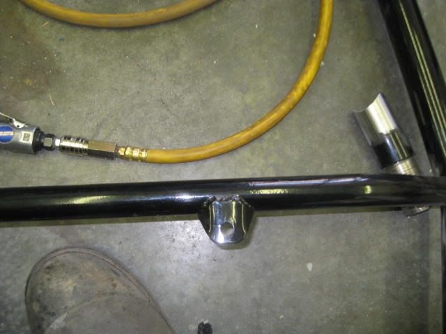

while im at it i'm going to ditch the eyelets on the cross bar for the shoulder straps and add some hoops to keep the straps from moving around. I guess the eye bolt is for a 4 point belt and I have 5 point simpsons
Chromo is apparently a little tricky to weld as you have to bring it up to around 400 deg to pre heat ensuring good penetration....something to do with the high carbon content

Hey Josh,
I've run belts on roll bars for years without the hoops, if you tie them up correctly they will barely move 1/8" left or right.
You'll also want to get the correct filler rod, I can't recall the number right now but a little Google action will reveal the recommended rod for 4130.

I know dave but what the hell, I'm already this far.
Bus daddy, I thought I'd try and stick it together with some aluminum rod..... You think it will hold? lol_hitting
JK. I have sourced the correct rods.... For the chromoly it's a certanium 72 (can't remember the 4 digit #) and for the belt retainers which are mild steel it was recommended to use a 309 SS rod.
ok safety first .
The reason for the hoops is to stop the belts moving during a collision . They may not move when your driving around town but they WILL move if you get T boned  or roll your car . i think its important to fit the hoops !!

got cage all welded up today...

If your cage material is 4130 and less than, say 0.120" wall thickness, then preheat is not necessary.  Controlled cooling is more important.  Using 4130 rod is not recommended due to the high hardness and propensity for cracking.  An 80k carbon steel electrode in the ER80S-D6 category will give you good strength welds, matching the parent metal strength, without all the preheat and possible cracking problems using more exotic metals.
What made you decide to use 309SS on mild steel?  Was it recommended by a boilermaker?  ER70S gives you a good strength weld with all of the correct properties and is relatively easy to weld.   The common use for 309SS on mild steel is for corrosion resistant overlay.
If you did weld your cage with CrMo electrode, I would strongly suggest getting your welds tested for cracks before you stick too much stuff in the way.

after all the research and questions I ask, figures as soon as it's done now I'm second guessing everything I listened to  :-\ this is why im not a welder
the rod used wasn't straight 4130 (I was told) but ? as for the SS, it was suggested by a very experienced welding shop forman....I didn't ask why ::)

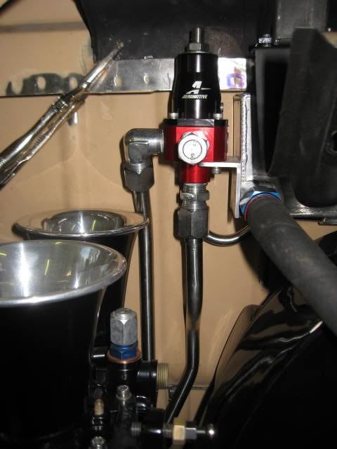

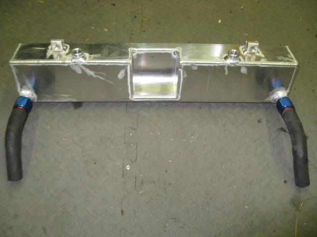

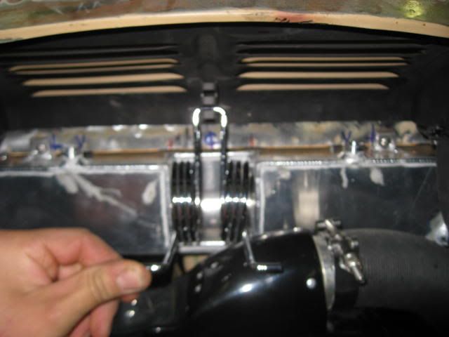

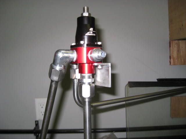

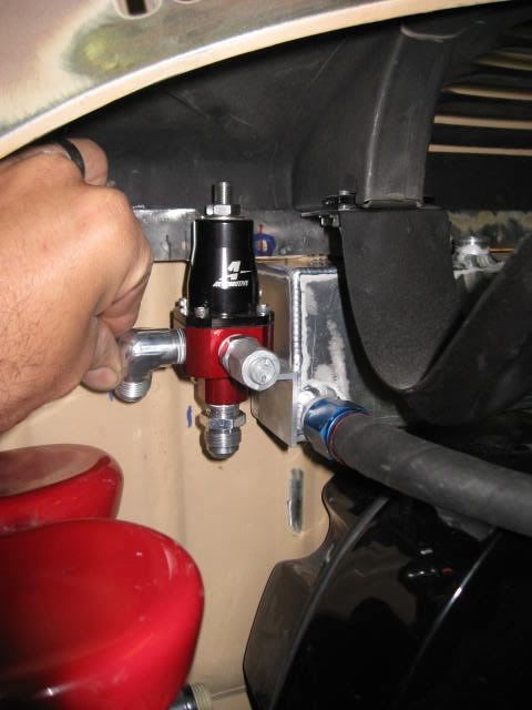

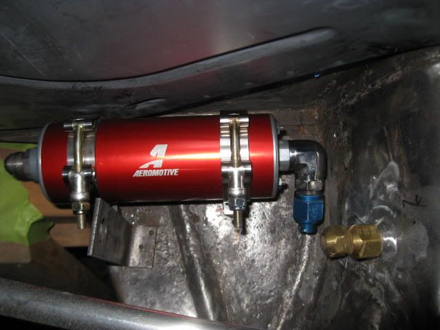

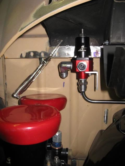

Been working on fuel lines, regulator, breather box

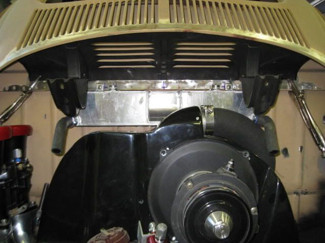

Trying a new way (for me) to vent crankcase with an aluminum box i'm building. Other cars i've had ran the el cheap-o empi box on fire wall running one -8 vent off each valve cover, off fuel pump block off and oil fill on alt stand. always had lots of oil in box and at extended rpm some misting overflow. new one measures 3x3 1/2x20" hangs off sheet metal lip under deck hinges. Venting through 2 K&N style breathers, box will have only 2x -10 AN's on fuel pump and oil fill, leaving valve covers alone. Done lots of research on subject and theory that's making sense to me is that venting #3 side is not ideal due to oil sling of crank and that valve cover being filled with oil. plus with a vent to atmosphere there makes oil draining back through those pushrod tubes near impossible simply due to the 2 different pressures
Anyway, no pics of box until it is tiged up but I descided to mount areomotive return reg on the side of box, will sit about here....
got bulkhead fittings mounted, -8AN on SS hardline will be bent up soon
The monster fuel pump doesn't have much room where I stuck it and a -8 90 deg hose end wouldn't fit soI made up a little ORB oring reducer 90 to sneak out of the pump, combination of fittings turned downed, silver soldered etc....
little one had to try running it through the gears
  :wub:
ok safety first .
Lots of t-boning trees and rolling of cars in stage rally, and the hoops are not required or used. Also got to test the t-bone theory in a justy which was t-boned by a tow truck at 80kph plus...Warwick survived, car did not. Belts didn't move. I'll stop hijacking Josh's thread now.

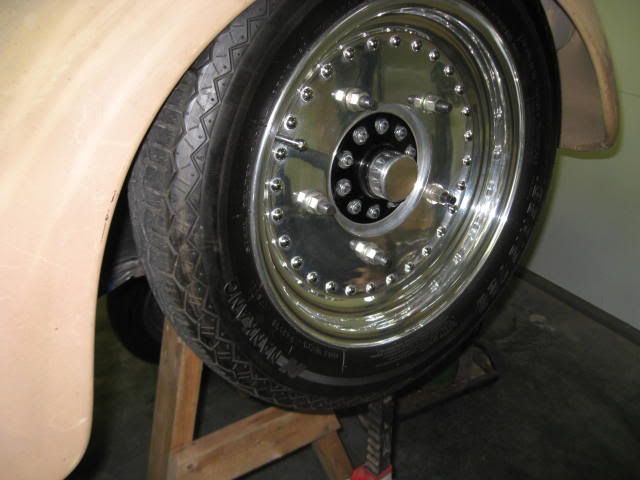

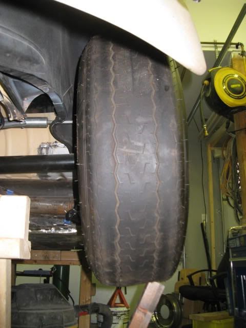

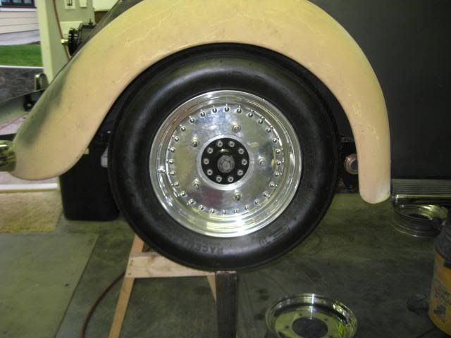

bought some tires and stuffed them on quick to see how they fit, rears are 215 M&H DOT street slicks fronts are nantang (sp?) 135's not staying on the centerlines ::) backspacing on the ercos are a bit better. These came from James's old copper bug......Slicks still have the titties on them!! Have rims for sale in classified if anyone is interested, $400....they're mint

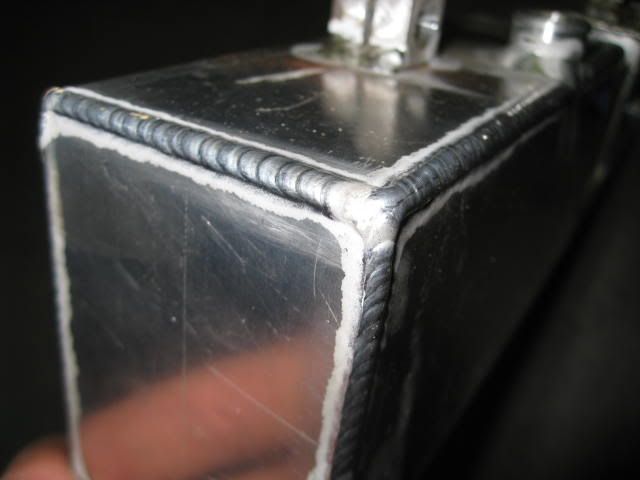

man I wish I could weld aluminum like this.......

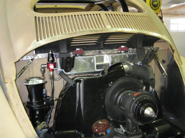

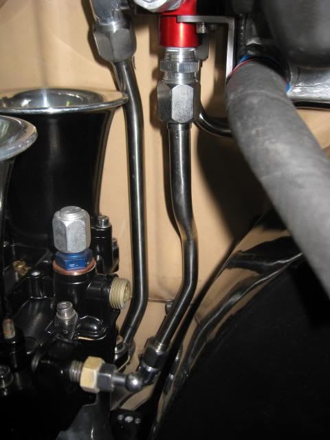

have a couple K&N breathers to go on the 3/4" stubs, -10AN vents go to fuel pump block off and alt stand. Bracket for fuel reg. will be welded to side and SS hard lines finished
Re: Project '54 Ragtop
« Reply #237 on: July 09, 2011, 09:44:37 AM »
baby steps......
got my hardlines all bent up and flared, just need to weld bracket for reg and bottom tabs for right carb feed. unsure if i'll stick a pressure gauge at opposite side of box than the fuel reg  ::)  or just a schraeder (sp?) fitting to set up and check with an accurate meter rather than the crappy std. 1 1/2" gauges???? what would you guys do?
