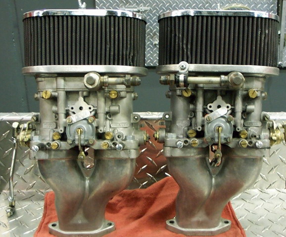

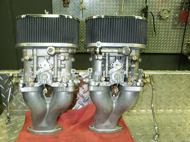

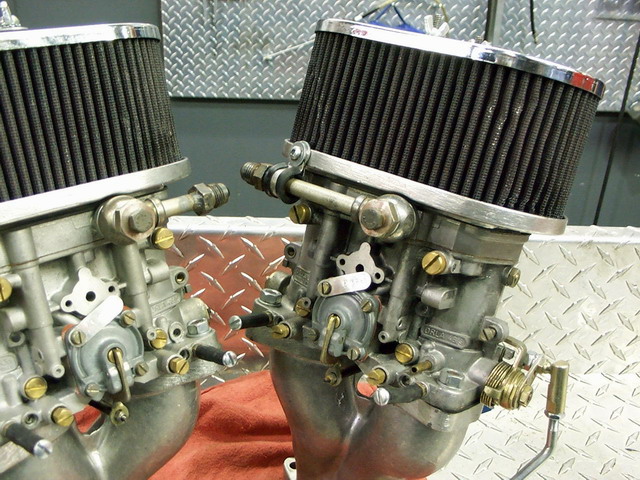

alot of people had e mailed me about how i attached the braded line and -an adapters too my dellorto carbs with the original 7mm bolt,here is some pictures of the adapters .parts are made from some scrap lines at work ,whats nice is they still maintain the fuel screens inside the fitting .also fuel passage is bored out as well as run a 2.5 needle and seat.

yep it is true in the new bugpack #25 catalog part #1134 is adapters for these carbs,were we these when i needed them?
