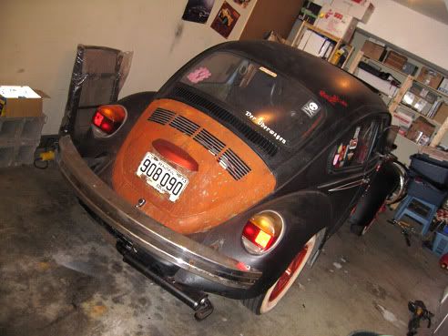

i used brake fluid when i made this:
though really only to prime the metal surface
salt water, lemon juice, and bleach did most of the rustifying

which just goes to prove that...
it's messy, ruins paint, stinks and should be left for the brakes, clutch slave cylinders, and nothing else.

ya, that was the point
