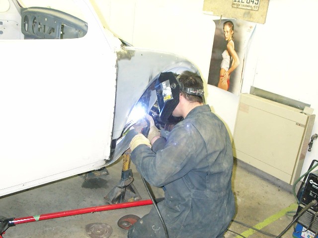

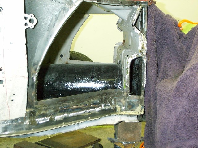

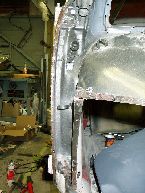

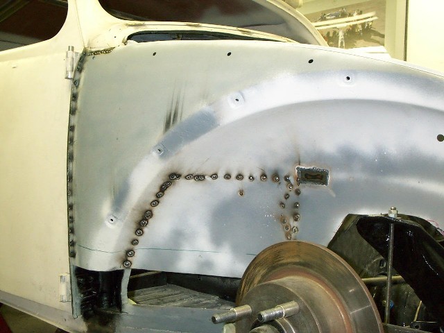

after a stop in on friday morning at airspeed to pick up a fiberglass hood and fenders  ,it was time too rush home to get a couple of hours of work in,
-here is the finnished patch -worked out great
opening up the pinch weld is a snap ,and whats neet is the spot welds on the new clip
lines up perfect with the original spot welds
 then here is a picture of the new/used clip sitting there,
                                                      lines up great as well as its level.also i have 2 lower repare pieces i got from jim/geoff that are
the lower sections that include the pinch seam and cover all the way too the bottom,very cool
so far easier than expected and i seam too be on track ,this friday i should have the frt clip welded too the body ,then will seperate the body from the pan.
--tried the new fiberglass hood/fenders on for a mock up and i have too say they look great.
thanks jim and geoff always fun too spend a bit of time chattin,more pictures coming next week

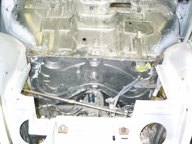

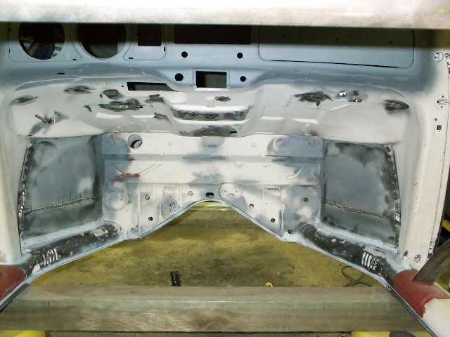

this friday i spent the time too patch the donner frt clip and tack it into place.
it fit real well and was a lot simpler than i imagened.
you can see some of the areas i patched and filled in.
but its level and straight in the quarters
have too do a bit of custom work for a fuel cell ,but it went well .
there it is in its new home,fits great and will fill in each side of the tank
with a aluminum trim panel.who said you can't stuff a cell up front.
time too let the master fabricator TATE WESTERMAN in for the real work
man he does nice work !!!!!
here is the sweet patch panel from airspeed .again very nice!!!
this is what it looks like from the inside.
just need seam sealer and its done

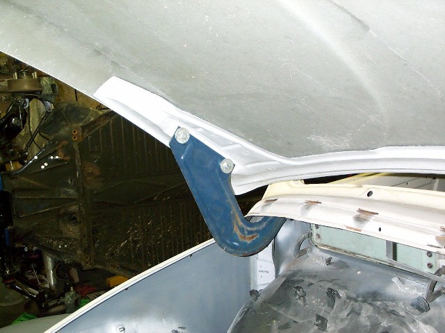

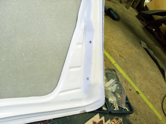

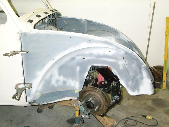

first the airspeed fiberglass hood gets a 10 out of 10 !!!
you can't use a riv nut as the cast in metal is too deep so the compression area would be in fiberglass
and not metal.  so no problem just tap it .!!! problem solved.
here is a shot of it on the car.works and fits great !!!!

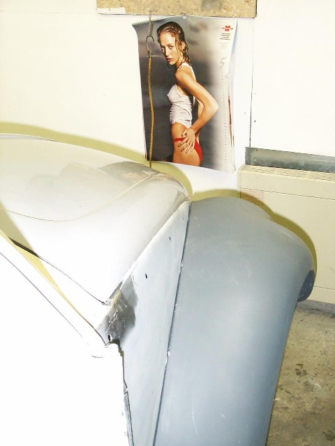

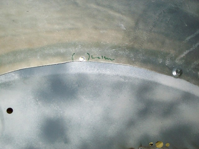

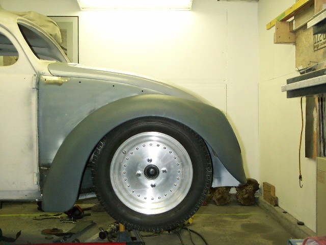

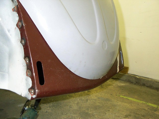

on too the airspeed fiberglass fenders.  right frt fender gets a 10 out of 10 for fit and instilation.
the left frt fender gets a 7 out of 10 . inner lip is a bit short and angle where it meets body
is too steap a little scarry too sintch in i will have too glass on a piece too support it ,as well  it sure didn't won't too take the shape of the frt clip at rear section of fender .strange considering the other side was a snap.
you can see were it was a bit short.
but most inmportant is both fenders fit  dead on and look fantastic on there ,
here is the million dollar shot.
nice!!!!
and i still have 1 1/2 travel as well as i now have 1 3/4 fender clearance .!!
hood and fender line up nice
thanks too the help of silas !! again thanks for stopping by

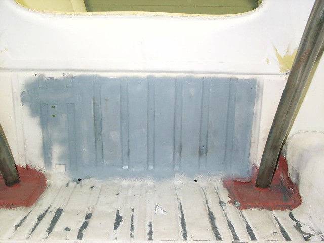

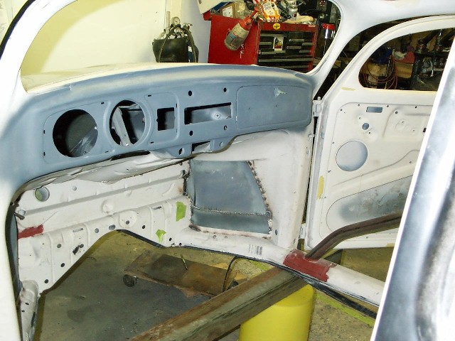

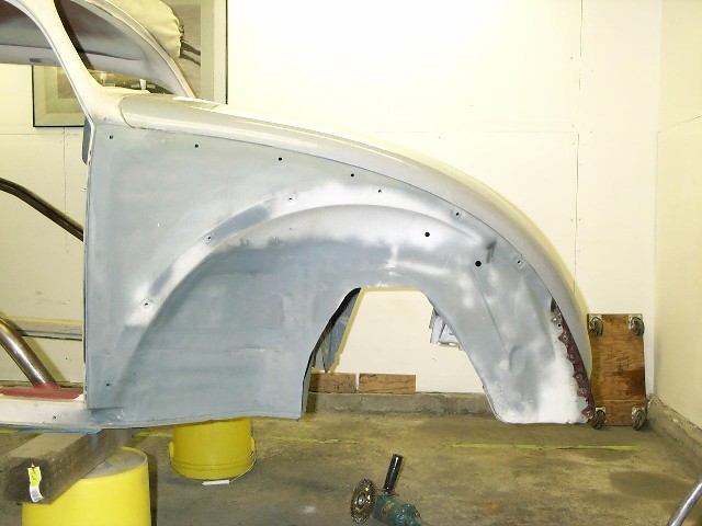

doesn't look like a lot of work got done but sometimes things take a lot of time too get the effect you want.
here is a picture of the inside under dash all area's are ground smooth for pure apperance.
just needs epoxy primer and seam sealer.

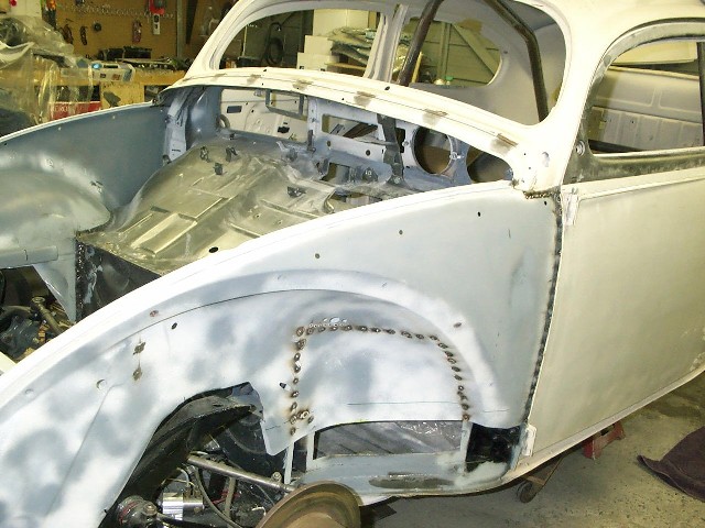

 even under the hood a lot of time was spent cleaning and removing all things that will spoil a smooth uncluterd look. areas where the tape is are spots that were touched up und will need a shot of filler and a light sand too smooth out. should look great in the end.notice the re welded in dash .someones junk is someones treasure.thanks jim/geoff
 the frt apron came off with little effort .allot of time was spent making sure the lower edge flows into the fenders. once again those fiberglass fenders fit great.TATE decided too start giving me a factory look .why now with the rosette welding ? looks great.
 the hood lines up nice with the new frt apron!!
here is a shot from the side with all welds ground down .
needs a couple of coats of epoxy primer and seam sealer.
the replacement of the frt clip as well as all the metal repare under the frame rails and lower panels as well as gas tank mounting area was most worth it . now i won't get junk fling under the frt hood as well as a more original feeling ,plus i can now throw a jacket under the hood or towels if needed.
 still not sure about the  look i'm going for , or the colour .but time will tell.

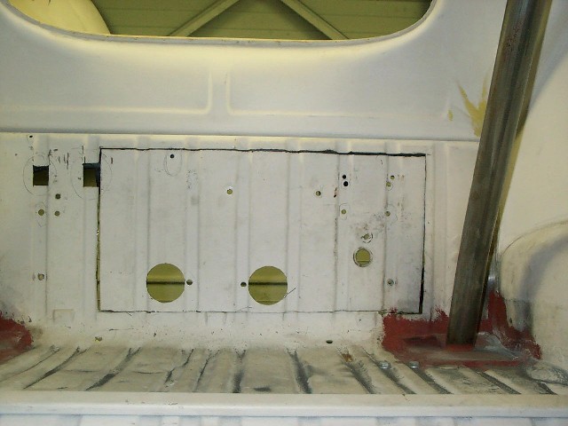

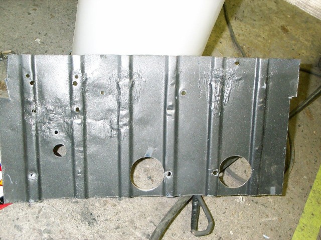

this friday i will tackle a real ugly piece \"the rear fire wall\" it has been abused for years and is beat too crap.
once that is done i will leave the rest too tate and back too the pan for me.

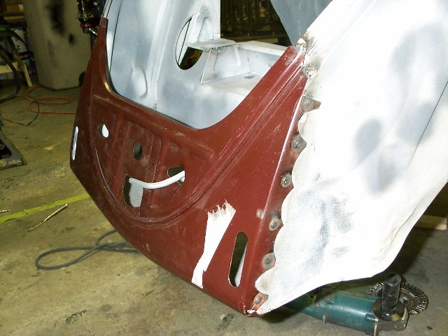

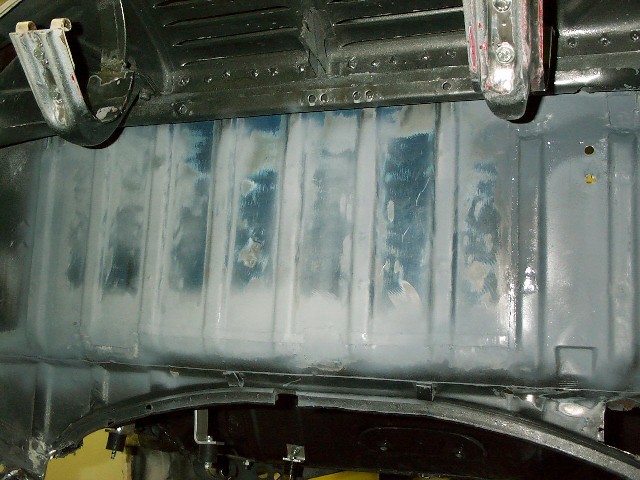

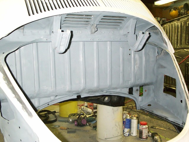

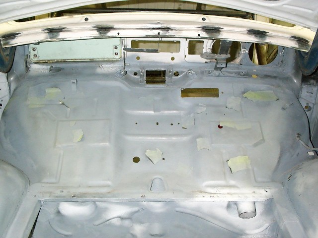

can 100 % say all major shell metal work is done .
here is a ouside picture of the rear section that was removed it had way too many years of abuse and modification.it had too go
here is the inner shot of the section.   bye bye !
inner patched section in and welded with a light coat of primer.section above holes is needed for fuel sysyem pieces in the engine bay.
outside looks good and makes me feel happy even if you can't see much of it
tate spun up a little filler before he left last weekend .can't wait till this weekend when its all sanded down
and coated in epoxy primer.
major progress starting soon.light at tunnel is coming fast

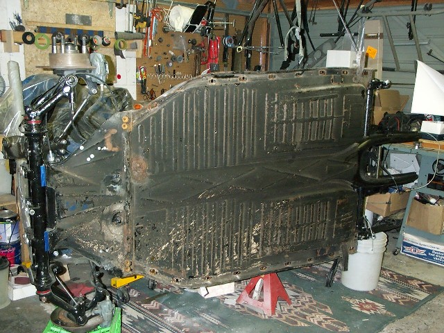

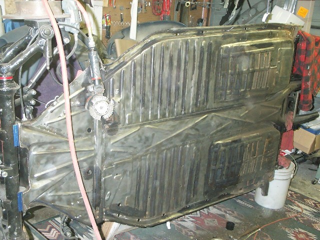

here is a shot of the wurth tool and the nearly cleaned pan .
like i said all major metal shell body work is done
a lot of time was spent on my back under the car in the trans area and lower quarters touching up some holes and removing all old paint.as well as rear inner wells and rear clip needed prep work is now done.yeah!ther is no photo's of that as once you spend all day under a car the last thing you want too do is climb under too take a photo
this weekend i should finnish the pan and paint it .
then i need too clean up the whole shop ,which i can now due as all metall /stripping work is done.as well as i have almost finnished making a body dolly so i can push the shell outside too blow it off after tate works on it. dolly will be for sale later.once the shop is clean and the pan is level again as well as the shell is on the dolly .thing should come together quick.
