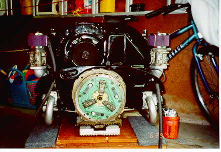

The picture of the head is from my 2087 motor which died in 1982. I then put the heads on the 1775 with dual 44IDF's, Engle W140 cam, 1.5\" headers. Power band - 6200-8500RPM. Needless to say, one of the valves let go,
and did a little dance in the combustion chamber. Only a few minor marks on the piston. I took the head back to Headflow performance to have it repaired, but never sent them any money, so it most likely ended up as a doorstop. This is the remaining partner that you see.
So I then rebuilt the T1 - 1775 and converted it to T3 engine tin & mount.
Engle VZ25, 40x35.5 manley ported heads, deep sump, dual Weber 40dcnf & Rebuilt IRS tranny from Transform.
She drove it to & from work for one summer ~ 3000 miles. Of course I pulled this out before scrapping the TIII.
I'm going to use this as my grocery getter motor in my Ghia, but will be reverting back to up-right T1 tin & 44IDFs.
I will be selling the carbs & T3 header and Engine tin.
Here she was in all her splendor:
