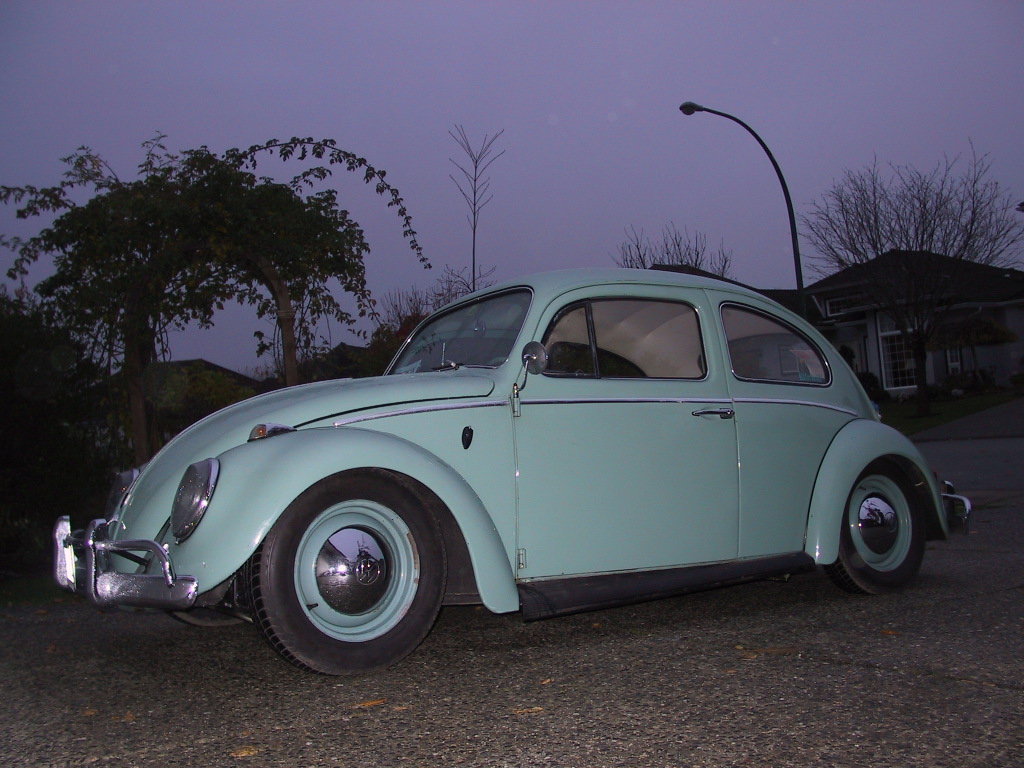

Lookin good Kirin! Way better with the rear down.

Dump that sucka - the front end is higher than the ass!
Kirins Slammed Turk
« Reply #6 on: November 16, 2005, 06:53:39 PM »
Hey guys,
I'll attach a few more pics in a few minutes. Yes James I know its a bit ass heavy. Now if only Stiener returns my emails about his tires that he wants to sell it will get right. Its amazing how no bumpstops and 1 notch in the back with ground out spring plates does. And who really needs bumpstops in the front.
Problem is though in the back I've already ground the muffler HARD getting out of my buddys shop on 76th ave. No way to get out even trying different approach angles. Depending on what happens it may go..(Muffler that is)
Btw did I mention how nice this thing rides now? Holy crap its more solid then the bimmer!

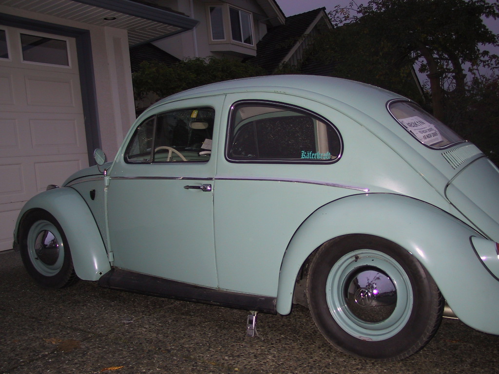

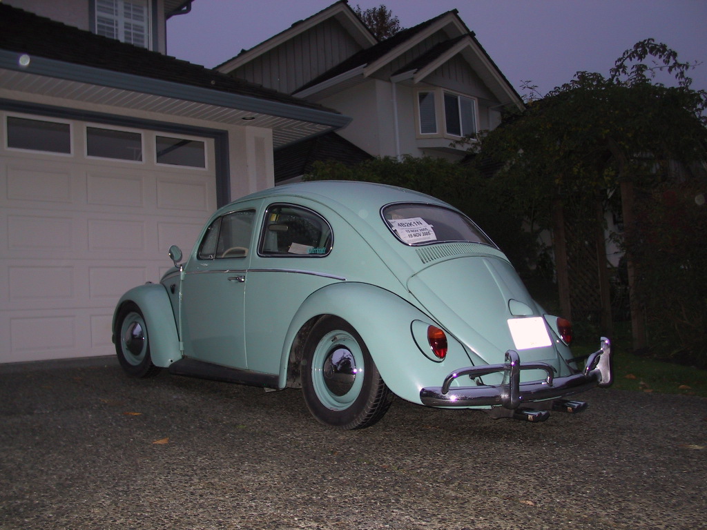

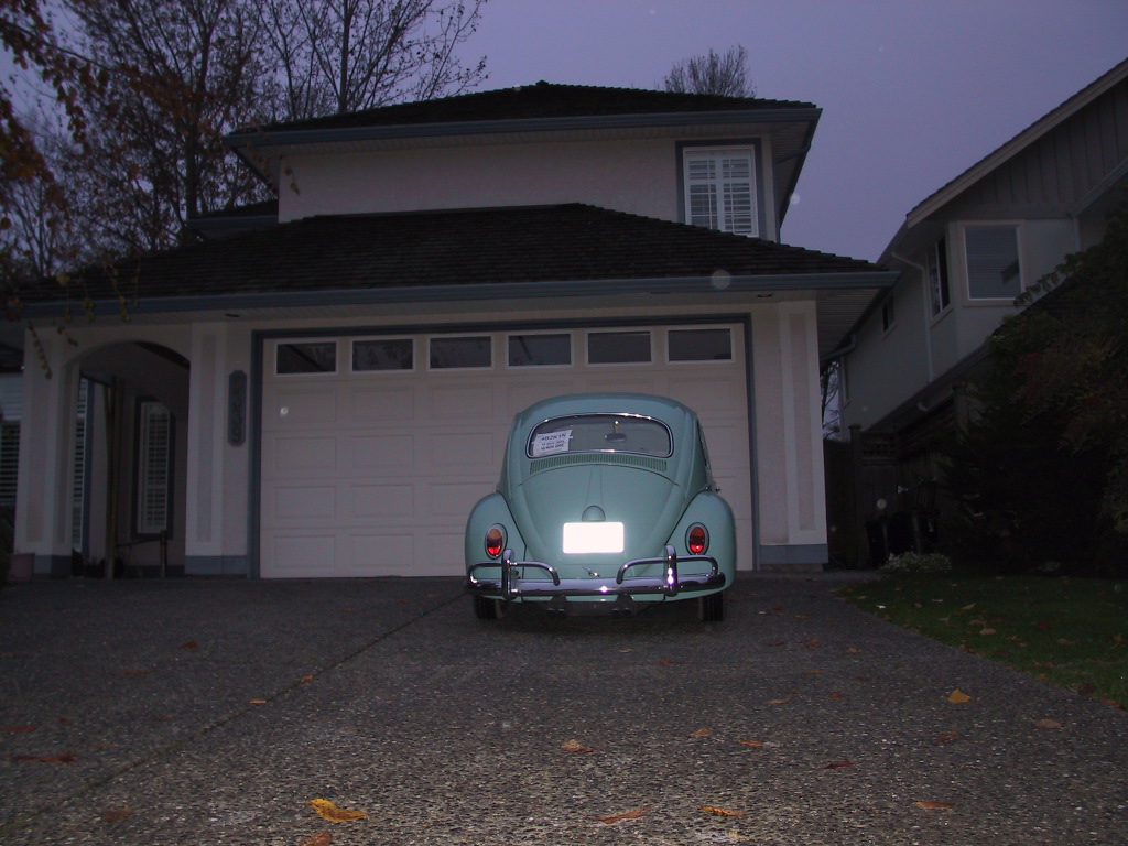

more pics

Uhmmmmm Kirin you left your phone on the ground ;)

Just trying to give  \"representation\" since taking low shots on a slanted small driveway sucks. Anyways the saggy ass running boards have already been yanked off.
Egspot. What it took was a adjustable beam up front with the bumpstops cut off. I'm running stock size tires. I could of gone lower in the front if I didn't have my disc brakes which means I can't use dropped spindles due to the kit I used. In the back 1 notch in the torsion bar down, and some notched spring plates and removed bumpstops.
