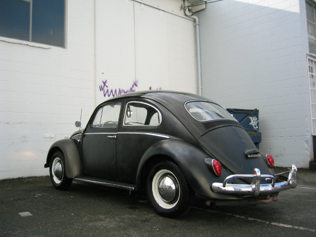

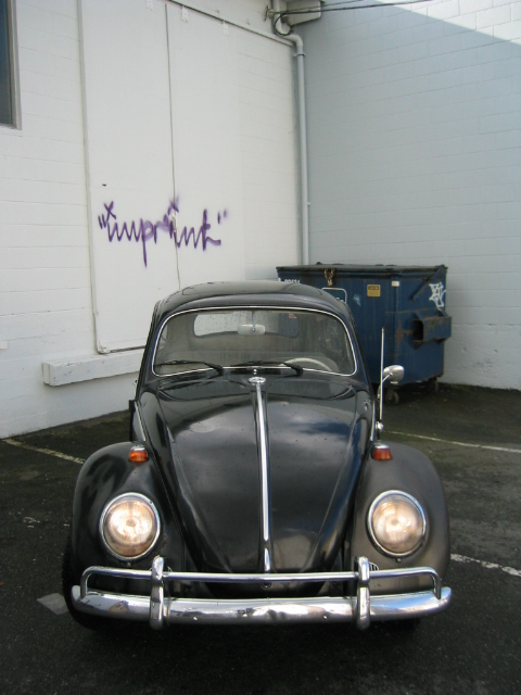

here it is.

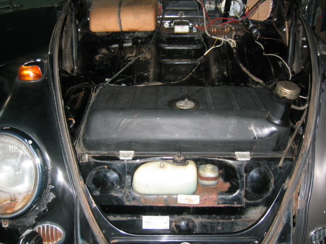

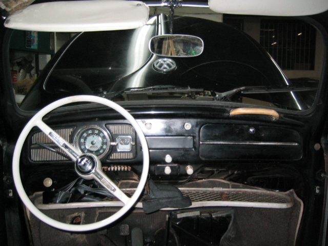

64 steel sunroof beetle. probably about 50-60% original black paint, original wiring harness, original pans (need a little love), uncut dash, strong rebuilt 1600 dp with about 2000 miles on it, early popouts...
64 has always been one of my favourite years for beetles. first year of the steel sunroof. last year of the early popouts, little-big windows, t handle on the decklid, wide door posts...
this one is far from perfect but is very clean rust wise. the front & rear bumper mounts are good, the fender wells are clean, the channels are solid, the rear crossmembers and lower rear 1/4's are all there. it does have 2 repro fenders on it (one that is grey & one that was painted black with a brush), aswell as a decklid and drivers door from another car. the front drivers 1/4 panel has a crinkle in it. but all in all i'm very pleased with it.
had a day off today to wash it and have a good look over it. the front end needs to be tightened up & i have to get the horn to work and then clean up the pans and fix the sunroof (small leak & naughty cables) and then i should be able to get the safety inspection and insure it and enjoy it.
das pics...
a little bit of bubbling around the passengers headlight bucket & the brake fluid resi tray & the repro grey fender on the drivers side...but if you look closely you can see the original L41 paint tag.

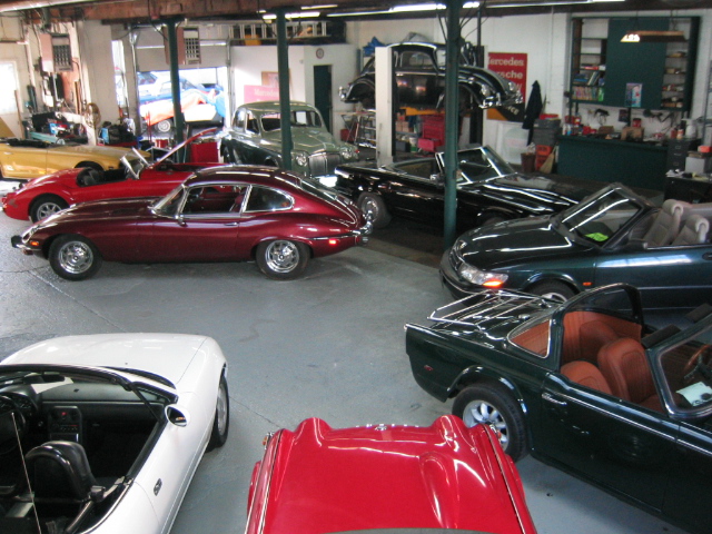

hans, i work at a shop called british classic auto. i found the place on clark drive and we recently moved to 346 west 5th, right by the cop shop. it's a small operation, with just me, the owner and the parts guy, but it's a good place to work. lots of 70's tr6's, 60's tr4's, that black convertable mercedes is getting put back together, the e type jag just sold, and that 2 tone 61 rover beside the hoist is awesome. wood panel dash & original leather interior, suicide rear doors. it has been parked for awhile so we're going through it. and there is a real lotus super 7 hidden in there too. we also work on newer stuff. import & domestic & we're trying to bust into the new mini market. i'll be working there until january and then i go back to school.
if anyone wants to stop by, business hours are 930-530 monday to friday.

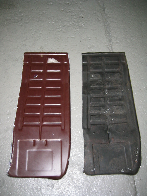

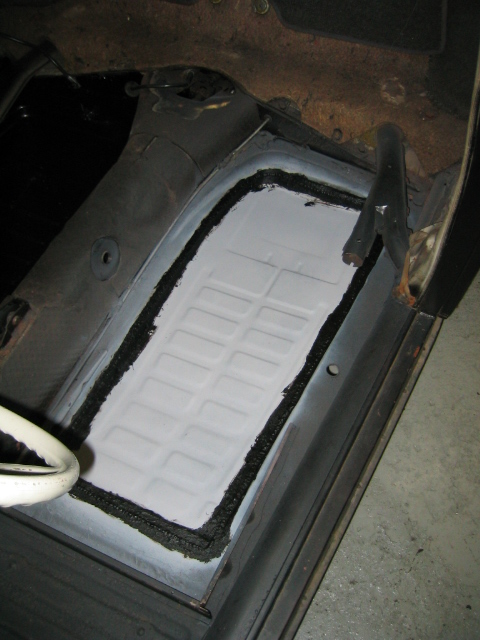

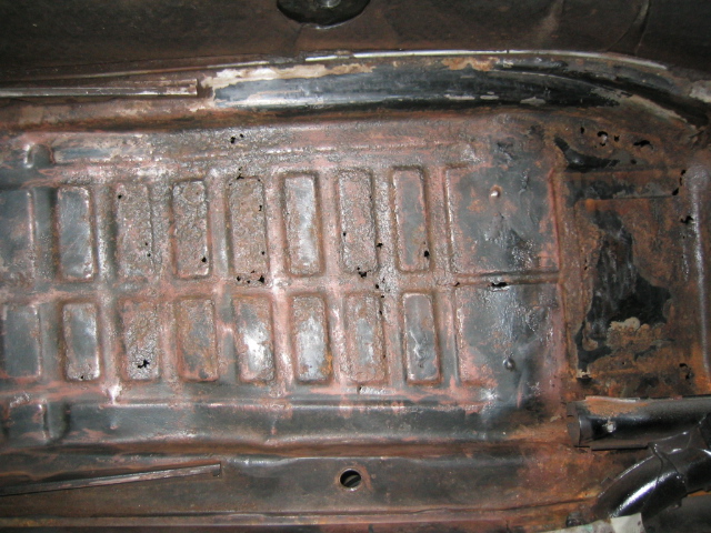

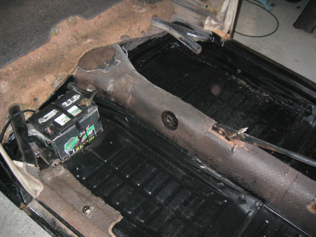

one day after work last week i pulled the rubber mats and tarboards and wire wheeled the surface rust on the pans and then coated them with 3m rust inhibitor. the area behind the drivers seat was a little worse for wear...

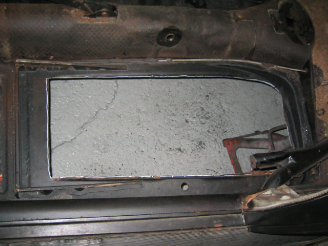

so i cut out the bad...

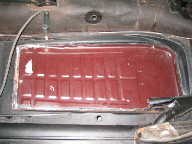

ordered a pan 1/4 section and trimmed it to fit...
tacked it in place...

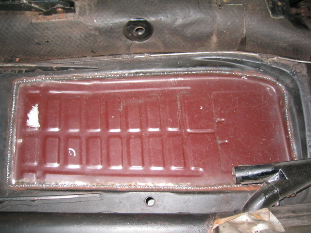

and then welded it in good & tight...
next up is to seal it and cover it and then tidy up a few more things and take it to get it safetied.

Nice pan repair. I have a couple of questions. I am a novice welder and trying to work to better my skills.
What did you use for wire? .023 gas shielded?
Did you use a series of spot welds or weld or run a continous pass all the way around?

hey mike, i'm a novice welder too! i used my miller 135 mig welder w/ gas (75% argon & 25% co2). i used .023 wire, had the voltage set at 2.5 & the wire speed at 3.5 and set the gas to flow at 15cfh. the settings will vary for different welders and different users, but this is what i have found works best for me and my machine.
the hardest part was fitting the donor peice. after i got it as tight as possible i tacked all 4 corners and put one tack on each long side. then i left it for a night and came back the next day to make sure i was happy with it. i was so i then tacked in the middle of those first tacks. and then in the middle of those tacks...and so on...working my way around in an orderly fashion so i wouldnt create to much heat in one area and warp the metal. a little hammer and dolly action here and there and it was finished.
personally, i am not skilled enough to lay a nice bead. i find the metal to be too thin and i end up blowing through. or it gets to hot before i stop and it warps. the tacks arent as pretty as a nice bead, but the weld is still very strong. i showed it to my boss and he gave me the \"is it that strong?\" look. i told him to go ahead and jump on it. the rest of the car will break before that patch does.  ;)

Fun eh Silas?... Tig would allow a continuous pass.

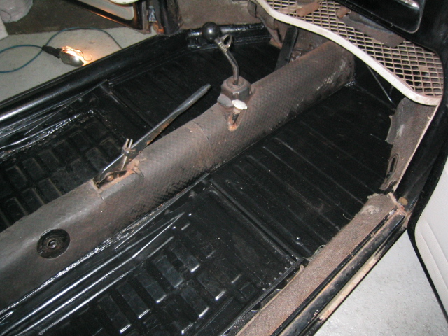

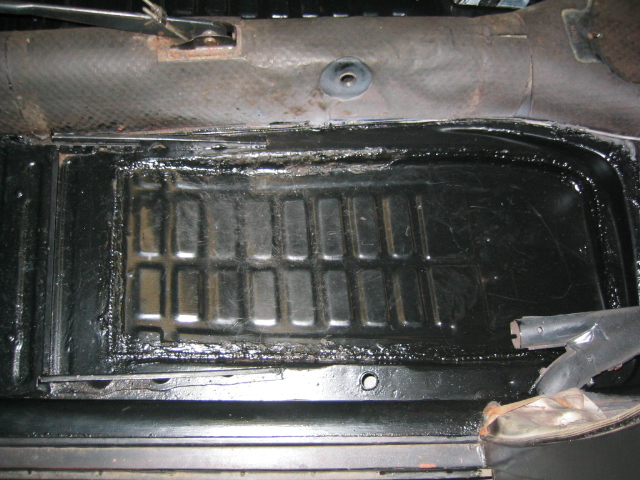

primed & sealed the new floor...
and then decided to tremclad the pans...
i pulled back the headliner in the front corner on the drivers side and found a sponge, some silicone and some nasty brazing and a few holes. i tried to spot the holes shut but they kept blowing through. so i cut out the corner and made a piece to go in there with a \"spout\" that the drain hose can go on. it's not the prettiest peice of work i've done, but it will effectively get water from the rail and out of the car. unfortunately i didnt get any pics but i will try to take a few before i put the headliner back up.
