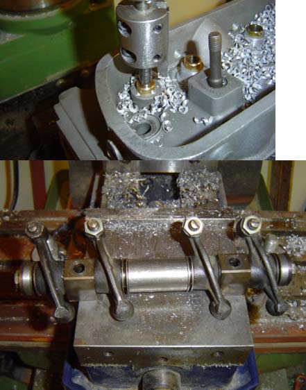

    At the same time some dual springs are going in and the machinist I was talking to is saying it's a lot easyer to cut for the springs if the guides are removed first..........true or no? If so it will be easier to get the flapper wheel into the rest of the runner with them gone.
False.  How are you going to accurately cut the OD of the guide boss if there's nothing to pilot from?

The guides have to stay in to cut for double springs , I will be doing this exact thing pretty soon, I'll post a picture of the tool  I am going to make when I do this.

Here you go fresh from the mill.  I used a valve as the pilot for indexing from the valve guide.
