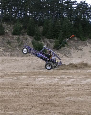

We run an 1835cc with dual 44 webbers, with a strong tranny (superdiff, close3&4th) and it wheelie's easy.Steal front beam and pushbar too!
