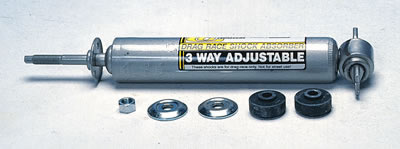

a little while ago lanny had made a replie to a shock post on the clf to which i replied and now that i think about i thought a post here was a good idea.
if anyone else is useing these shocks on the frt of there car the adjustment chart printed on the box is incorrect .the postion for the rear is ok but the frt is backwards.info on there site is correct  .here is what you need to know.
setting - frt shock-rear shock
   R       -    90/10  - 50/50
   F       -     80/20  - 40/60
   XF     -     60/40  - 30/70
first number is compression and second number is extension
