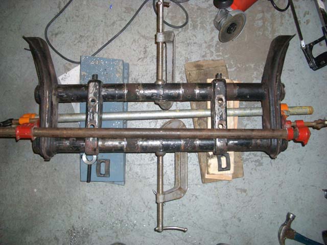

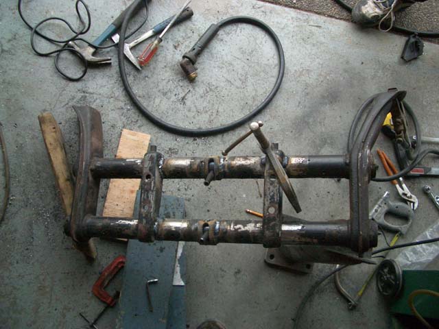

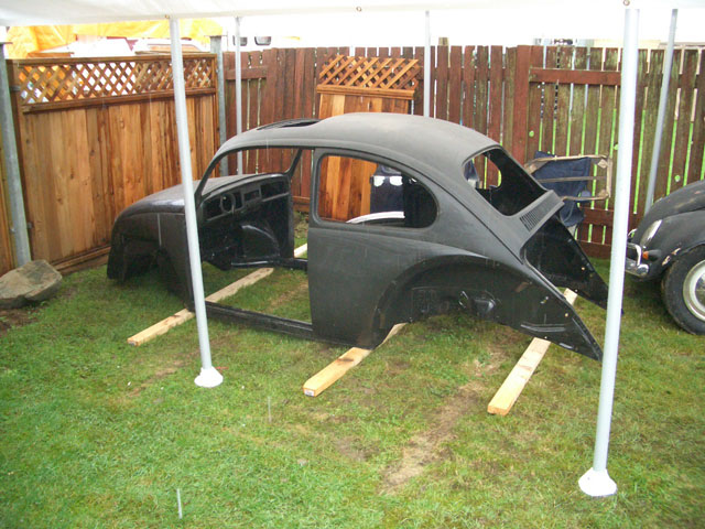

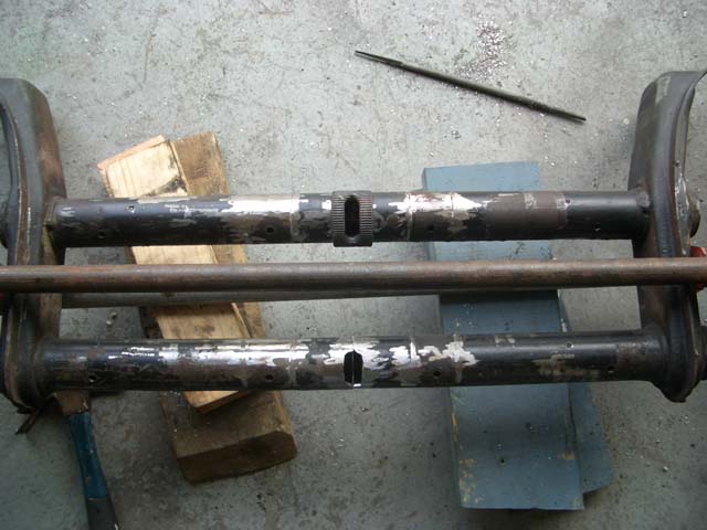

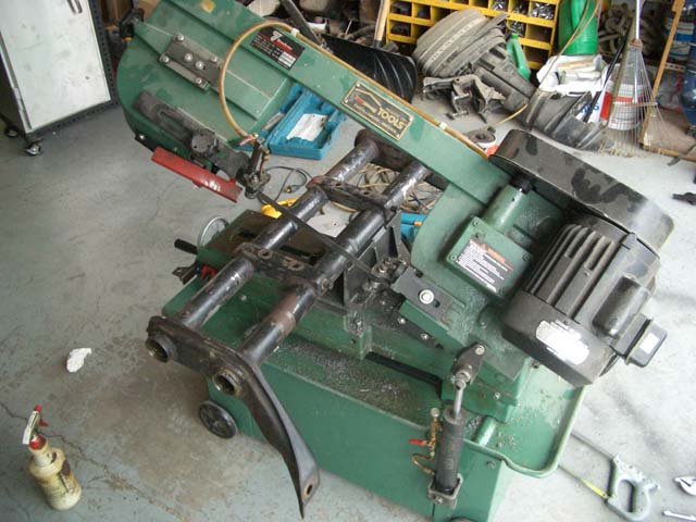

Well, a few big changes since the last post. Plan is still the same though. I traded the '68 shell and bought a rust free '70 sunroof to start the project. The '70 is pretty complete. I spent yesterday in the garage narrowing the beam. I did some research on narrowing and then just went for it.
I took 5\" out of the beam. I like the look of a 4\" narrowed beam and I wanted to use CB drop spindles and front disks. I decided to cut the section from the centre after seriously comtemplating cutting in two segments outside the mounting points. The control arms ride on needle bearings at each end of the beam and on some sort of a guide about 6\" into the beam, I was worried about cutting and welding near this inner guide if I was to cut outside the mounting points. Also, with \"avis\" type adjusters and a german beam I really dont know how you can install them without taking a portion of the beam out (the part where the stock grub screws and dipples are).
Anyway, I removed the stearing damper bracket and stearing stops, cut out the 5\", removed the stock mounting points, installed the adjusters, welded back on the mounting points in new locations, welded back on the stearing damper bracket and stearing stops. Now I just have to clean it up and see if it fits  ;)

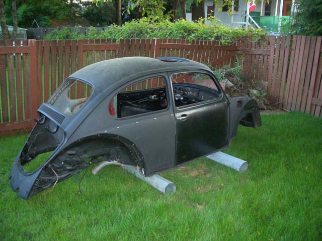

Oh slammedbus....... Im ready to haul this thing up. Pulled the shell off today
Let me know
Mike
