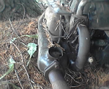

i bought this bug a while back, and before I sold it I took the engine out and kept it. On it is a pully that no one can tell me what it was for. it is an AH block, here are some picyures of it you tell me. there is also an exaust on it that i have never seen befor. If you know what that is you can help me in my seach also. thank for your time.

It would be easier to tell what it is, if we could see it.
Take the \"thumbnail\" part out of the link.
Eg. http://www.thesamba.com/vw/gallery/pix/179291.jpg
Looks like fuel injection exhaust.
« Last Edit: November 05, 2004, 07:56:18 PM by Cameron »
Do You Know What This Is
« Reply #2 on: November 05, 2004, 07:55:03 PM »
Looks like someone welded an extension to the pulley to drive another belt - maybe a service engine for a fire pump, air compressor etc...

My guess is fuel injected car at one time with air conditioning pump run off the extra pulley!

The AH block is definately a 74 block but it has FI heater boxes.  It should have provisions for fuel pump on top of block. FI blocks do not.  73 block was AK still flat top pistons but 74 used dished pistons to lower compression.  75 FI block was AF and later AJ   Marcel

I have the same pulley I thought it was for ac??

i have been told by many that the pulley is for and ac uint and the exuast is from a injected car?  it just seems odd that there was no other signs of anything to do with AC.  If anyone else has anything it would really help the thinking.
