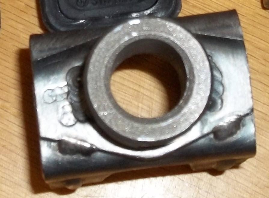

Finally got my shift rod coupler in from CIP1.   What was I thinking?   I remember thinking it would be interesting seeing how the cheapest one they have compared to one of the better ones they have.  Basically  $19 vs $42.   I guess somewhere along the way I was adding and removing various things from my online "shopping cart" and then finally submitted the order.   So it all shows up and there is only one coupler in there.   I apparently deleted one of them:  the good one.   So meanwhile this $19 one?  Who the heck would ever put that in their car/bus?   I totally get and understand the whole "you get what you pay for" but seriously this thing is just bent up metal crap.   Why even carry it?   I think it has more play in it than my worn one.  So now I've ordered the proper one.  Actually I ordered their two "best" ones as they are pretty close in price and if they are both good I'll always use the 2nd one sooner or later.
Meanwhile for fun and learning, I had my wife (engine off, bus up on ramps, front wheels chocked) go slowly through all the gears 1-2-3-4 and back down again multiple times while I watched and learned from underneath the bus how the shift rod coupler moves and how much for each gear.  Then I had her do a few 1 - 3 and back and 2 - 4 and back since they are kinda similar down there.   What amazes me about this all is how incredibly close 1 - 3 movements and 2 - 4 movements are.   It is barely discernible to my eyes that they are even different:  it looks to me like one is just a little more "tilted/turned" on the rod axis than the other.   Amazing that inside the transmission it can react to such a small difference.  I can certainly see why a little worn play in that coupler can mess up shifting.

My couplers are in!  My couplers are in!  Yep, a HUGE difference between the better two options and the crap cheap option.  And even at that one of them is clearly more heavy duty than the other one.   Get all my damned taxes sent in today so I can get back to enjoying life out under my bus putting in my nice new heavy duty coupler and everything will be happy again!
I will post photos of the three different couplers in the next day or two so you can get a good view of how different they each are.
Will this along with the clutch adjustment I'll do while I'm under there finally be the solution to no 3rd or 4th gear available when the bus is physically moving ?   I hope so.   I need to get some camping days in soon before the Summer Vacation crowds start showing up everywhere.

It can't make it any worse, bet it solves your problem.
Regardless of how "heavy duty" that coupler looks it's worth 10 minutes to weld the pressed in collar the shaft goes in to the sheet metal cage, 1/2" of weld on each side is plenty. In some cases that collar can get loose and twist in the cage, usually after letting a non VW person drive it.

Ok so got my nice new shift coupler installed this afternoon and adjusted the clutch cable.   I drove it off the ramps and checked that while sitting in the driveway with the engine running I was able to easily shift into all gears and let out the clutch lightly to ensure the gears were actually engaged and started to move the vehicle.   So far so good.  So tomorrow I'll get a one day permit and give Bart the '76 bus a quick road test.  I say quick for two reasons:  1. I'll know very quickly if I'm able to shift from 2nd to 3rd or 4th at road speeds or not.    2. The bus is backfiring lots and I don't want to draw undue attention that I don't have all the mechanical parts done up nice yet.  I suppose it's a pride thing.
Here is the new heavy-duty coupler happily installed.   It did not require extra welding to hold the pressed-in tube secure because on this particular version the entire armature including the tube is all one single cast piece of heavy-duty thick steel.   Very nice.   Still need to slide through the lock-wire into that grub screw and tighten it up so it cannot come loose.

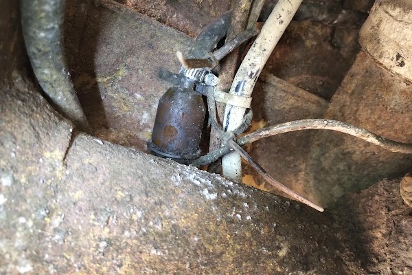

Meanwhile though, I did find some interesting stuff and one surprising thing.    The interesting thing is how a previous owner dealt with a new clutch cable that was apparently too long:
And the one surprising thing?  As I wrote in an earlier post, someone had worked on the bus at some point before me and chopped out the fuel filter and put a small plastic tube between the two hose ends that used to go to the fuel filter.  I fixed that up several weeks ago and installed a nice new see-through fuel filter just a little bit before the fuel pump.   However, look what I was able to see today once I was underneath at the right angle to adjust the clutch adjust wing nut?  Hidden almost completely out of sight up above the torsion tube.... and it's plenty old and dirty inside and out:
