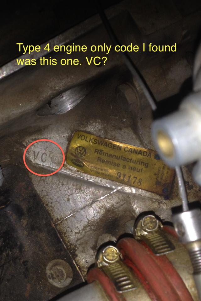

Look on top of the case near the left front, close to where the bellhousing flange starts.

Working on it.  Found a mouse nest.   Twigs.  Like big twigs.  How the heck do twigs get up in there?  Cleaned most of that out but not exactly certain where I'm looking (I understand the general area, just not exactly the location that the 1/2" x 2 stamping will be under the black hard burned oil/crap which means I have to clean my way down to bare metal.  I'm assuming not under the engine tin, though.....   I'll do some research tonight to see if I can find some photos of the exact location.

Sure looks like one from here, I wonder what kind of combination of starters, bellhousings and flywheels you have?
Here's the alternate engine code location for 411/412 and Porsche:

Ok, now I know exactly where to look.  Just two characters but that's all I need.   Meanwhile, I have a theory on the history of this bus and it's based on a little conjecture that is based on a fairly decent likelihood and a few findings and suppositions.   Here we go:
