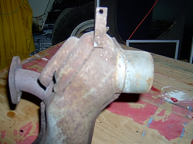

I followed advice and worked on the aluminum deluxe trim. For the beltline I used oven cleaner to get the anodizing off. Then 0000 steel wool and then Mothers Mag and Alum polish. It really shines. But for the window trim, I didn't bother with the oven cleaner. Just used the polish and steel wool together. Worked pretty well. Here's a pic of a half done piece.
9 years and counting....

Looking good G, but I see a few issues on the engine you'll need to adress before it goes in.
The front tin over the flywheel is for a beetle, the bus version has added sections on the upper corners to match up with the hole in the firewall. Those heat exchangers are also beetle, the cables won't reach the control arms, bus ones have a lever on the outside facing up. The fuel line zip tied to the heat riser tube is going to be interesting. I don't see any seals on the oil cooler exhaust ducting, recycled warm air doesn't help cool much. That alternator pulley might give you problems, watch the swaps for an OG one so you'll have one ready when it disintegrates. Once it's on the road you'll find out if that 009 needs some carb rejetting to fix a flat spot, that muffler may be OK, but some of the new ones are restricted internally and act like a governor ~55 MPH. The chrome parts are something you'll have to figure out the hard way, once again watch the swaps for OG parts.
The pulley, distributor and muffler are things that can be dealt with later, but the front tin, oil cooler seals and heater levers are easier to fix when it's out, now's the time for thermostat flaps as well.
Interesting garage you have there, cool!

Interesting. All the tin came off the bus. I pulled it, blasted it and painted it. The heat exchangers as well. I have another set so I'll compare. The cables were hooked up. The pulley was not off the bus. I'll check on the muffler. The chrome valve covers are going to be replaced. Those were temporary. Not my garage! I wish!
Re: 1971 Deluxe Project
« Reply #19 on: November 26, 2017, 10:46:59 AM »
Well it's not uncommon to see a bug motor slapped in as a unit from a junkyard find, not everyone can spot the subtle differences in the tin, especially if the bus motor is already gone. The 71 only tin has added "ears", the 68-70 also works but you have to cut a hole for the oil cooler exhaust. I made up a few pairs of ears years ago, I'll see if I can find you a pair that you can weld or screw on.
The heater levers can be adapted by removing that linkage on the inner sides and bending the lever back over on itself so it faces upwards, if it was somehow connected before you'll have to fix the cable tubes as well since they must have been cut loose and bent to reach. Here's a universal replacement heat exchanger with both lever styles for comparison.
Another thing I just noticed is the generator, if it's a 30 amp Beetle version opposed to the 38 amp bus model you'll need a 30 amp voltage regulator or the generator will die from overwork. It looks like it has the 38 amp tin, make sure the pulleys align now since the bug generator is shorter.
The pulley looks like an EMPI product, some last OK, but more often that not they get loose and wobbly fairly soon, make sure you have at least 10 shims in the stack so the cupped washer clamps down tight when the nut is tightened up.

Changed the tin and the heat exchangers for the correct ones. Had them from another motor. Also the valve covers. Paint is done. Now to put it back together.
