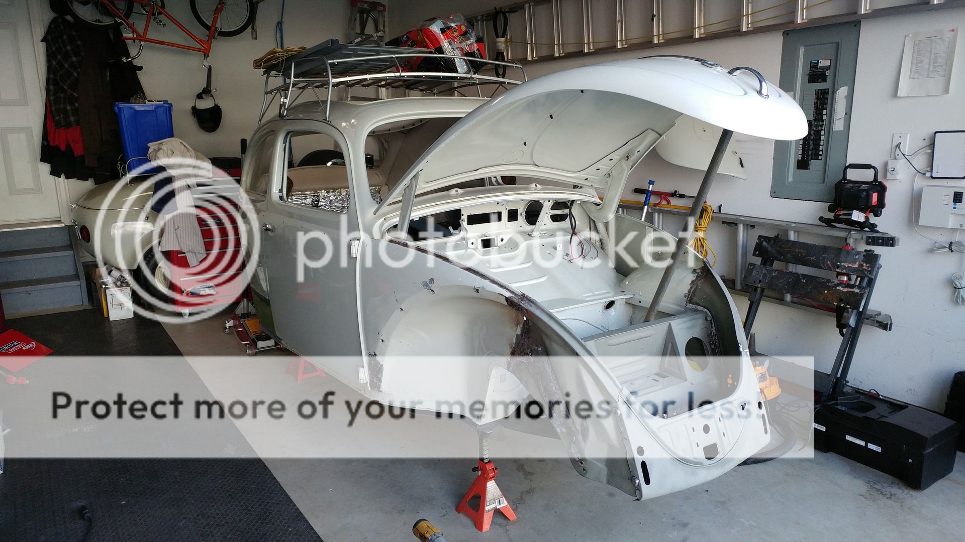

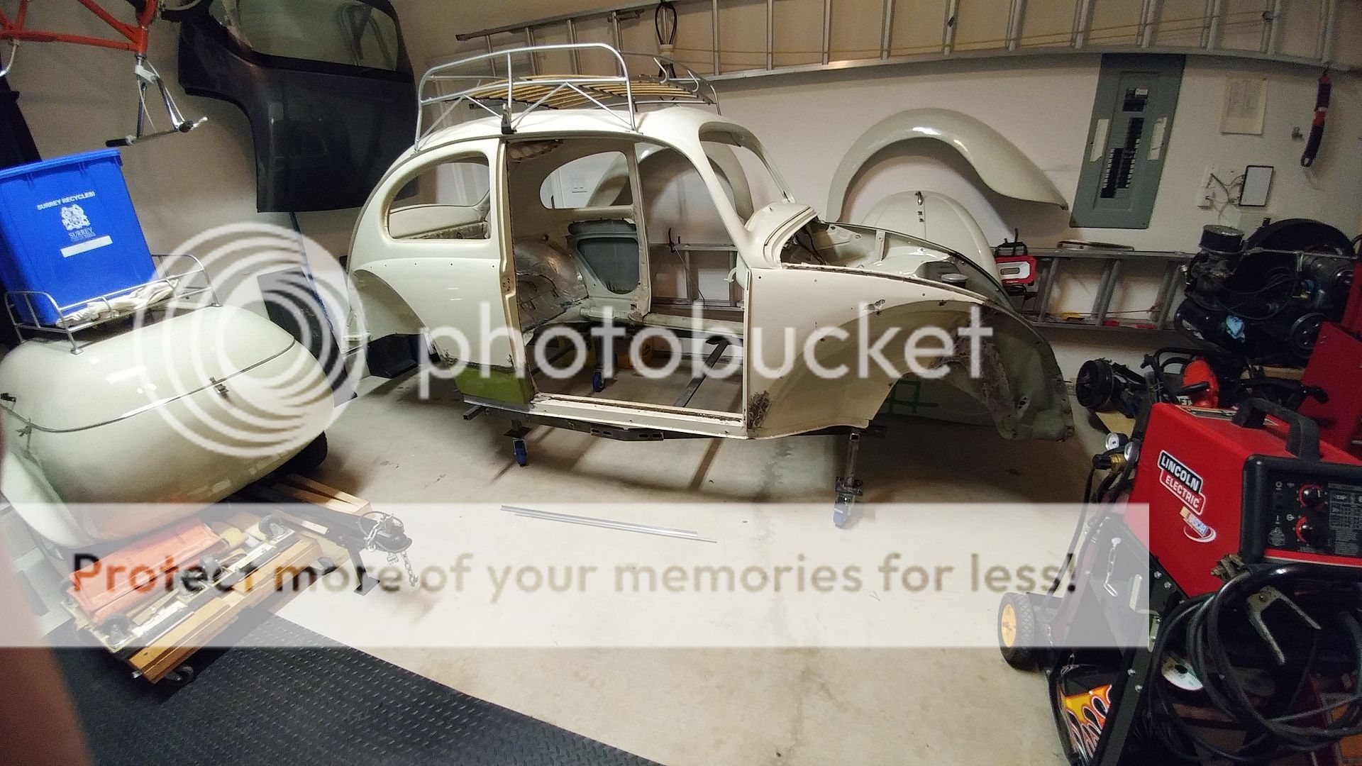

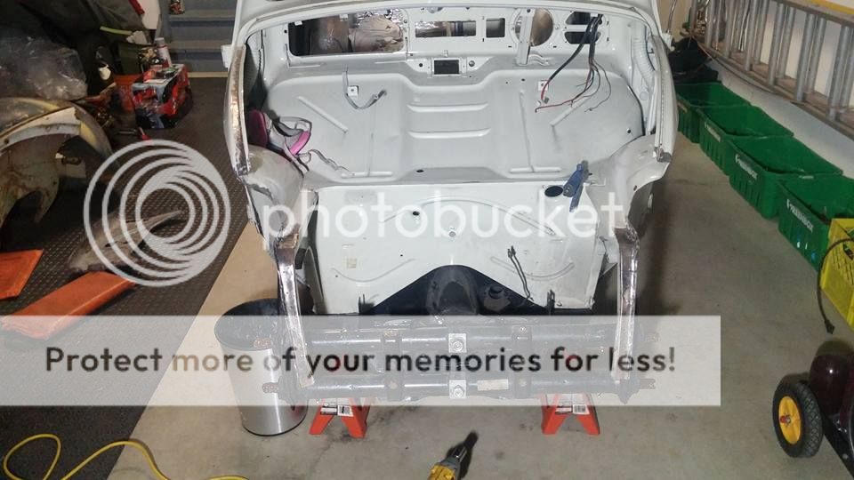

Well I have been rolling in my 58 for 6 years now and felt it was time to give it a little love. Since getting the car most of the power train has been upgraded (Engine, tranny and brakes) and a rag top with new interior were done. I have been collecting parts over the last few years so I could redo the body to make it all 58 part correct and plus redo some old repairs. My goal is to end up with a nice clean Cal-look car that I can drive down south at some point. The main areas of repair needed are the driver rear bumper mount, both lower rear quarter areas and the front clip. I also have a four tab hood and wire tube fenders for it. Not sure how far I will get this winter as I have given my self two winter to complete this work. This means you my see me rolling in a part finished car next summer. I started this week by stripping the car down to start making the list to figure out a plan of attack. Well here we go....will down some pics later.

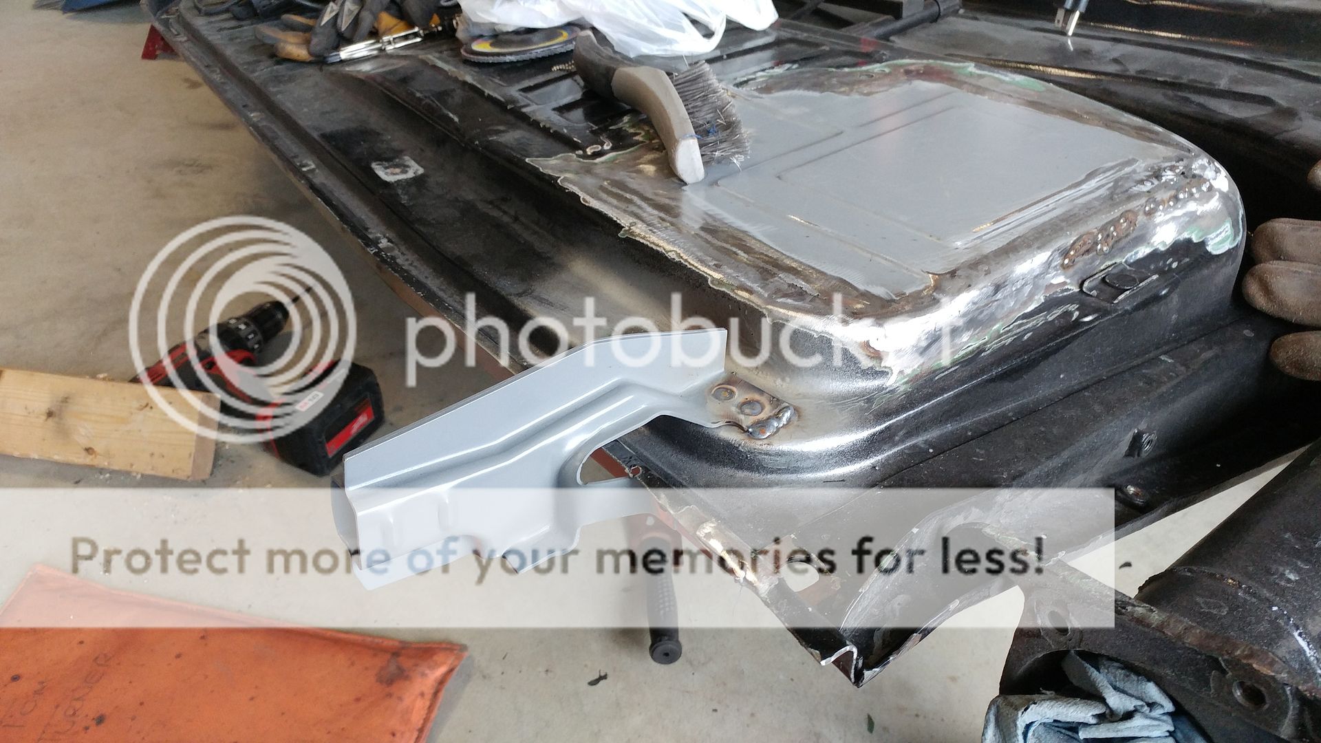

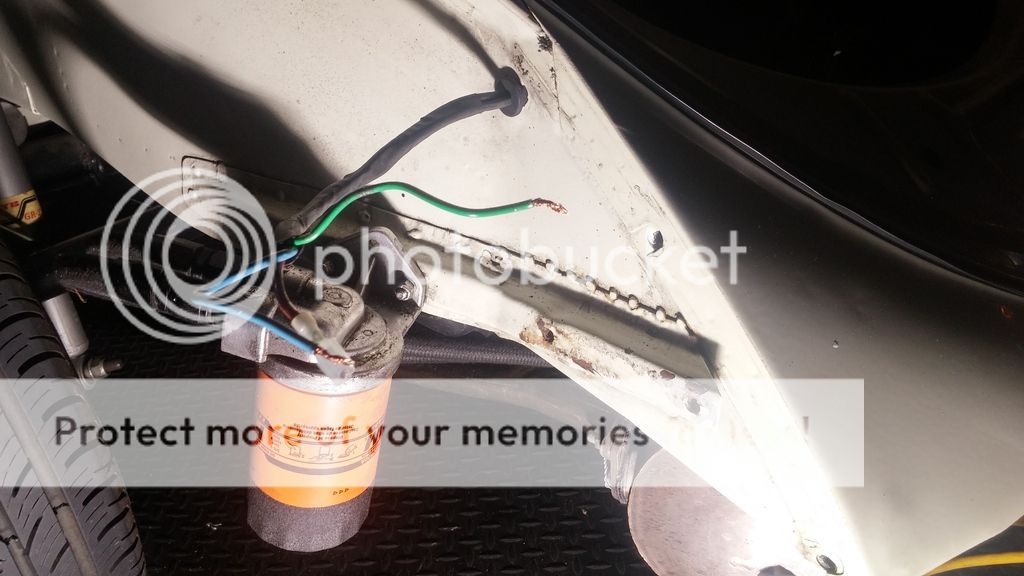

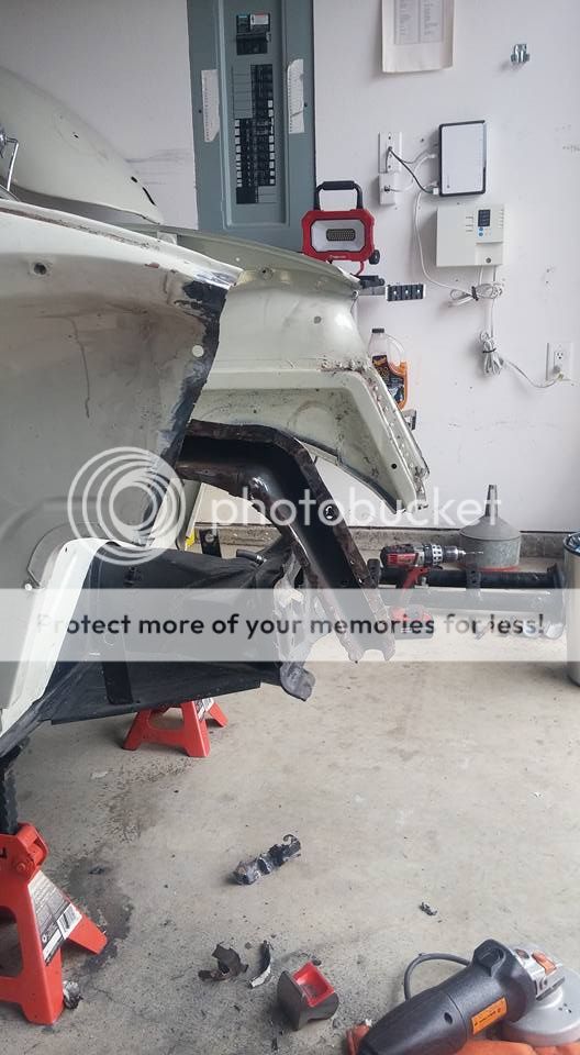

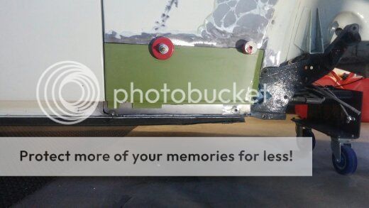

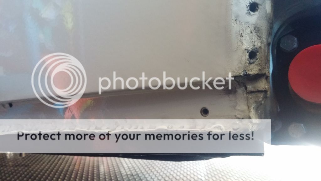

Started the repairs on the 58. Removed the bumper mount and replaced the old repairs. I replaced the mount with a new one from Auto Craft.

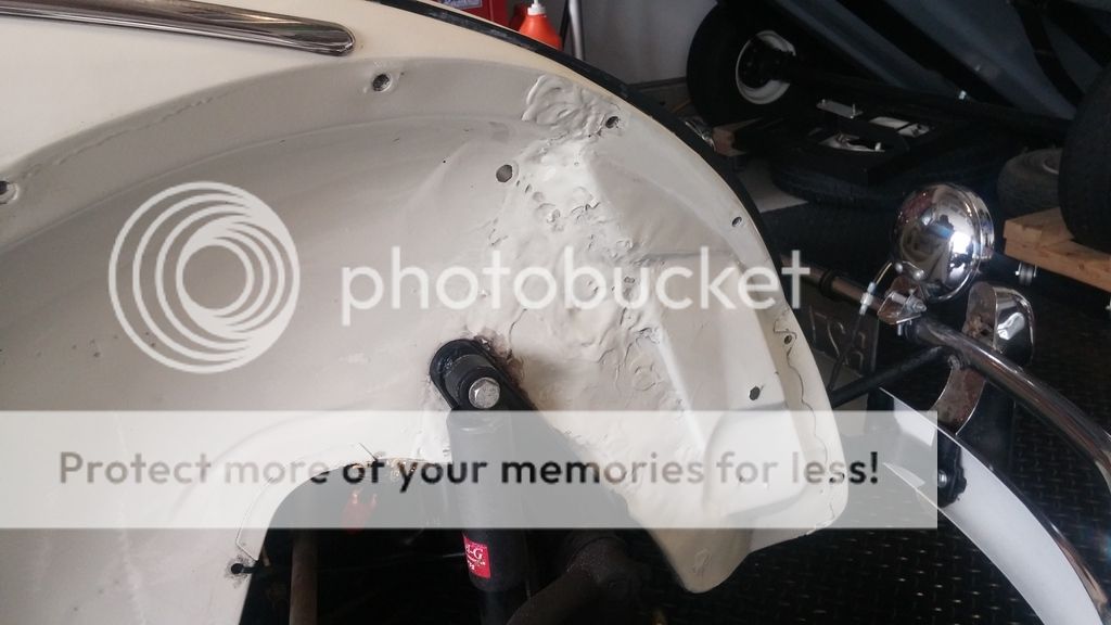

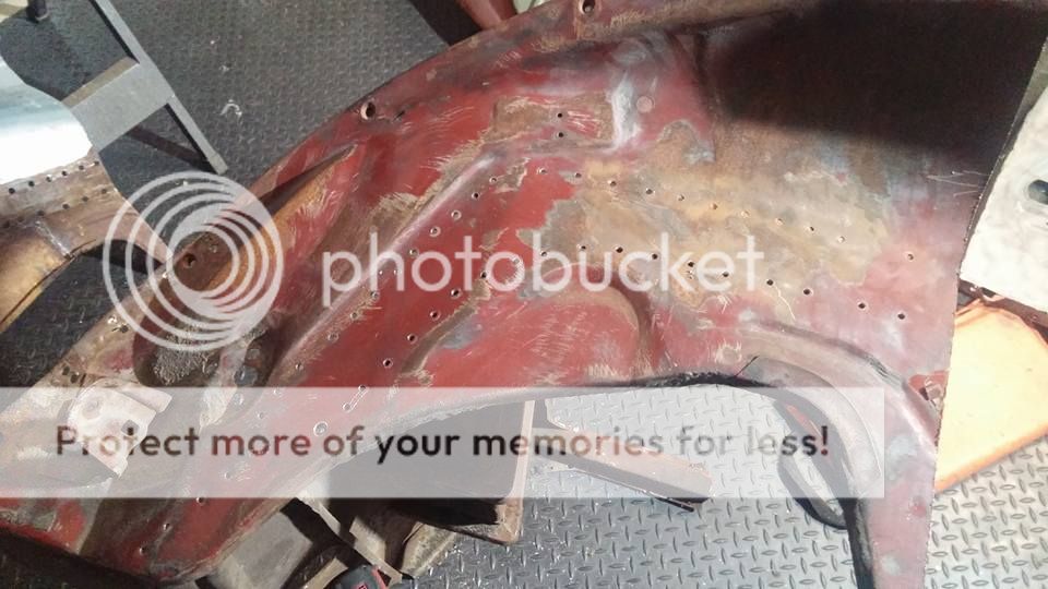

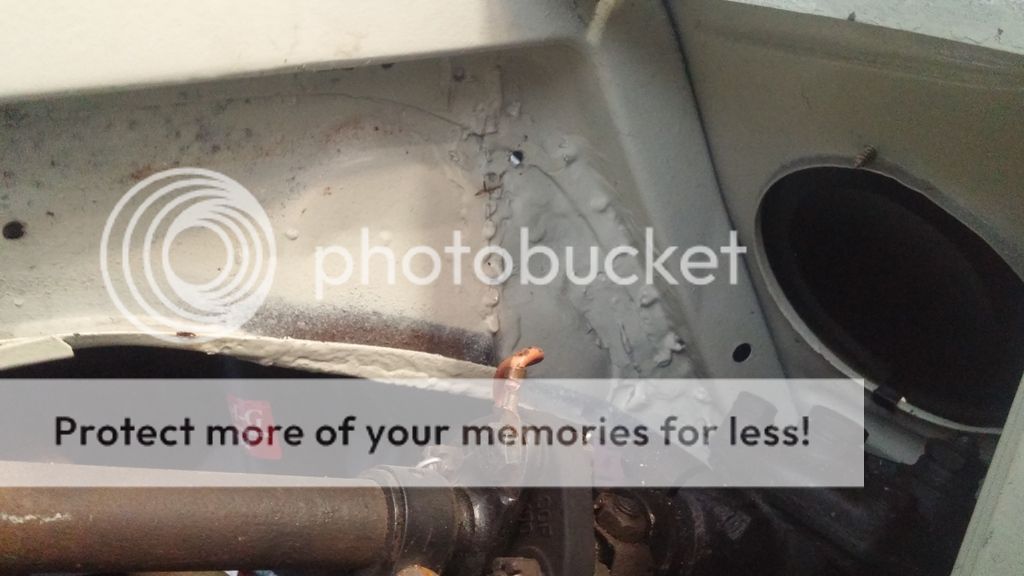

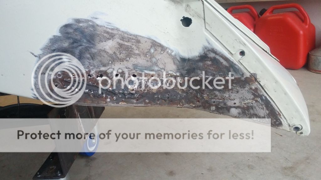

Well a quick update. I have opened up a couple areas of old repairs and found some more repairs are needed inside.

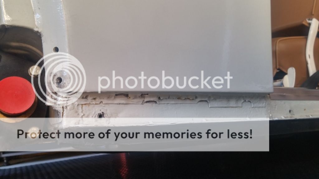

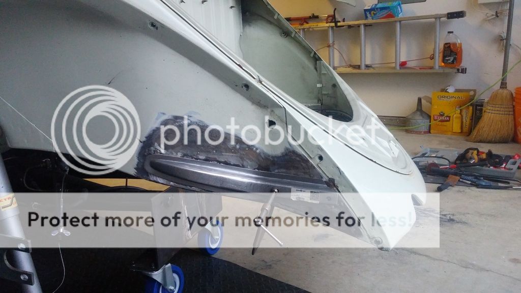

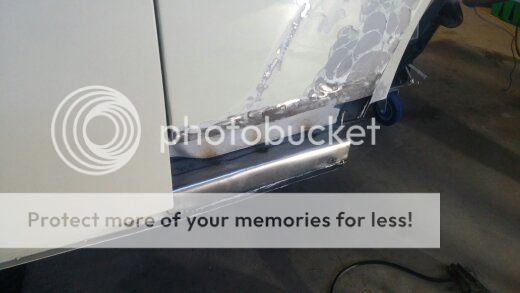

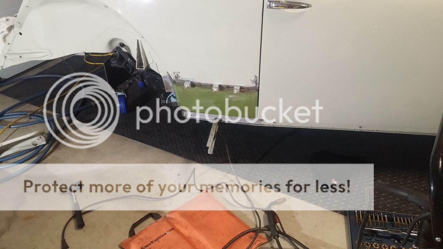

Some updates on the repairs. Heater channels repaired and lower panels fitted and welded in place.

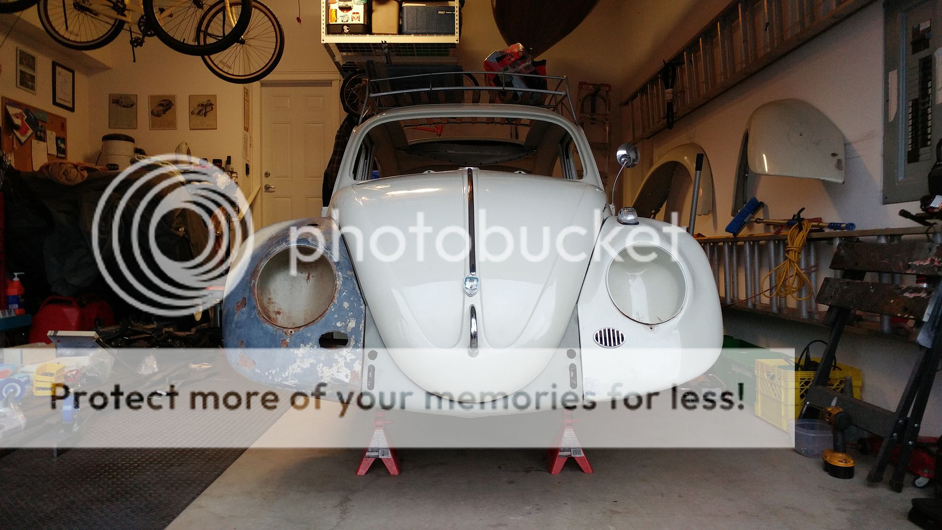

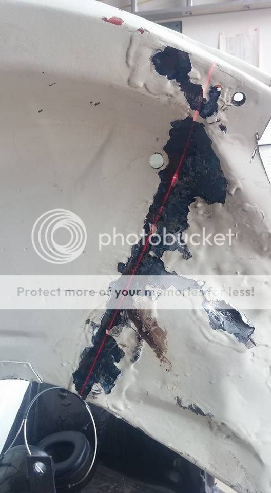

Started on the front clip. I saved the inner supports so I would have an original part to work from. I separated to clip apart and placing it back piece by piece it help with alignment.

Nice 58' Thomas!  Looks like your panels are lining up nicely, I like the laser idea, that's pretty slick!

Well in the picture it doesn't look a whole lot different then the last ones but a lot of hours put in. It took a couple tries but the clip is in place. I have some final tweaking on the apron then weld it in place. Hoping to pull it off the pan soon so I can get some repairs done then off for blasting and powder coating.

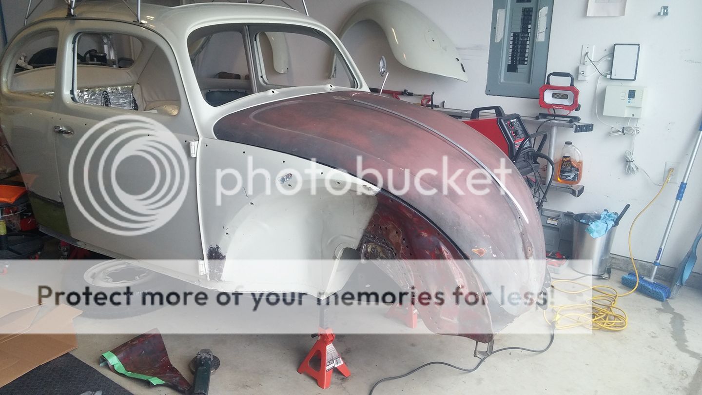

Well got lots done this weekend. Did one last test fit on the front end to make sure everything was still good after welding up  the clip. My hood had the usual side crack issue so I took a section out of the spare hood and replaced the bad area. I also managed to get my car dolly built so I can separate the car from the pan soon. Hoping to have the pan repairs done quick so I can get it off for blasting and then to Russ for powder coating.

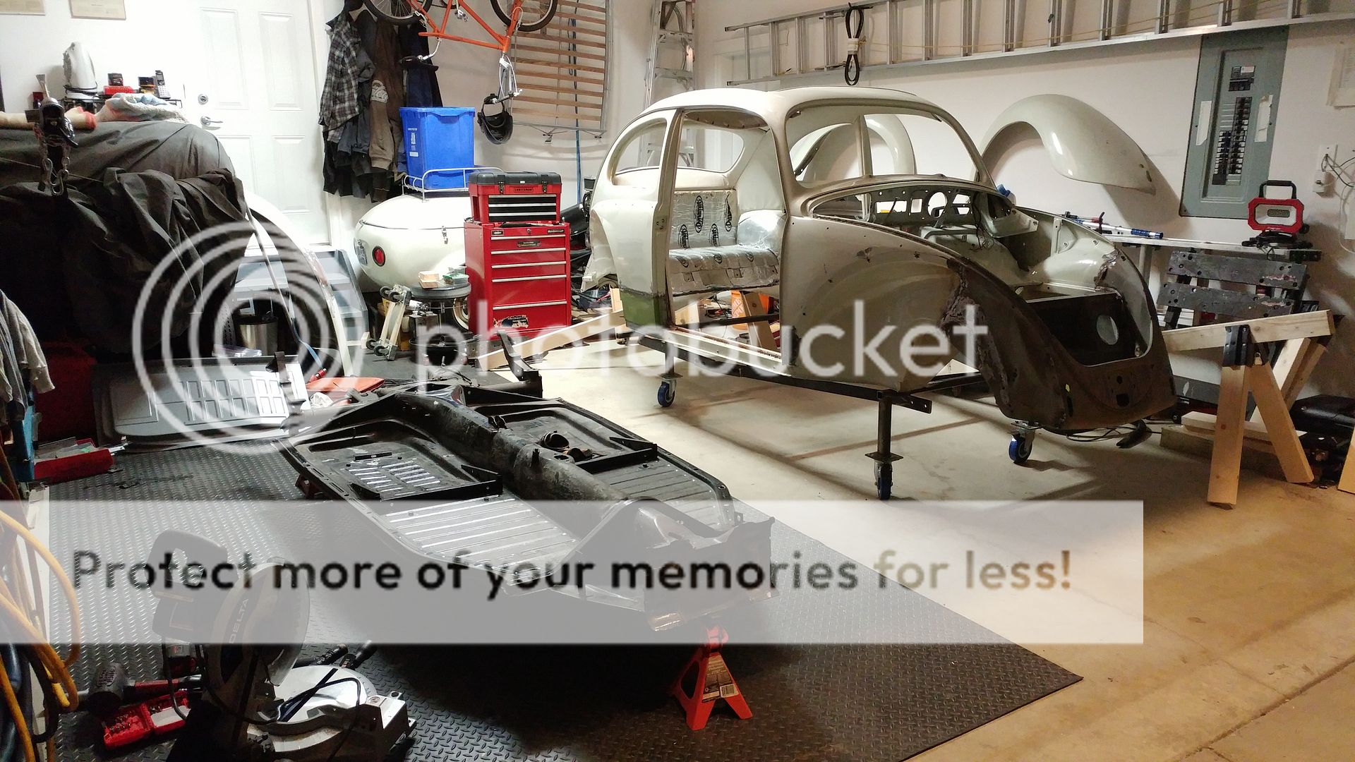

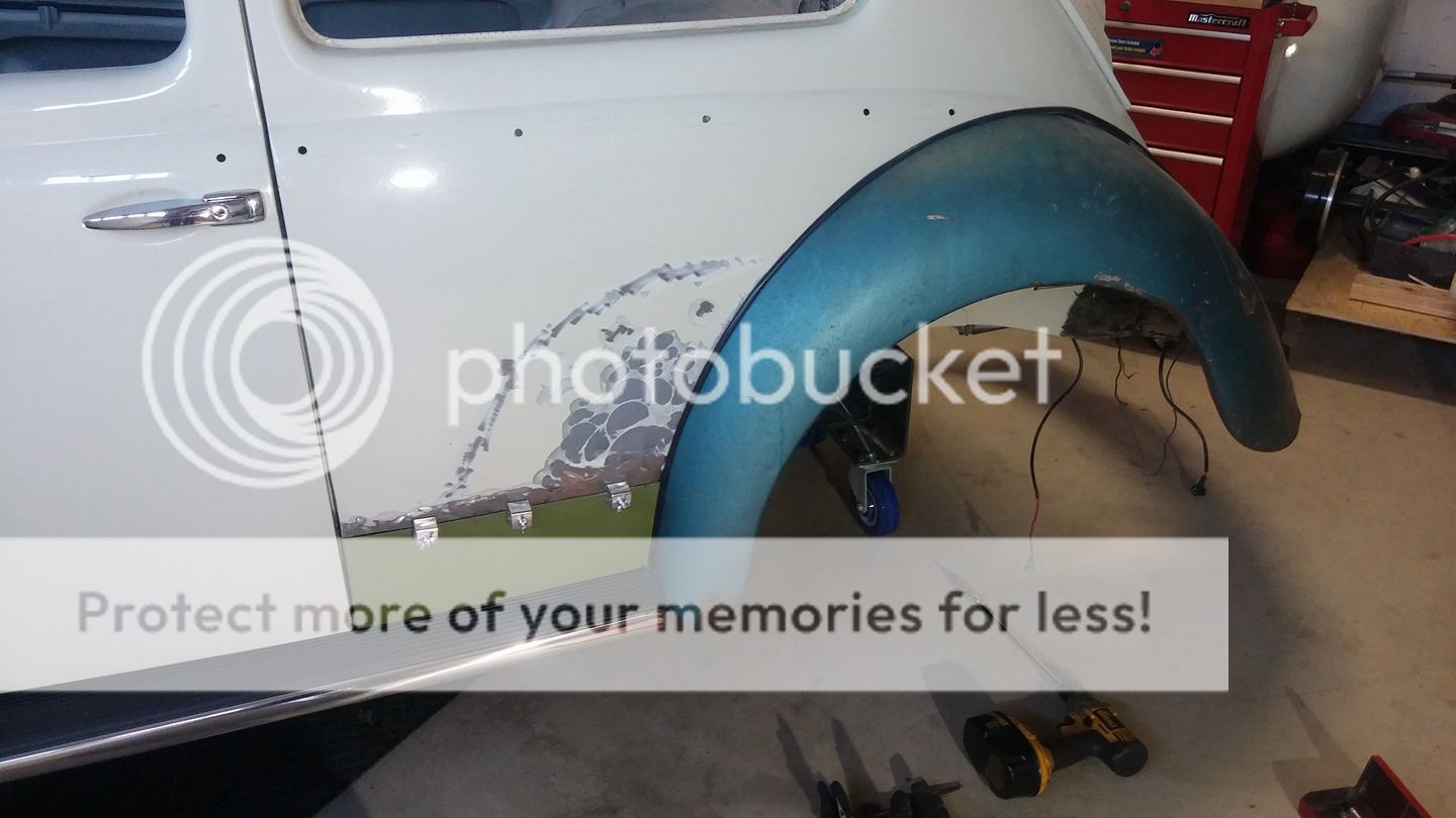

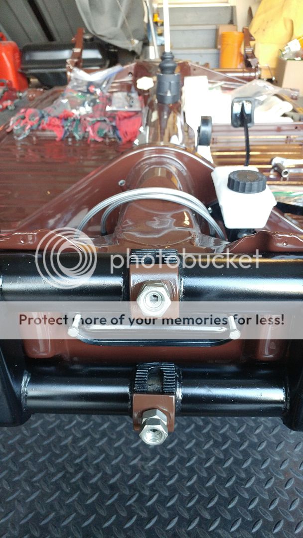

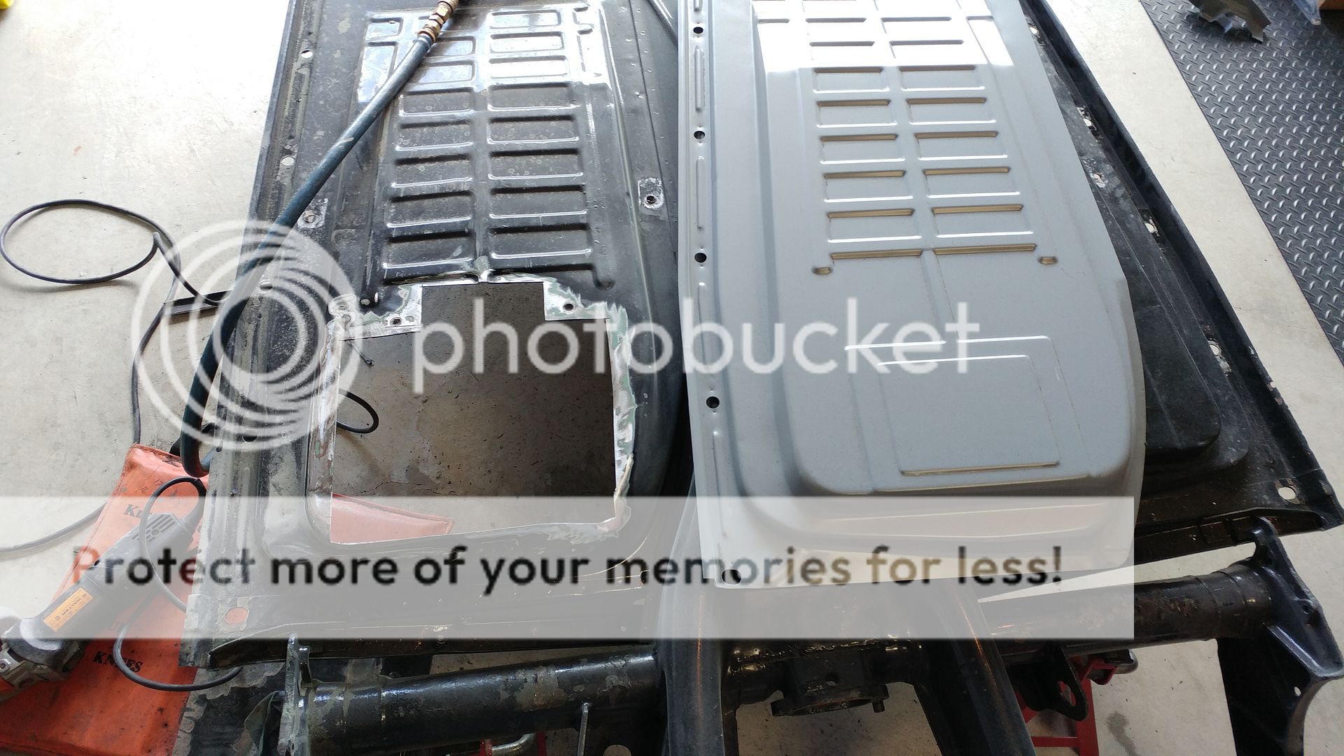

Started the pan repairs. The battery area had a old repair that I replace with the proper metal from Wolfsburg West. I also put the jack points back on the pan. Going to make a pedal access door and a few more small repairs before off to the blaster.

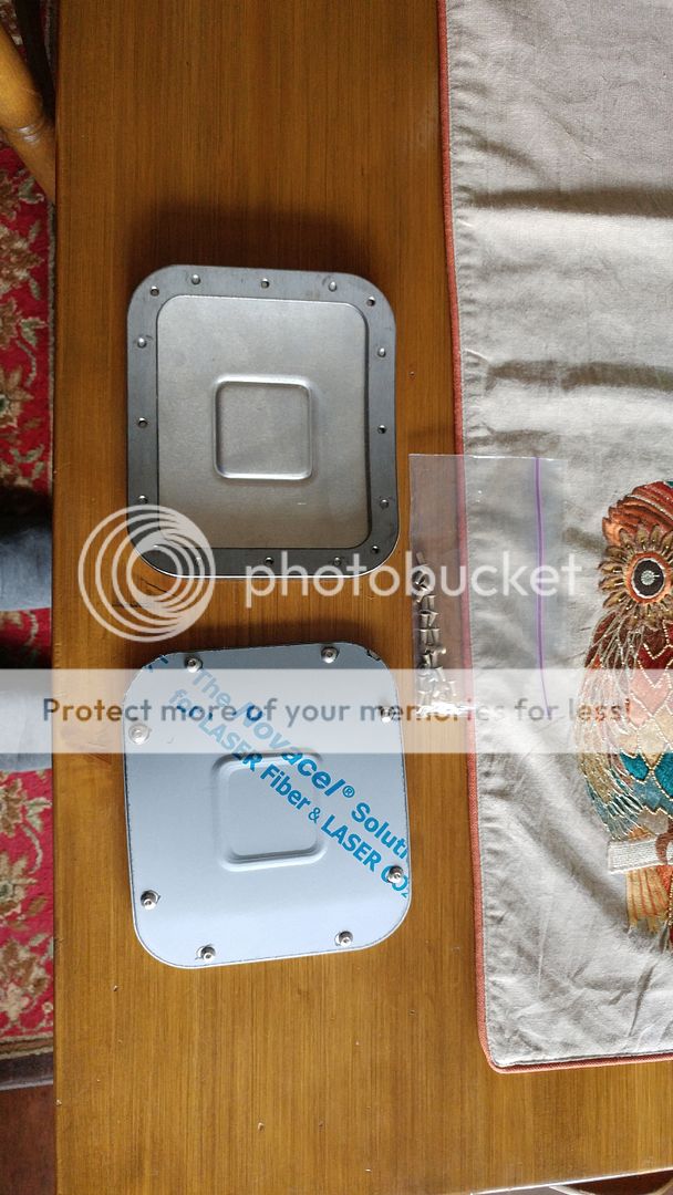

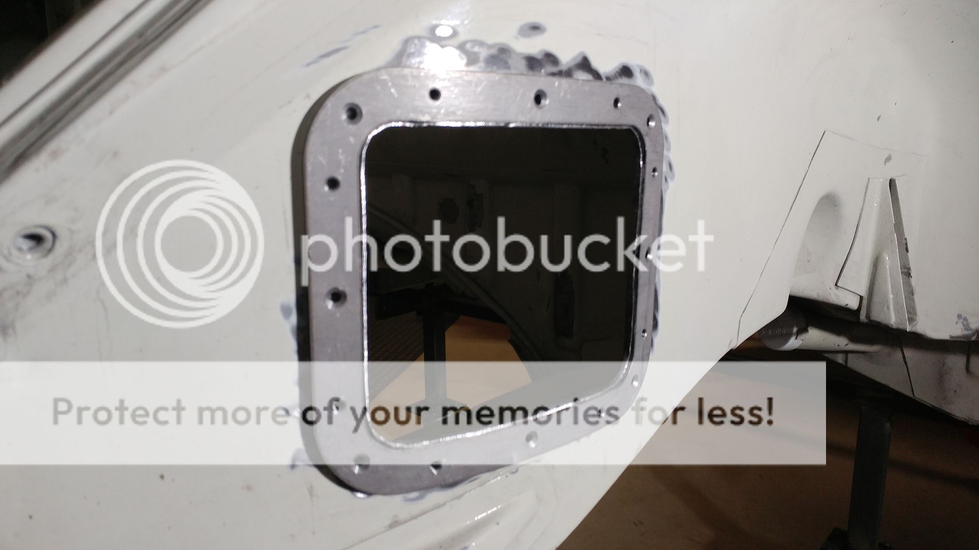

Well installed a pedal inspection door on the pan and sent it off to be blasted. Time to finish up all the welding on the body.

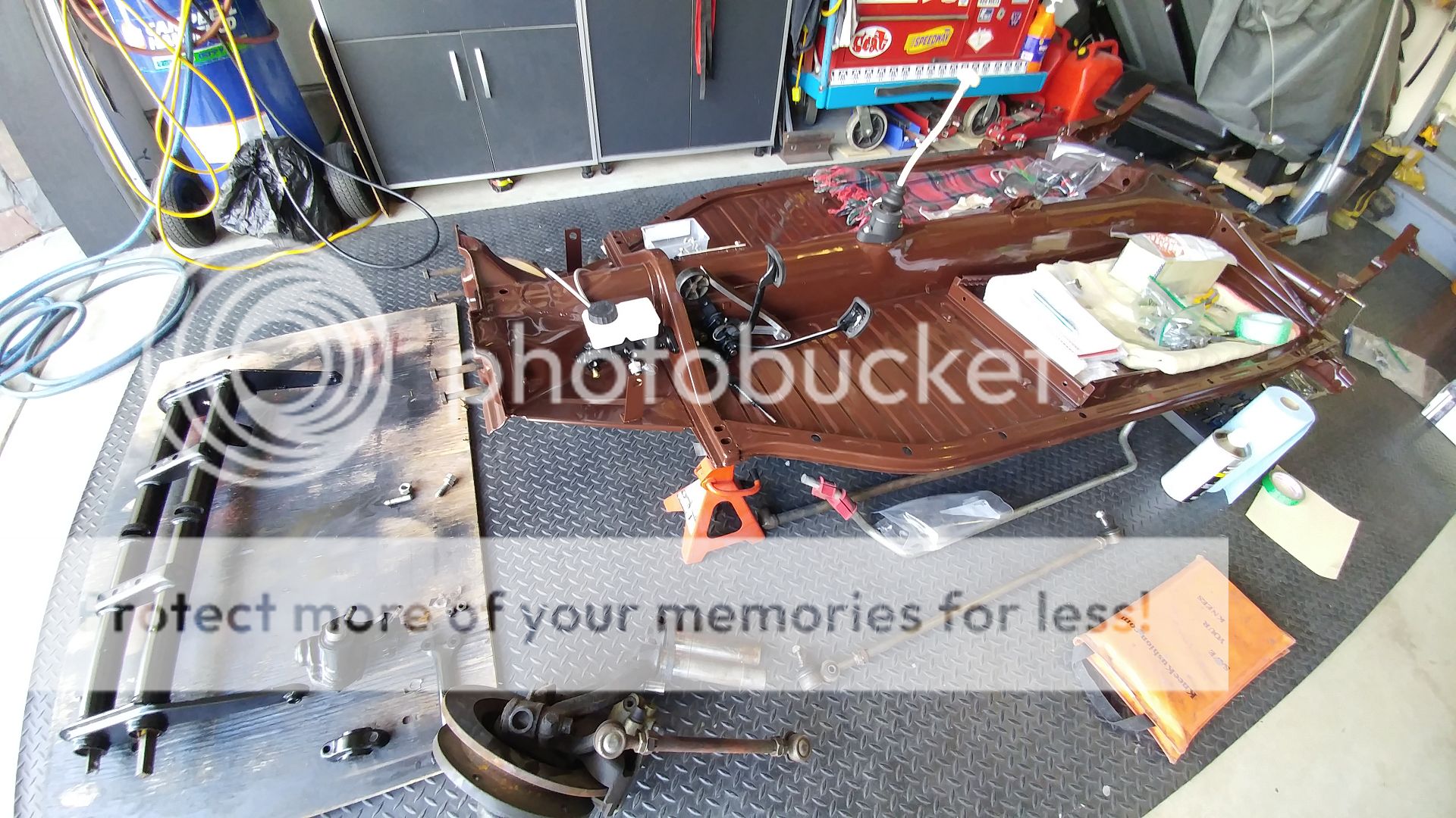

A few updates. I  installed a set of GAB FAB carb windows on the car using the write up in Hot VW as my guide. I also got the pan back from the Powder coat guru  Russ Scott. Been putting parts back on the pan as I inspect, repair, paint and piece them back together.

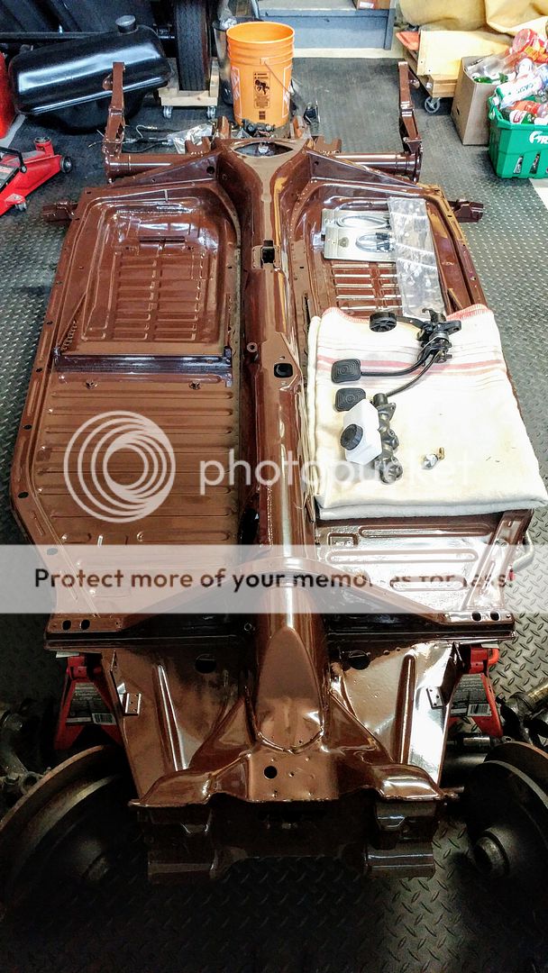

A quick update on the 58. I have the pan back on all fours again. Next up is to build a booth in my garage so I can get started on the body work.
