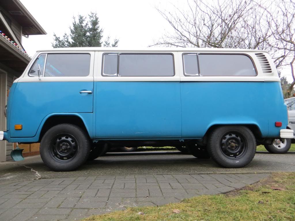

This is my project.  It is a year round driver but there is plenty left to do.  I figured it would be a 3-5 year project and I am approaching year 4 in a couple of months.
Most of the mechanical items have been resolved.  Westfalia interior is mostly complete with the exception of a head banger closet. Installed a big AGM battery (under the back seat) and 110/12 volt electrical system last summer.  No problem handling the original Dometic 12 V fridge.  Still need to figure out some auxiliary heat for those cool overnight trips.  Espar D2 or Propex 2000 are the choices.  Both are thermostatically controlled and very fuel efficient.  The propane unit is a little more costly as I will need a new tank.
I also installed a set of proper winter tires in November so I don't have to worry about ice and snow.

« Reply #7 on: January 03, 2014, 06:25:57 PM »
Hey Hansk. What size are those? I like em.
Re: How are the Bay projects coming along?
« Reply #8 on: January 03, 2014, 11:29:22 PM »
 Those are P225/70/15s  so still not LT rating but oh well.  They're on eurovan rims which actually DO NOT work on a bay.  Everyone else probably already knew that but I just had to try and make them work anyway. Don't try this at home.
« Reply #9 on: January 04, 2014, 07:49:31 AM »
In 1993 I put euro van wheels on my 71 bus. All that was needed was to enlarge the center bore for the bearing hub to pass thru. The fwd offset worked good on a lowered bus.
A better way to go is the 15" Benz steel wheels.

« Reply #10 on: January 04, 2014, 09:05:55 AM »
Thanks Hansk. I've increased the centre bore on a few sets of Audi and Mercedes rims over the years. Not a big job.

« Reply #11 on: January 04, 2014, 04:29:38 PM »
Yes but to have these steel wheels properly machined would not have been cost effective in this case .  So I went red neck back yard  , now they fit ... but can never be balanced again ,  plus I'm pretty sure the wheel has been weakened somewhat .  I can live with this but would not recommend it to anyone .

« Reply #12 on: January 04, 2014, 04:49:07 PM »
I think you can balance the wheel and rotor/hub together as the bore in that will still be in the right place. Problem solved.

« Reply #13 on: January 06, 2014, 09:27:58 AM »
True but the other issue with these is the bolt holes are up off the surface of the rotor more and probably should have longer studs . I agree with Geoff , mercedes wheels would be better.  I think in the long run I would go with one of the 27/8.50/14's LT tires out there on stock wheels.  Same outer dia. as these.
