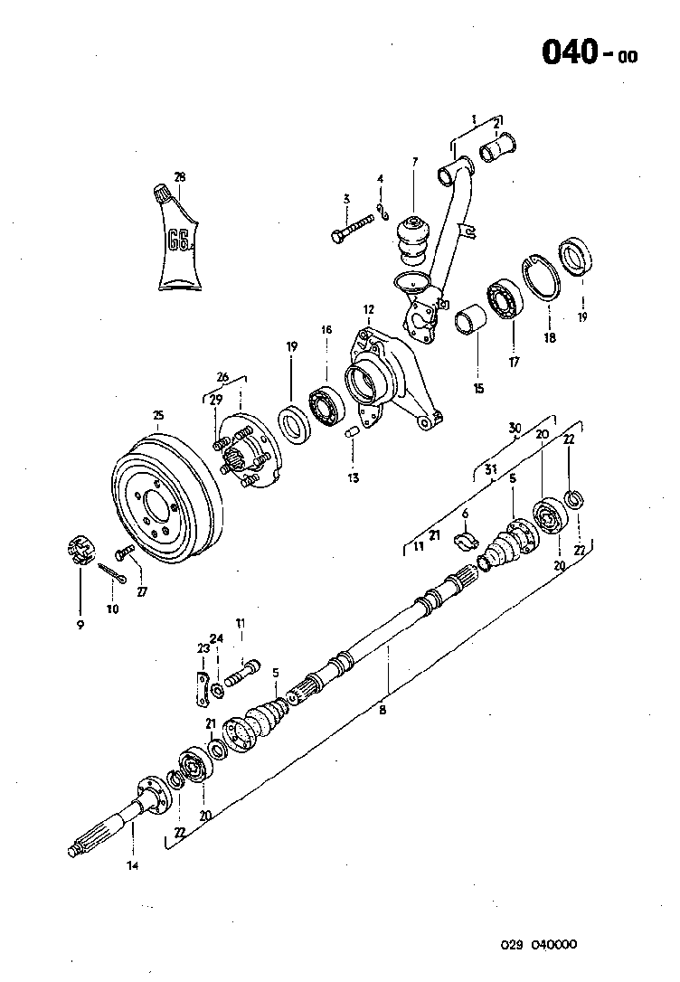

Some early ones did have an internal hex or allen style bolt, clean yours up really good with brake claener and a dental pick. as for securing them they use special serrated washers and link plates between each 2 bolts, miss those and you'll be retorquing weekly. #'s 23, 24 & 11 here:

My set up is as shown in the diagram (I have 11, 23 and 24) and I am continually tightening them with vice grips. I have cleaned a few and they do seem to be round, but I will give them another good cleaning tonight to double check.

My set up is as shown in the diagram (I have 11, 23 and 24) and I am continually tightening them with vice grips. I have cleaned a few and they do seem to be round, but I will give them another good cleaning tonight to double check..
You'll need to get them cleaned up or replace them, Vanagon's use 36 foot lbs torque even though it's the same part as the bus, apparently VW thought tighter was better later on. Rather difficult to use locktite there as the grease from the CV is all over the threads no matter how careful you are, some have drilled the heads and used lock wire but good parts properly torqued don't need it.
