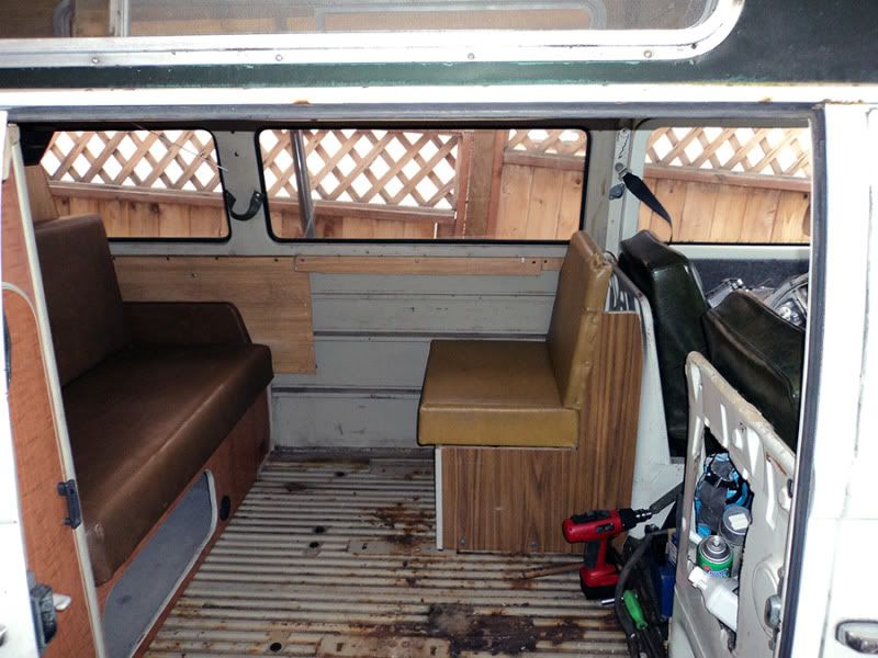

interrior mocked up, what you'll basically see when you enter "THE HALL OF THE MOUNTAIN KING" (said Vigorously with the loudest of loud manly man voices(with a touch of german accent thrown in)

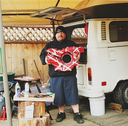

my Frankenstein fanshroud..

Lanny will love that shroud! ;D
Nice bus!
Nice bus!
thanks, she's a bit rough round the edges but a gem none the less!

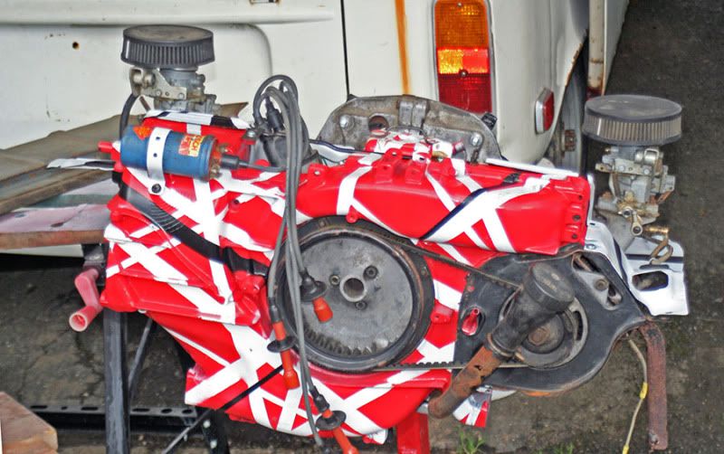

heres some of the engine tin on,just waiting for the front tin to get blasted then i'll finish painting it. i ended up doing the cylinder tin in the black & white frankenstein theme...probably wont stay white for very long.

Most Van Halen like. Looks good.
thanks.

finished up with the painting today....then again, who knows i may find something else that needs Frankenstein stripes  :P anywho, finished cleaning the gastank and putting it back together. reinstalling tomorrow then hoping to
get to test starting the engine in the next few days.

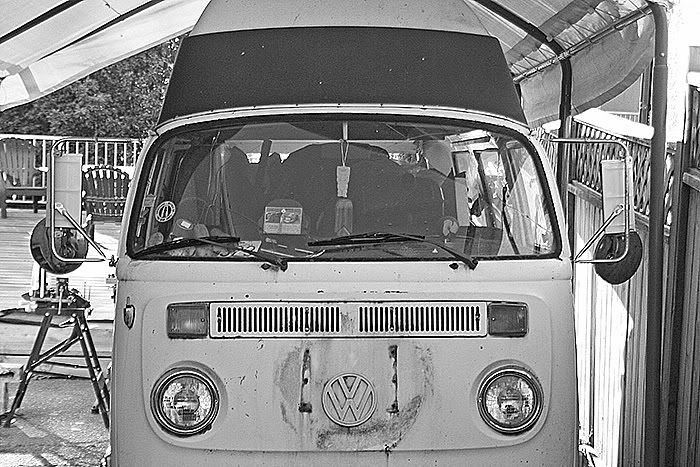

stock mirrors gone.....new mirrors on,I found a set of NOS west coast mirrors for a good price.getting closer now, just need to get a new windshield installed and reinstall engine...woooohoooo!!

Its FINALLY in!!!!
