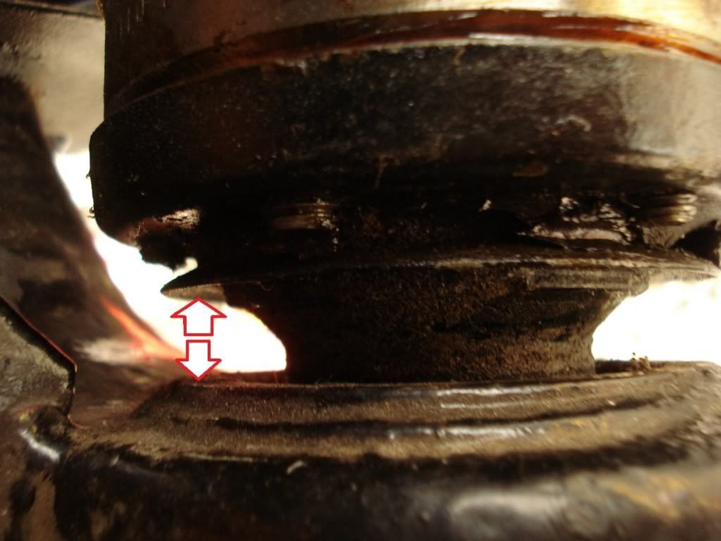

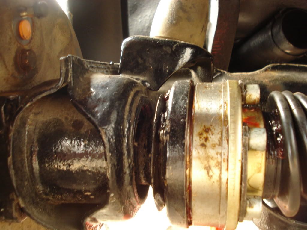

Re: IRS rear brake problems
« Reply #5 on: April 09, 2010, 05:37:33 PM »
is there suposed to be this much gap? wtf
Billyisgr8
« Reply #6 on: April 09, 2010, 07:51:51 PM »
Your axle stud has to go way in, that flange should practicly line up with the edge of the bump on the trailing arm.   Bottom it out to the bearing.

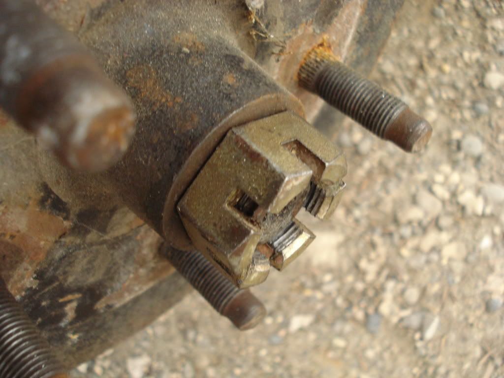

I just went out... first I took everything apart, put the bearing cap and drum on with the same result.  Next I removed the CV joint, and tried to tighten the axle nut, it made no diffrence at all.  I even tried to tap the CV flange with a hammer and it wouldn't budge.  How can I remove the stud?  I can't get it to budge in either direction.  Do I need a bigger hammer, I didn't heit it that hard, can I damage anything?
oldbugger
« Reply #8 on: April 09, 2010, 09:10:24 PM »

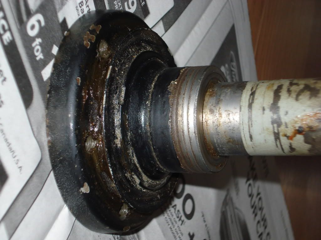

take your drum off  remove the cv axles and put the castle nut on backwards  and wack it with a big f@#* hammer [it will pop out] then check if theres an extra set of spacer on the back of the stub . are those Type 3 automatic axles? if so they are shorter then standard trans one about a inch so the cv axles may be holding your stubs back
« Last Edit: April 12, 2010, 08:50:22 AM by oldbugger »
Offline somevwguy
  • Posts: 219
  • Jeff
    • strictlygerman.ca
« Reply #9 on: April 10, 2010, 01:09:58 PM »
Well it turned out that there was an extra spacer on the stub axle. I removed it and cleand all the paint off the first spacer, greesed everything and it all went back together easaly.  Thanks for the Help   You_Rock_Emoticon
