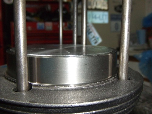

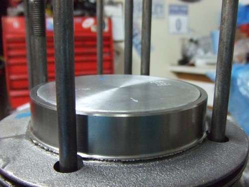

Here's my "deck height"...I'm assuming I'm going to have to start with shims in order to sort these out? I placed one of my V-blocks across the piston and measured the height between the piston and edge of the cylinder.  1, 2 & 3 are 0.007", #4 is 0.008". Well, for what those numbers are worth. The cylinder's are just 'resting' on the case (couldn't torque them down without making something on the lathe, lathe is across town).
So here is where I get stuck...sort of. I figured after measuring the deck-height I would have a theoretical compression ratio and thus a starting point for a discussion on what I should be aiming for. But since I have to shim just to get the clearance Bentley calls for, I guess we should start that discussion now? Final build is a 1776 and I'd prefer to run on regular gas. I put 45,000 miles on the bug last year so overall life of the engine is more important then absolute power. What should I be aiming for, and thus what barrel shims should I be ordering to start with?

A conservative CR would be 8.0:1.  Then you can use cheap gas in cool weather.
You'll need to shim the cylinders up from the case a bit.  When you're setting your deck height, do not go with more than 1.5mm.  1.25mm is good.  1.0 is risky.  At that DH, you may run into the piston hitting the head.  The tighter the DH, the better the resistance to pinging.  I like 1.25mm for my use.  Lower reving engines with short stroke cranks can take less DH.  However, China cranks........
Re: Dave's Engine Build Questions
« Reply #5 on: March 29, 2010, 11:52:10 PM »
Alrighty then, a set of .060 shims should start me off in the right direction...at least get me to a point where I can measure something.

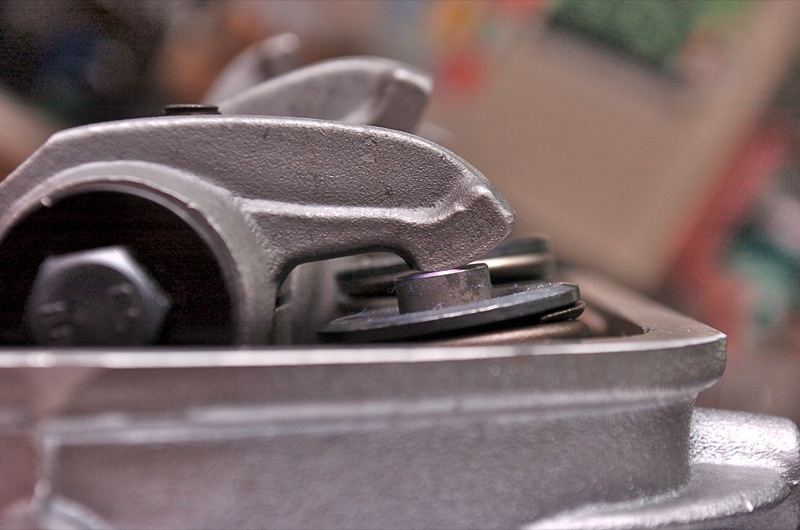

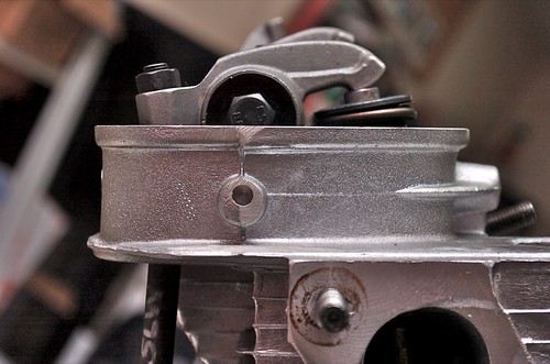

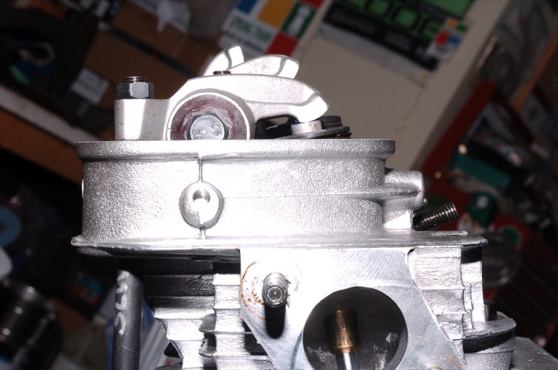

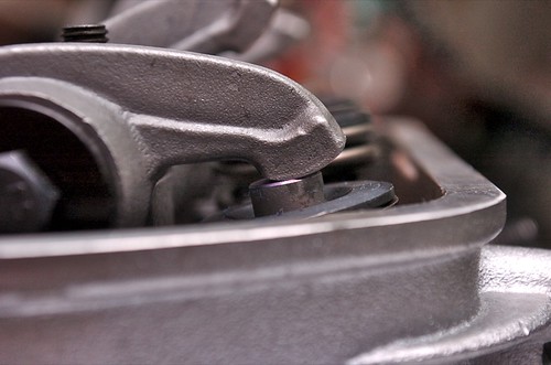

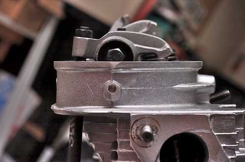

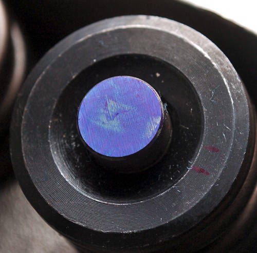

Alrighty, had some issues with the valve train geo, spoke to Darren and picked up some Lash caps this morning to help me out.
As I understand it, perfect valve train geometry is going to end up being a compromise between the wipe area on the lash cap and the angle of the pushrod to adjuster. Here is where I've got it set currently, with no shims. The pushrod is an adjustable rod set to loose-zero.
Zero Lift:
Half Lift:
Full Lift:
wipe area, which I think is pretty spot on?
If I understand this correctly, for the pushrod side of things at half-lift, I would ideally want to add a spacer under the rocker shaft mounts, which should straighten the slight angle out that i can see in the photos. But doing so will move my wipe area up on the valve, and I'm pretty much centered right now. I *think* the valve side is the more important of the two, considering how close I am, so I should just stick with what I've got here. Correct?
Billyisgr8
Re: Dave's Engine Build Questions - **Now Valve Geo**
« Reply #13 on: April 14, 2010, 03:59:56 PM »
I would still put a .060 thou shim under the rocker shaft and see where it ends up.  You can use a regular washer if you don't have any proper shims.
Kevin
« Reply #14 on: April 14, 2010, 10:19:12 PM »
What you have is no good.  The pic you have of full lift is what it should look like at half lift.
