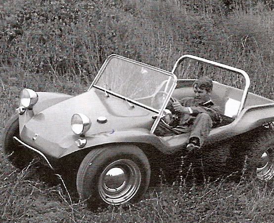

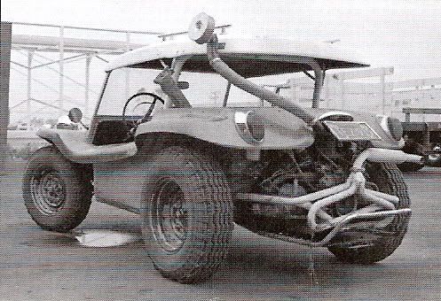

A few cool shots from back in the day.
Some taken at the BF Meyers shop
