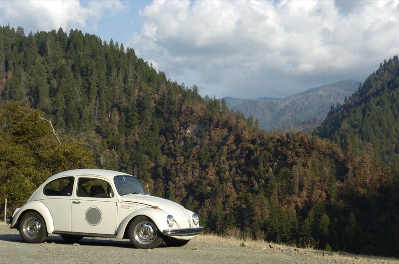

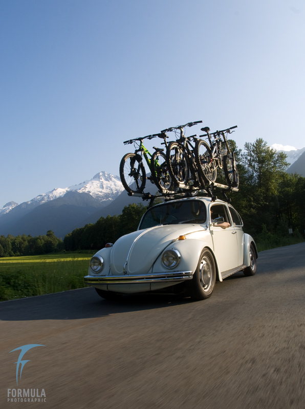

Love the ride! The shut-off valve at the tank is a smart idea. Might have to add one in to my '75 when I do the front beam.
What do you have your front beam set at for height? Looking at your photos I'm thinking your front suspension hasn't settled yet, as I'm running a stock beam with CIP drop spindles and mine is way lower. You might want to give a few cycles of the front suspension to see how it settles out.
Here's my car with drum drop spindles:
And here's a shot with the disc drop spindles...basically the same, but the upper image shows the drop better.

Since this is a 2"up/2"down beam this setting will raise the front 1.5" but with the 2.5" drop spindles it will actually only be about a 1" drop overall. With this beam I can adjust it back to stock height if in the future I put collector plates on, or go lower. Basically I can go from 0.5" drop to 4.5" drop.
The shut off valve came in handy later when I had to remove the tank again.;D
THAT explains it. I hadn't realized you adjusted for just an inch drop.
