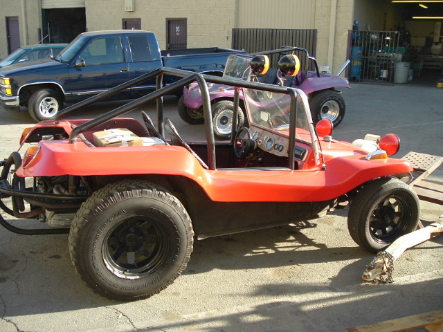

« Reply #2 on: February 02, 2009, 04:14:36 PM »
.. found this pic of a buggy that looks like yours.. :D
Rob
1957 dune buggy
2002 beetle

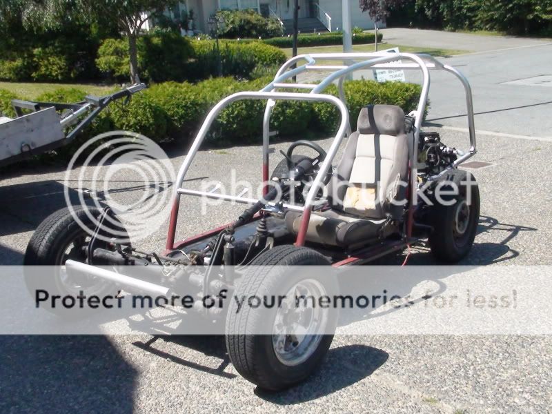

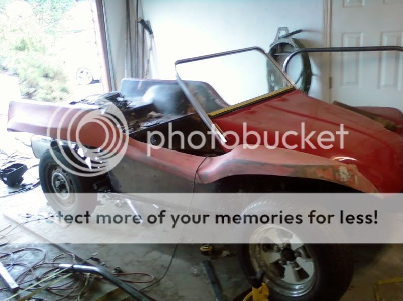

So I finished the flooring and got the IRS swap done, here's some pics:
There's a gas can in the back I'm just asking to blow up the garage!
Rotted chunk I had to cut out and replace
The bottom finished
As it sits now
IRS bracket welded
What do you guys recommend for chassis paint, lots of people recommend the POR15 route what do you guys think is best for the condition here?
Here's a 3D model of the cage I'd like to build. Before modifying the pipe bender I broke it and after working with it for a bit I didn't think the mod was going to work for me. Right now I need to figure out what I'm going to do for a tube bender and get to work.
And finally I ended up getting an engine that I think I'll use for a swap, it's a 4af out of and 89' corolla, I got the whole car for $200 with 220k but it's mechanically sound. It's not the best engine but 96hp should be plenty for a buggy plus the adapter plate fits the 4age if I want to upgrade later on...
Well that's about it, progress is going way slower than I would have liked  :-\

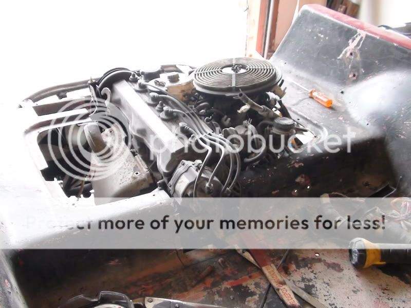

Re: The Street Buggy - Engine Swap in Progress! With Pics!

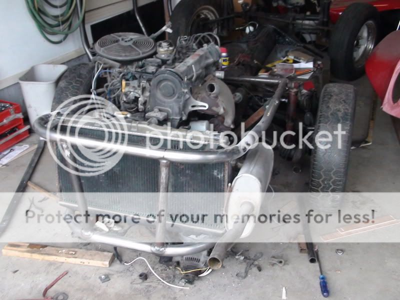

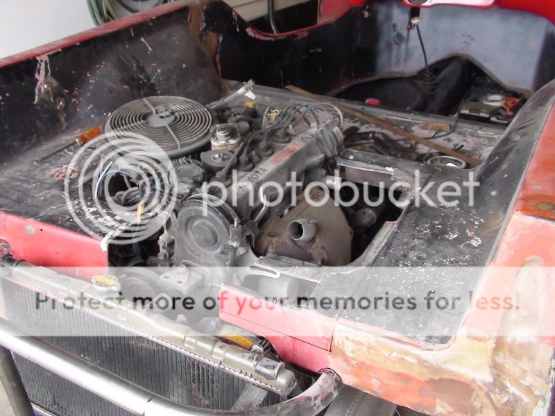

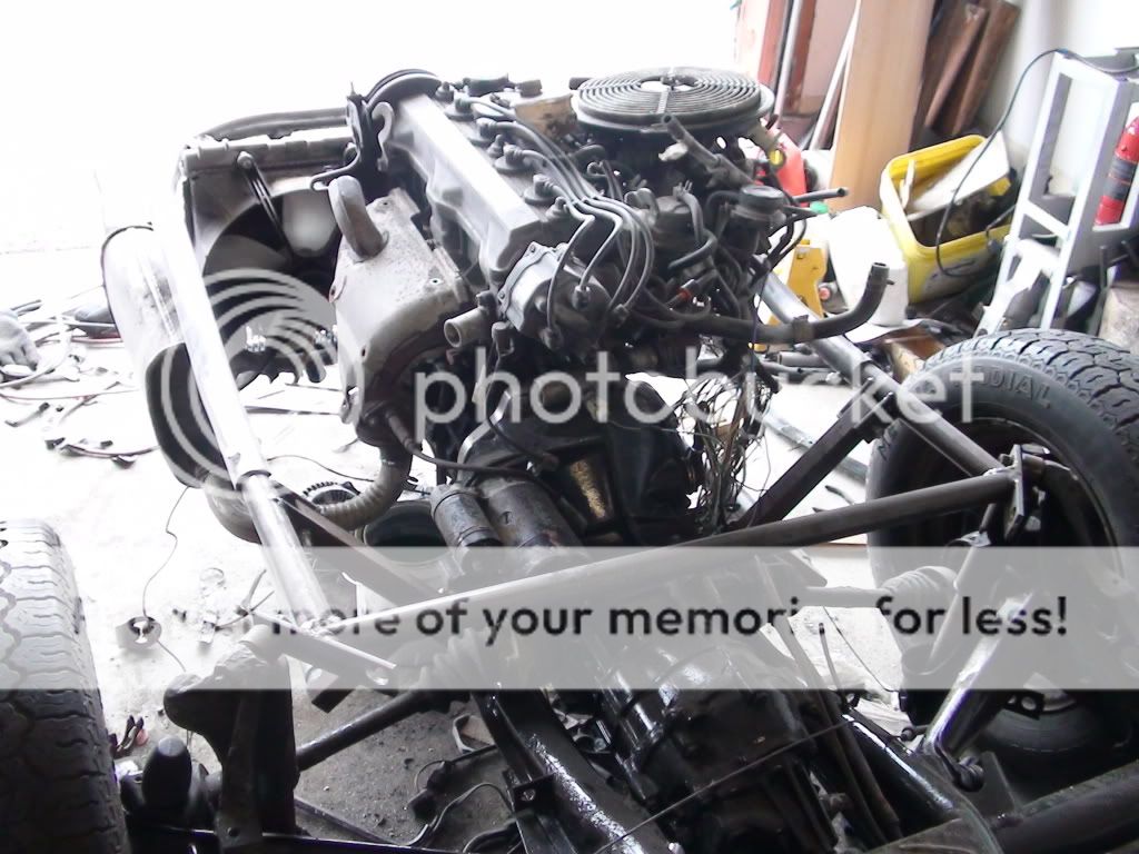

« Reply #20 on: February 16, 2010, 06:07:23 PM »

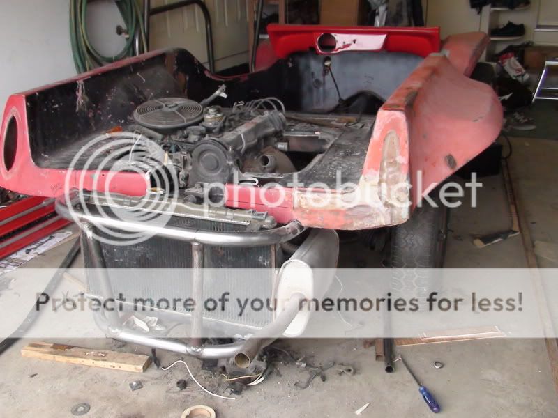

Here's a couple shots of the engine bolted up. Still gotta make the rear bumper so I can mount all the accessories and run the exhaust, I'll take my chances and won't run the cat it should pass 1970's standards though...I'm gonna keep the rad in the back since the one I have won't fit in the front, the electric fans should have no problem keeping this small of an engine cool, and the body will need a little trimming, not too bad though. I can't wait to get it running! :D

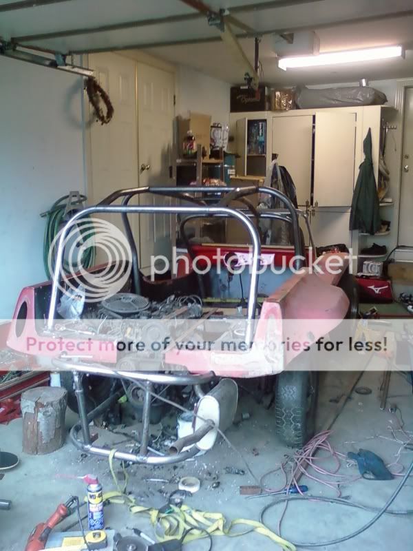

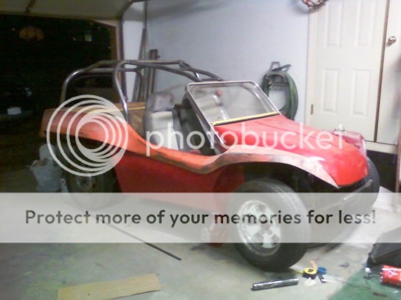

Re: The Street Buggy - Roll Cage done!
« Reply #26 on: March 16, 2010, 11:11:34 PM »
lol the gas and brake pedal are definitely going to stay VW! (Although I can't count the number of times my gas pedal got stuck), I'll let you know how the aircare works out, a rotary swap would be sweet but cooling might be a challenge. There's a rotary powered buggy on thesamba classifieds.

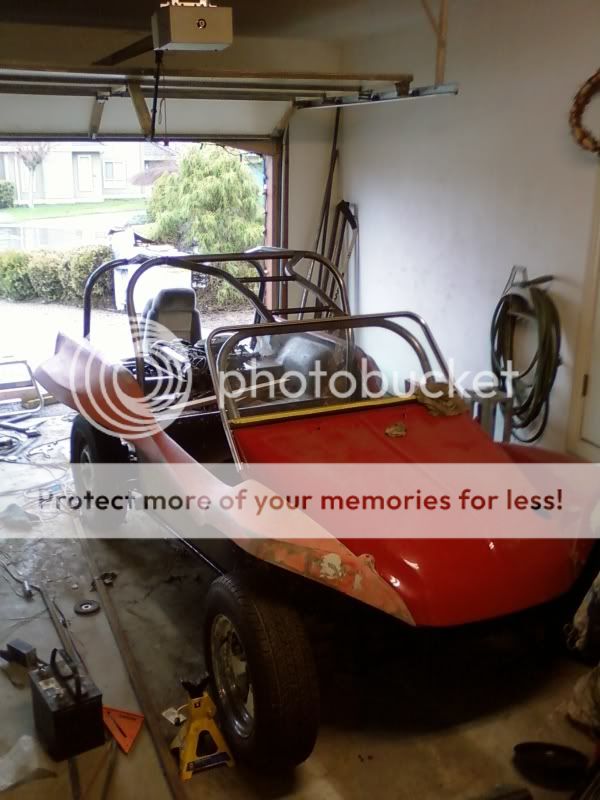

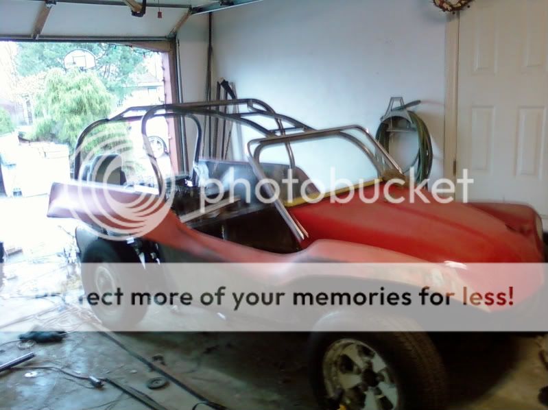

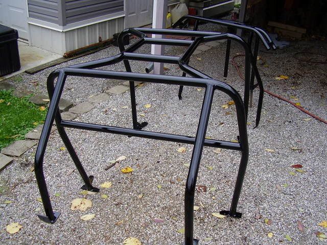

Anyways with spring break I got tons of work done. Got the rear cage fabbed up, engine wired and running, rad mounted,  body cut and mounted, roll cage tacked together...I'm sure there's more that I'm missing.
Ended up mounting the rad in the back since it won't fit in the front and I don't have the money to get a custom one fabbed up...we'll see how well it works
Body cut
Windshield mounted
Roll Cage!!
That's about it for now. Still gotta get the seats, seat belts, steering column and a few other pieces mounted, then final welding, bodywork, paint and wiring, finally getting there!  :cool:
P.S sorry about all the missing pics I moved them, I'll have to take some time to replace all the links...here's a link to the album though: http://s478.photobucket.com/albums/rr142/thebuggyproject/The%20Street%20Buggy/

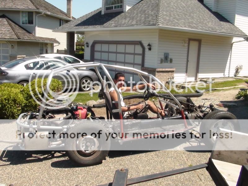

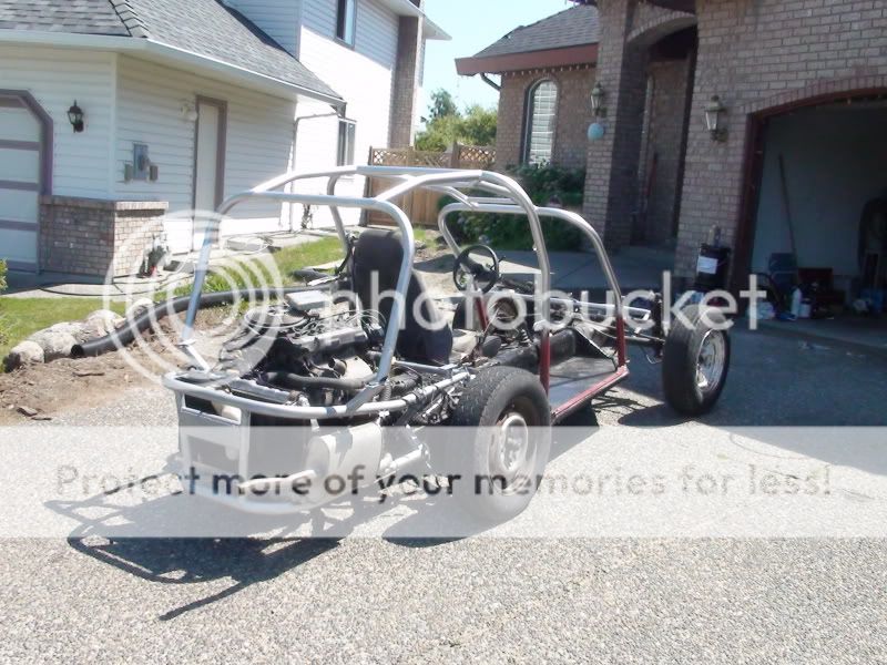

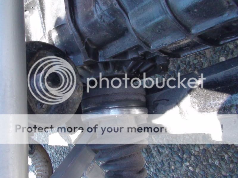

Finally got it running and driving! Runs pretty well still a few problems to address, the alternator is done (running off the battery), transmission whines a bit (a lot in reverse) after reading up it looks like the mainshaft bearing is almost out, I think I'll run it just as is for now... CV's rub the frame horn sometimes and I need to bump the rear up another spline. The engine makes good power I haven't even got on it yet it will wheelie at about a 3.5k launch but that's with no weight in the front and the rear sitting lower than the front...the extra weight in the back definitely isn't ideal so I'll eventually figure out ways to better distribute the weight (right now I have the battery and radiator hanging out back, they could be moved to the front), still tons of fun!
Anyways can't wait t'ill it's all done hopefully soon.
Video:
http://s478.photobucket.com/albums/rr142/thebuggyproject/The%20Street%20Buggy/?action=view&current=M2U00010.mp4
CV joint rubbing
Before disassembly:
Lots more pics in this album:

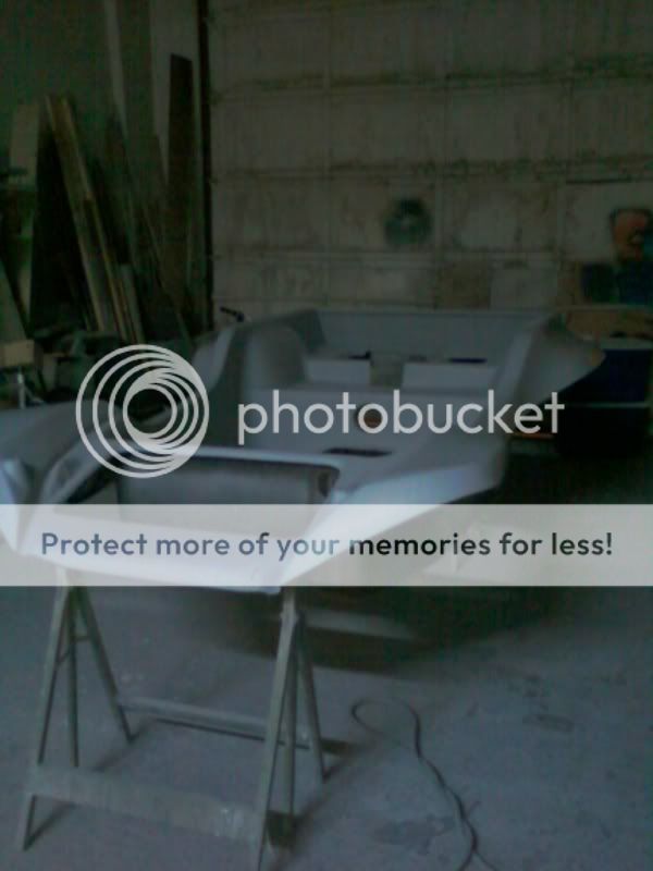

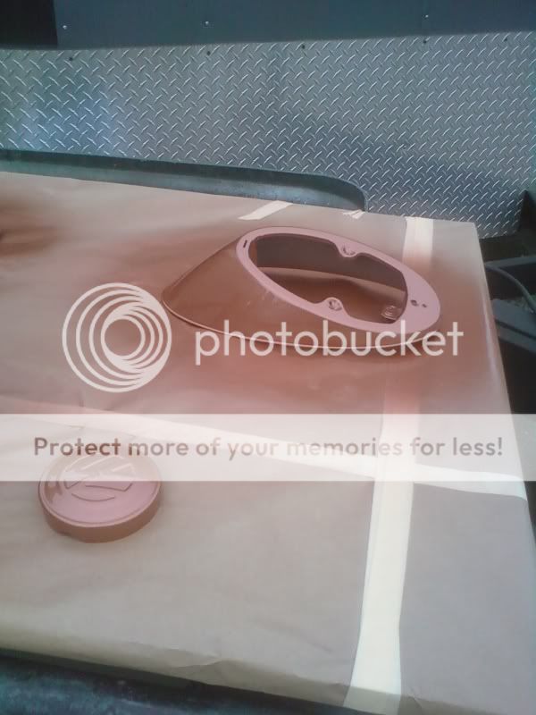

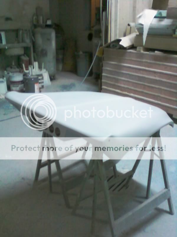

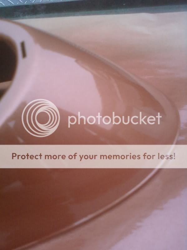

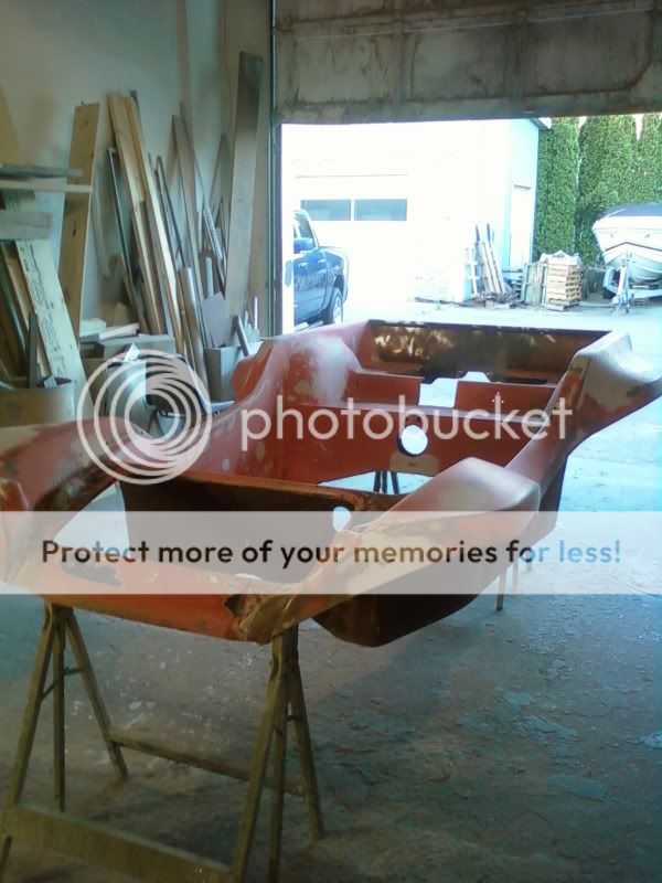

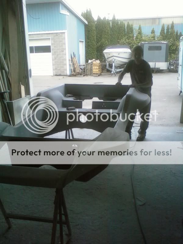

Some more progress getting the body primed and painted. I'd like to give a big big shout out to Stu(Stu817) for all his help wouldn't have been able to do half the job without him!
I'll let the pics do the talking the color's off in the pic I'll try and get a shot with a real camera not a cell phone, if all goes well it'll be painted tomorrow!

What kind of bender did you use to bend the cage?
