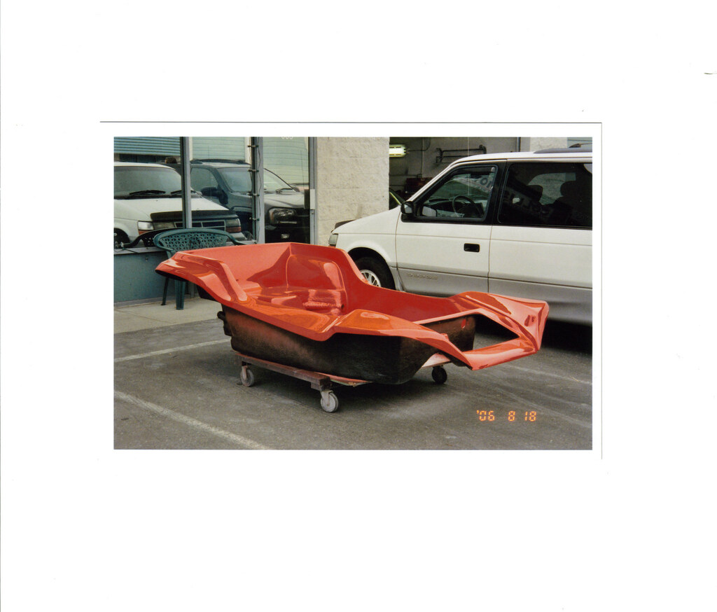

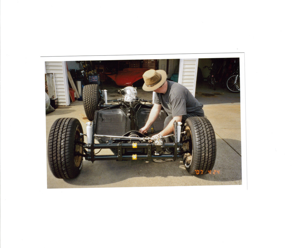

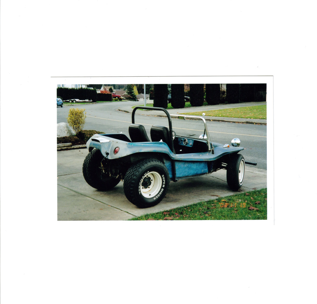

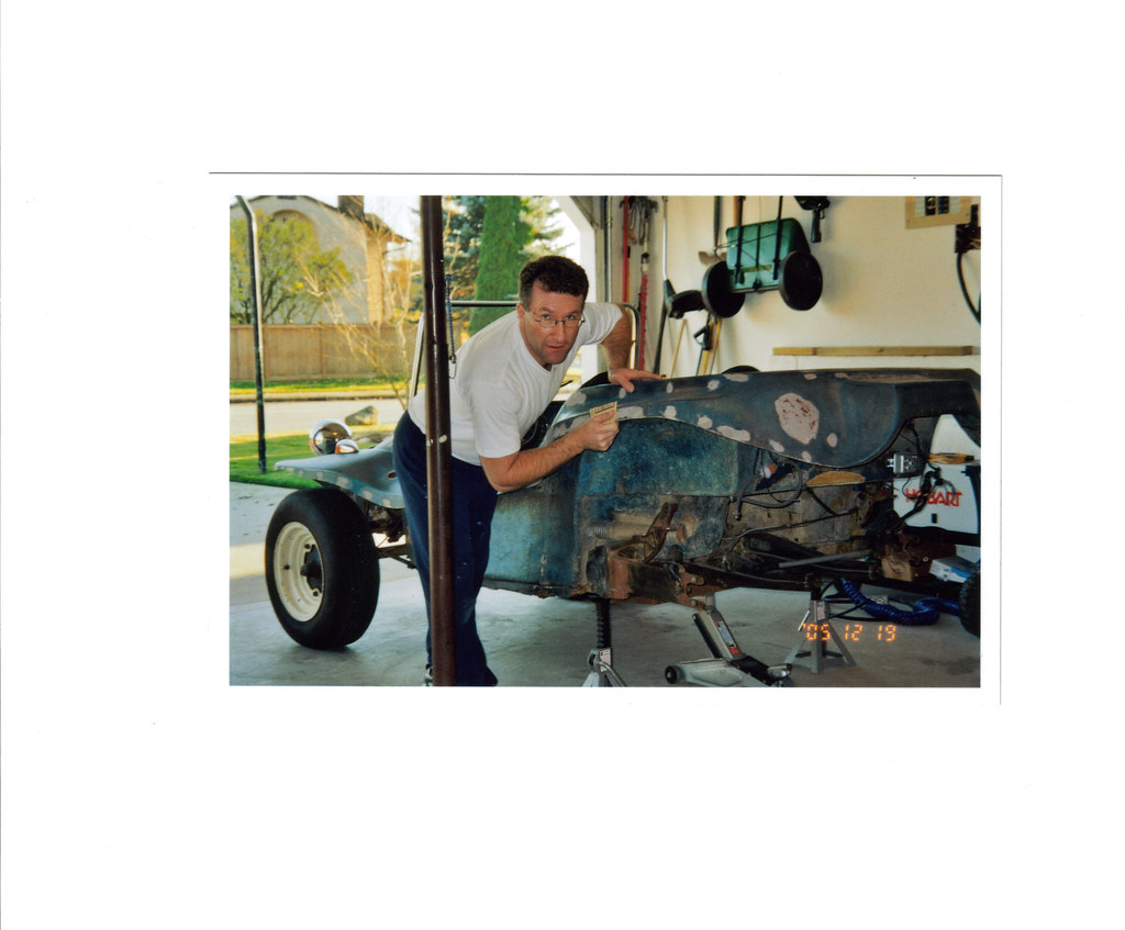

............... after selling my 1971 westy this is what my wife surprise me with...........

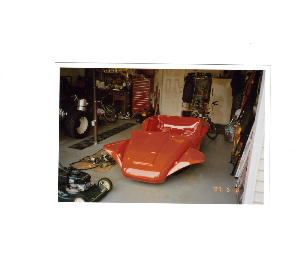

.............. started doing all the body work...................
............. me and buggy 1 ...............

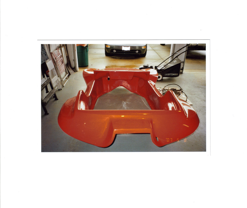

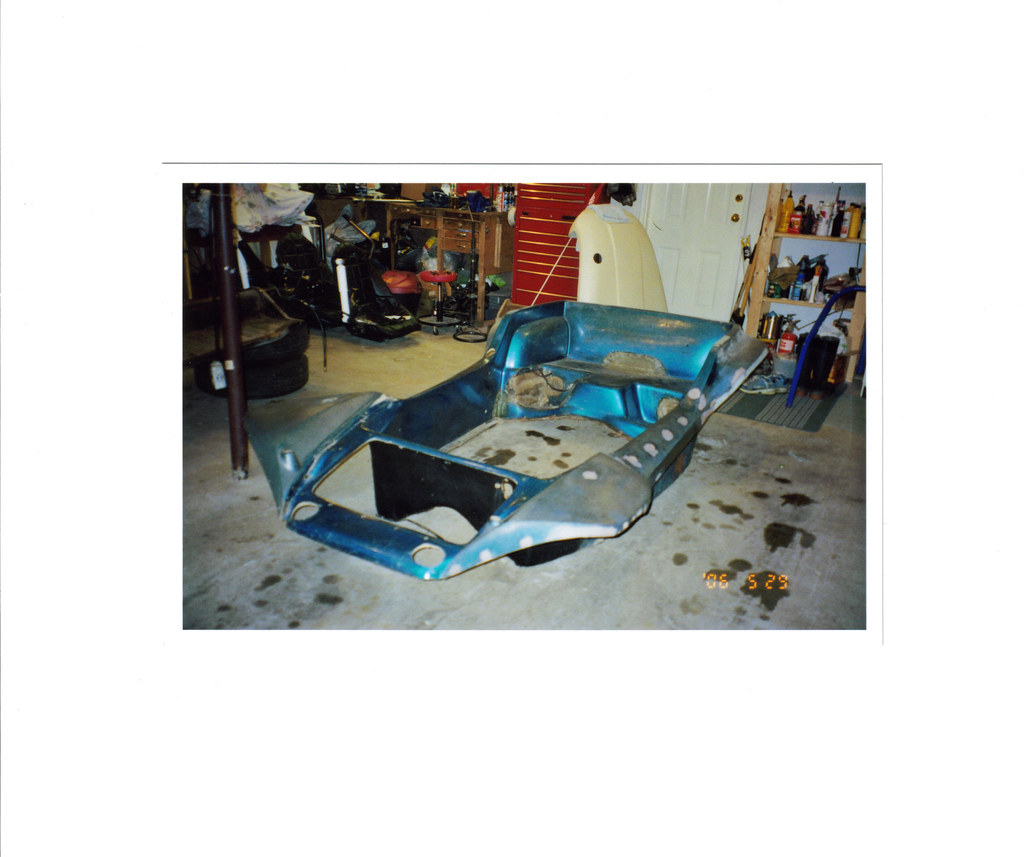

............... off to get body work and paint .............

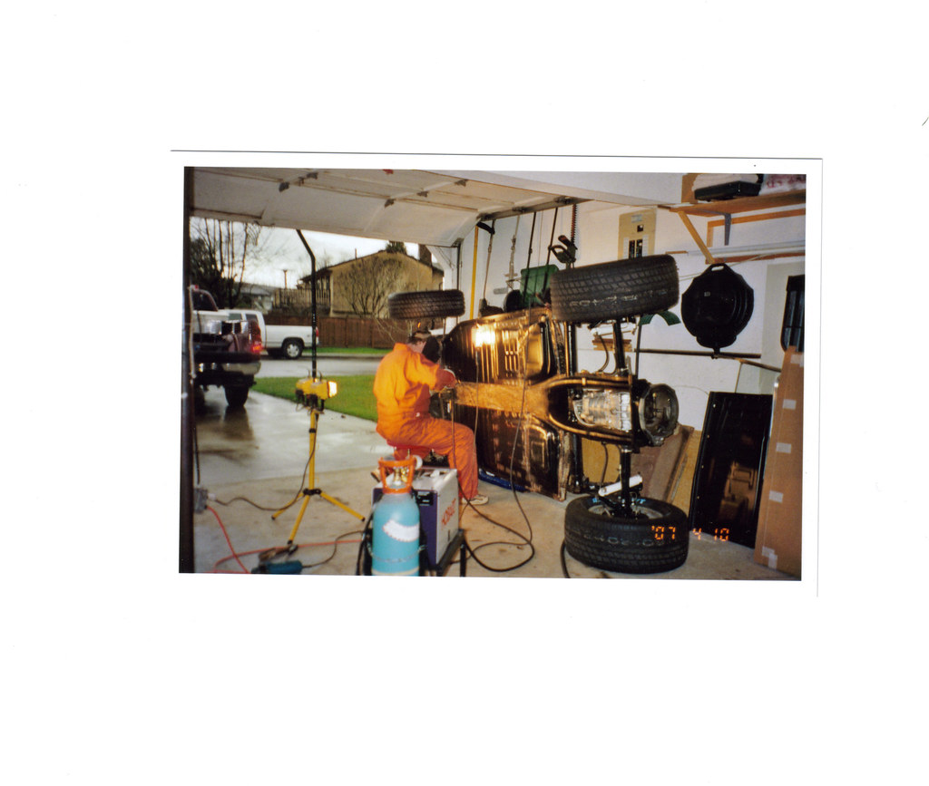

.............. welded in new floor pan section ..............
............... me and my son playing around after all that welding .................
............... the body getting ready to be put on the floor pan ...........
............... getting all the brake lines in and blead...... waiting for the body to go on ..........

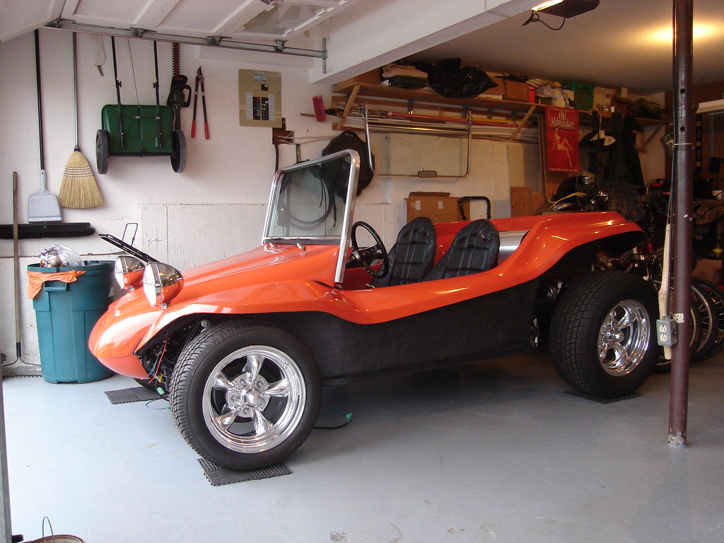

............... had to get some bling for the buggy.........

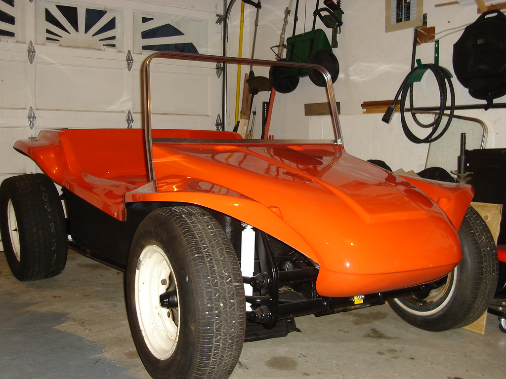

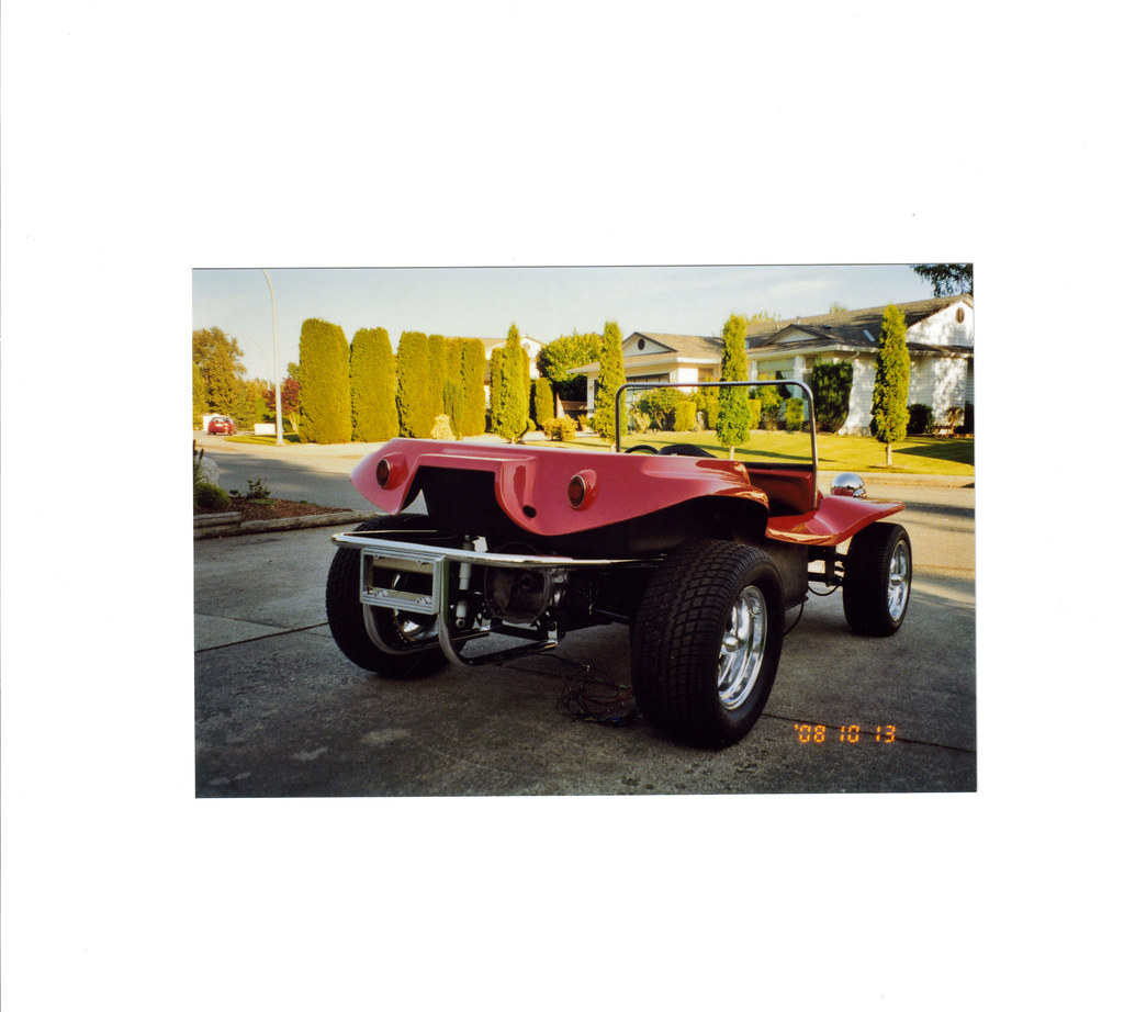

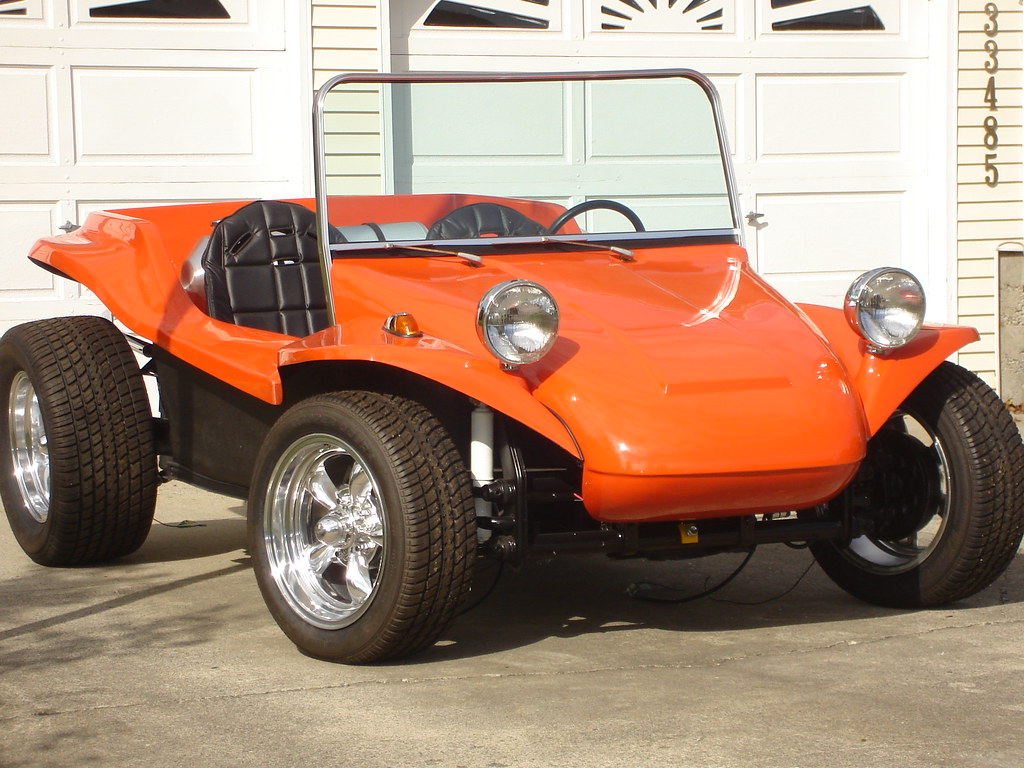

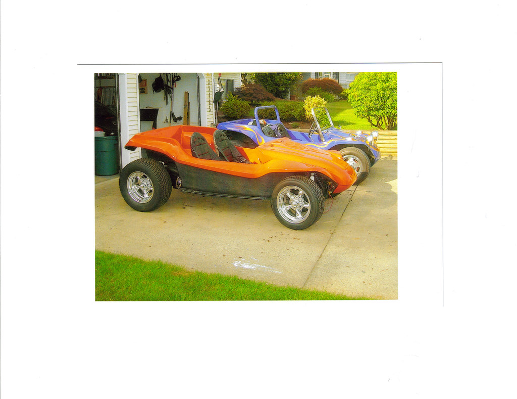

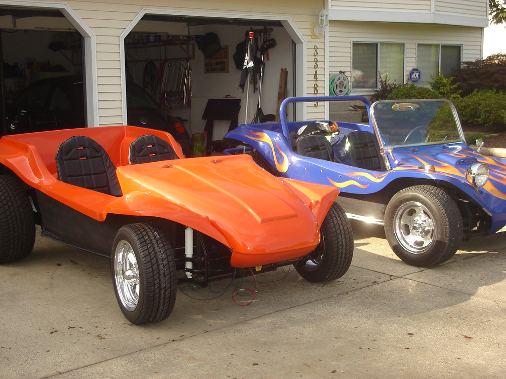

............. here's some more pics .............
............. had to get some bling .............
............. the buggy starting to come together ...........

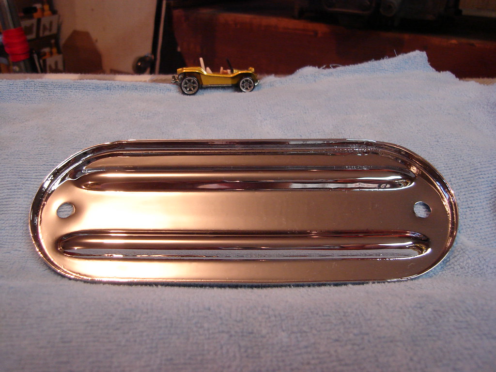

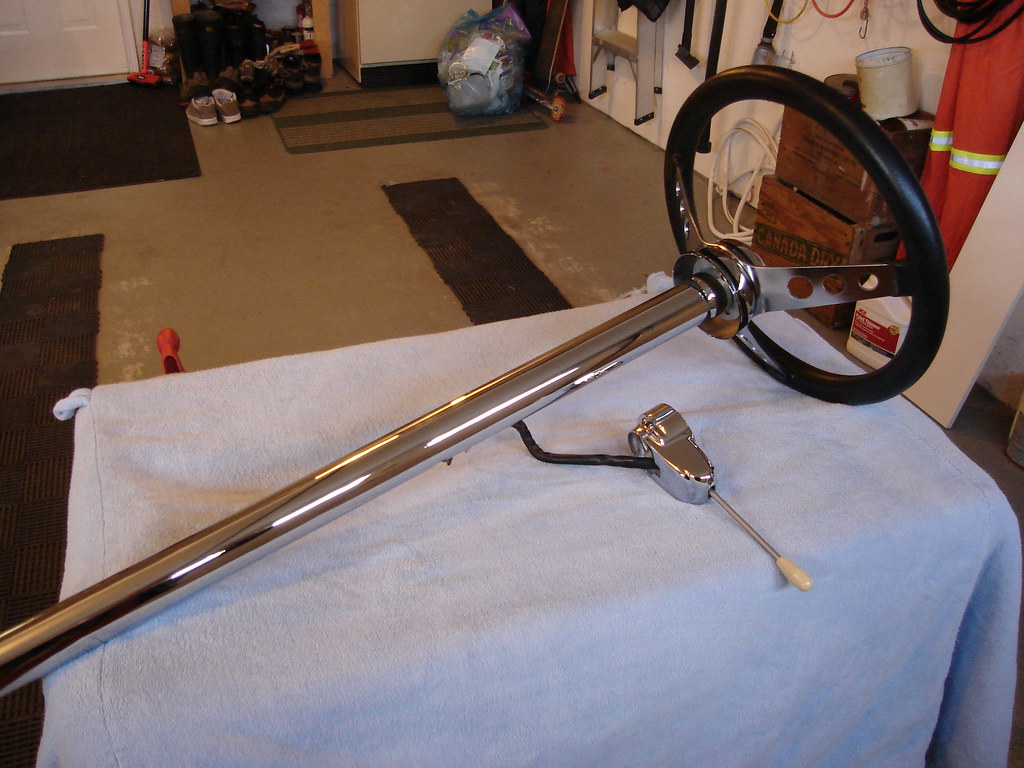

... Well got the rest of stuff back from chromer, so here is some pics...
... Inspection cover plate ...
... Steering column bracket and King & ling front lowering adjusters ...
... Shifter and washers ...
Rob

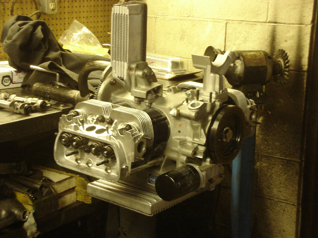

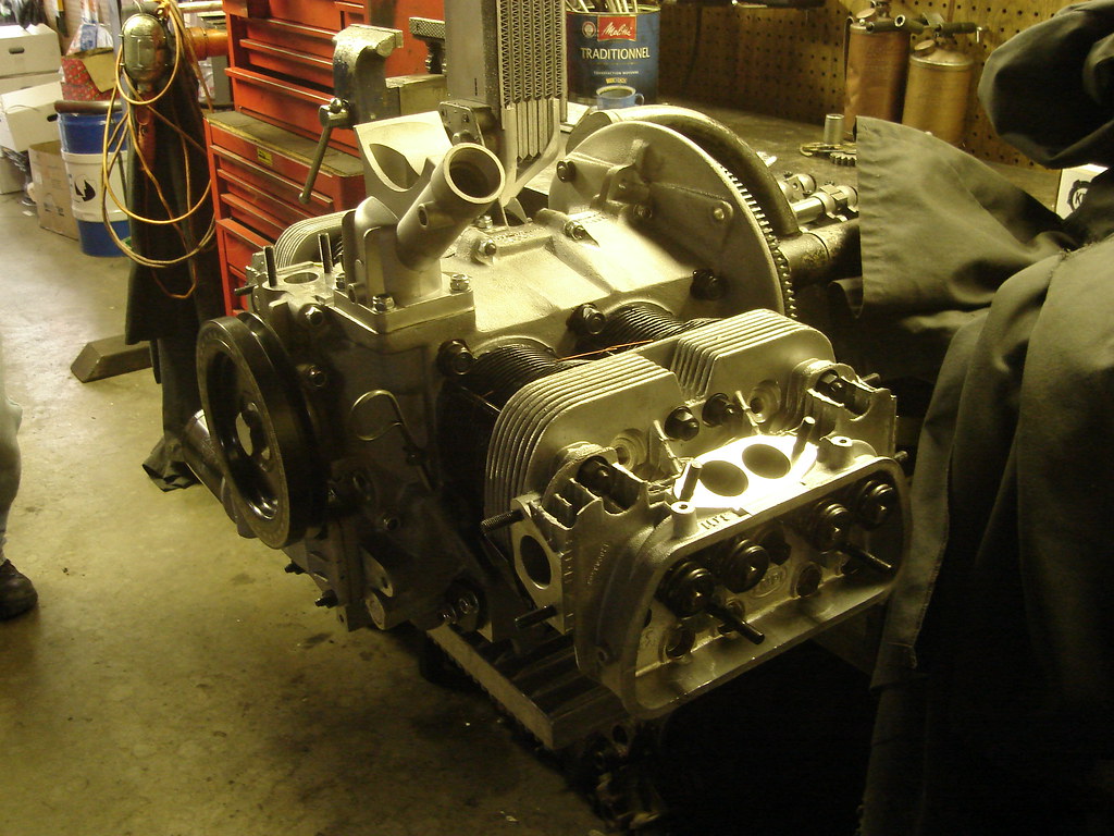

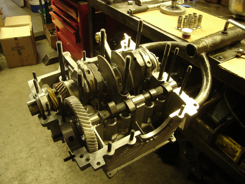

I finally got back working on the buggy so I decide to put some time in getting a good strong engine build.I went to AVR Imports and talk to Art Vic & Rob and decided to go with something that has a little HP and that is reliable.
The engine size is 1915 cc here is some pics of the build.
EMPI Bubble Top Engine case,94mm,10mm case studs
EMPI 4140 Chromoly Counter-Weighted Crankshaft 69mm 8 Dowel
EMPI 4140 Chromoly I-Beam Rods
EMPI 30mm Lightweight Racing Lifters
Engle W110 cam
3/4 reach 12mm Spark Plug with 40mm Intake 35.5 Exhaust Single Spring with a 3 way Valve Job
EMPI Super Capacity Oil Sump
Box of Goodies, Chromoly Push Rods,Empi 1.25 High-Ratio Rockers,Stainless Steel Windage Pushrod Tubes, Full Flow Oil Filter Pumps.
So now that the case is together with the Lightened Flywheel the 94mm pistons are ready to go on.
The Crankshaft ,Rods,Pistons Flywheel And the 5 1/2 LB Crankshaft Pulley are balanced.
I'll post more pics when the heads are on.
Rob

Went to AVR the other day to see how Art was doing on the 1915 and things are going quite well.The pistons and the heads are on plus the front pulley, generator and oil cooler. I took a few pics of the build.
Art thinks maybe by the end of February he will have it all ready to go.
Rob
