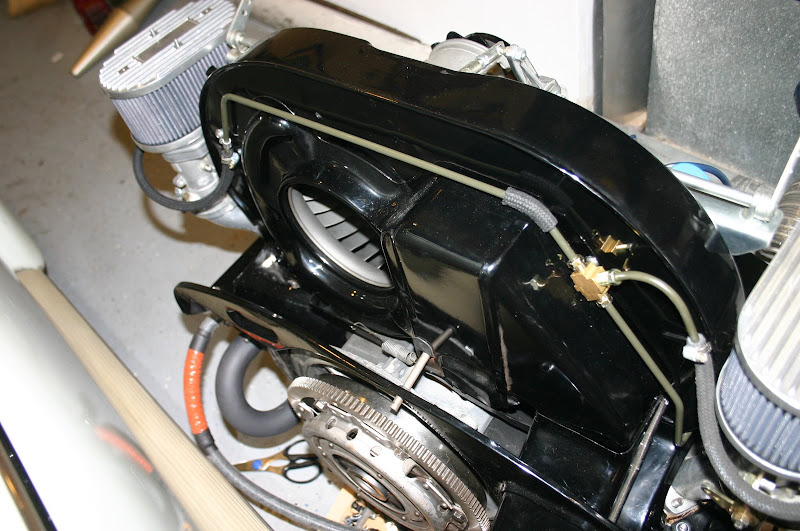

Here is the redo of the lines that were just flopped in the engine compartment.
Now as far as size line goes. I was going to do 5mm from the pump to the T and then 7mm to the carbs. Any difference in running 7mm on everything? The 5mm is a stretch on the brass T I have.

Better would be to go to your local auto parts store and get some brake hard lines.  Also get a brass Tee.  Then use that instead of all that loose rubber hose.  Use short pieces of rubber hose only to couple the ends to the pump and carb.

Metal lines are much more robust than rubber hose.  Use brake lines and the flared ends seal perfectly.  The only hose pieces you would have is one short one at each carb connecting the hard line to the carb inlet, and 2 hose pieces at the pump.  Use clamps to secure the hard line to the forward part of the shroud where you don't see it.

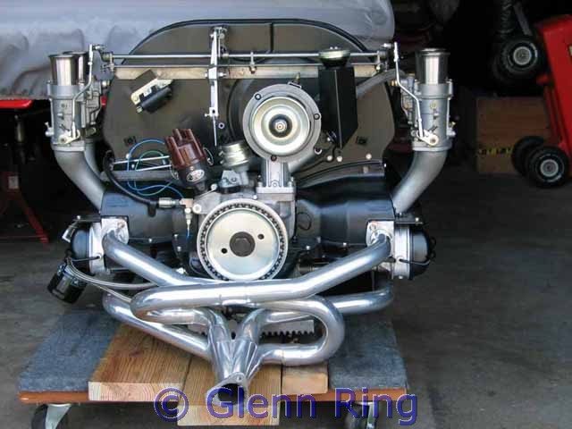

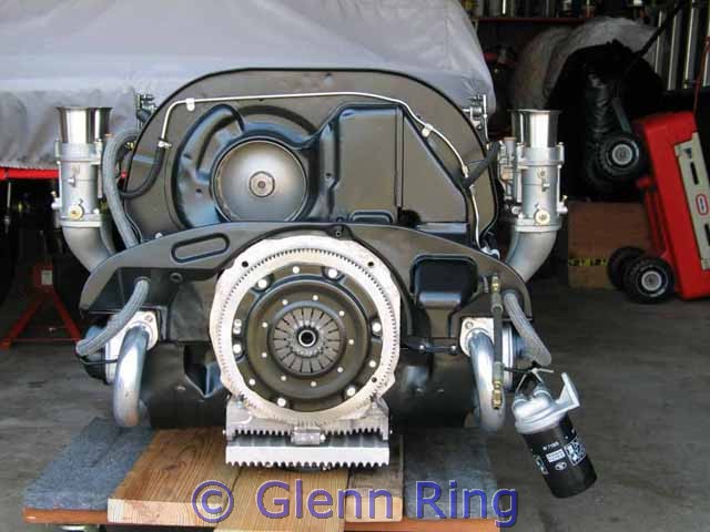

I am going to redo all the lines and then see how the tank looks and think about a filter up front.
Chris,
I used .250"OD/.196"ID stainless tubing and it works just fine.
Glenn

That looks like very COOL work. Thanks for the pictures.

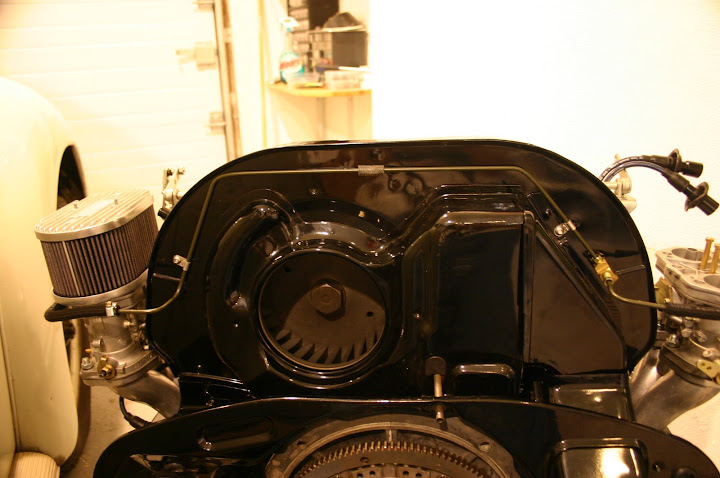

I picked up some 3/16 brake line and mocked it up. I need to go 1/4 like what Glenn used so the 7mm fuel line fits on it better, but this is the basic idea I have so far.

« Reply #17 on: November 23, 2008, 09:02:51 PM »
That's the right idea.

You'll want to keep the hardline close to the shroud. Otherwise it will make getting the engine in harder and access to the mounting bolts difficult

I just need to make up one more line.
Re: Fuel Line/Fliters
« Reply #20 on: November 24, 2008, 09:17:43 PM »
does the hardline go through the hose at the bend by the oil cooler tin? or just the hose?

It's just a spot of soft hose over the hardline to keep it from rattling.
