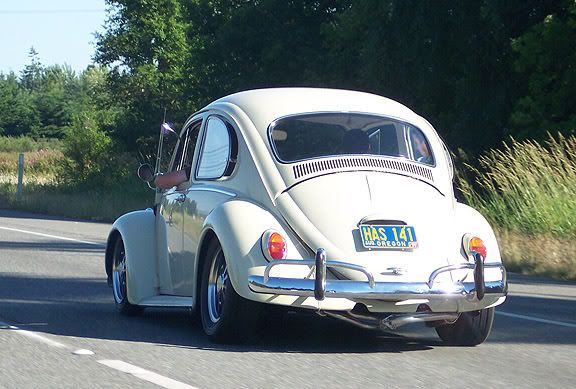

4" narrowed would look good, it would tuck nice and you can still run shocks.
Here is my old car with a 4" narrowed beam, CB disc, drop spindles on 5" BRMS with 125's.
