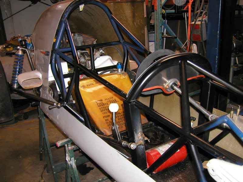

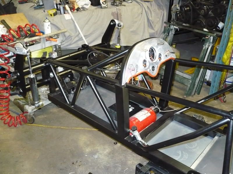

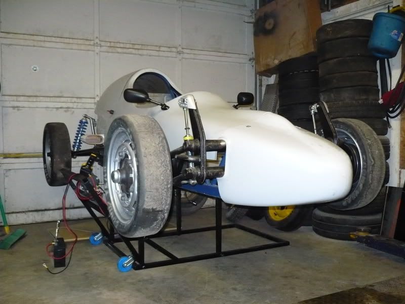

Hello, I started about two years ago collecting parts and info to build a Formula Vee Race car.
I found a chassis and body at RDC welding in port moody and started from there.
 I do admit this has become a consuming hobby but I just enjoy building and collecting stuff.
I have road raced off and on for about fifteen years, I rented a formula vee for a weekend and got hooked. I guess the idea of this thread is to hook more people.
For those who do not know what formula vee racing is about, I will give you a quick overview.
The mechanical components are from a 40hp pre 65 type 1. Mandated by the rules are steel wheels, kingpin beam, drum brakes,  1200 engine with 28pci carb and type 1 trans with specific ratios. These parts are put together in a open wheel one seater race car designed for
road course racing.
I have built this car as a budget project. The Idea was to be on the track for under four thousand dollars. Once I started buying extra toys the budget has grown.

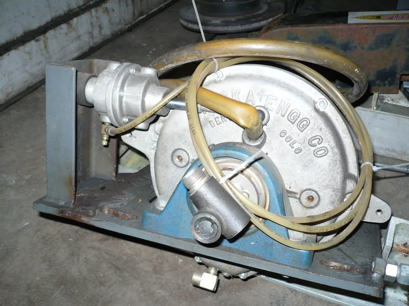

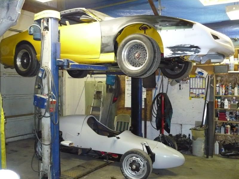

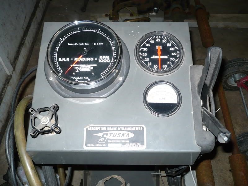

I will try to attach a couple of pics of the progress, from the buying to near finished. I bought a couple of extras such as a lift for at the track or home.  I just bought a stuska dyno for which I am going to make a vw aircooled specific engine stand for breaking in and tuning my motors.
