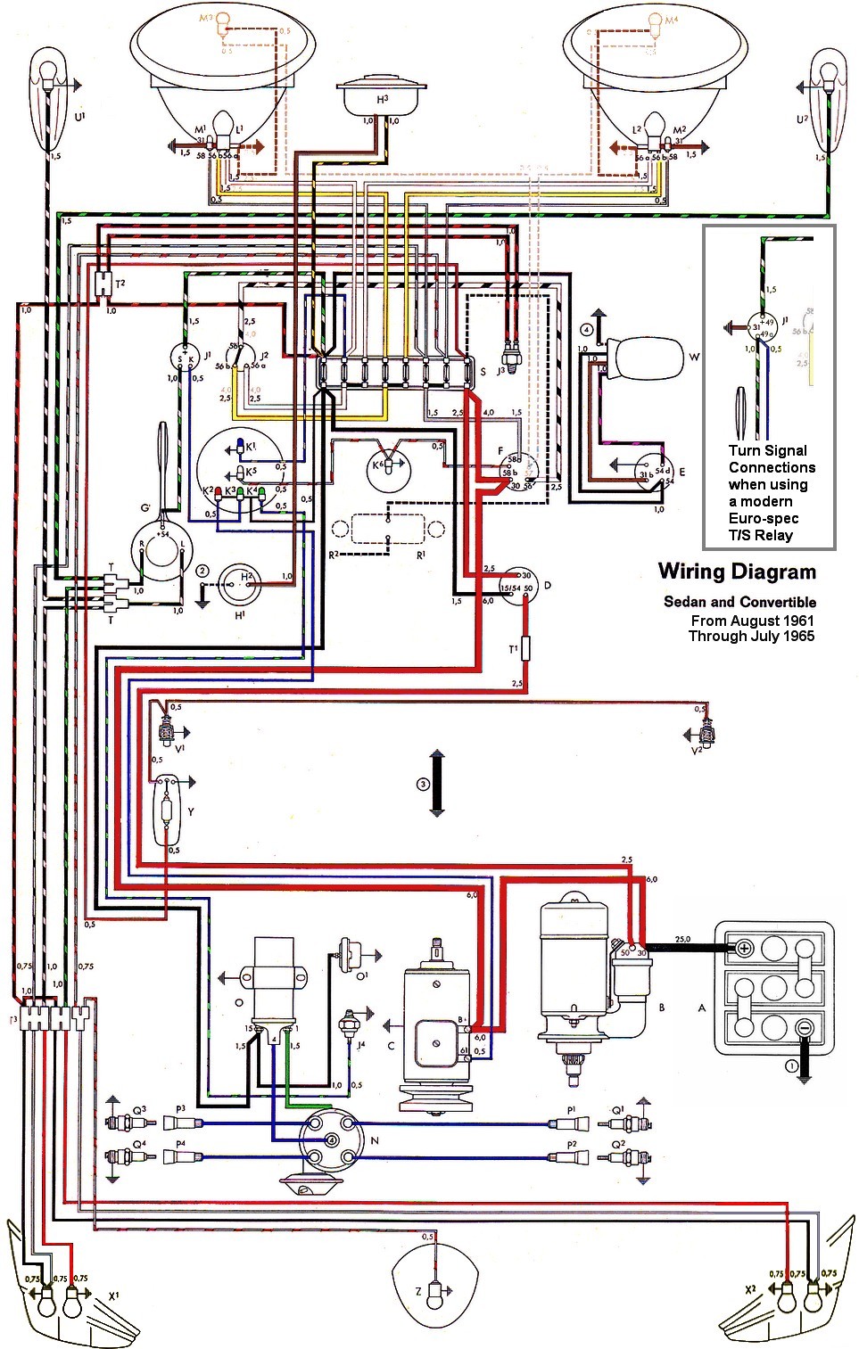

you could get a universal harness if you want, here is a 65 beetle wiring diagram

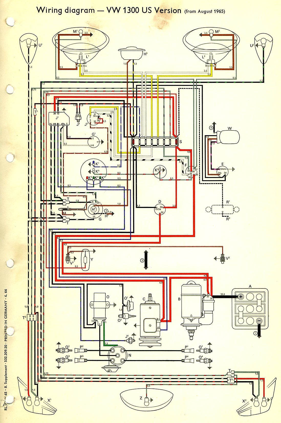

every circuit should be fused, but like the diagram that vwchris posted, there are several different circuits that can run off the same fuse.
just because your buggy is a 66, i'm going to post up this wiring diagram from a usa spec 66 beetle (it's pretty much identical to the one vwchris posted)...
