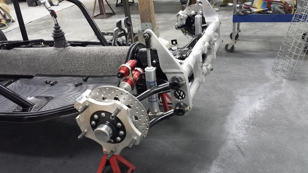

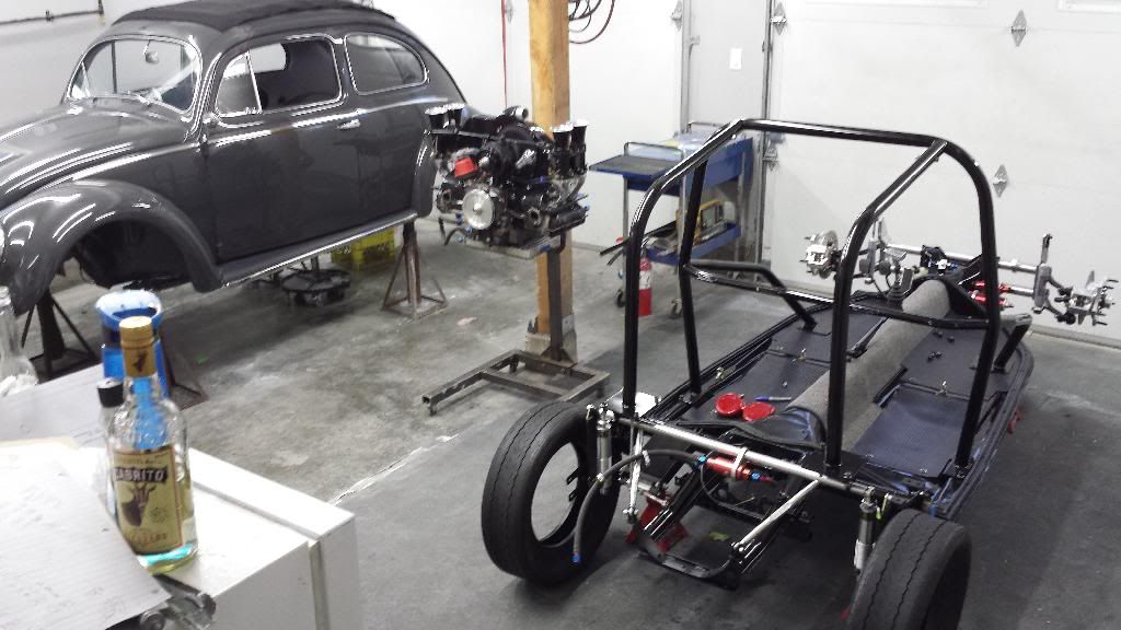

 Been a busy mofo!

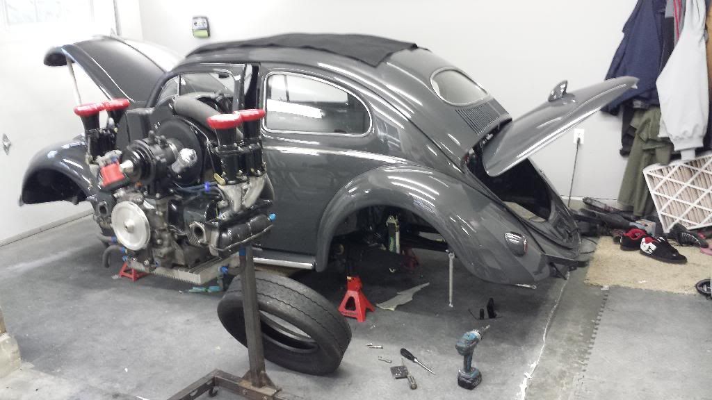

Last weekend was huge! Body met pan at last!!!
Thanks Johnny,  Andrew, Jay and my bro Casey!! Shit is becoming a reality!

« Reply #345 on: January 14, 2014, 11:09:52 AM »
Wow great work man! The garage looks way different with the "booth" gone!
Re: the '55 Ragtop, 5 years and counting.....
« Reply #346 on: January 14, 2014, 11:23:35 AM »
Man those rear rims sure look lightweight! ;) Looks fantastic Josh!
« Reply #347 on: January 14, 2014, 05:45:55 PM »
He's the first to use hub less wheels on a vw

Brian you won't believe how light those bad boys are....and expensive lol_hitting
Kevin,  it's been down for a couple weeks and it still throws me off every time I walk in the shop....that bloody thing was hogging room for way too long (served it's purpose very well tho!)

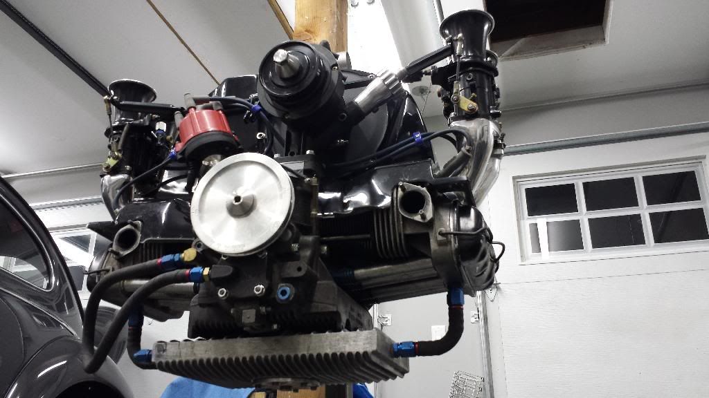

ps…i hope you didn't let johnny & andrew get into that cabrito and play lets see what we can stuff in these open exhaust ports!  :o :angel: ;D

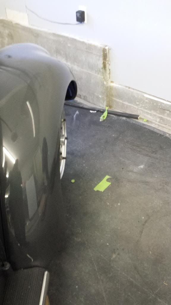

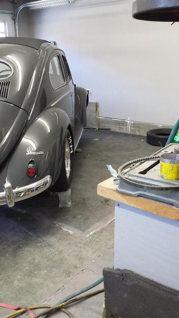

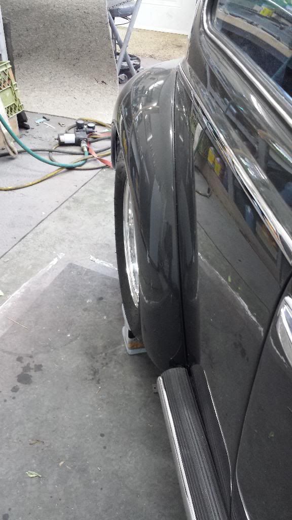

So today my wheels arrived ....
What do you think?
Those were the best shots I could get.....

Just teasing us! Looks freakin awesome
