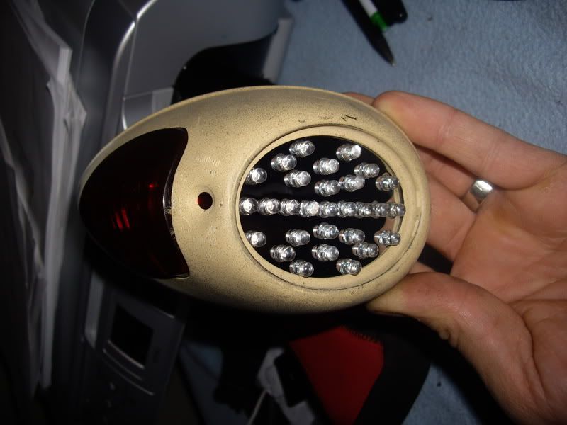

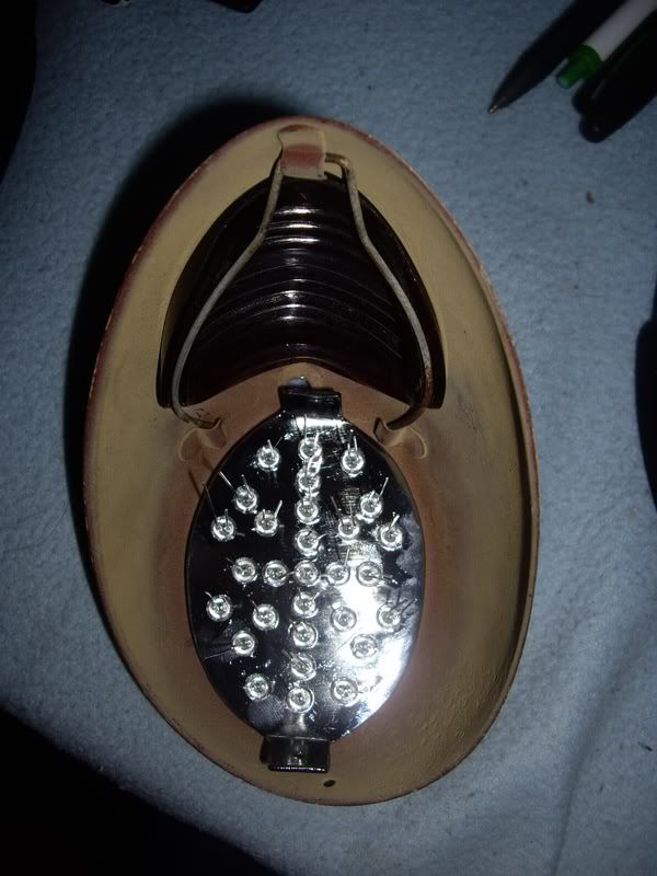

making some LED tail lights for the hearts
Started with a sheet of 1/8\" copper and cut out the shapes with a tab top and bottom. layed out the template/pattern and ended up with 29 LED's in each cluster. the template shows how I figgure i'll wire them, the black being running lights then all of them for the brake. keeping standard incandesent bulbs in the \"heart lense\" and using them as a signal to come on with the semaphores.
I still gotta make up my mind on how to solder them all together, leaning towards mini circuit boards. I did a quick test just by bending the tabs to contact each other and just about blinded myself and the guy next to me :shock: they get a little toned down behind the lense but still should be pretty bright.
ALSO MISSING ONE HELLA GLASS LENSE AND BEZEL (if anyone has a spare collecting dust)

Nice job with the lights I would like to put LEDs into my hearts aswell.

what type of leds are you using? you may have to upgrade to an electronic flasher relay as the older relays dont like the LEDS and may flash at a really fast rate. Also you can buy resister that goes in line to add the proper load to the circuit.

I had read that about leds and flashers, thats why the top heart lense will be using the stock incandesent bulb for the signal

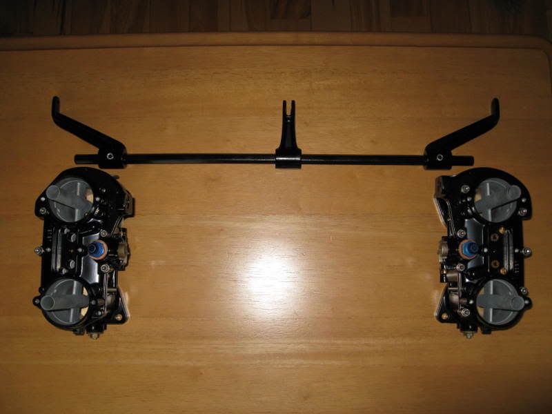

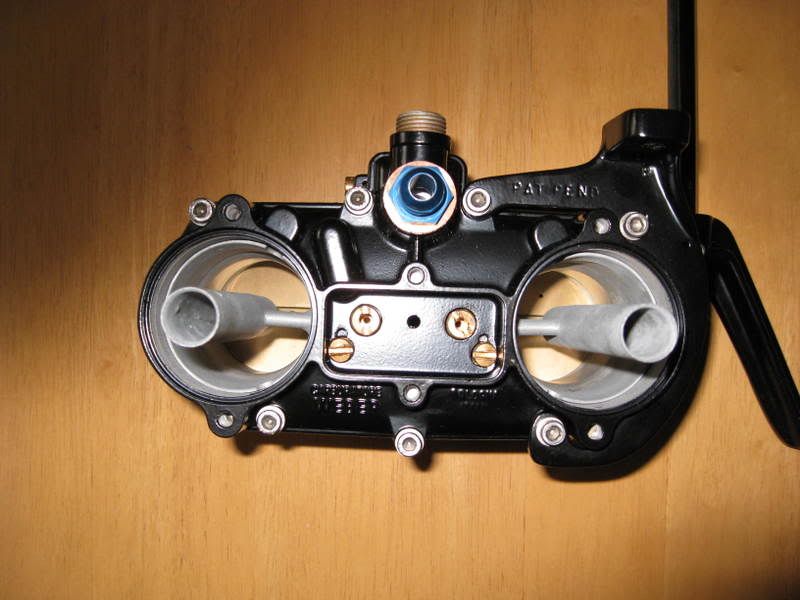

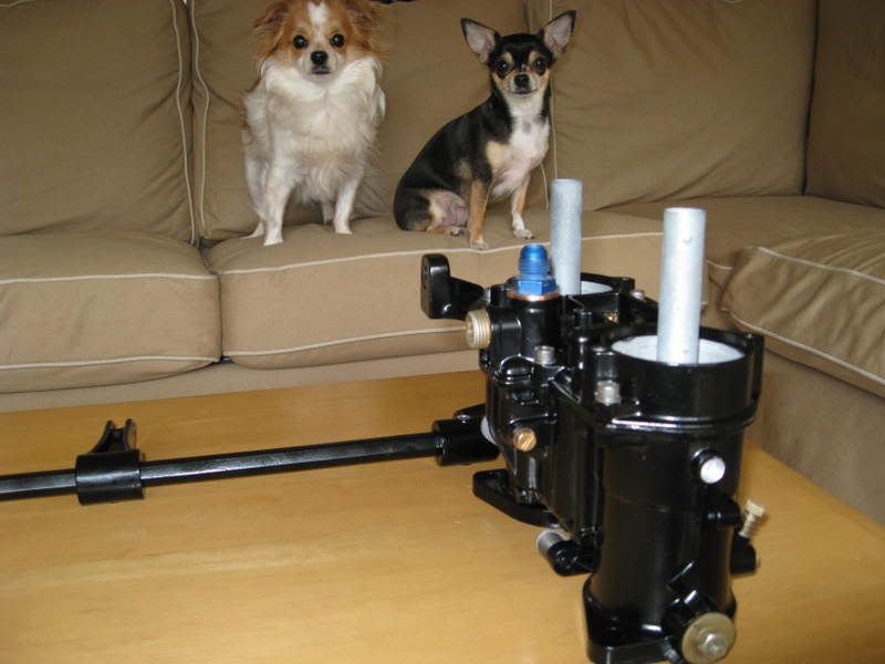

I've recieved my rear inner fenders from wolf.......very nice indeed just waiting for donor sheetmetal so in the meantime i've got a bunch of powdercoating and clean up of little parts done.
biggest hurdle were the IDA's, thought about polishing but ended up going semi-gloss black powder coated :rockon: they were a major pain in the A but I think they look killer. many hour went into prep not to fill all the threads with powder, stuffed every little hole full of tinfoil and it worked great. going for the low bling stealth bomber look on the motor, no chrome but a couple bits of polished alum, mostly black. I'm thinkin' annodize the velocity stacks black and then polish the insides and top lip to match the intakes.
my super fierce muts wondering what the hell i'm obsessing over :rolleyes:
powdercoated dual circ master cylinder with rabbit reservior
lots more stuff done but not assembled yet like steering box, pedal cluster and torsion arms, link pin carriers, various other brackets and bits'n'peices. I LOVE POWDER COATING :D

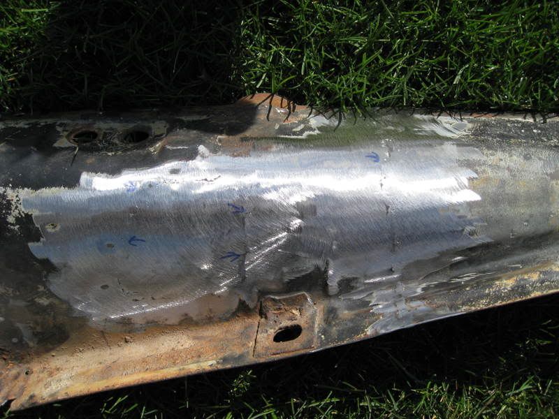

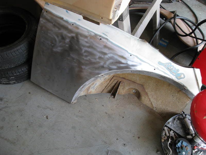

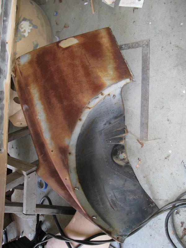

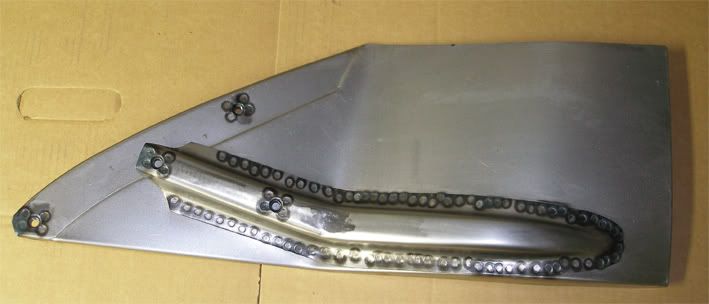

so a little update, got all my sheet metal for the ass end of the car now. bumper mounts from wolfe, pass side rear quarter/wheelwell from california and Tom H hooked me up with the drivers side  :D imagine that, both my donor sections came from 55's :rockon:
I started disecting the old heater channel chunks out of these and found a couple thin spots inside so I drilled out the spot welds and will bead blast and start fresh.
the section from cailfornia had the rear crossmember cut in half with a plasma cutter to fit it in a smaller box to save me on shipping so I had to stich it back together (I now have the mig at home) also cut out and patched where the heater box exits.
I'm pretty happy with my first attempt at butt welding sheetmetal with a wire feed.
not as much as a dent in either of these panels, much better than what I was up against.
still not 100% sure on where I will be splicing these sections in, i've changed my mind waaay to many times, just gotta do it

« Reply #49 on: April 02, 2008, 08:34:36 AM »
Looking good Josh, I have project envy! (the car and the time to do it)
Russ
Project '54 Ragtop
« Reply #50 on: April 02, 2008, 02:21:33 PM »
thats cool that you were able to find two clean panels.
tricky part is putting them in now
keep us updated good job man

« Reply #51 on: April 03, 2008, 12:47:48 AM »
welding them in isn't all that tough if you are real careful in trimming to get the fit perfect, it's just really time consuming!!
I plan on making some templates from heavy paper to transfer the cut lines.
Cut out the engine bay shelves tonight and seaperated the 3, count them 3 layers! of overlapped/stacked metal that made up the inner rear wheelwells :wacko: now they're prepped and put aside until the new sections are welded in.

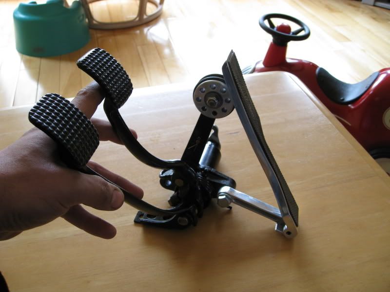

finnished my pedal cluster.....rebushed, powdercoated and made a new wheel for Russ's killer cruizer to ride on complete with skateboard bearings, o-ring grip and speed holes of course ;D  way better than the cheezy plastic stocker.

I like that wheel....keep up the good work!

Re: Project '54 Ragtop
« Reply #55 on: April 23, 2008, 02:19:29 PM »
ha ha that's killer love the o-ring grip.
you should start selling them

f@#kin kick ass roller pedal with o-ring gription & s-pee-d holes!!!!! good work josh....i love it!!
