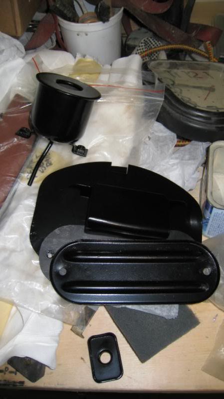

Headlight buckets powdercoated and rings rechromed.........
and a few other odds and ends powdercoated
Idea is to have all the little shit ready to go and stashed away......once and if I ever get the body finished, assembly should go really quick ::)

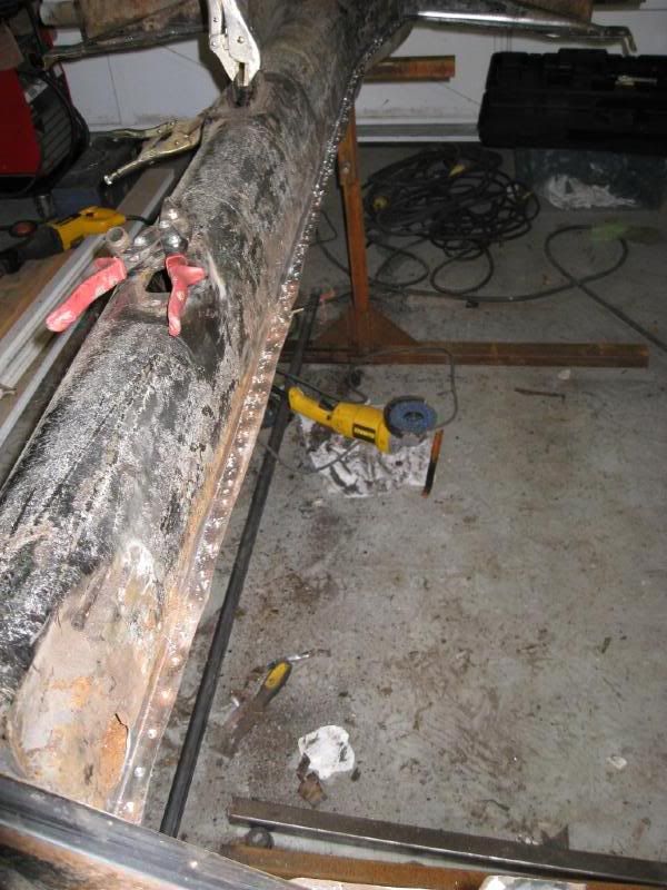

So I got over my procrastination and hopped back on the POS this week.

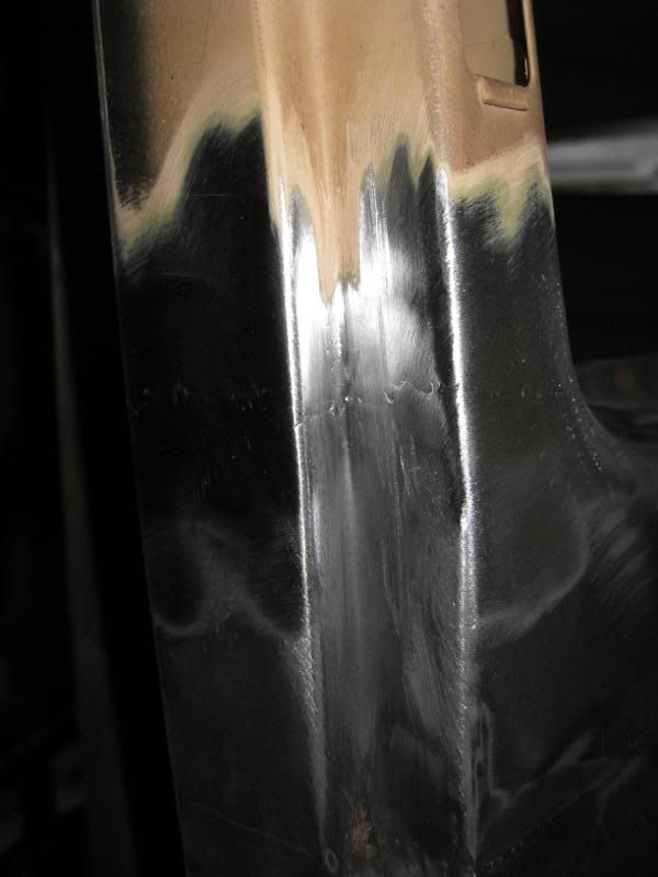

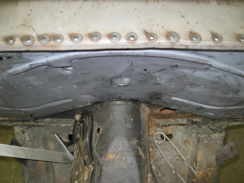

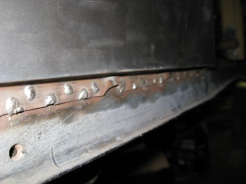

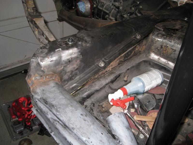

Got a bunch of welds all ground down and smoothed out on the panel splices. For those who are interested here's a bit of a how to on the process I have been using.
Obviously cut out the offending hunk of panel to be replaced (I use a cut off wheel in an electric angle grinder) nice and straight.
 Trim your replacement panel to fit while taking precise measurements and trial fittings (the blue transparent paint is called dykem (sp) machinists use it a lot for scribing precise lines). And end up something like this......
Then start tacking it in jumping around so you don't put too muck heat into the thin sheet metal and burn though. The trick that i've found is to have a max gap of say .020" if not closer. If you can use a copper heatsink to back your weld, i've made up an assortment of shapes and sizes some brazed to the end of a bar for leverage. It's not fun to blaze a hole through where you can't get to the backside.
Here's what it looks like connecting the dots......

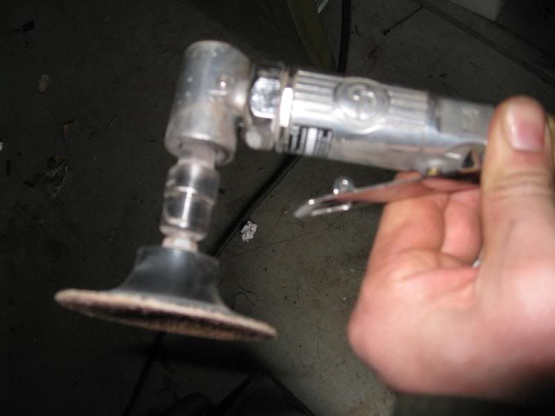

Then using a mini 3" X 1/8" cutoff wheel in the air grinder take the tops off the welds very slowly making sure not to hit the panel surface then using these puppies........
They come in a bunch of different grits and blending pads, twist off of the arbor and work SHIT HOT!!! they don't last long tho.
End product is something like this....
And with a quick squirt of black spray bomb to protect the bare metal......
You can barely feel the seams when you run your hand over, they are all just a bit indented (maybey .010") so I will only need a super thin feather of filler once I get that far. A far cry from what I started with!!!!!!!!!!!!!!

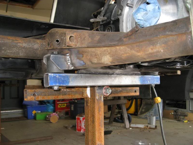

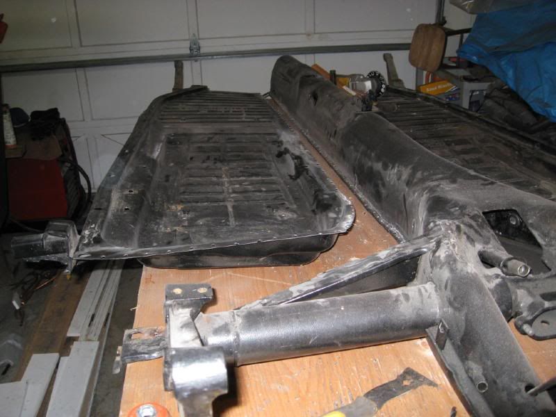

been picking away at stuff. made some good progress on the pan.... I ended up scrapping the idea of welding a new panhead on the 57 pan (didn't want to risk ending up with shitty alignment on a built pan) and drilled the mint pans out and installed on a 59 spine I had.

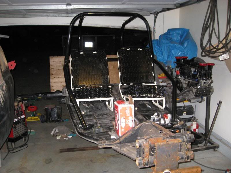

New early flat seat tracks welded in
Mocking up with cage making sure seats fit
mid mount done.....no more solid mounts!!!!! :lol: 57 was LOUD!!
more mock up with kafer brace, will be tying this into the package tray mounts of the cage to stiffen things up even more.

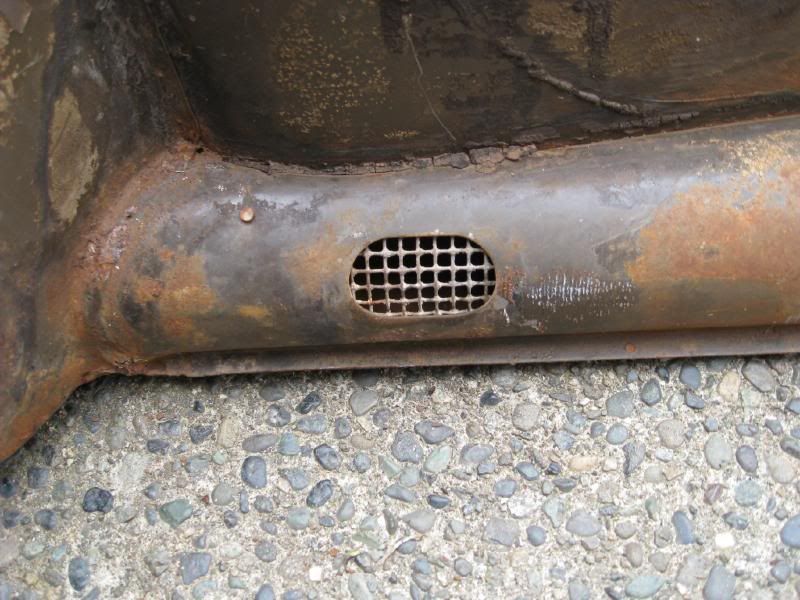

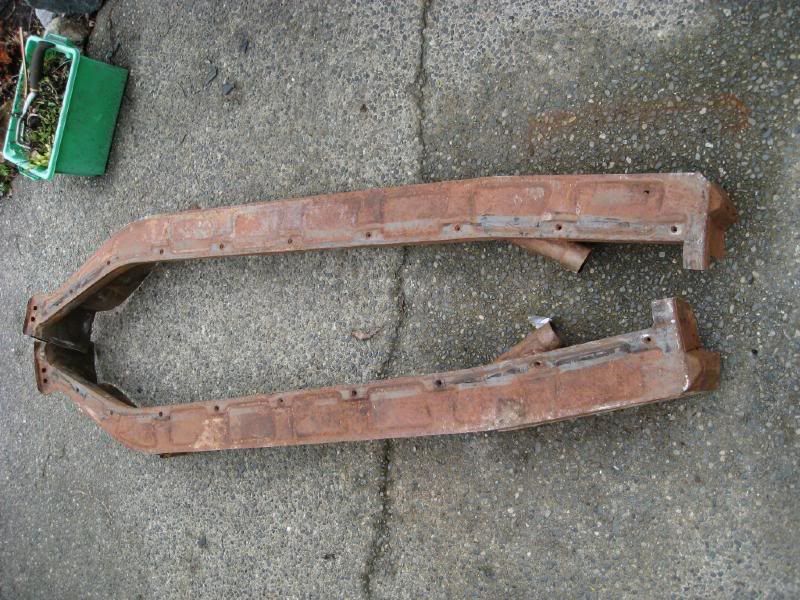

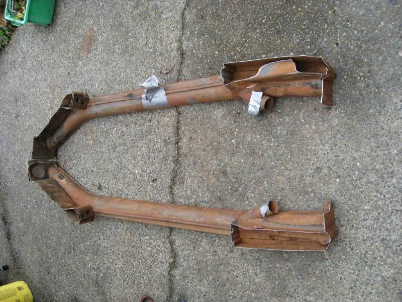

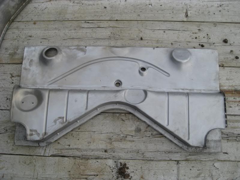

Broke down and coughed up too much money for a pair of original dry heater channels form down south......came today :D
This was the last piece to this mega puzzle and I figured I was going this far and deep, I may as well do it right!!

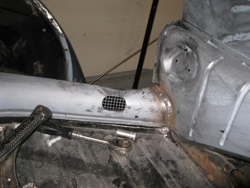

Heater channels had a couple issues of course, nothings as it appears. Shitpiles of work grinding, drilling and welding fixing some areas and had them dipped. acid etched the outsides and then thinned some por 15 and completely coated the insides before welding into the car......no chance these things will be a problem again.
I read somewhere of someone bolting the channels, rear crossmembers and front bulkhead to the pan to get the alignment right and welding them together then droping the body on and mating the 2.....so that's what i'm doing.

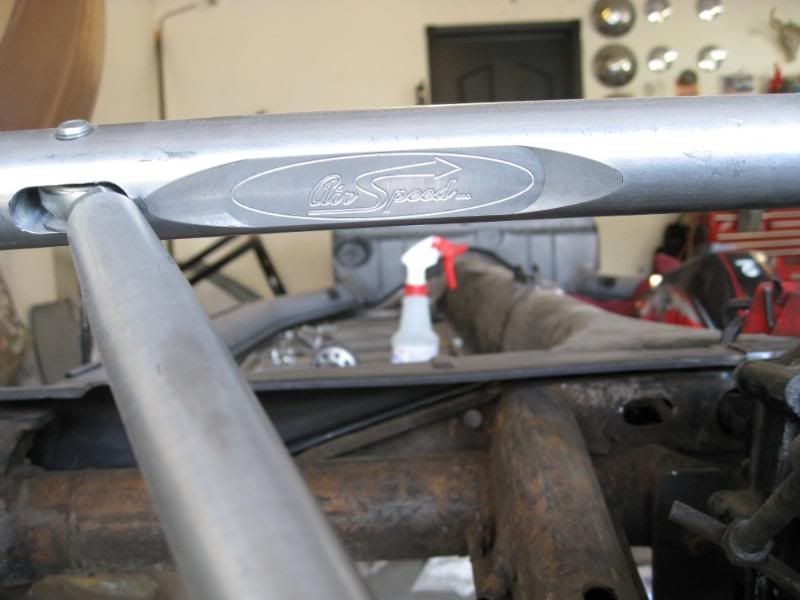

also picked up an NOS ::) Airspeed dragbar from Russ for it

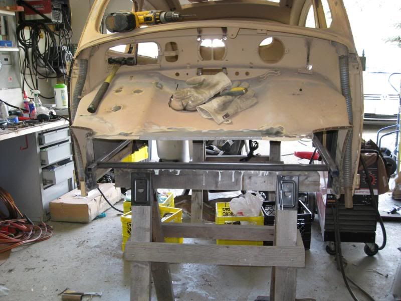

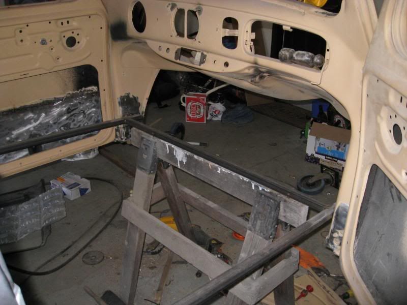

Also couple shots of the 1"x1" square bracing I put in to keep it all aligned

thanks man, I had thought about diagonal braces but this thing was so squiwiffed to start with it wasn't square.....surprise surprise  ::)

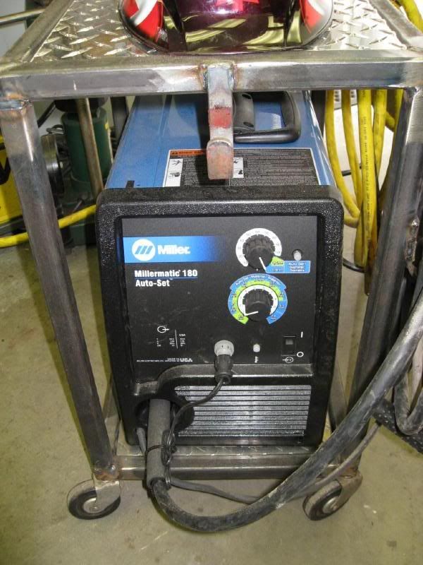

I'm not dead.....haven't updated in a while but have been picking away slowly. we recently sold our house and are renting until we build, car is crammed in a buddies single bay but at least I can still work on it here and there.
I picked up a new MIG ...Miller 180, its a 230v machine that is way more forgiving (than the monster Lincoln 255) on the tinfoil body metal but can still crank it up and do some decent thicknesses, so far really  happy with it! I've have been building a cart for it since the store bought ones are pretty hokey

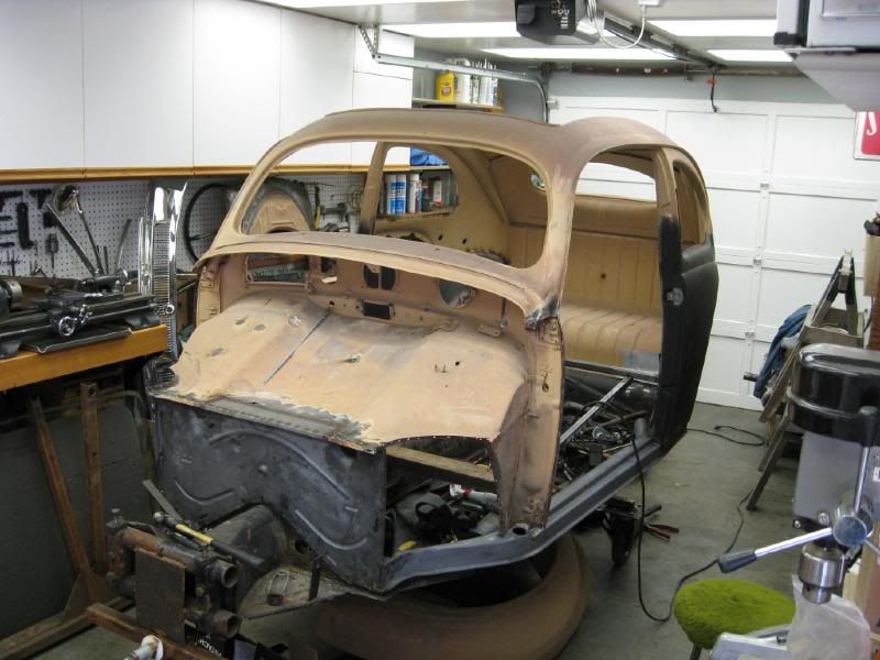

Car is starting to resemble a beetle again ::) body is on heater channel assembly, bolted to the pan as a jig.
plug welding all the drilled out spot welds........ shat loads of fun :P
working on the A pillar bottoms now so I can cut the braces out and pull the pan and put body on the rotisserie
Should be done and on the road by the GCVWS :laugh:

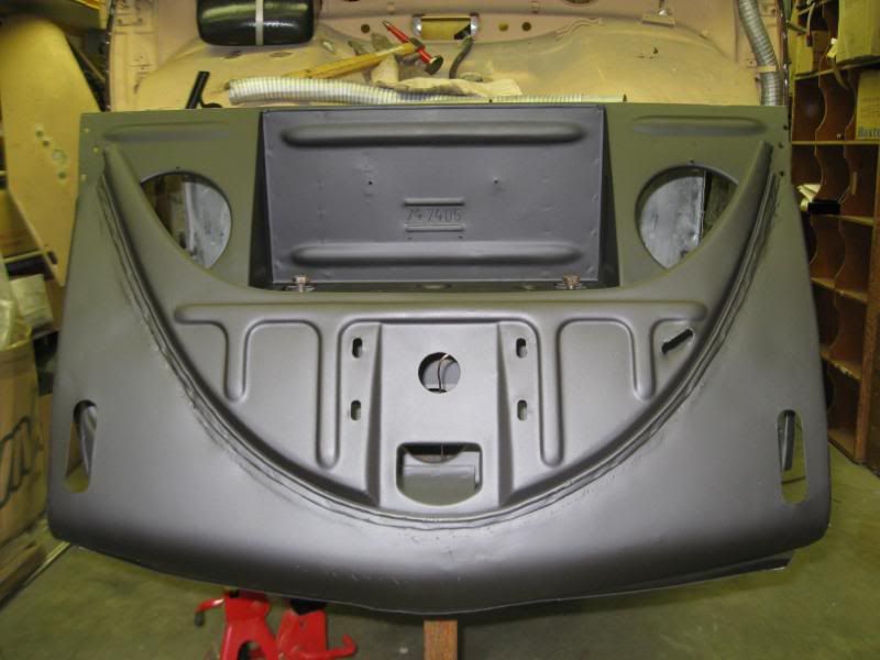

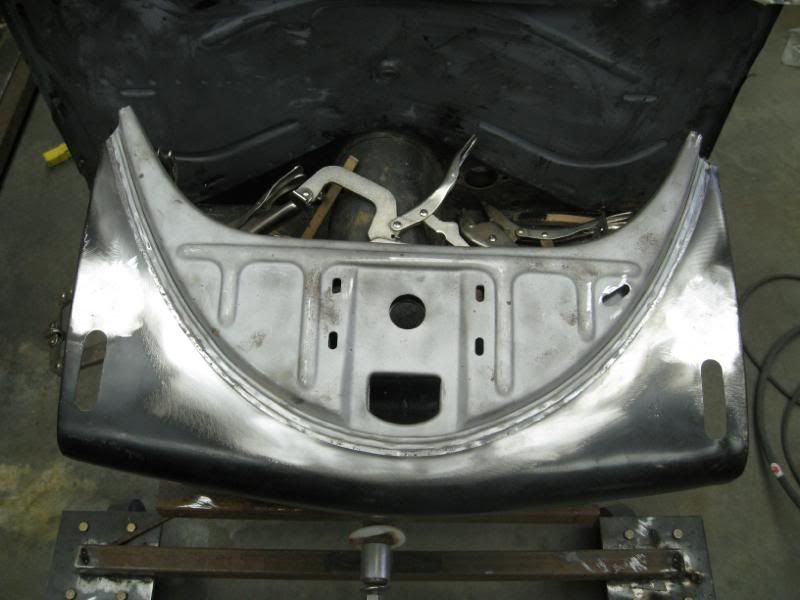

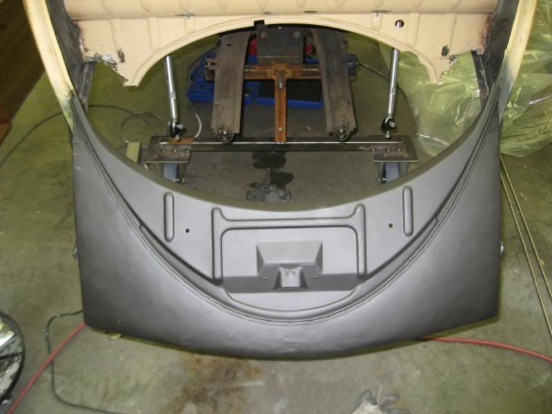

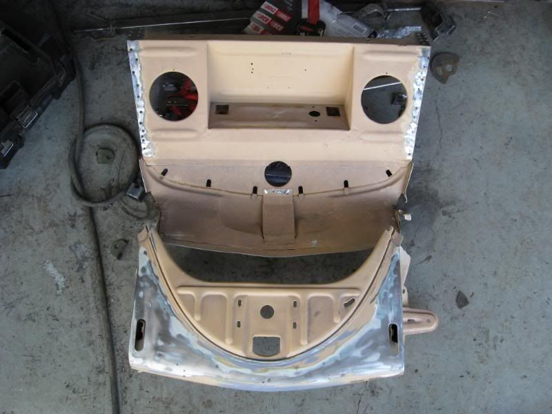

 front apron is done...started with a decent quality aftermarket skin, overrider holes got filled and 4finger section grafted in...
also have my front quarters, rear apron,front tire tray etc all finished and ready for blasting and epoxy but no pics yet

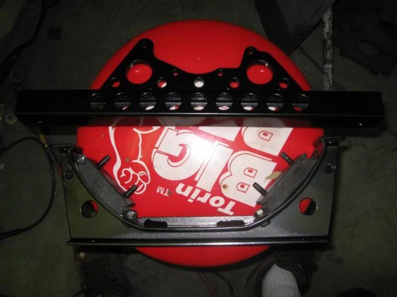

some goodies powdercoated.... check out the speed holes in my intermediate mount 8) lost 8 oz :P

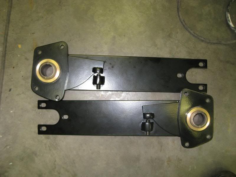

adj springplates....gave the adjusters a little lovin' so slicks wouldn't scrub them this time

FRESH PAINT! :D

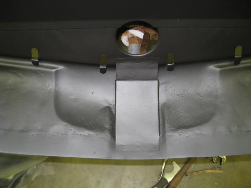

apron and tire shelf....
had to make a new reinforcement plate, tricky little chunk being heavier gauge and some strange contours.

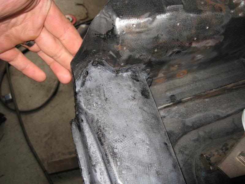

lots of work went into these pricks, one is a 59 and other a 60. '60 had the  wheel arch grafted from a 54 to make right and the antenna holes welded
59 had some cancer in the bottom corner by door hinge and the front 10" was munched and rusty so it got a section up there.

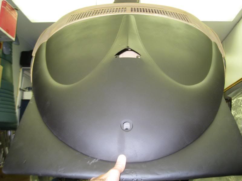

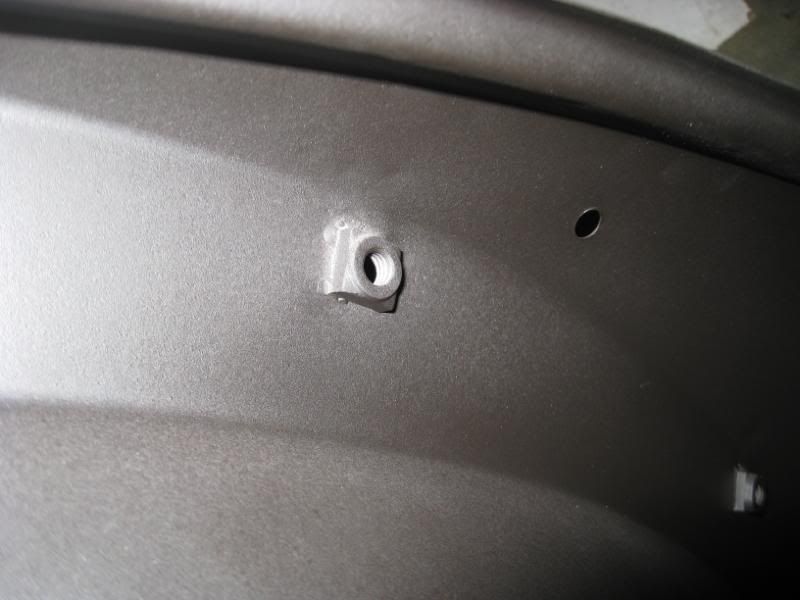

This is me being overly anal and changing all the fender nuts from the long snout ones to the square ones.....what a pain in the ass. I saw a pic somewhere where they grafted a clip on mid tank and the nuts didn't match....looked super cheezemuff. my car came with the sq. ones so....
has to be the cleanest big spring W lid i've seen.....
Non cutout H apron removeable.....only way to go!
and together....

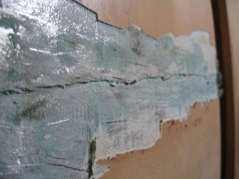

Do you have pics of the problem with the 1960 quarter panel?

Bruce I didn't have the cam with me this afternoon but next time I go to the shop i'll snap a few of the problem area.
Finding it wouldn't work on my car was like a kick in the seeds.....I was really stoked to get the front clip done and finally be done with the metalwork, now I can't do jack until I find a new quarter :'(

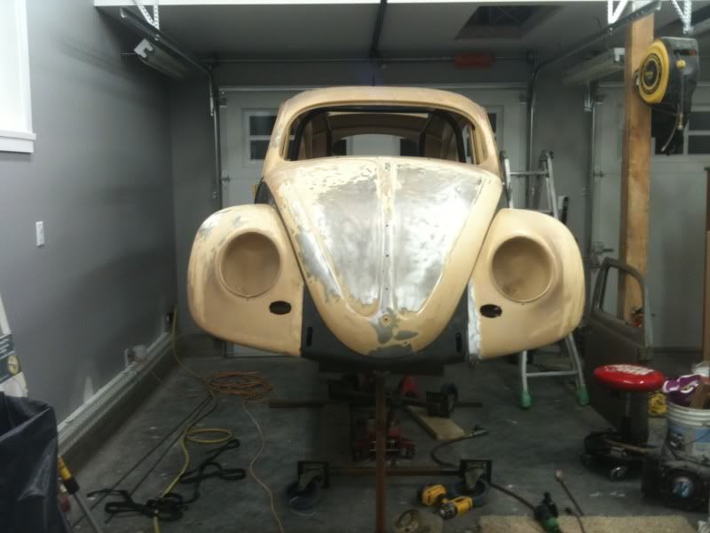

Anywho now that the fam is settled I am dialing in my shop with work benches and organizing the mess. Car came home last weekend. It fit in my buddies 4x8 trailer (barely) because the front clip is still off.
1am lastnight I had enough organizing and couldn't resist hanging some panels. Everything is lining up mint and the car is as complete as it has been for a long long time.
Goddammit can't figure out how to upload pics from the phone, I'll chuck some pics up later......
edit: pics

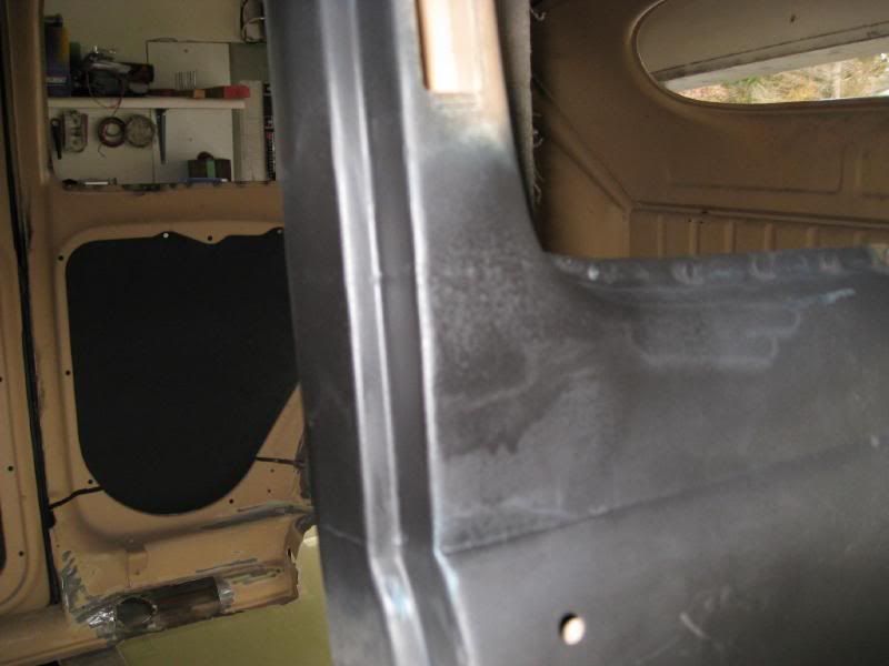

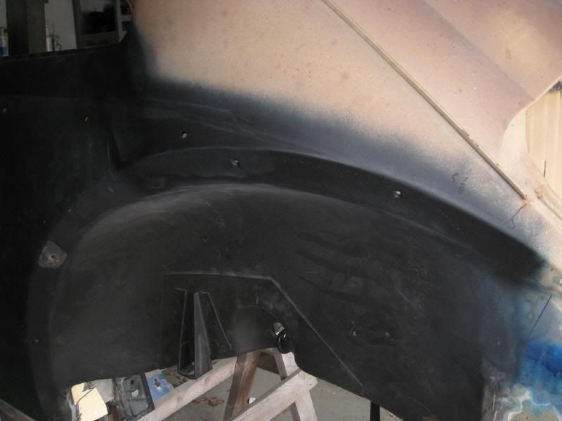

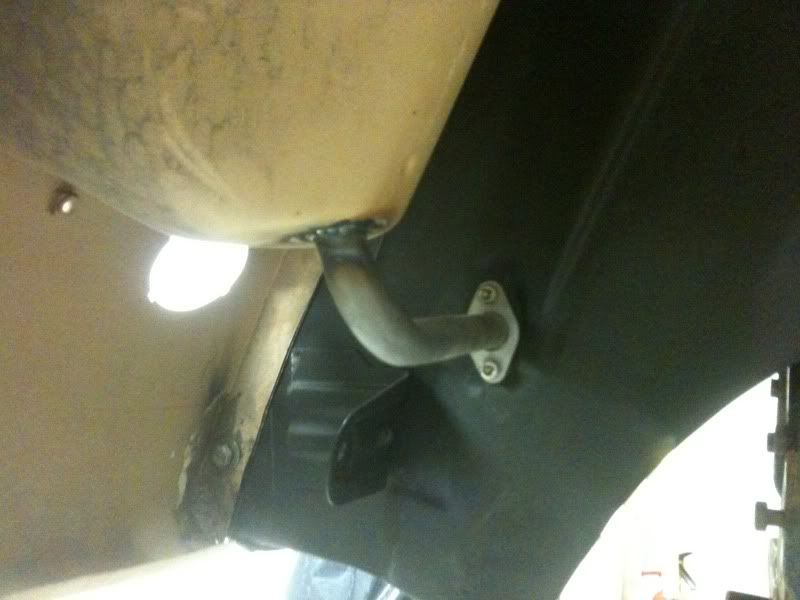

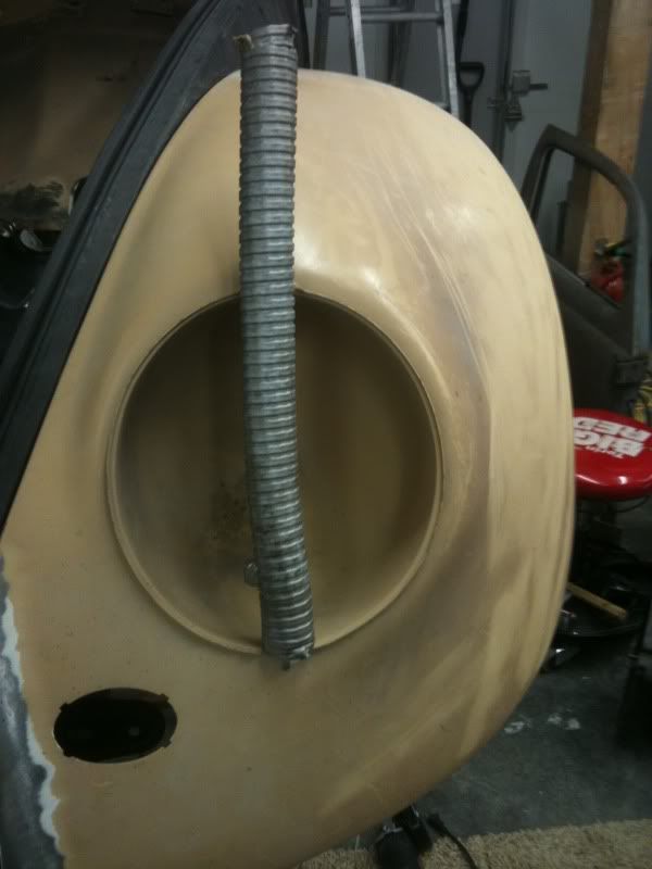

my little gearhead was out with me today, we fixed the boogered driver door skin mess I made over a year ago.
she was telling me how much she wants to ride back there PDT_Armataz_01_37
missing wire tube welded back on
nasty hood gaps were one of the deciding factors into ripping so deep into this car and now they are 1/4" all around  :D

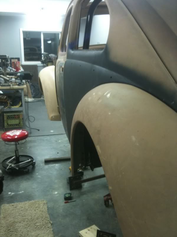

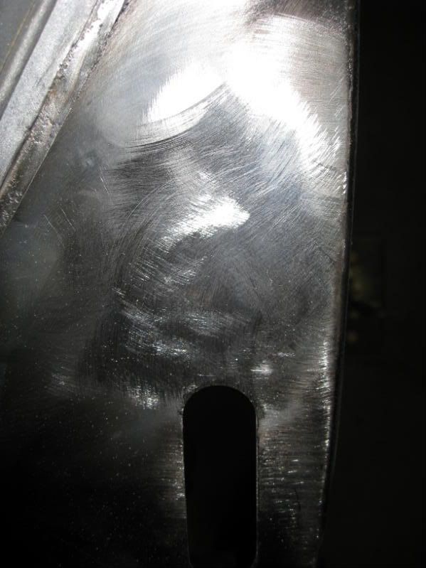

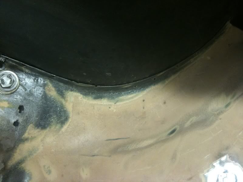

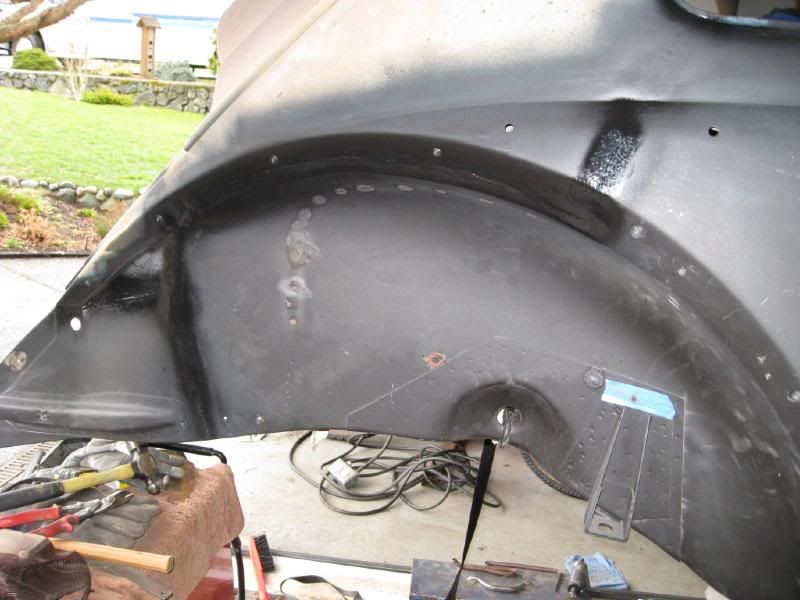

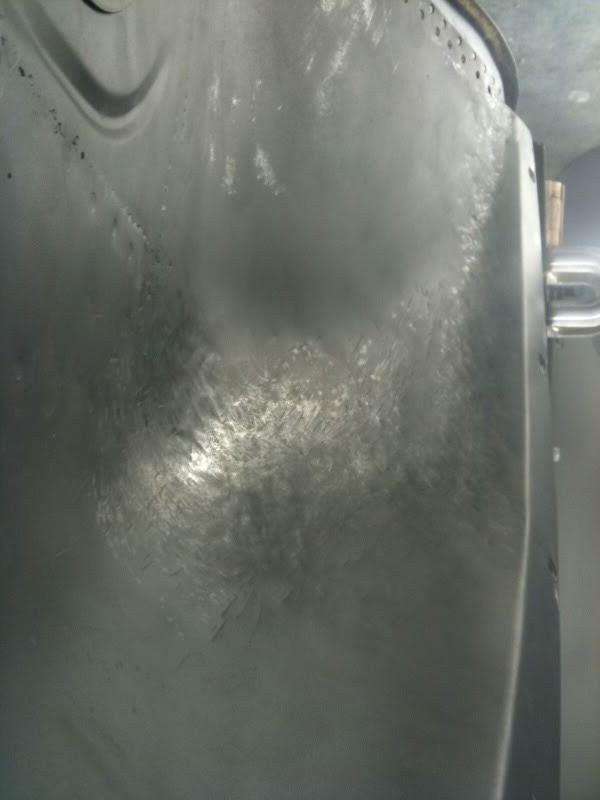

got a couple hrs. on this pig today, metal worked the shit out of this quarter panel area where it wasn't lining up.....
whole bunch-o bumping and hammer/dolly work to stretch the pressing inwards. I may bug my buddy into running it through an english wheel to make it perfect but at least the flanges meet up now :cool:
