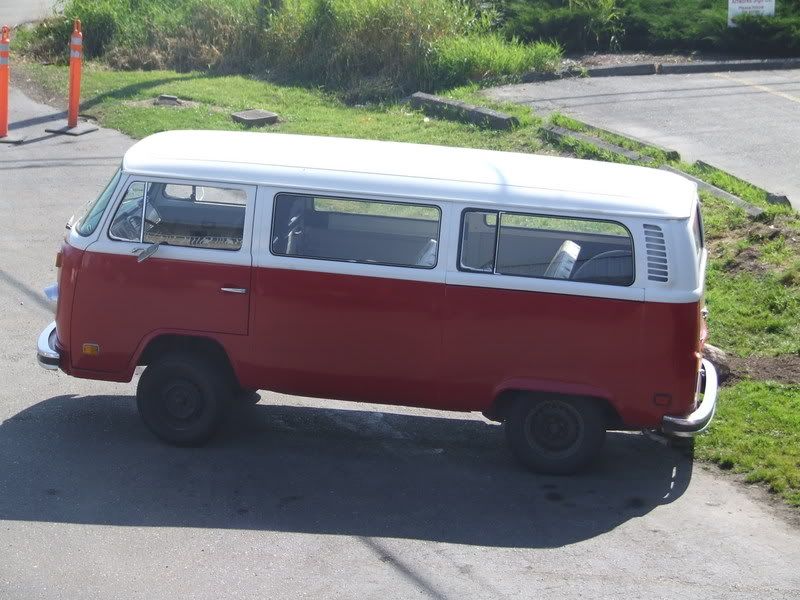

hi all,
i just picked up this 73 baywindow and i want to slam it. what is the best way to acheive this?
i have read in other threads about adjustable beams and dropped spindles, with beetle kyb gr-2's. is this the way to go for the front? and if so what is my best option for aquiring such a set up?
for the back i read about adjustment in the spring plates, would i also replace the rear shocks? (with kyb's?)
i am hoping to pick up a set of 17\" or 18\" wheels for it eventually (before the lowering) if that makes any difference.
thanks for any help.
