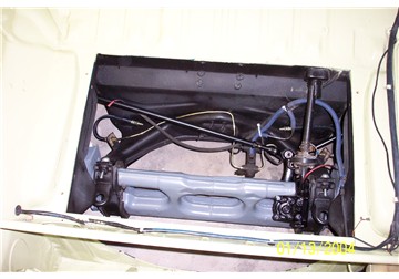

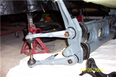

Those wheels only come in the one offset. and a type 3 beam can't be narrowed, they use a torsion bar suspension, like the rear of a type 1.  Unless I had torsion bars made up to fit a narrowed t3 beam.....
I heard a rumor that there is a guy in the Vancouver area that has a set of these he was able to mount to his Notch, but he welded on a type 1 framehorn and is using a type 1 narrowed beam. Sounds pretty trick.

how about narrowing the wheels themselves? if they narrow from the outside, the offset would work and there shouldnt be any rubbing on the fender. maybe??
are those 5.5 or 6\"s? see if greens can cut em and narrow them to 4 or 4.5\"
i think dave conklin runs american racing mags on his 67 and got his narrowed.

They were 4.5's already. thought about shaving some off the inside of the wheel, but that might be a bit hairy. If I took 1/4\" off it would only leave about 1/4\" of bolt hole thickness. I was looking at a t3 beam today...contemplating....

Its not a rumor!!! Its a true thing. I put a beetle ball joint frame head on my notch floorpan so I could run a 3 inch narrowed beam. Unfortunately it is still in the build stage. The wheels matt has are chevy bolt pattern and offset, thats why they wont fit easily. I have American Racings wheels as well but mine started out as 7's and I had the fronts narrowed to 5.5 but they are in the porsche pattern which the offset is to the inside so it made it easier to fit. I guess Matt and I will be brothers with the wheel and car combo!!

I'm gonna throw this into the mix....  From the pictures it looks like it is the tires that would be rubbing.  Are we missing the easy solution by just going to a different tire combination?  They make so damn many tire varieties now that you should be able to find something to fit.  On a different note SlammedBus and I are looking into narrowing beams already.  We have a couple type 3 beams here, we'll look into it.  Sounds like a challenge. :wacko:
