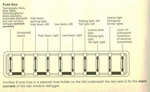

I have a 68 beetle, i bought a mix set of fuses , Does anyone know what size goes in what spot , Thanks!

the above diagram is from thesamba.com tech pages and as per a manual i pulled off my shelf (volkswagen service & repair handbook, clymer publications), all should be 8 amp fuses except the second from the right should be 16 amp.
good luck.

unless its a new fuse box, ive noticed some of the new ones coming out are actually backwards....
