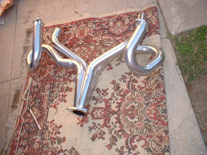

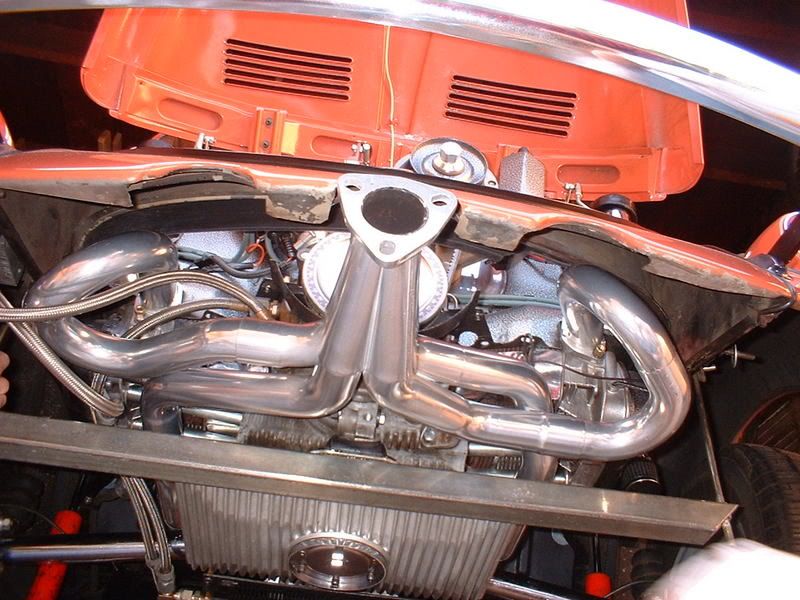

Here's a nice merged exhaust system, made by A1 in So Cal.
I took these pictures as the exhaust was being installed on the car, Bill Schwimmer's 58 beetle.
Click on the photos.

« Reply #9 on: April 19, 2007, 08:39:00 PM »
here is a pic of my A-1 Lowdown with a 1 1/2\" tranny raise
its a little dirty, but its ceramic coated and I can clean it up.
Looks to be the same one as what gav posted, if your running stock height tranny mounts you should probable be able to clear the apron or just about.
