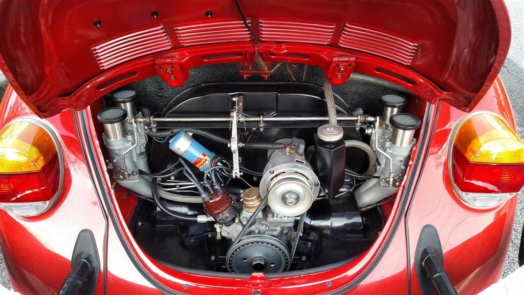

I'm not running heat and I want to ditch the outlet ducts on my shroud for a cleaner look. Have a good original shroud and i'm wondering if instead of buying an aftermarket one w/o outlets (heard bad things about cheapies cooking motors) can I chop the ducts off mine and skin it in sheet metal. Will this screw up the airflow direction inside??? Anyone done this?

There are 3 or 4 spot welds that hold the outlets in place. I had to grind a couple of high spots on the shroud it's self where the metal is rolled up a bit. Made templates to fit into the holes and welded them in.
I haven't had any heating issues with my 1915 and i run 9.5:1

1973 Type 181 (aka Thing) shroud. No fresh air outlets.

I read this somewhere before, once you have the outlets off , look down inside the hole. You should see that the air flow is blocked from going to the heads forcing it out the heater outlets.   Cut a hole so that the air can blow down on the heads and not just be totaly blocked once you fill the outlets.  Apparently the thing shroud has something like this.  Maybe Glenn can confirm this?

I've never taken a Thing shroud apart, but i've also heard that the internal vanes are different. And simply plugging or even removing the fresh air outlets cause internal turbulance and cooling is not a good at a real 73 Type 181.
