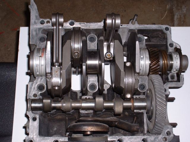

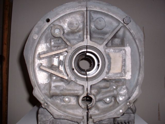

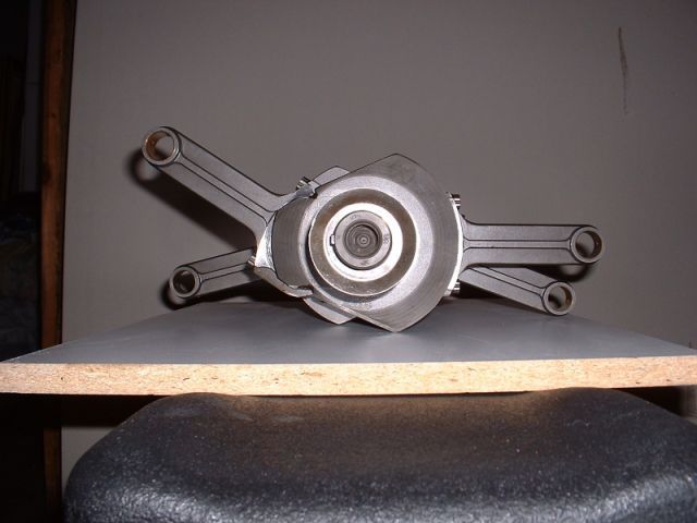

took a moment today to snap some pics of some of my new motor parts for anyone that has any interest in checkin them out!
what ya see is an AS41 case..clearanced..and welded up
a pauter cam..clearanced..
pauter 5.5\" rods.
pauter rev true 86mm crank
and some pauter 1.3:1 billet roller rockers..
those gears are getting swaped for straight cuts..and all the little bits and peices that ya dont see are hiding in boxes..just waiting for some pistions and cyls to show up..and my new heads.
it will be an 86X94mm motor.. damn near 2.4L
its a tight fit in the case but so far so good.
this one should be a screamer.

Hey Cale,
I had a 2443 a few years back and one thing I found was clearancing was a bitch, there were spots on the top of my case that were VERY thin... go slow!
Offline Boost_Retard
  • Posts: 530
Next Seasons Motor
« Reply #9 on: December 21, 2004, 03:52:52 PM »
the case work is done..actually i did not do it myself.. it was purchased from pauter ready to go...
there is actually ALLOT of meat left on the top of the case..way more than i expected..the case to crank clearance is right on the money though..you might be able to slide something the thickness of a  credit card between the crank and the top of the case..
i think it has allot to do with the shape of the counterweights on the crank..
thanx for the heads up though..it might need a bit more work..just to get a little more clearance...but at the moment it all spins free...
