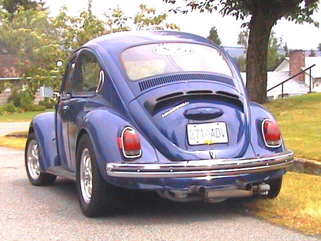

I have 195/55 15 on the front of my 72 super with adjustable struts and upgraded stiffer springs the tires are 22 \" tall.  On the highest strut setting ( which is 2\" lower than stock)  with a family of 5 in the car I only just touch the fenders if I hit a huge bump, It has to be very big bump to rub.  On the lowest setting ( 4 1/2\" below stock)  My fender hit the tire once when my wife was driving and went over a sidewalk driving very fast, it ripped the fender bead out and also wrecked the tire by cutting right through the cords and side wall.   If I was to do it again I would go with 175/60/15 tire and leave my front end where it is now.  My car sits now at 2\" lower than stock, and with just me in the car the tires have never rubbed.  Only have rubbed with 5 people in it.
Here is the link to the picture  http://www.thesamba.com/vw/gallery/pix/146562.jpg
