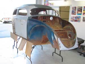

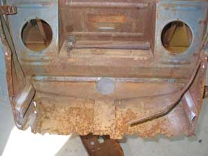

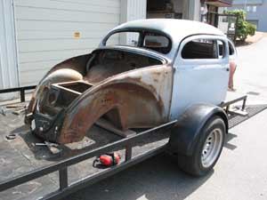

Here are a few pics of the biscut with the nose repair started.
Here she is before we removed the apron, As you can see it was hit hard enough that the pass front 1/4 has a large crease and is kinked. The nose was pushed back about 1.5 inches.
Here you can see some of the wrinkles in the inner fender
Here the spot welds have been drilled out and the apron removed, lots o rust in the spare tire well. We will replace the apron and lower well area.
Here you can see that we used a home made puller, dont laugh it worked. We straped down the body and used the winch to pull the nose as we hammer and dollied the kinks out. The end result was better than we thought and all fenders and hood lined up nice!
More pics to come.
